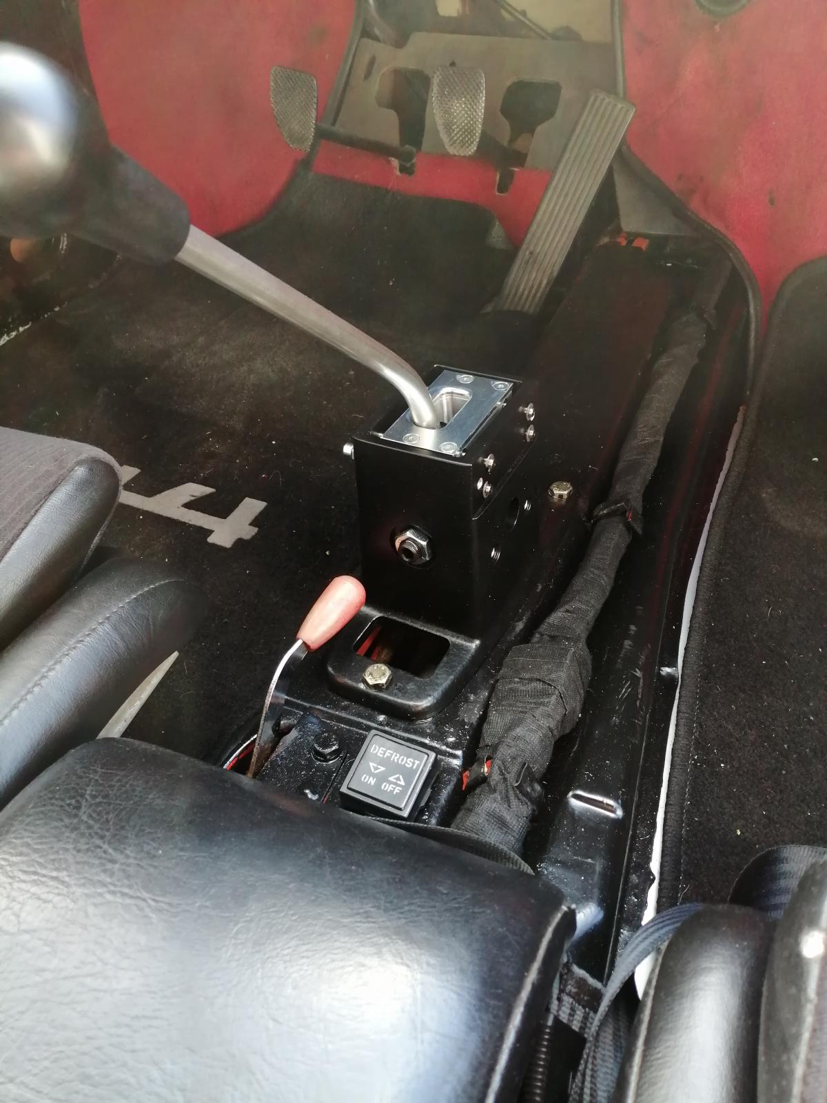

I made some changes, mostly removing all sound deadening material, changing old bushes, mounting a short shifter,.. A pleasure on the roads!
The short shifter:

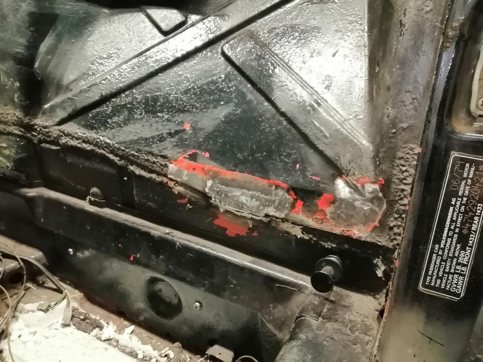

First checking.. Under the long.. Well fiberglass was well hidden:
And on the inside under the belt fixation was also nicely fiberglassed

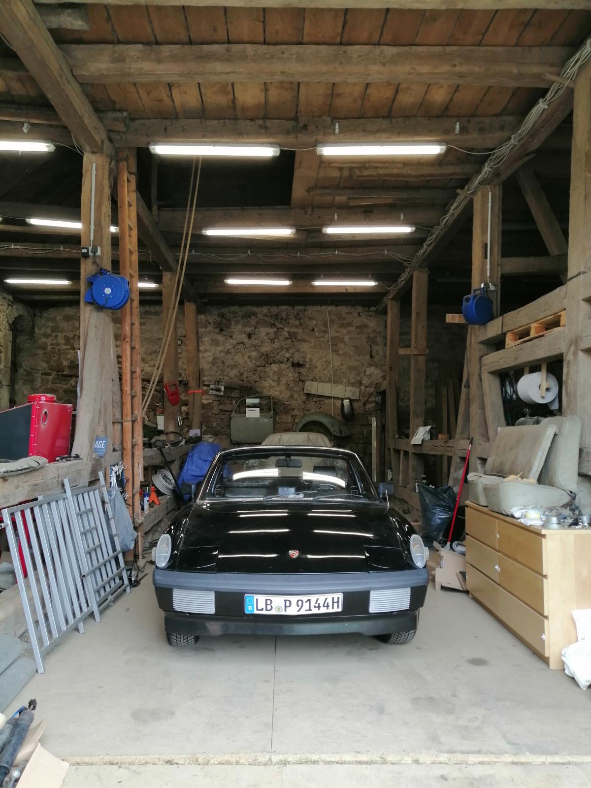

So.. The 914 is in my shop

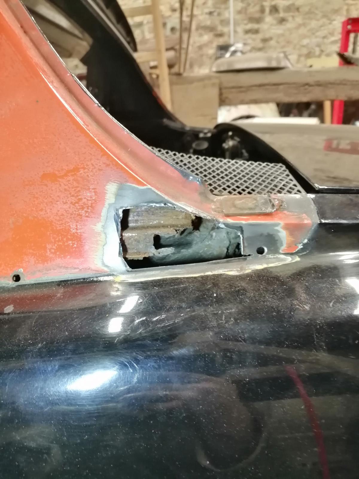

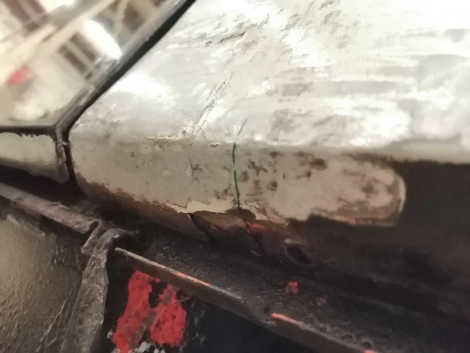

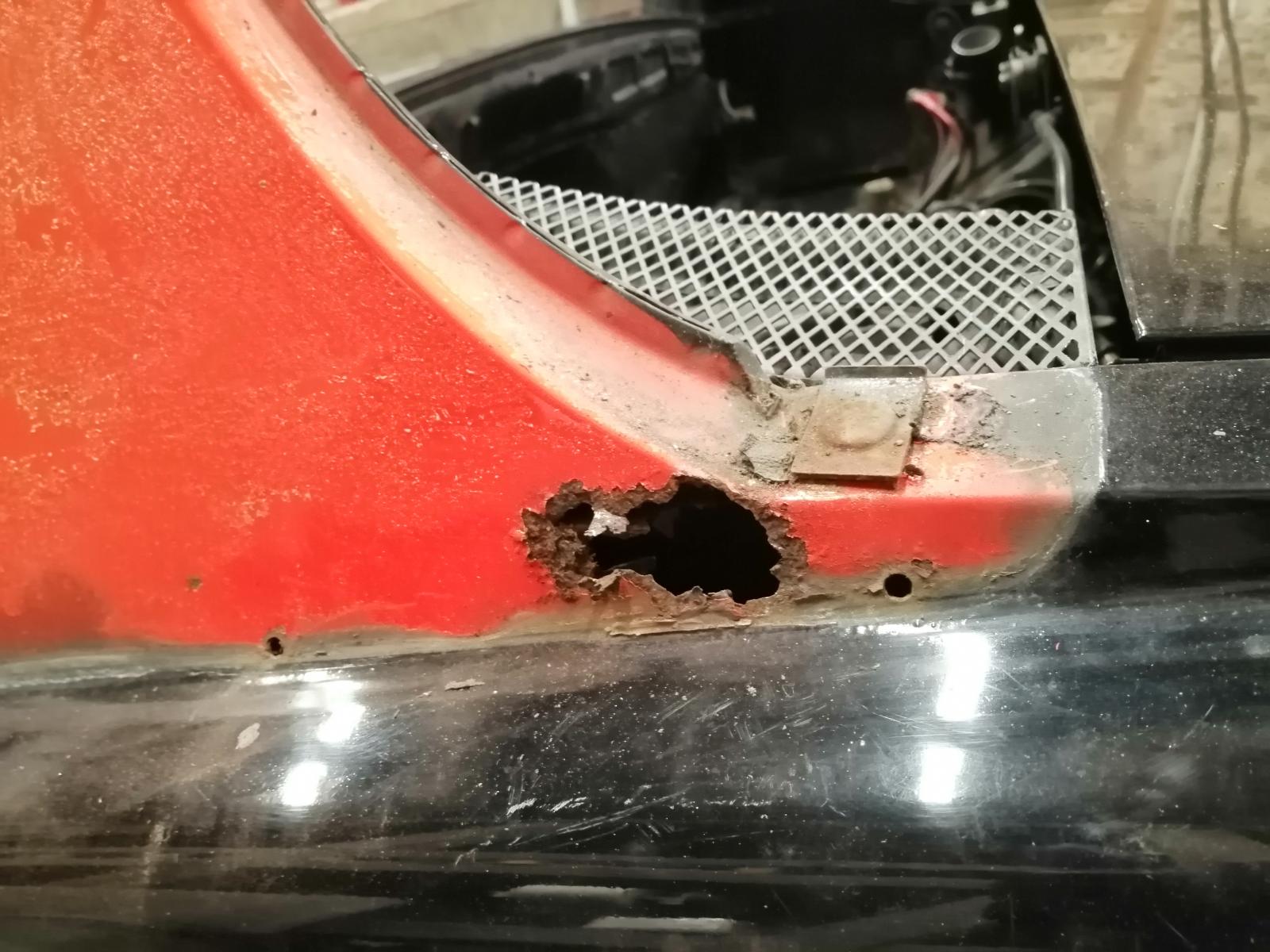

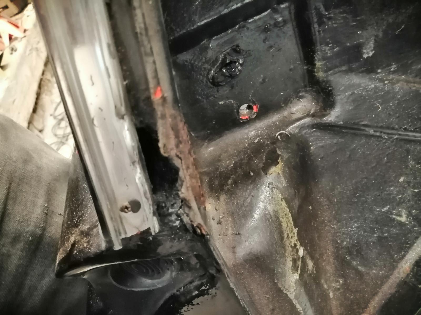

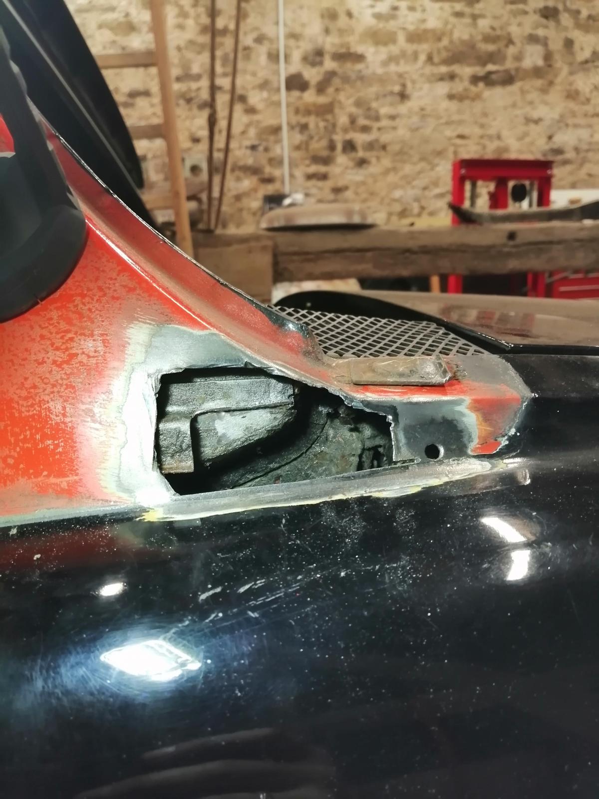

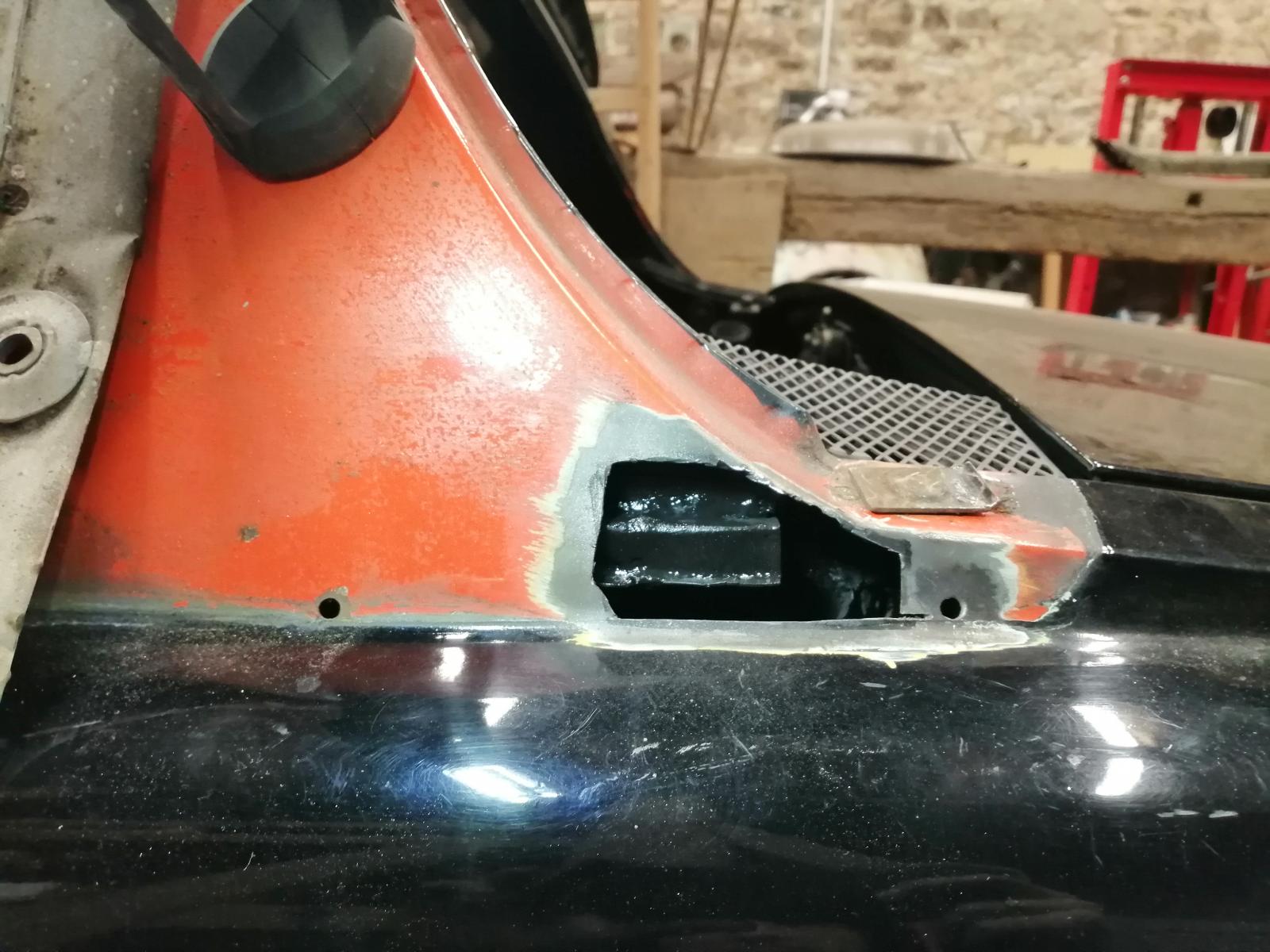

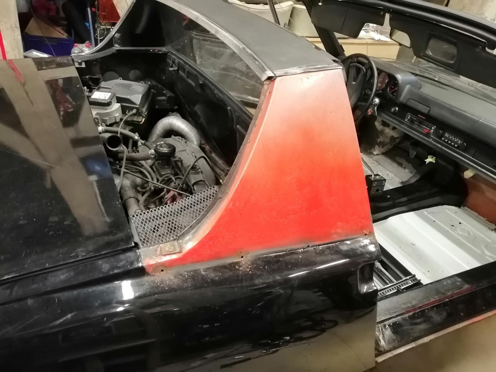

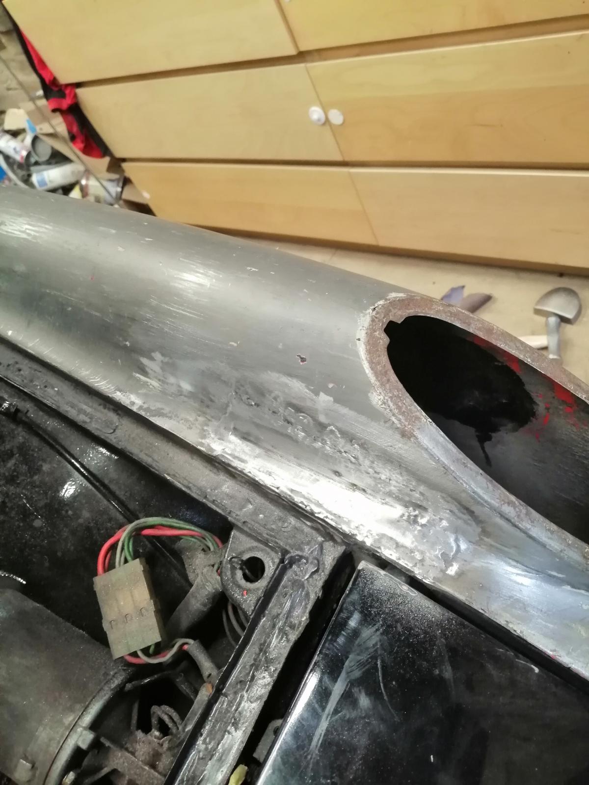

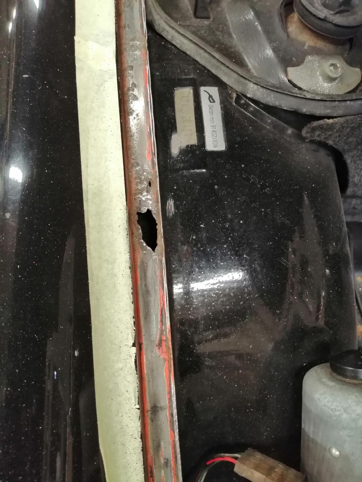

And I made some more disassembly, and checked the B-pillar behind the sail panel where I expected a lot of work..
Passenger side is quite a good surprise, except this hole that could be foreseen:
And is real:
The rest is good
Driver side had developped some.. Let's say waves..
And here there are a bit more damages..

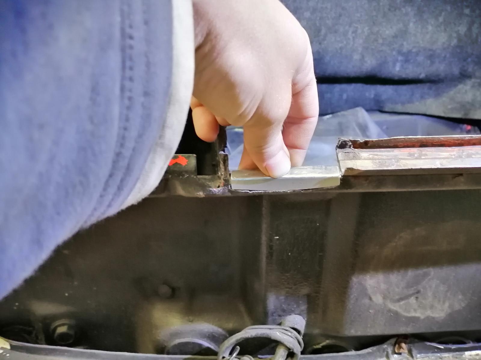

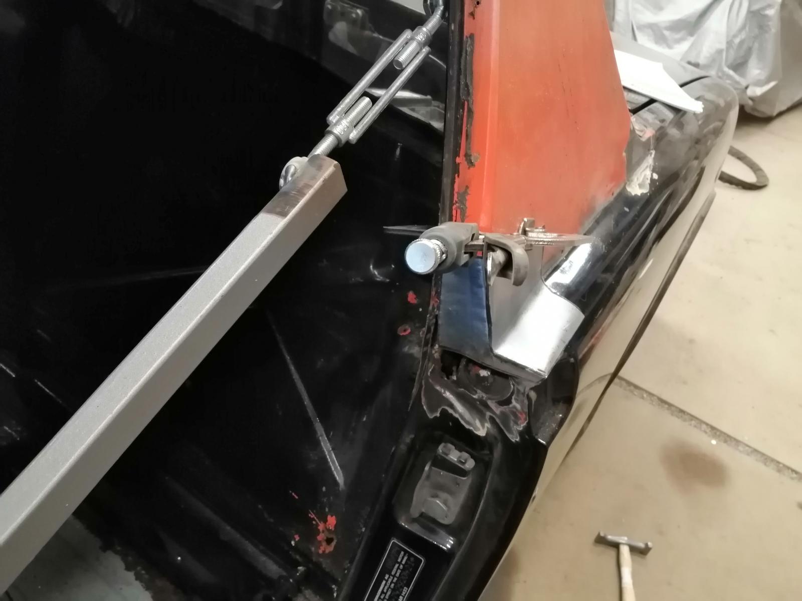

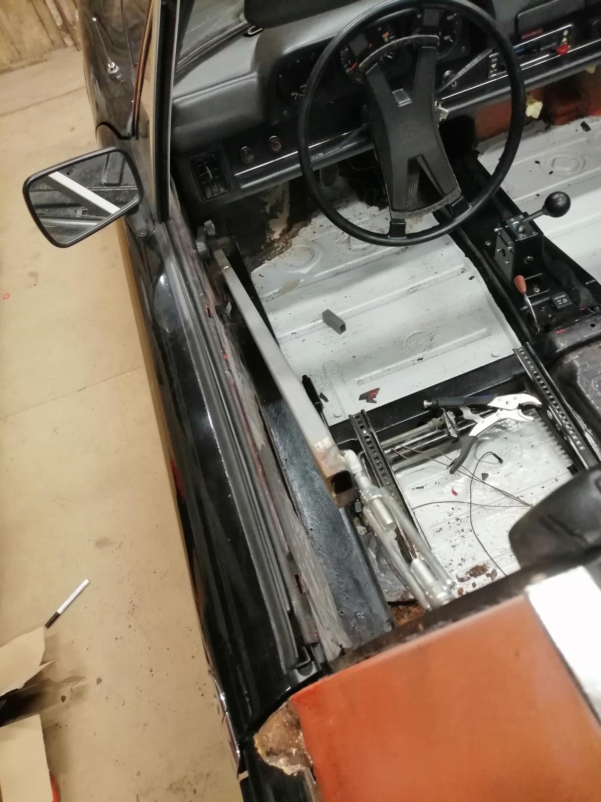

Then I built the necessary door braces, made to be able to keep the doors, in order to always be able to check the gaps
And mounted:
I made them in order to be able to keep the doors to always be able to check the gaps:

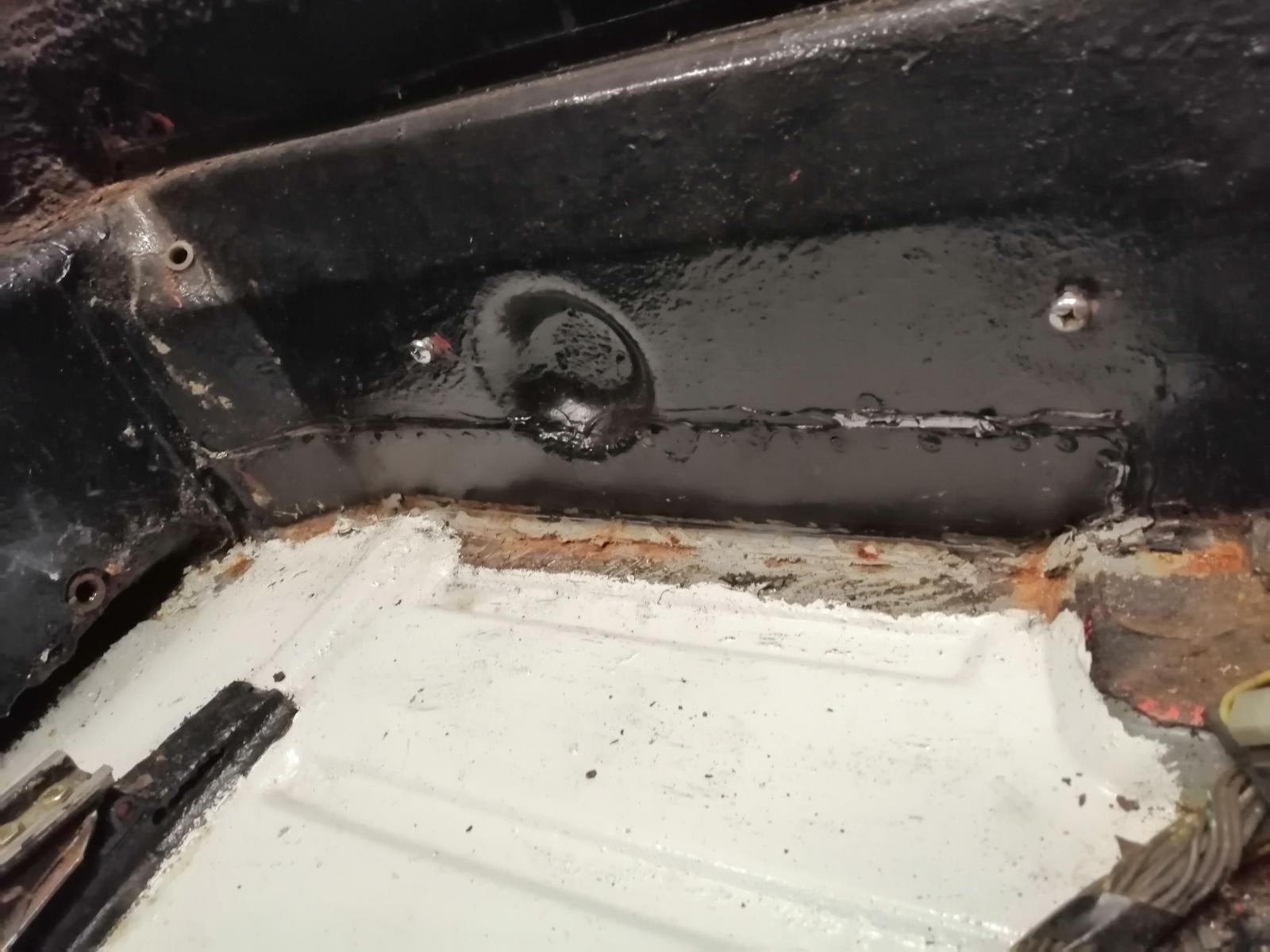

And I check further the inner firewall.. Holes on driver's side, bad repair on passenger's side..

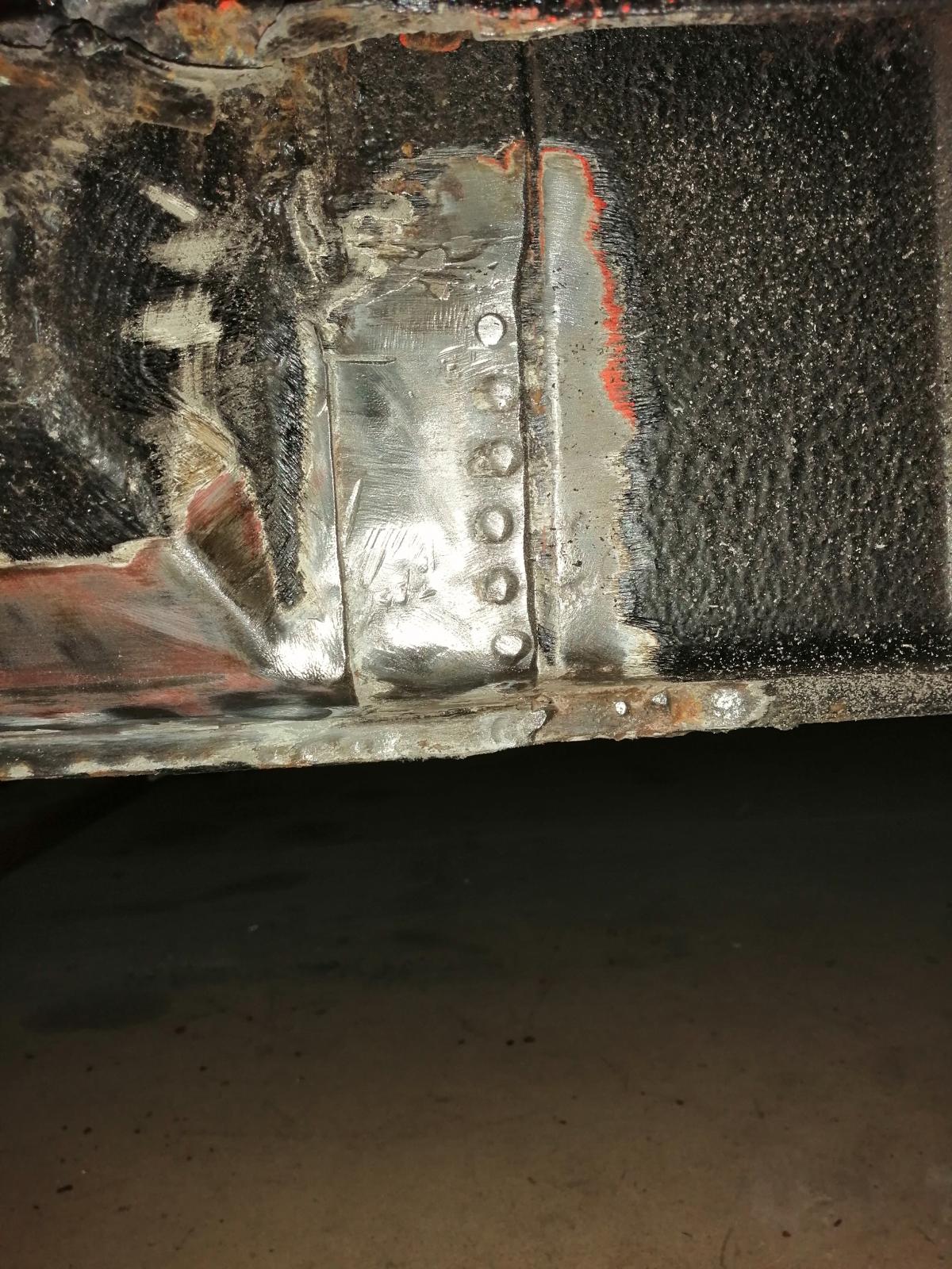

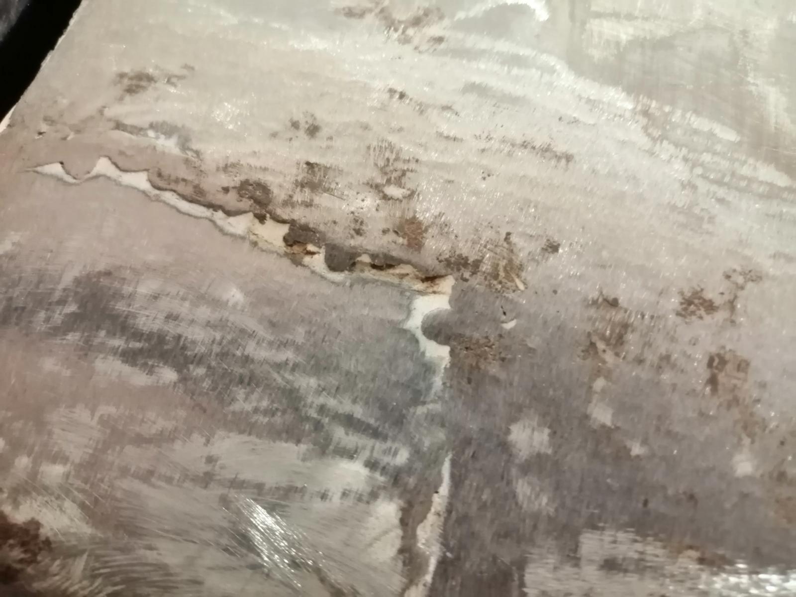

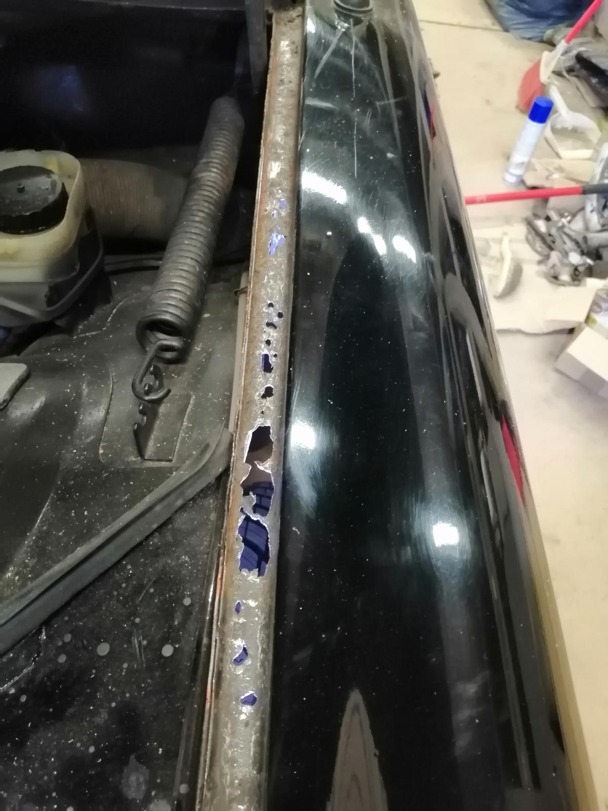

So, I removed more of the undercoating and it appeared to have some "fix" from the past on the long.. Well, let's see after cutting:

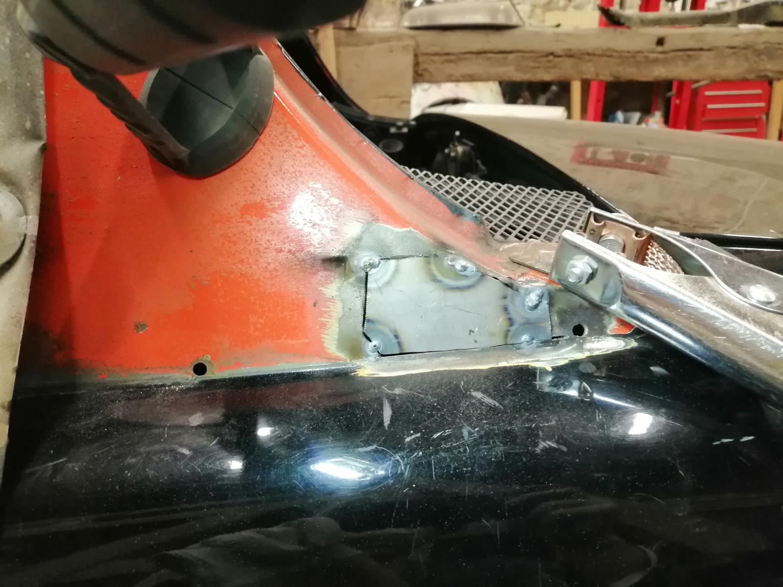

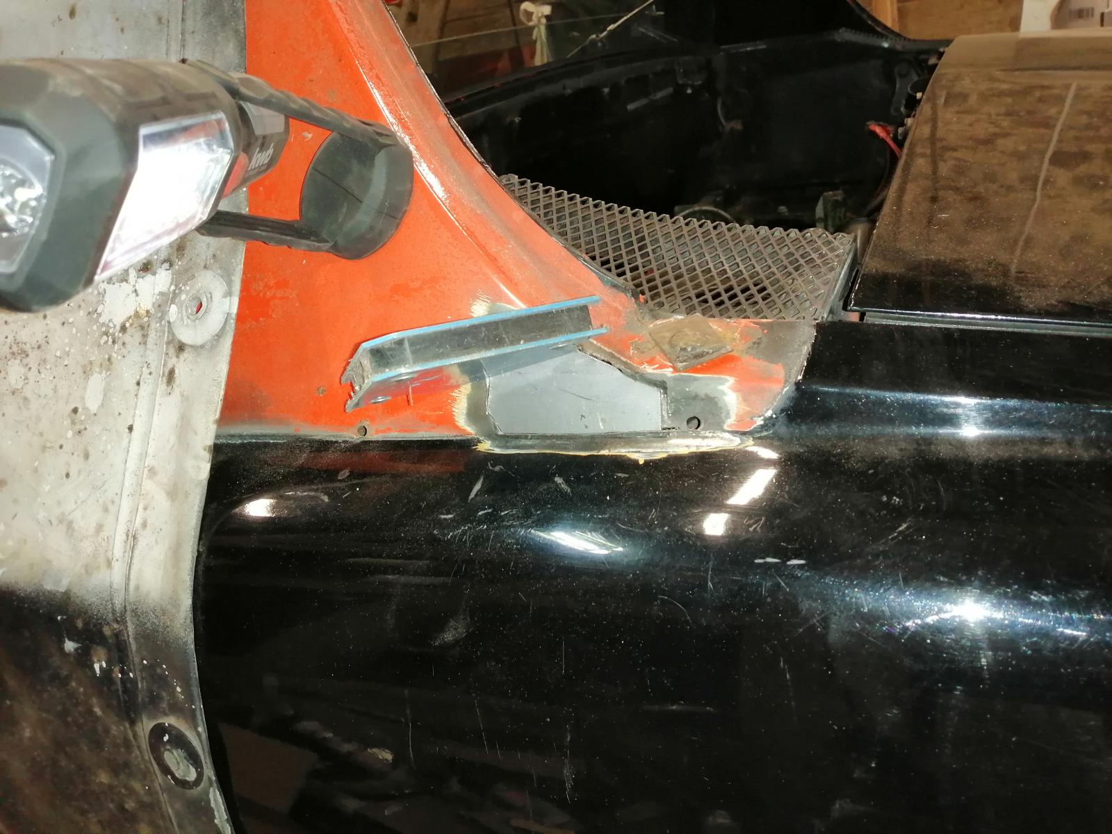

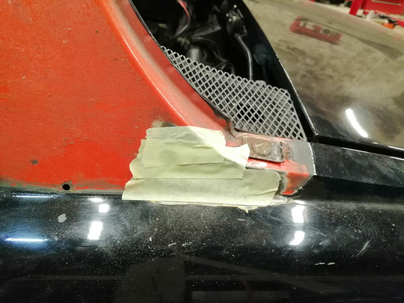

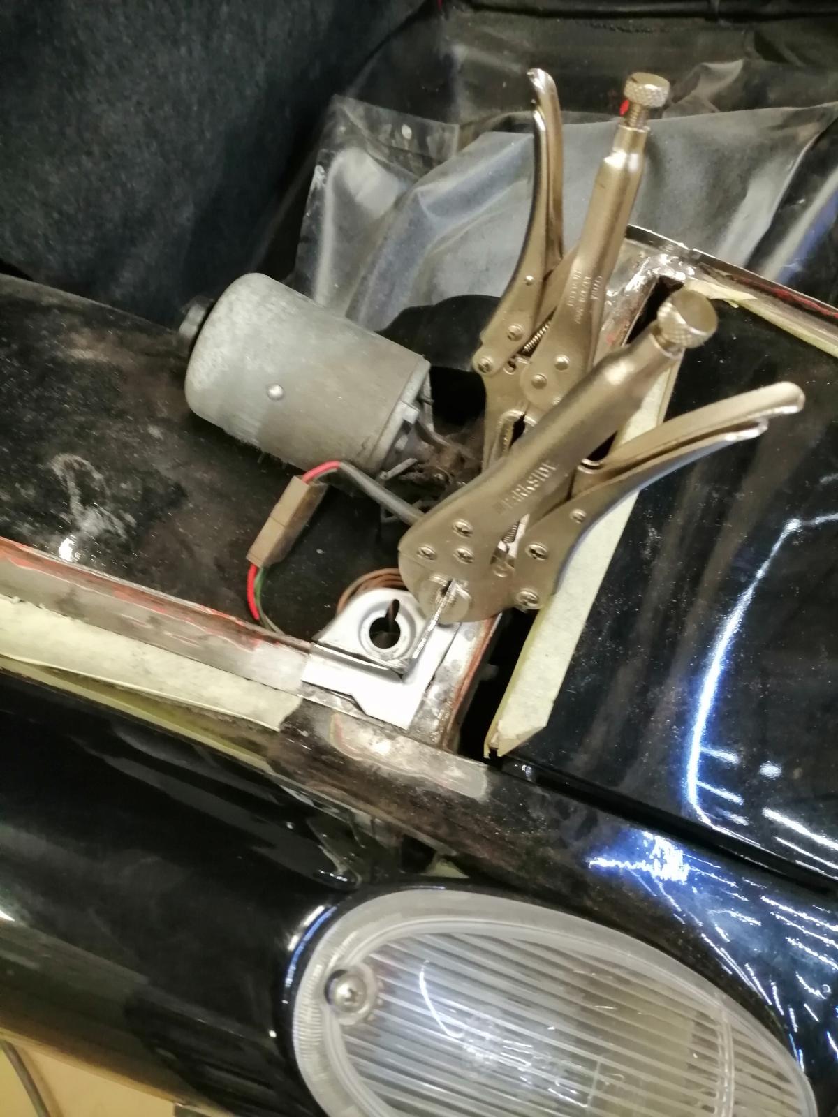

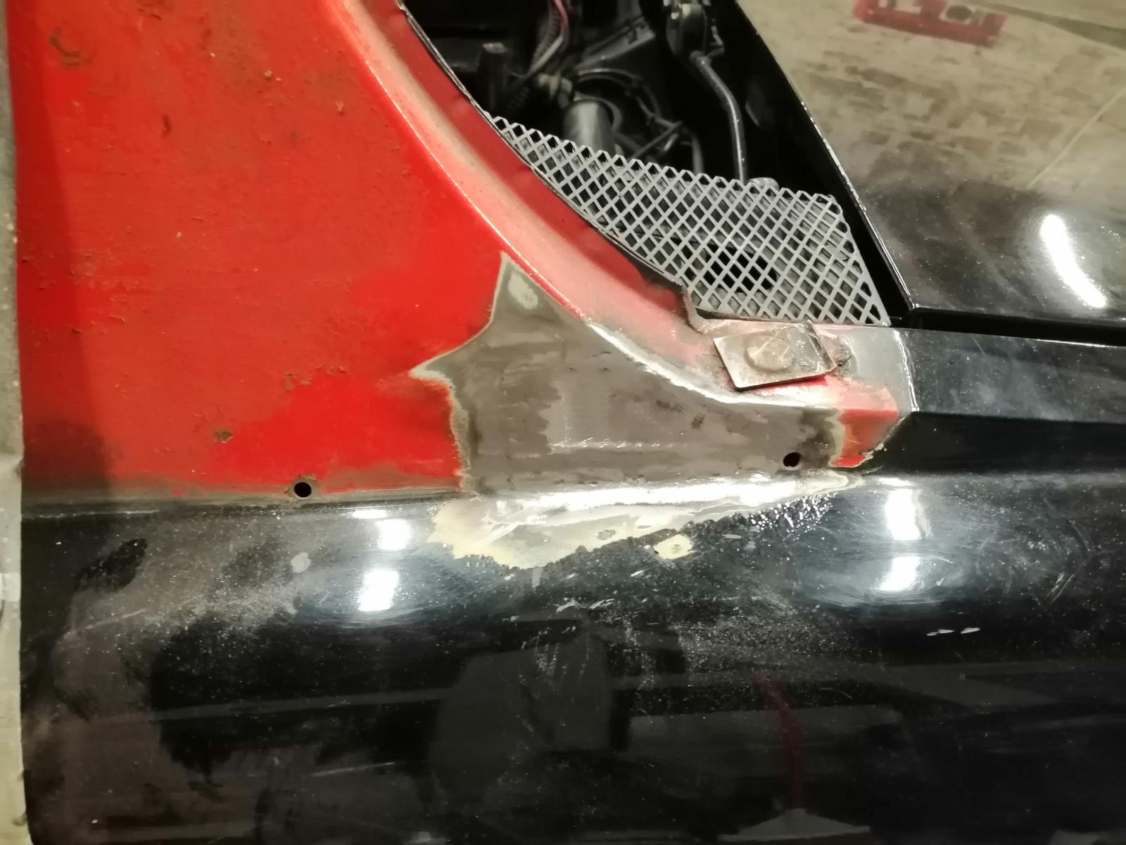

And because it's always good for the motivation, I made a first repair on my driver's sail panel, all TIG-welded

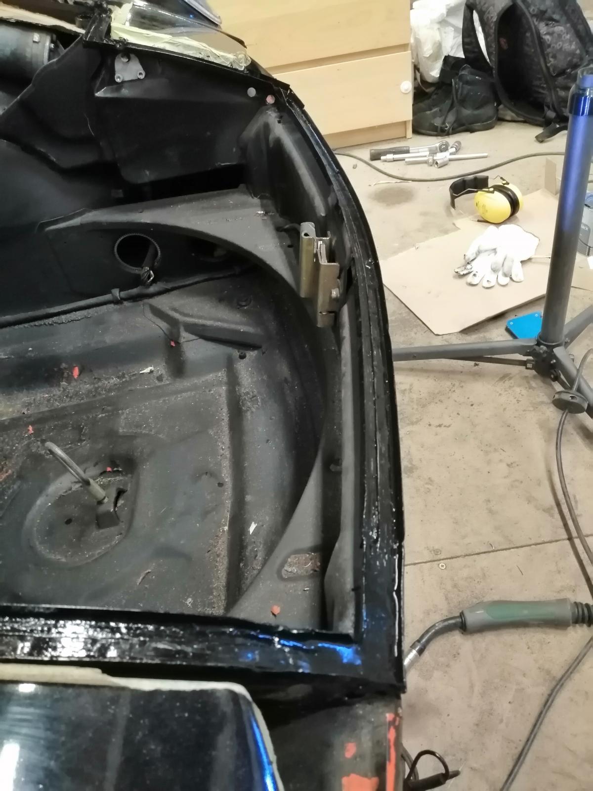

So, already a lot happened to the 914 this week!

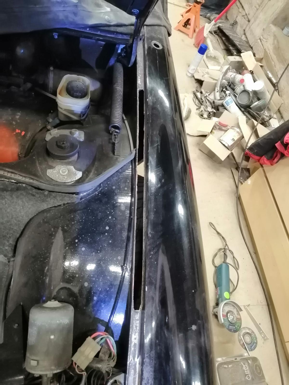

I started upfront by pulling out the frunk seal to check the condition under it..

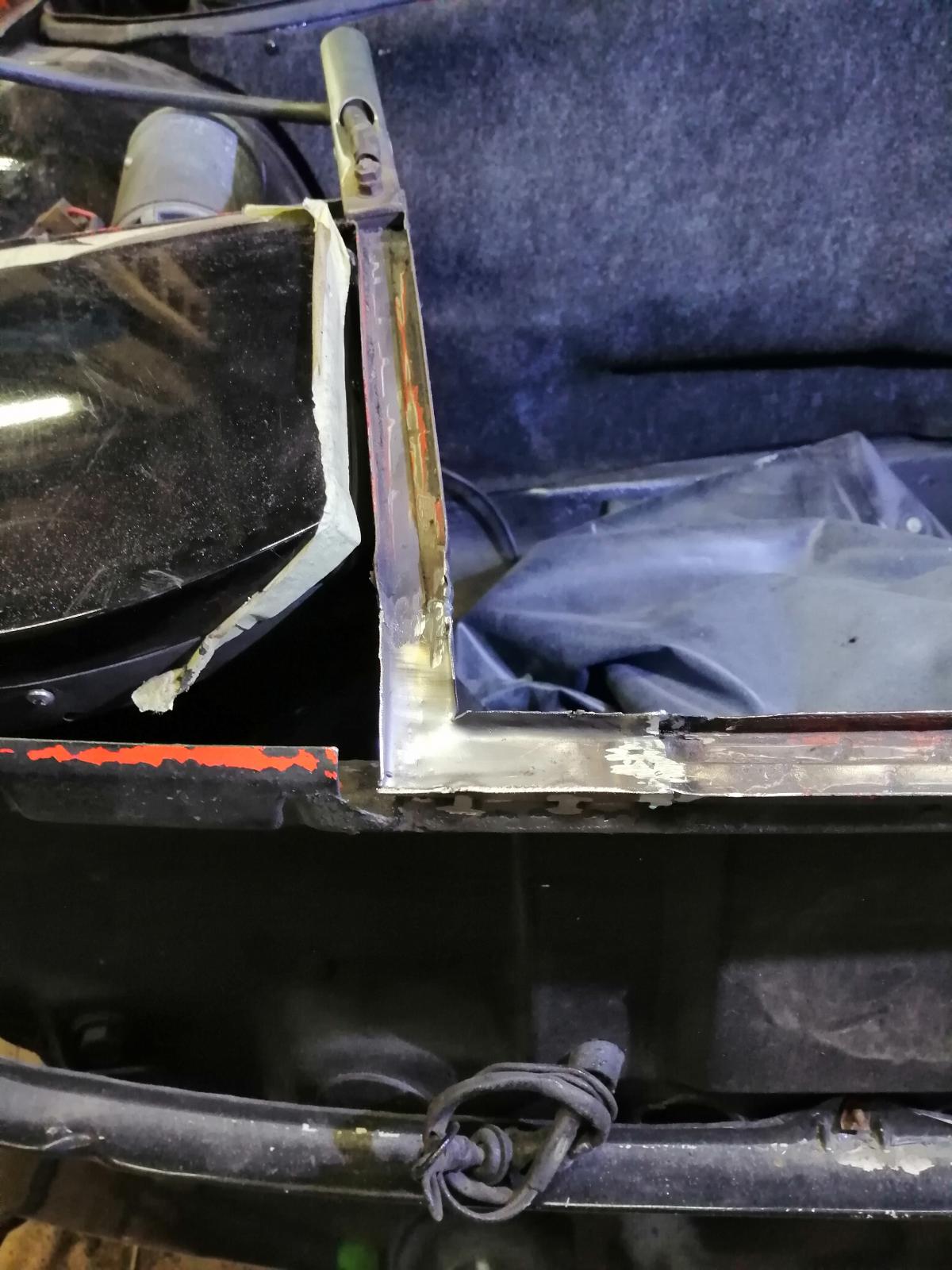

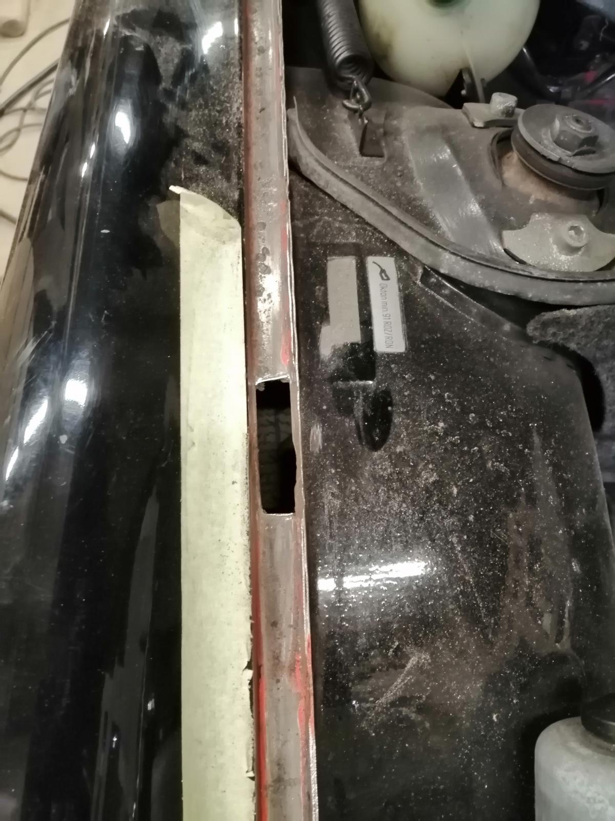

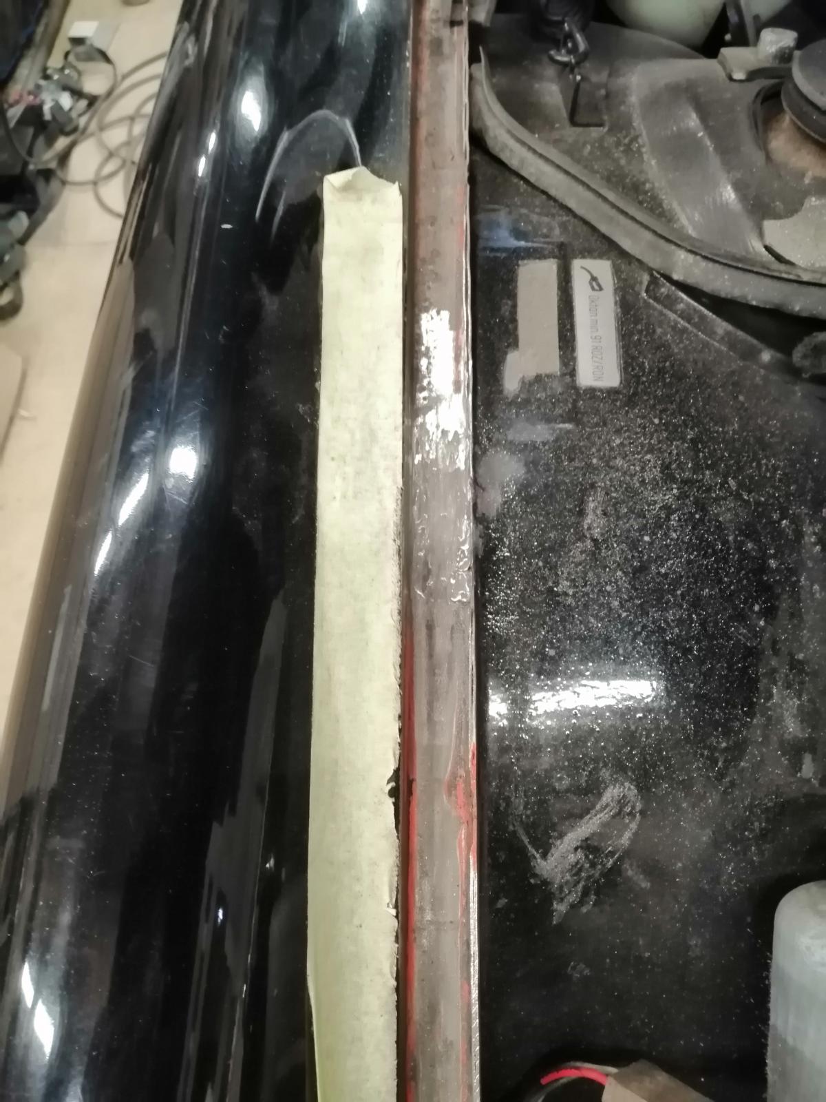

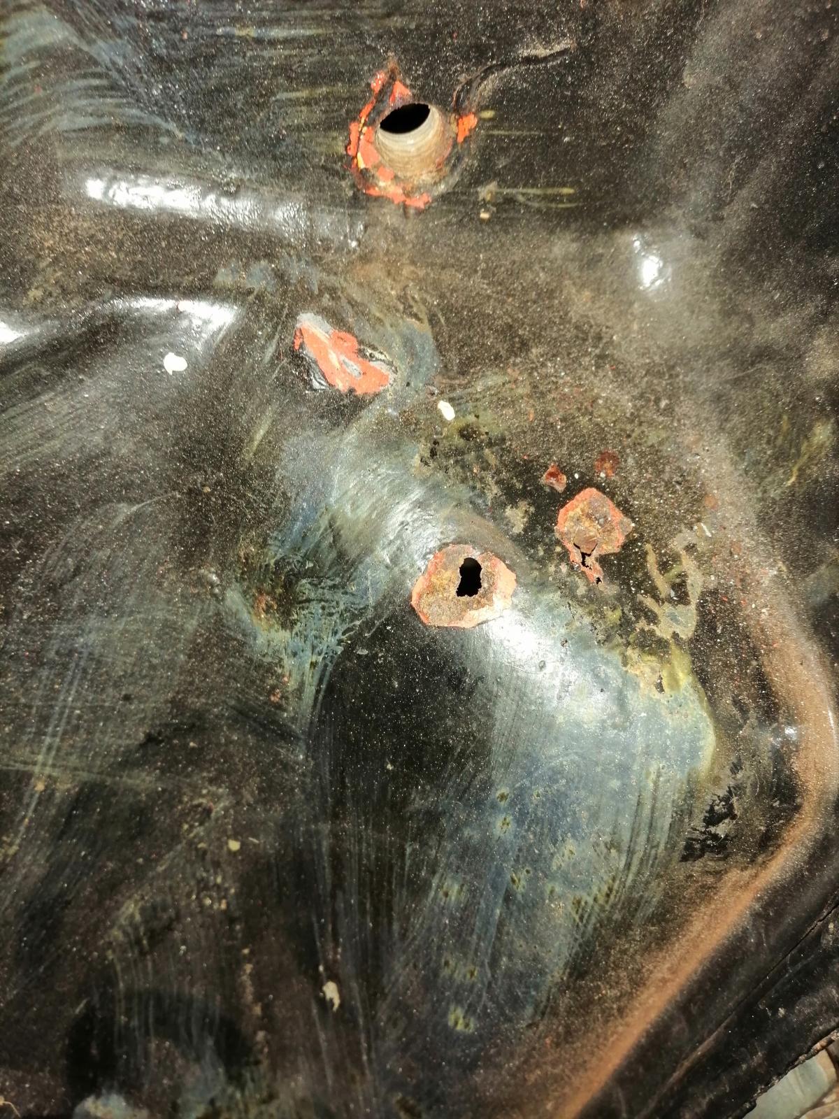

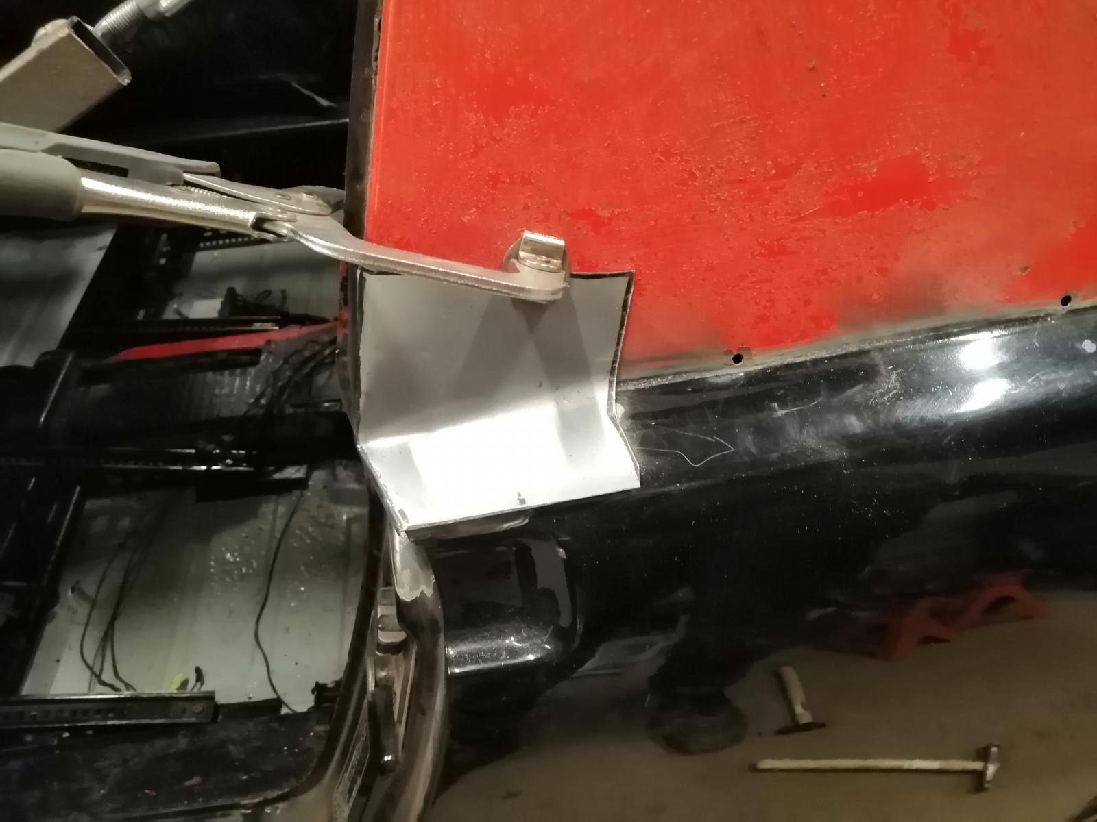

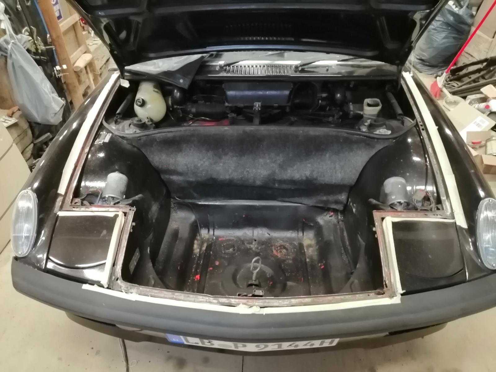

And I found holes after holes. I cut each of them and replaced with metal, I won't bore you with every single picture but here are a couple of examples, like here :
Or here:
Or here :
One last example:
Afterward I put some primer and some paint for complete protection:

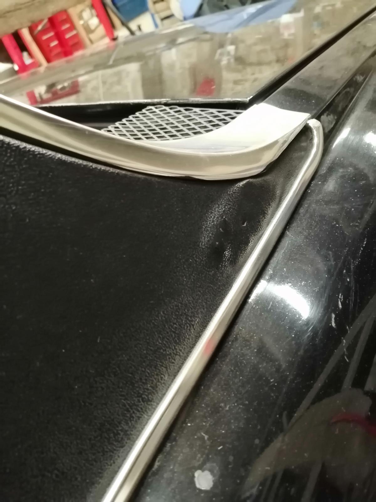

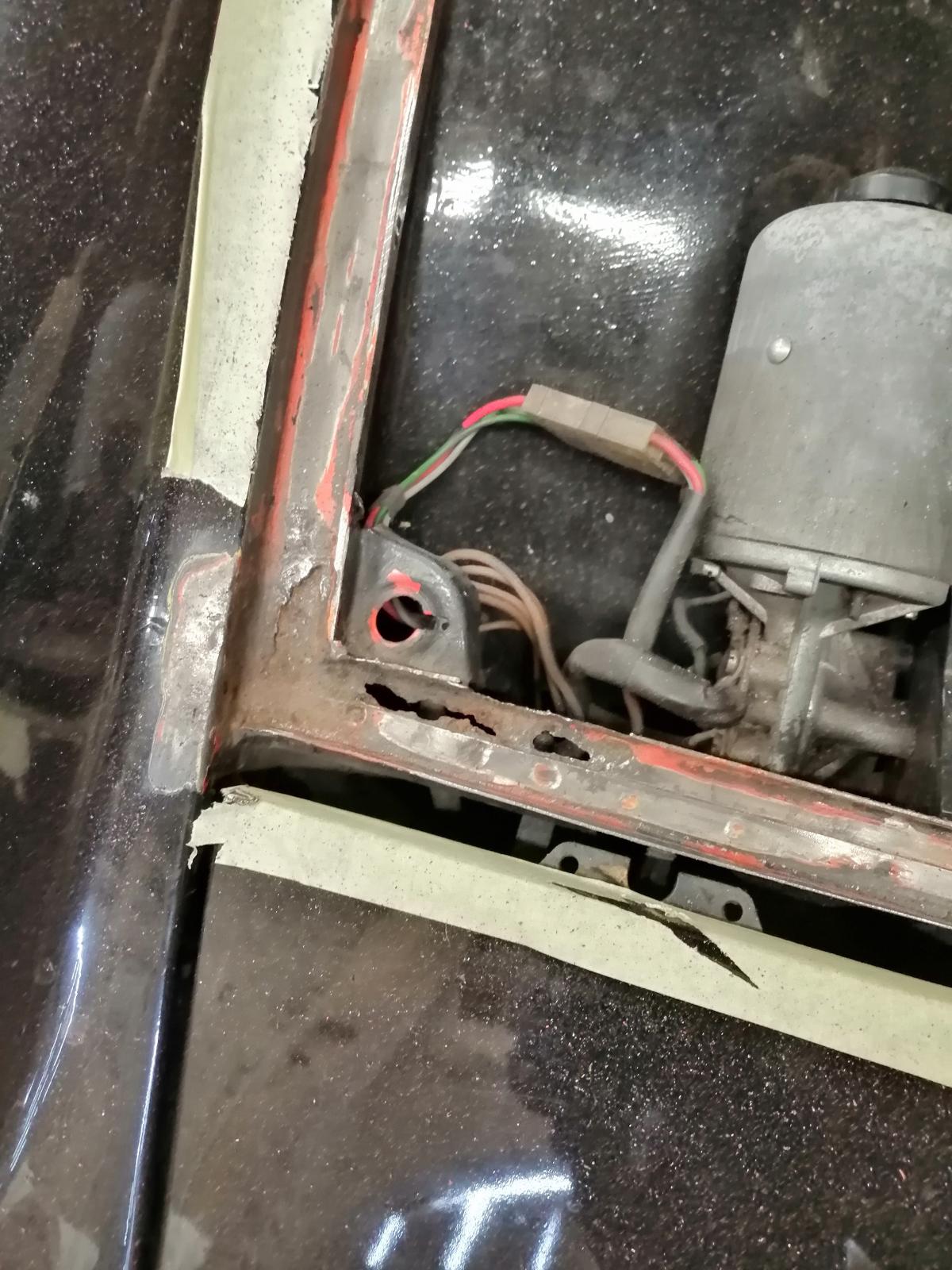

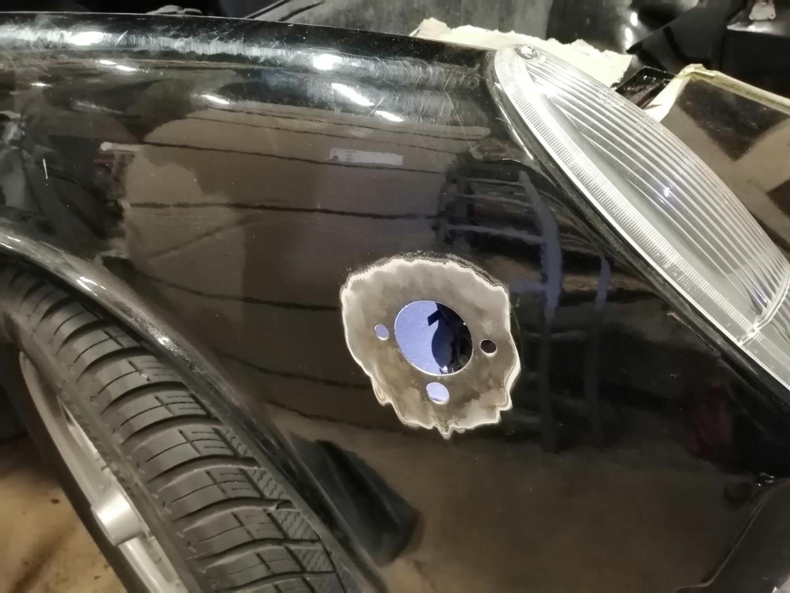

As I was already working on the front, I removed the side markers and the antenna (no radio on a lightweight project !) :
And started the first part for my B-Pillar:

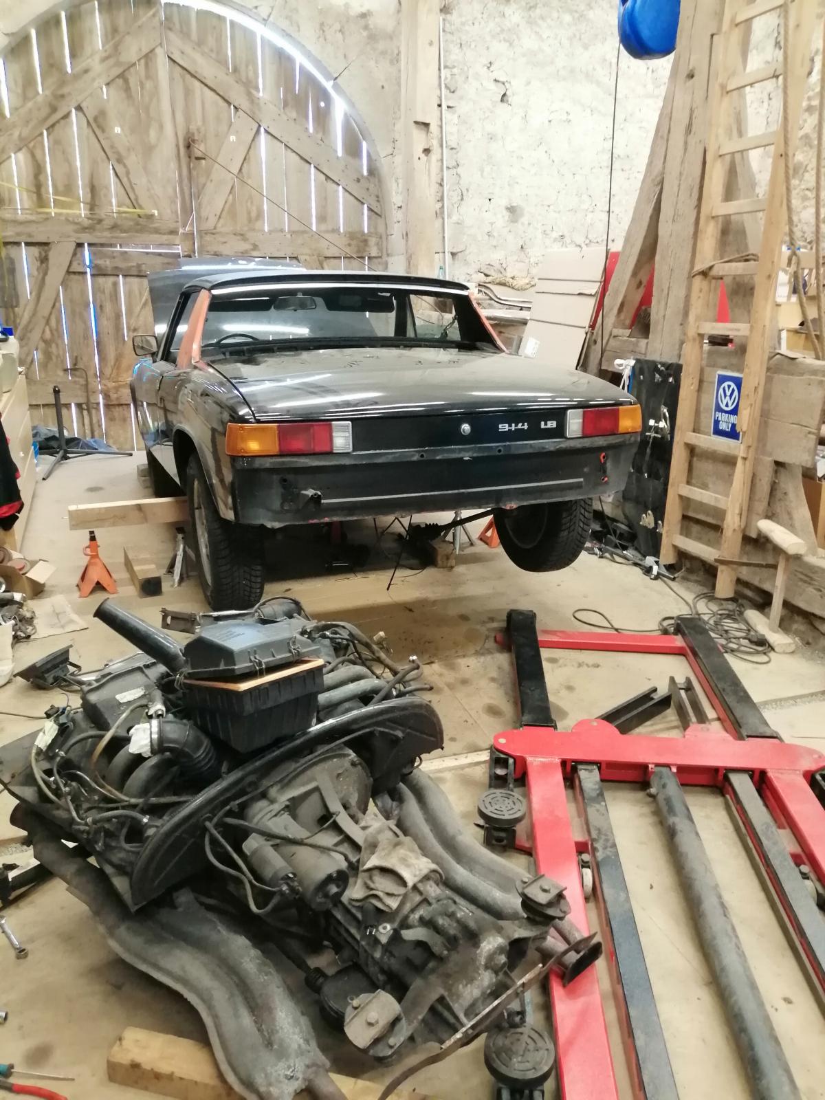

I put the rear up in the air:
And removed the engine :

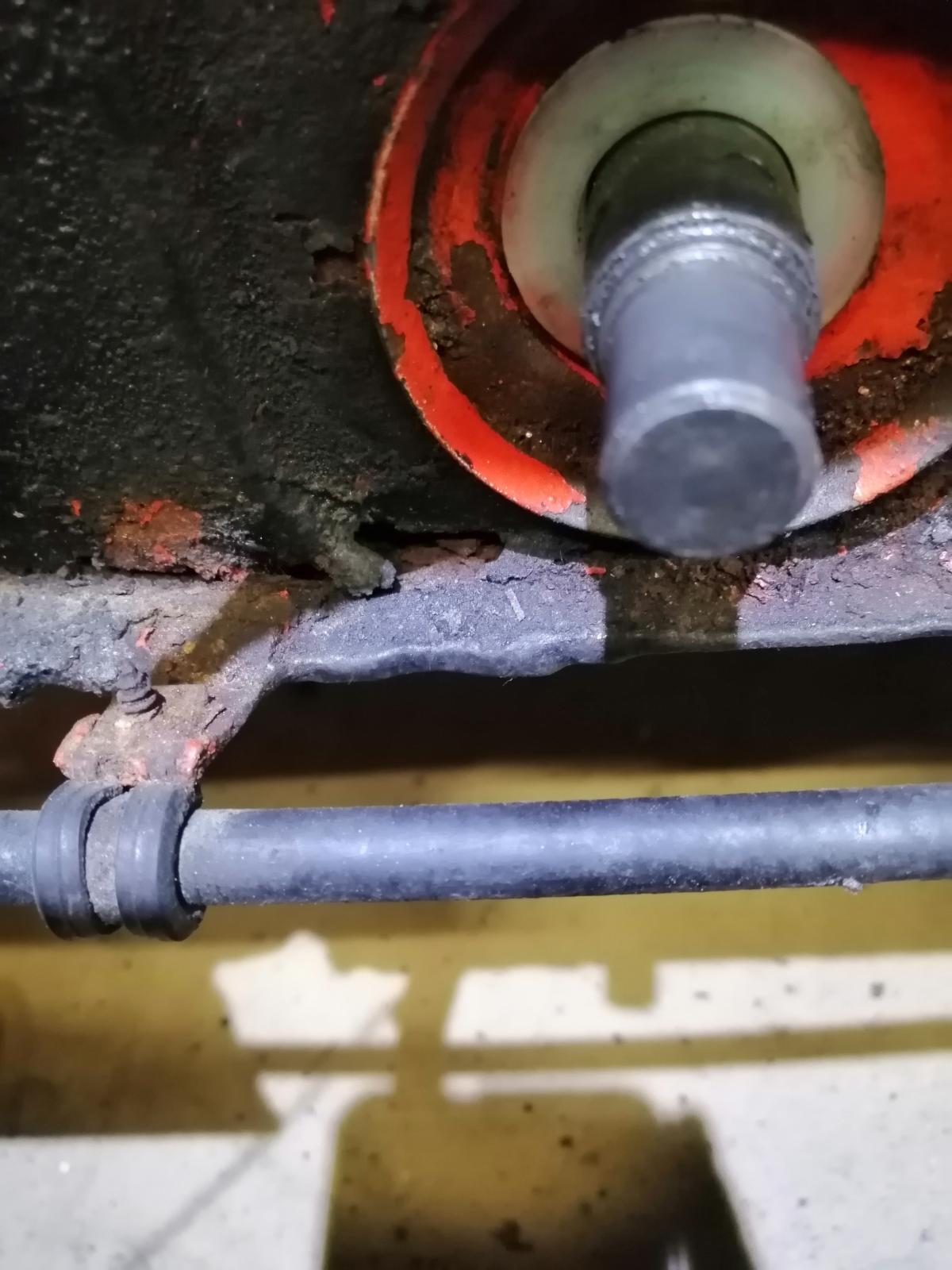

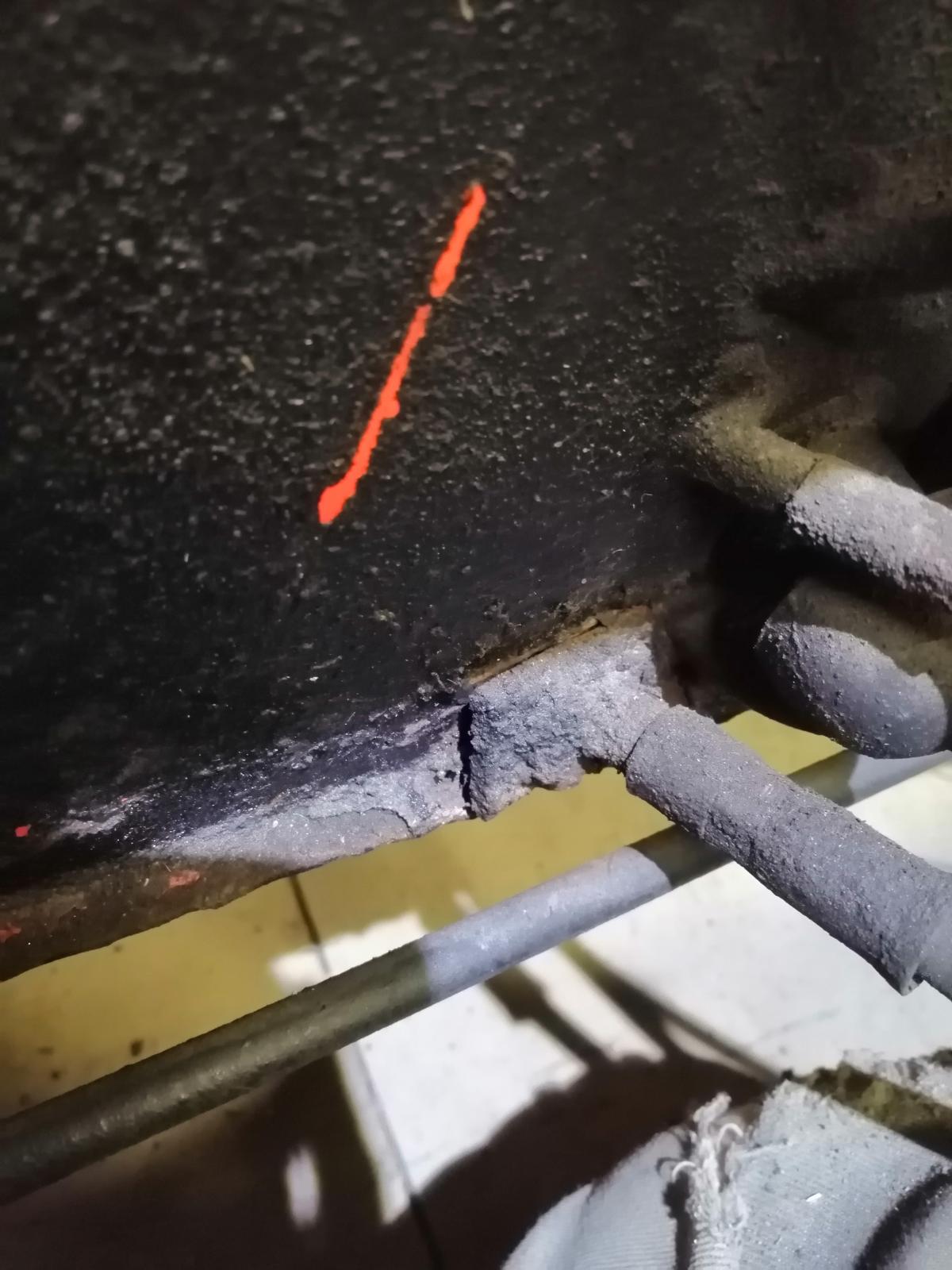

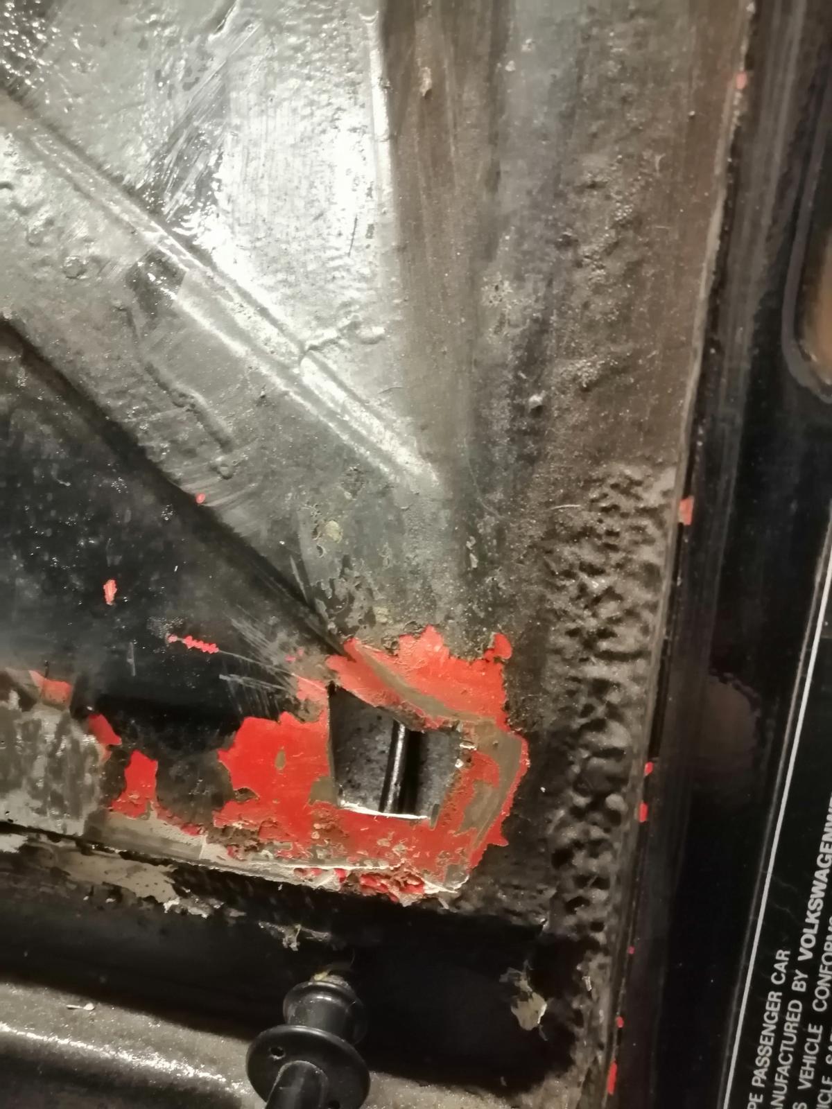

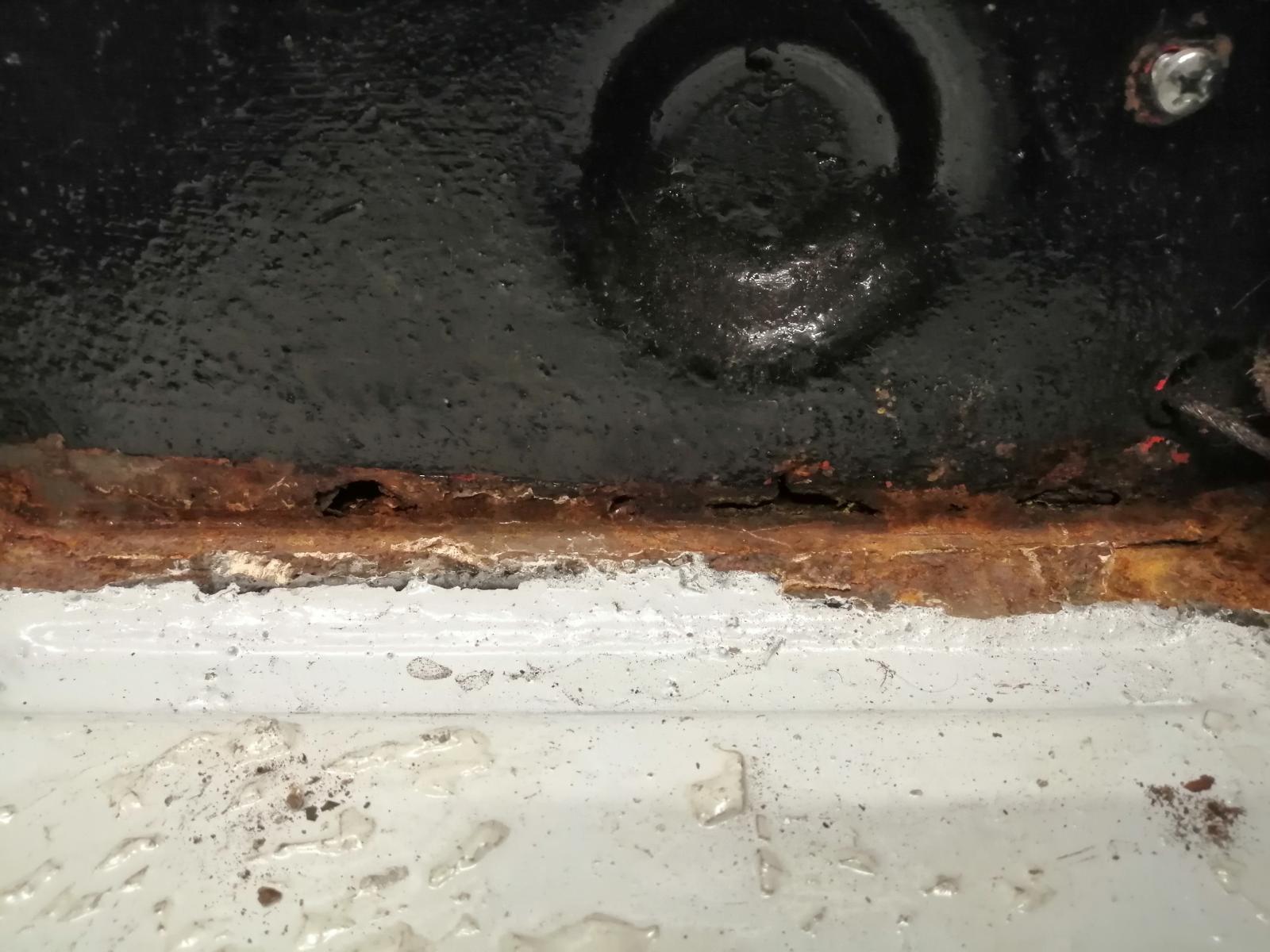

Found some rust here at the bottom of the firewall :
And what looked like a "sh**ty fix" for the clutch cable tube:
Is worse than that..the tube just moves freely like that!!

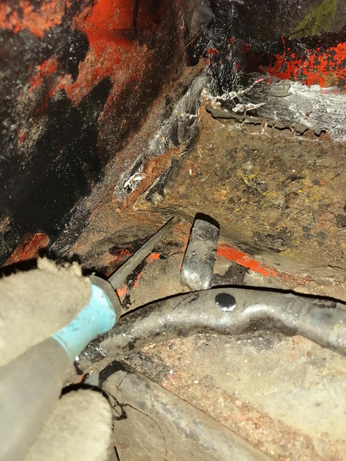

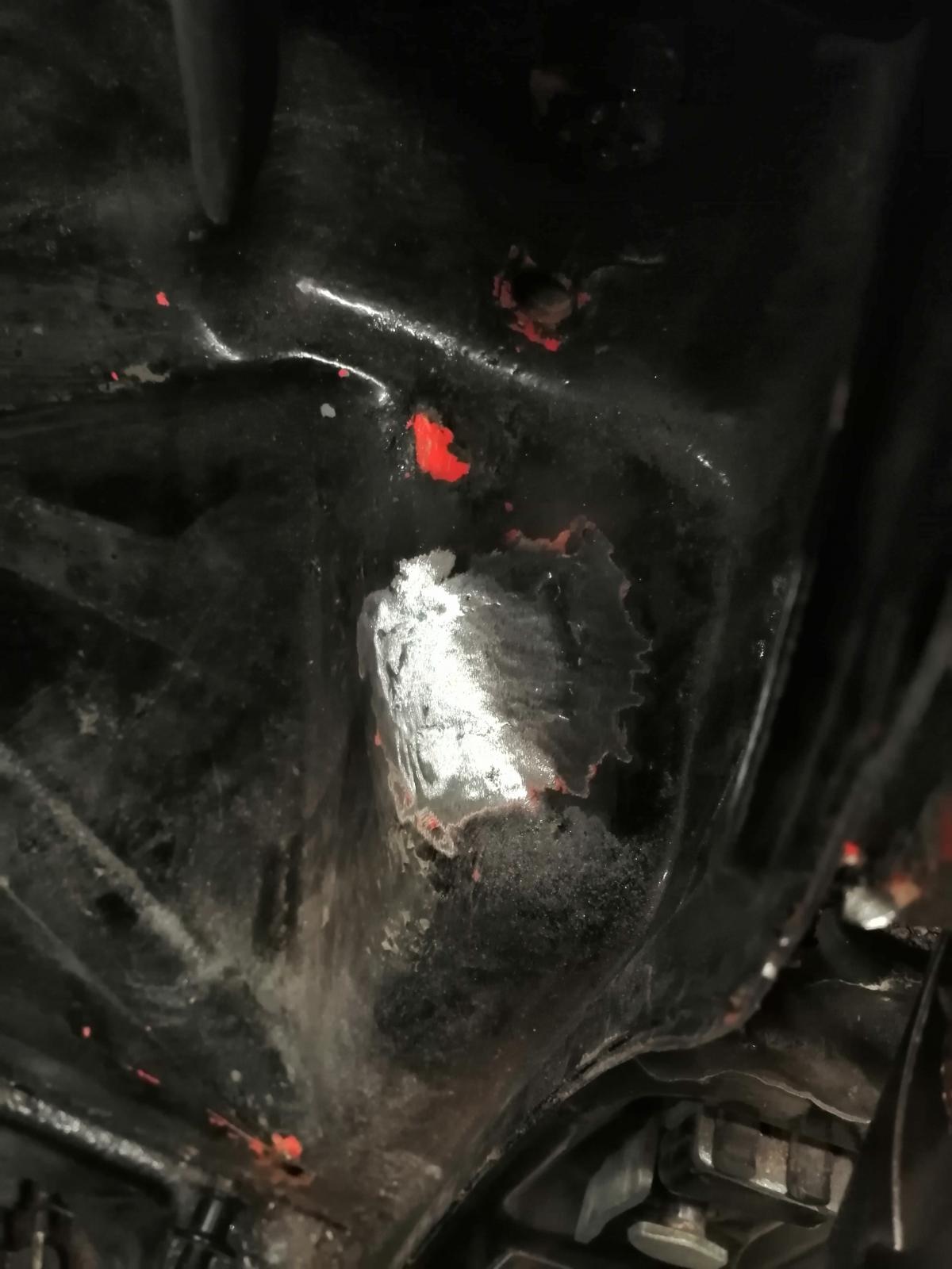

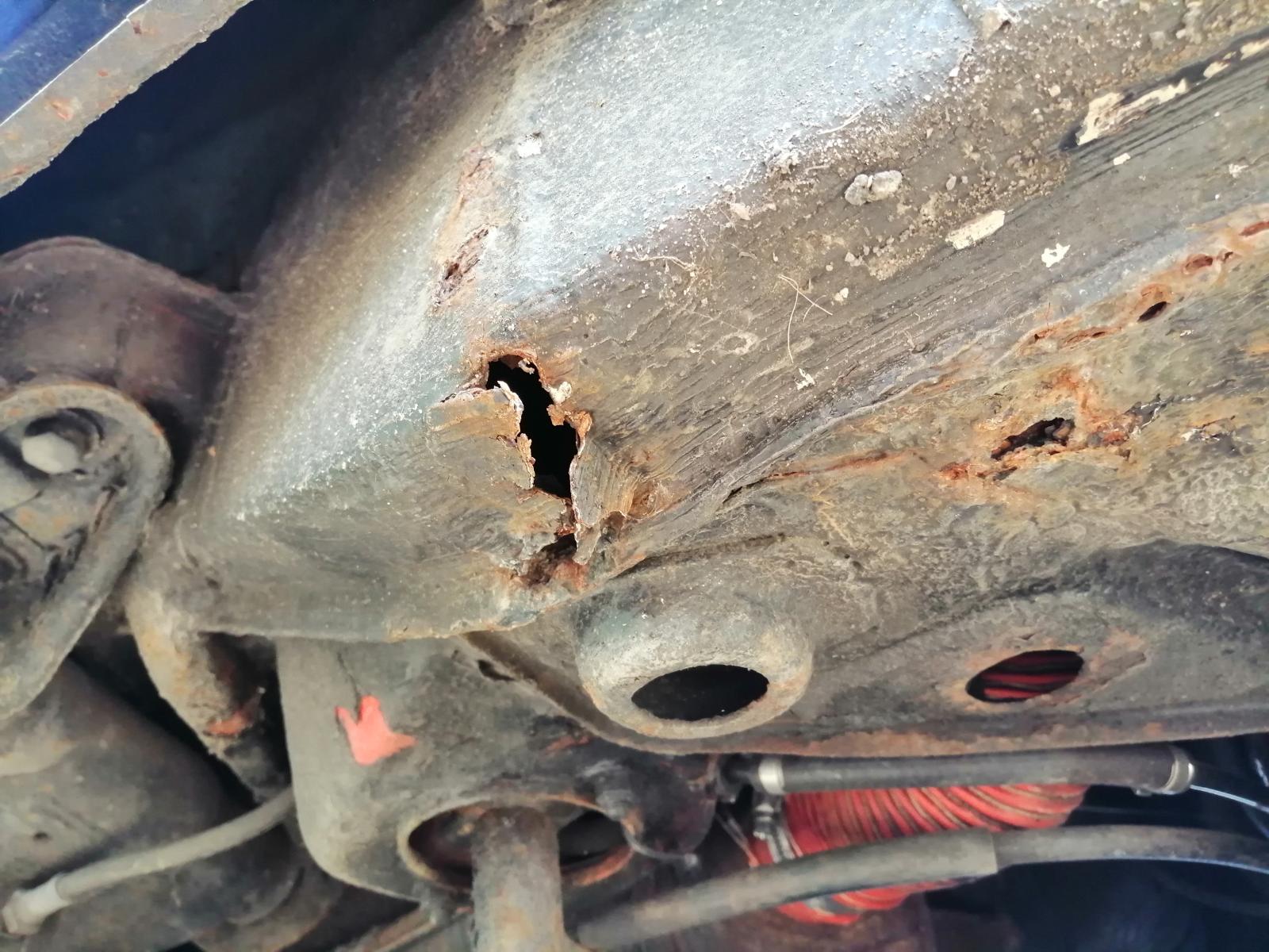

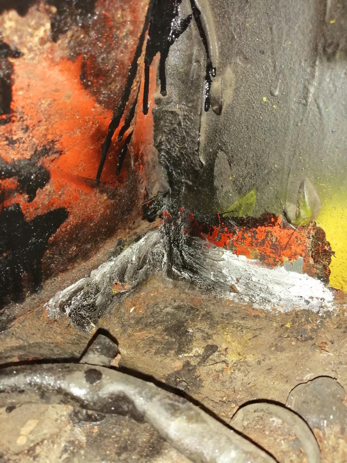

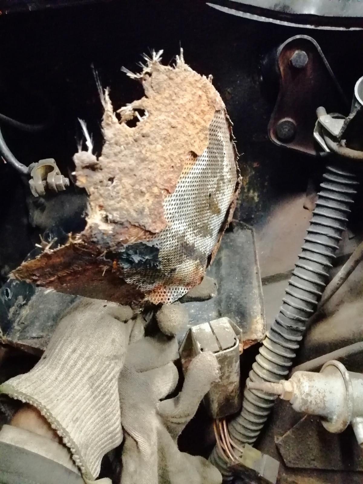

And the big question.. The hell hole.. Well, when I bought it, I couldn't disassemble much so I checked with my hand - no holes - and tried with a screwdriver-everything robust.. So I thought to be safe..
Then I checked after engine removal:
And after a better check with my screwdriver..
Here is what I found:
A real disaster:

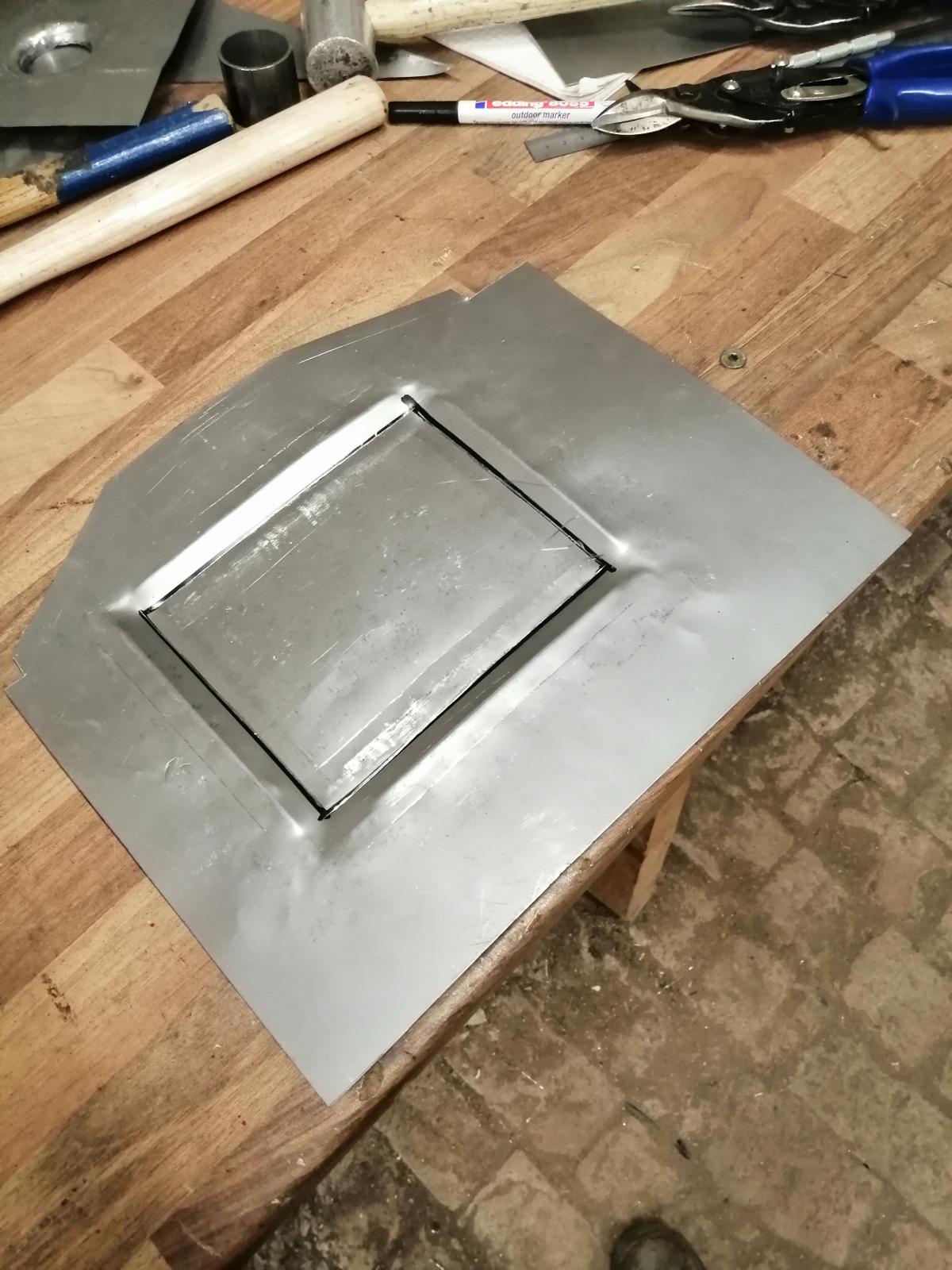

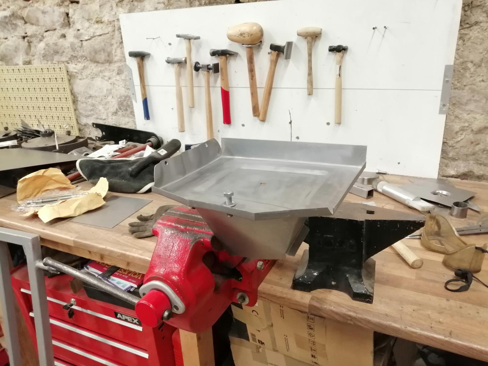

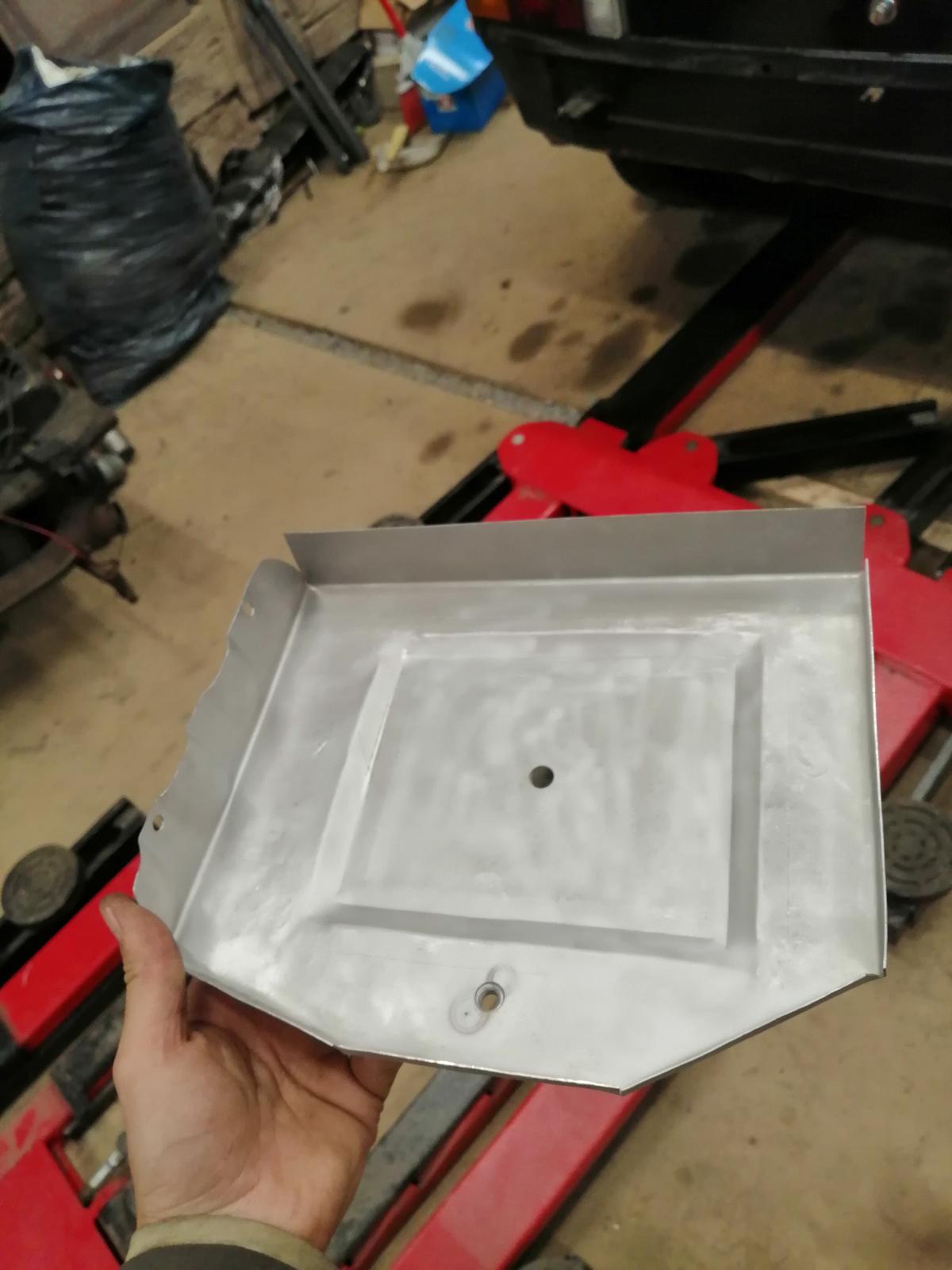

But I am not a guy that let something like that discorage himself. So I need to remove my battery tray to check further and make my plan.. But before that, and before probably destroying the old one by disassembling.. I built the replacement one:
Check with the battery and the fixation sandblasted:
And the bottom part:
Ready to go after the hell hole repair:

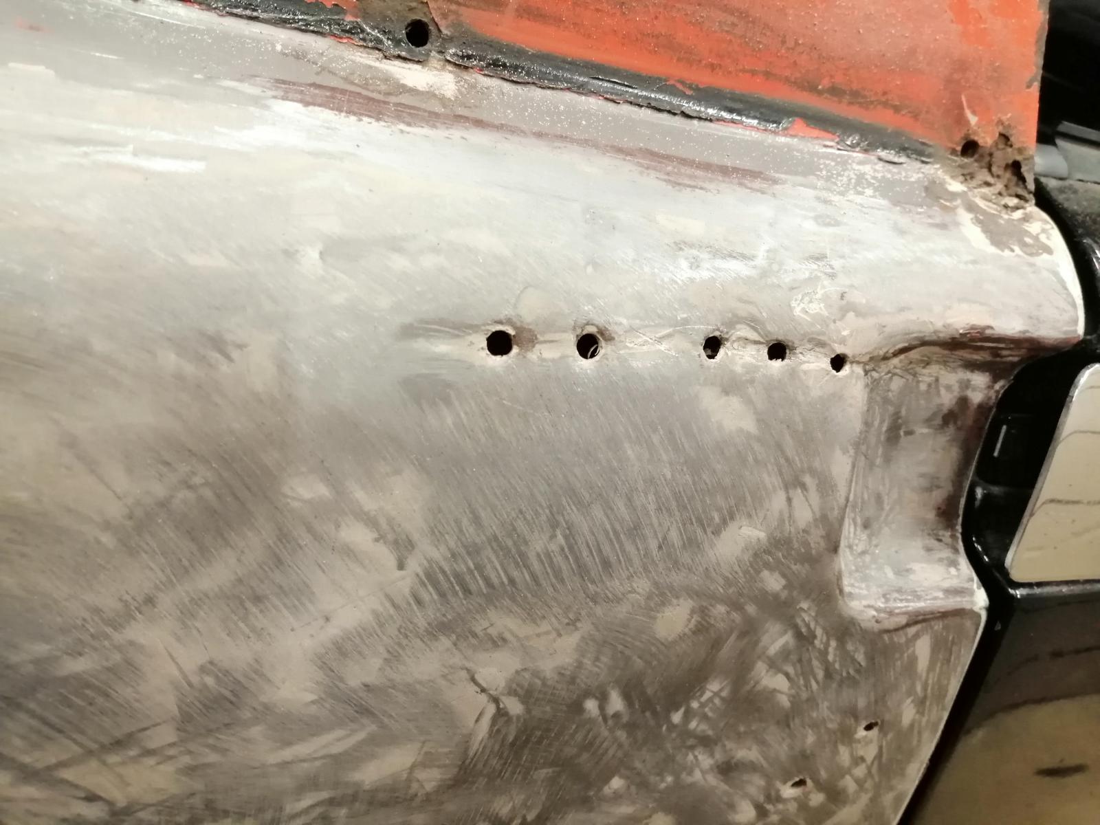

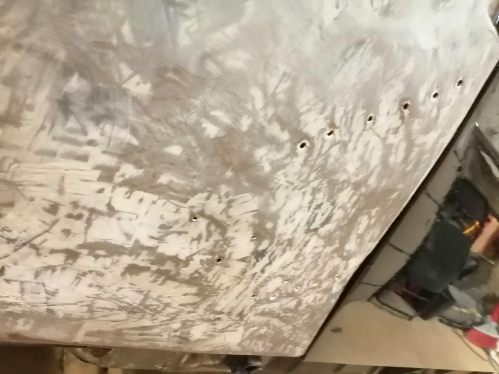

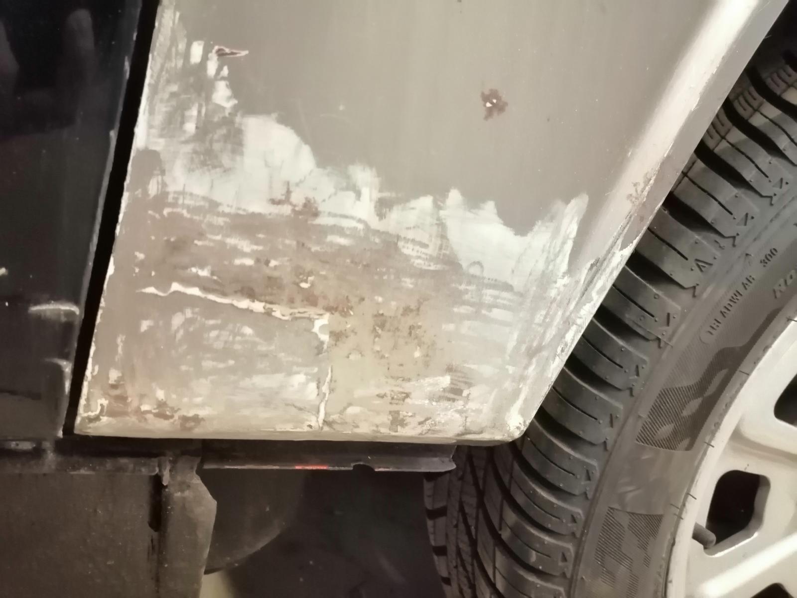

As I already did start the work on the front, I decided to make sûre nothing is hidden there under the paint..

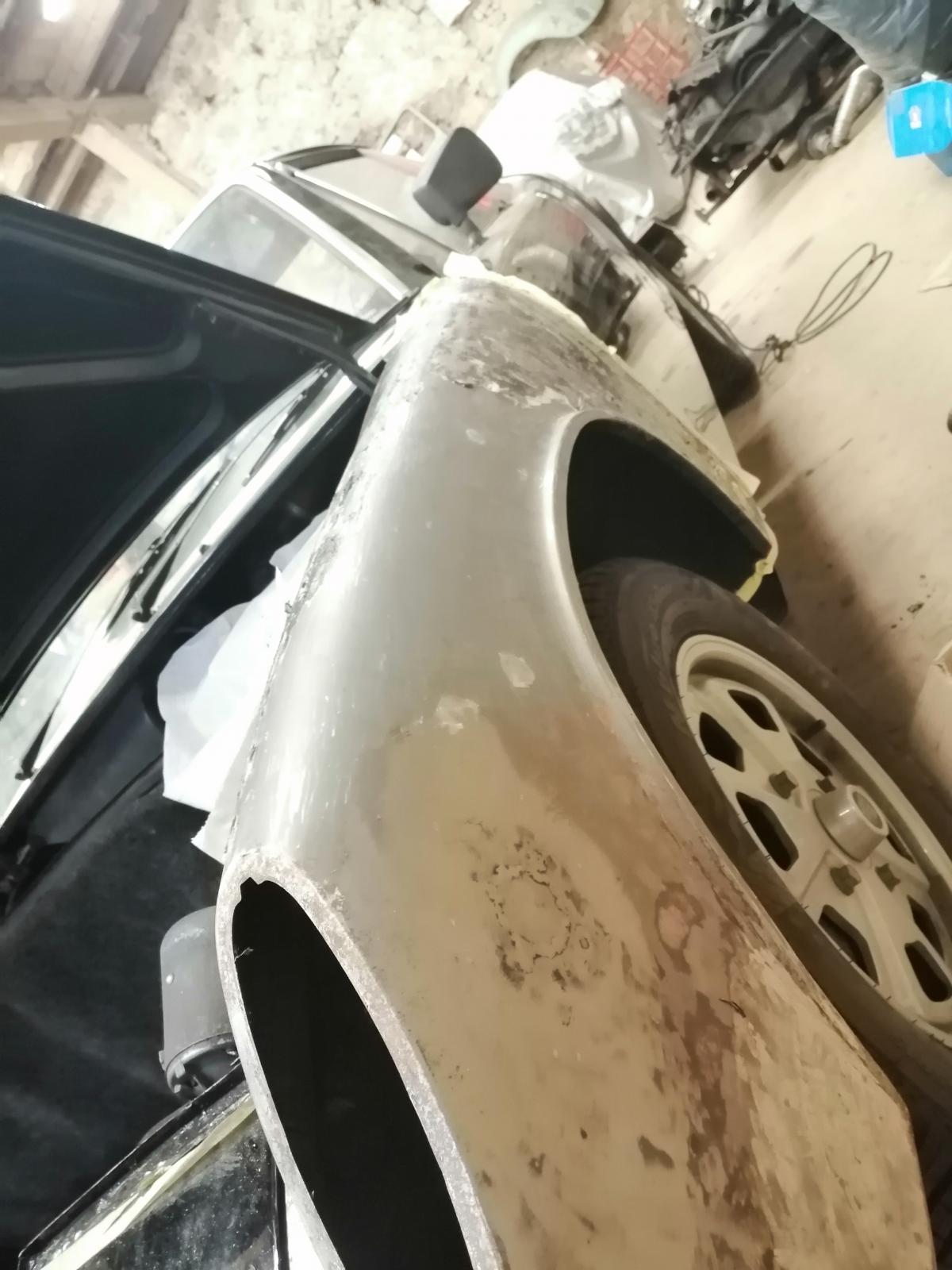

Well of course some (bondo-) surprises were there...

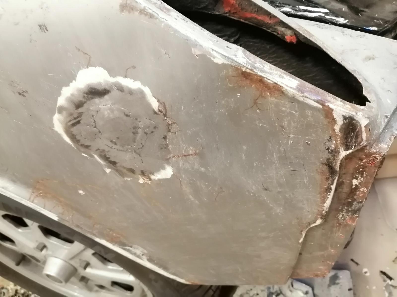

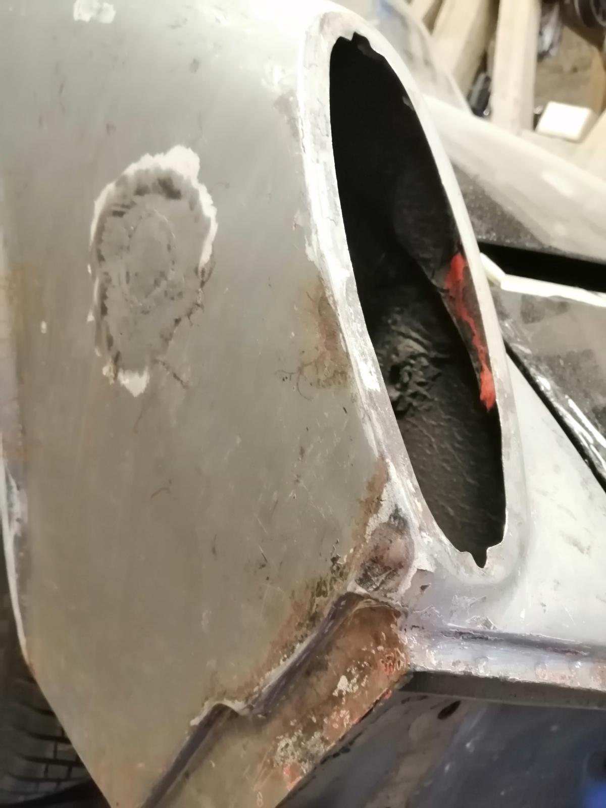

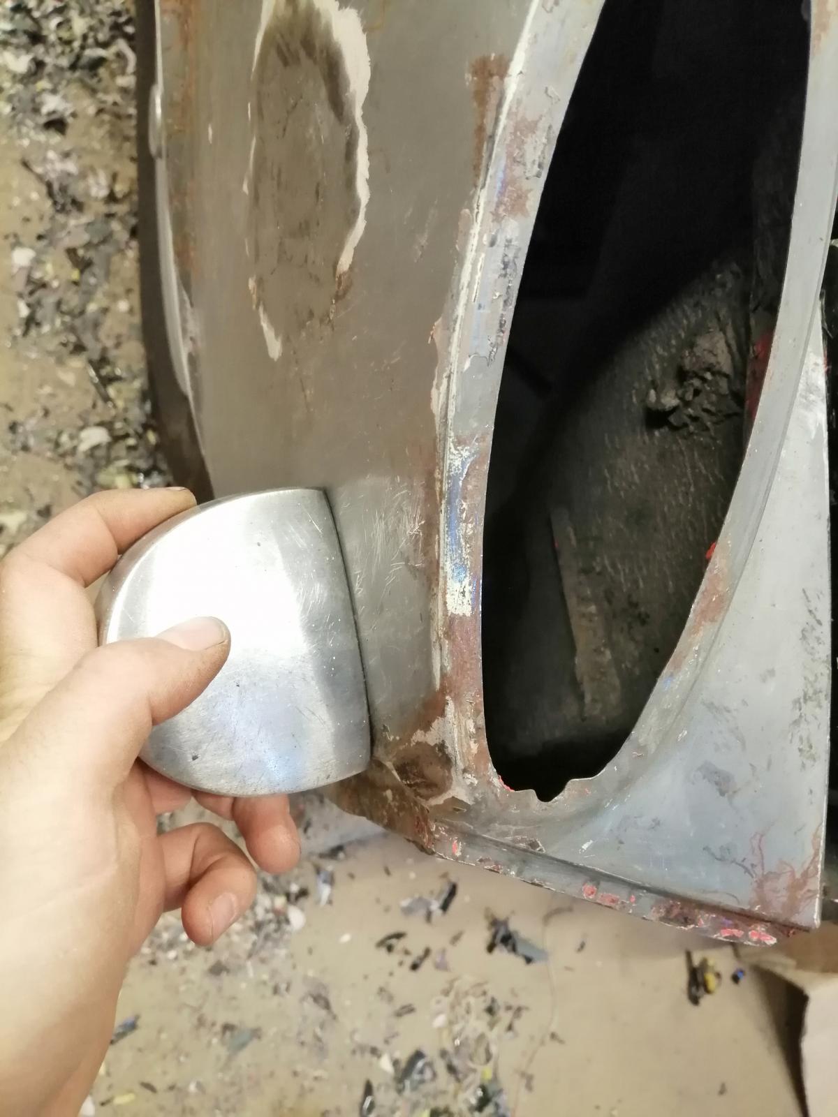

Here a big dent, that I took care of using dolly/hammer:

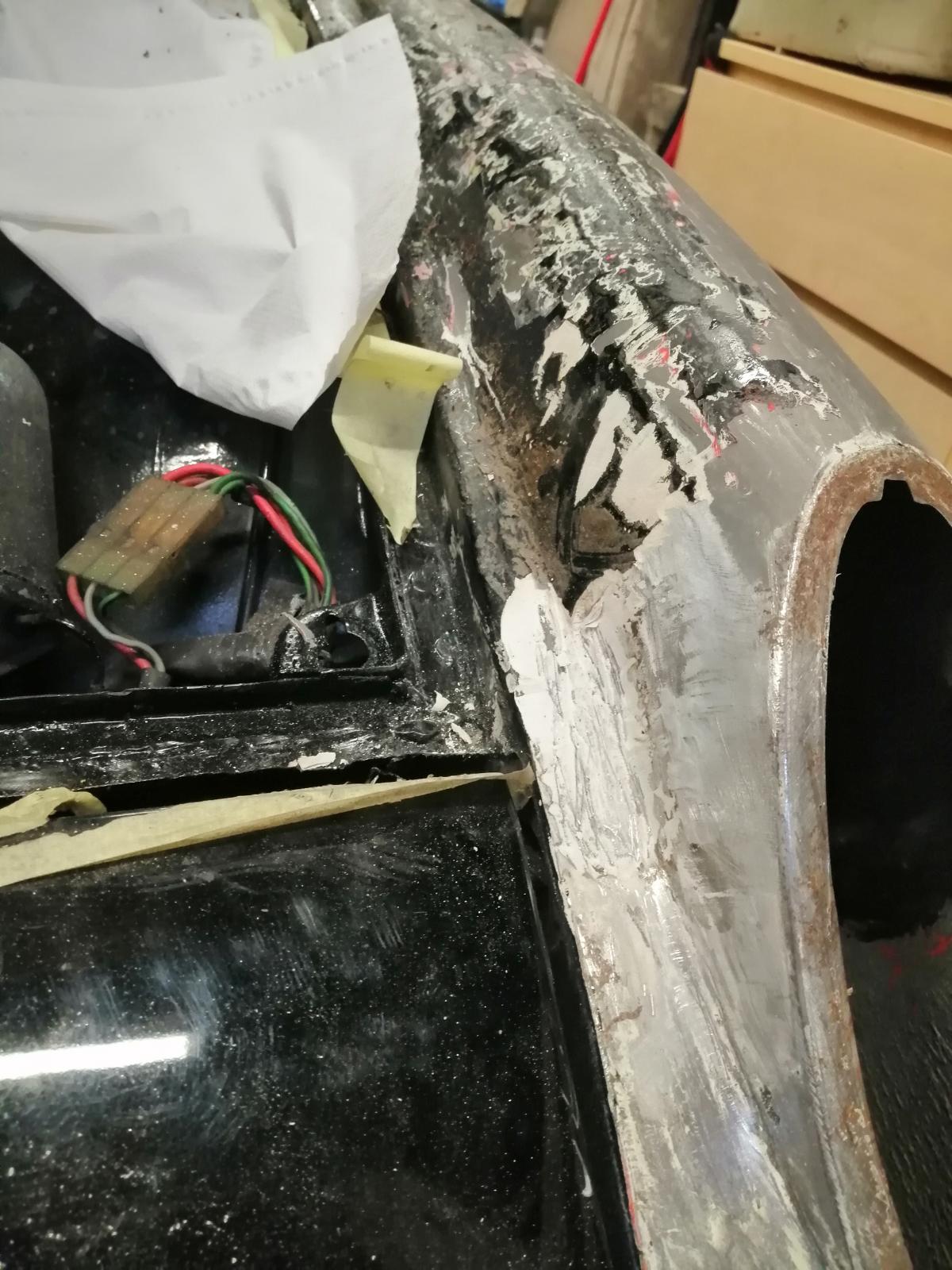

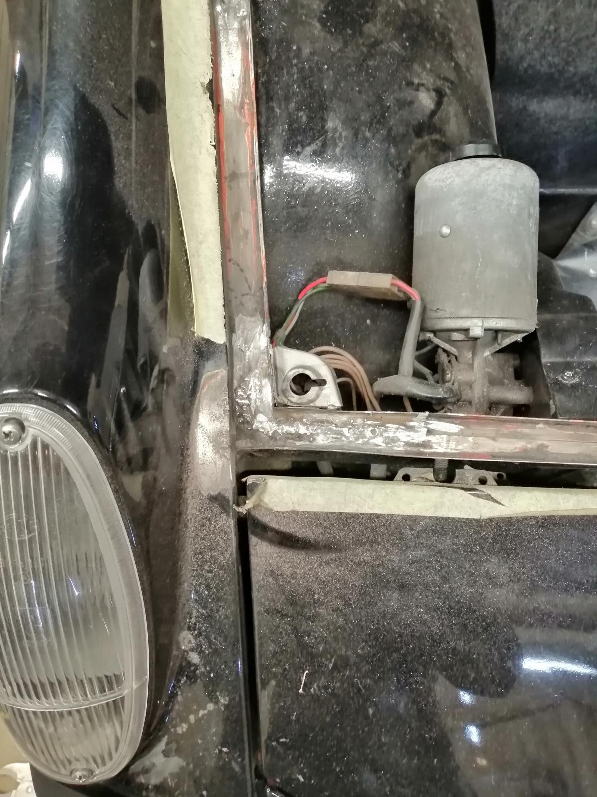

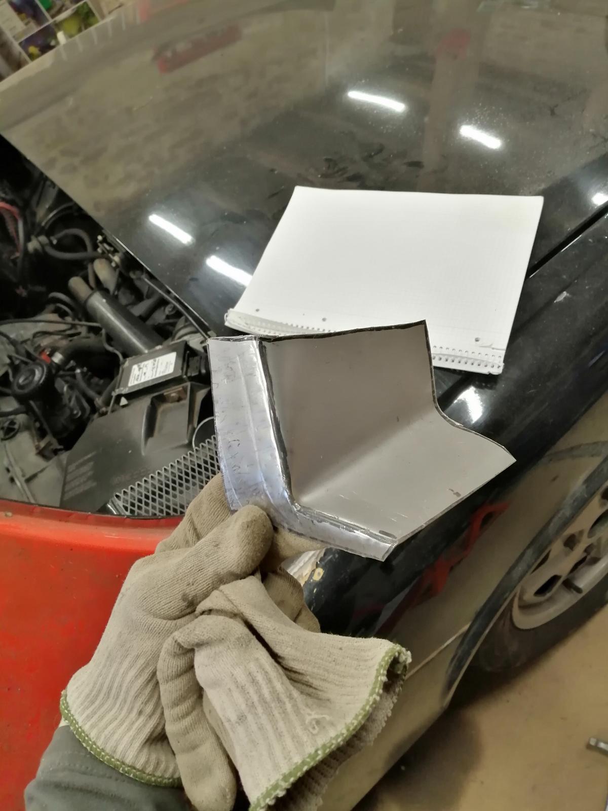

And here.. There was a lot of bondo and under it a "fix", by the way of a plate under the rust hole.. Here to see:
So I of course couldn't let it, so cut this bad work:
And TIG welded a real patch:
And put it in primer:
Same on the other side :

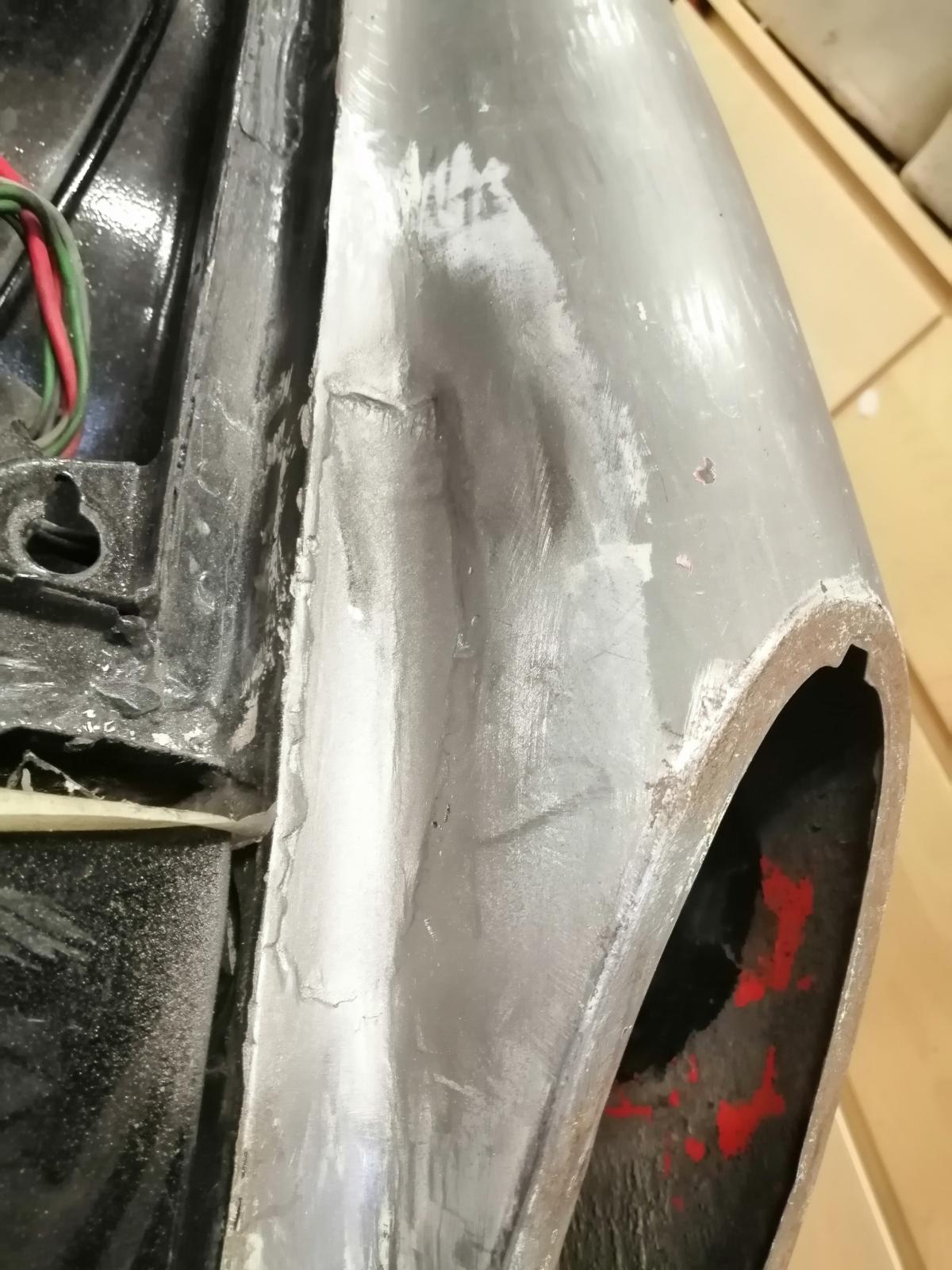

Big dent here was hidden under bondo:
So dolly/hammer:

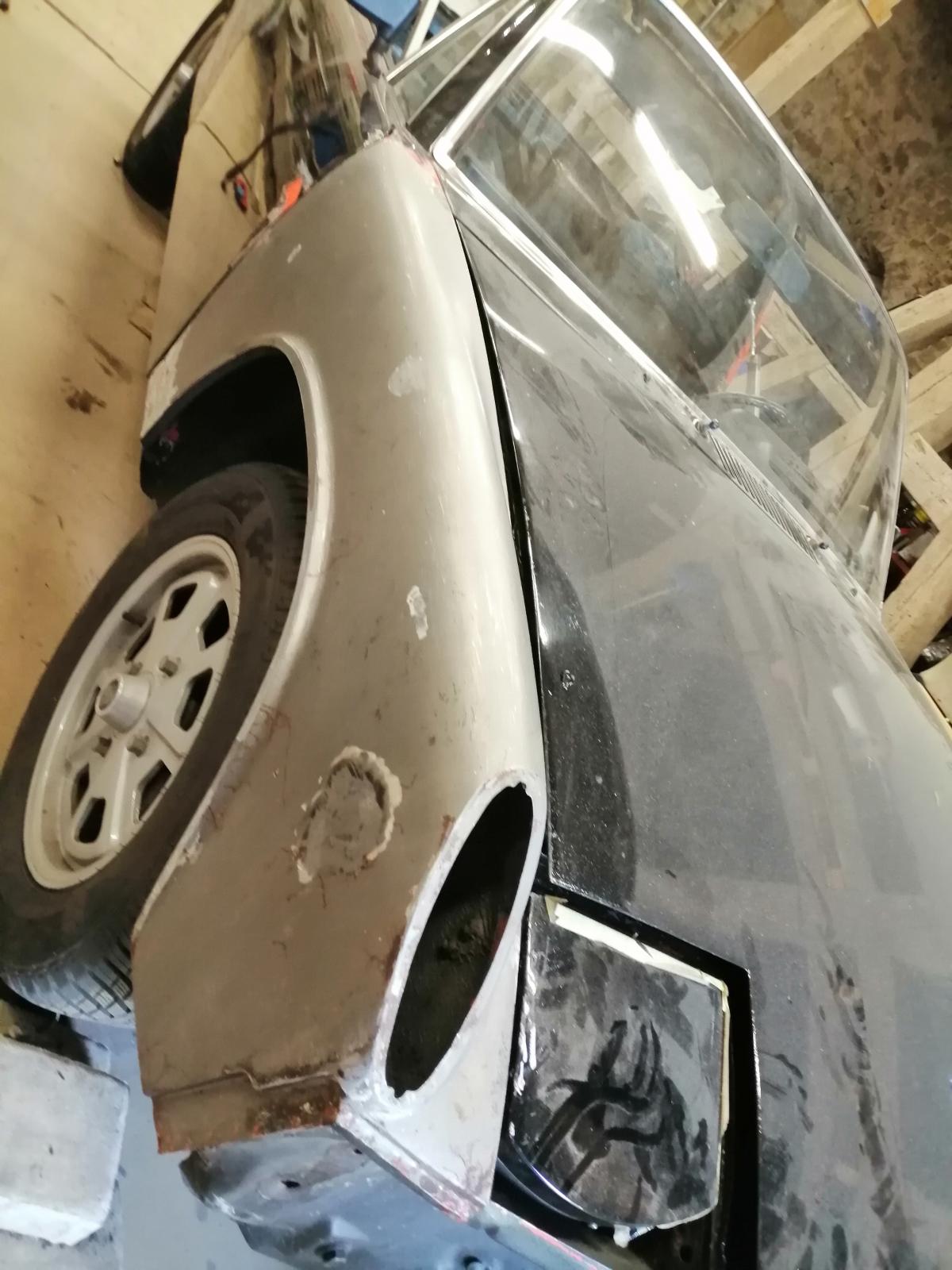

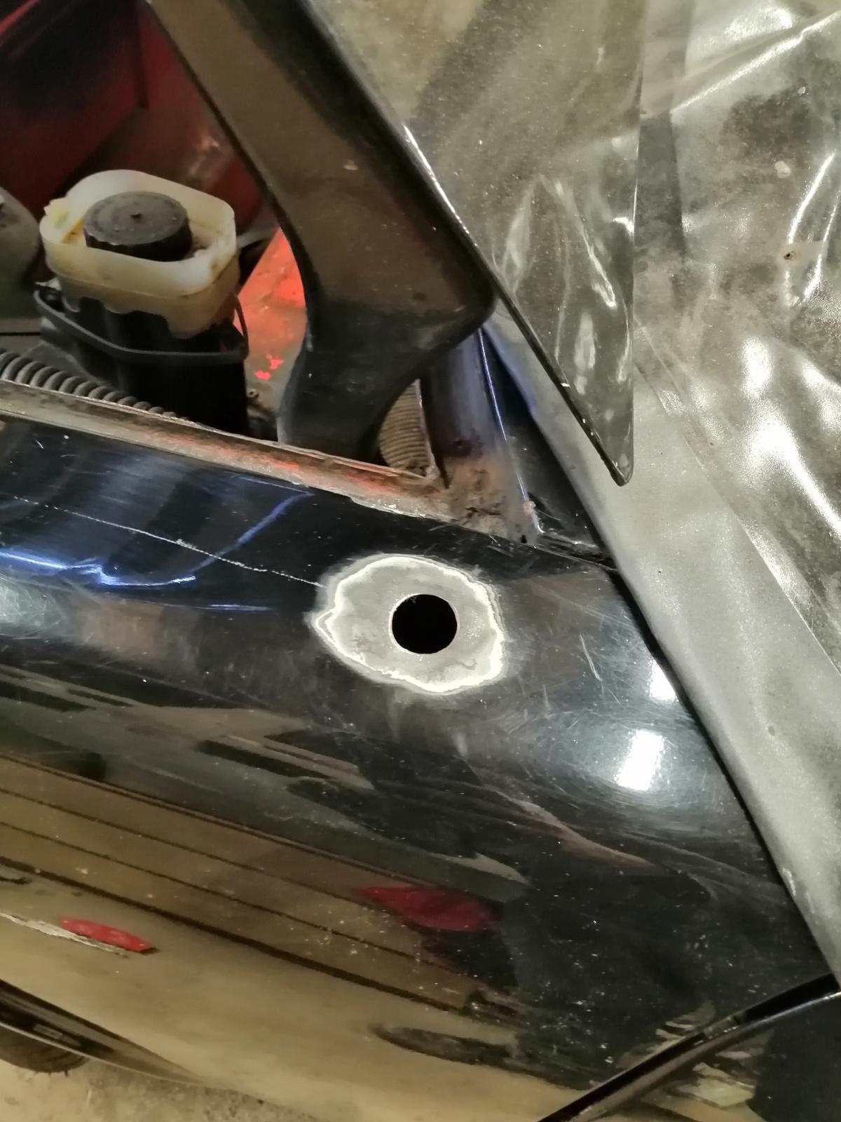

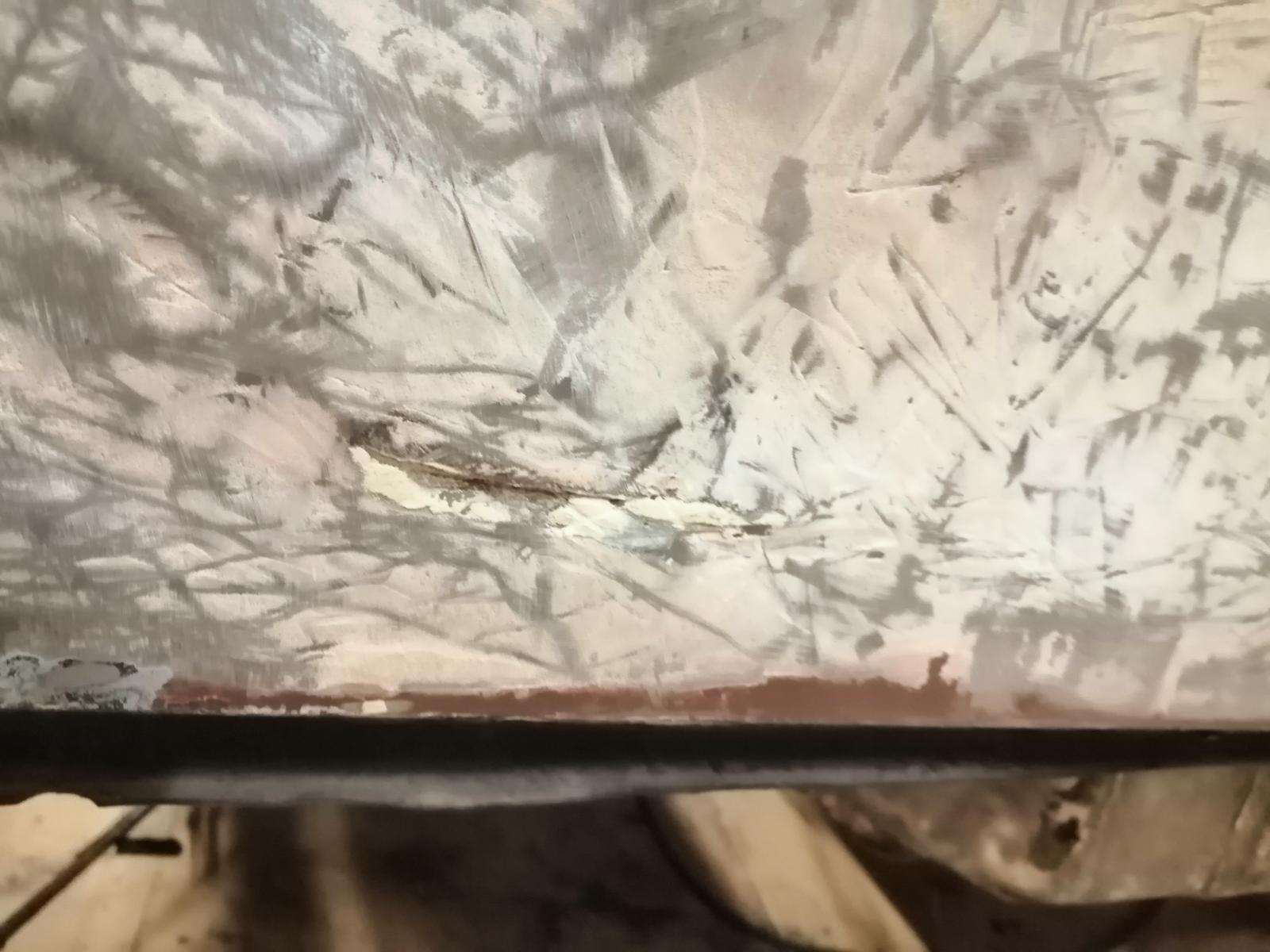

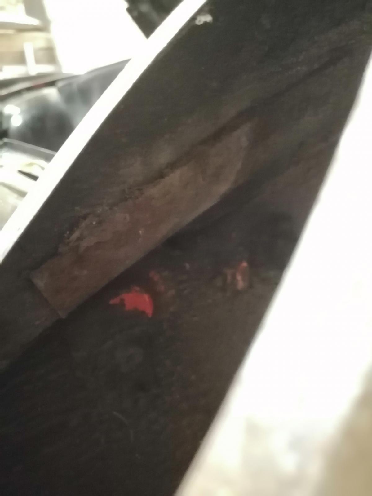

And in the back there was also a surprise:
Yes, again a plate welded quite behind the panel.. And on the bottom not welded :
So.. Patch prepared :
Now we are flat:
Stay tuned, work is ongoing here!

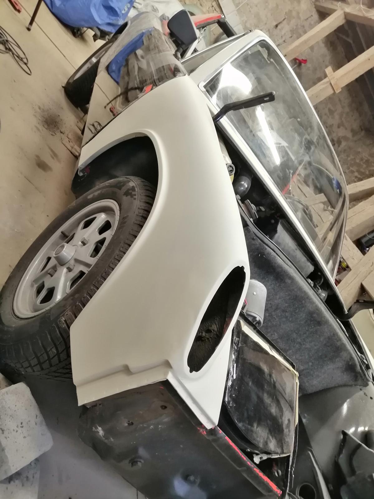

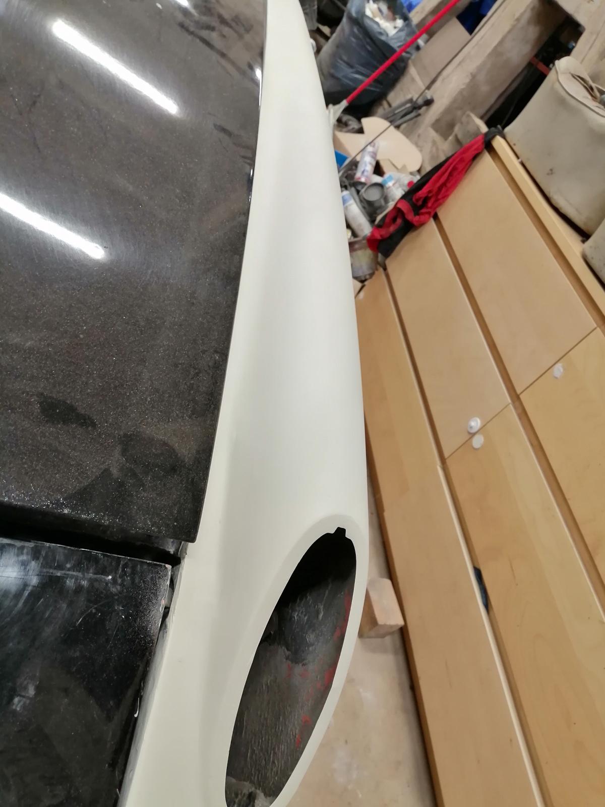

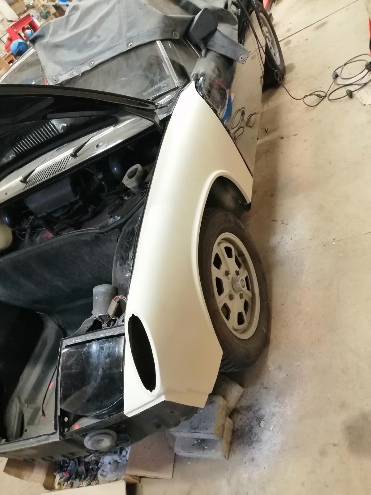

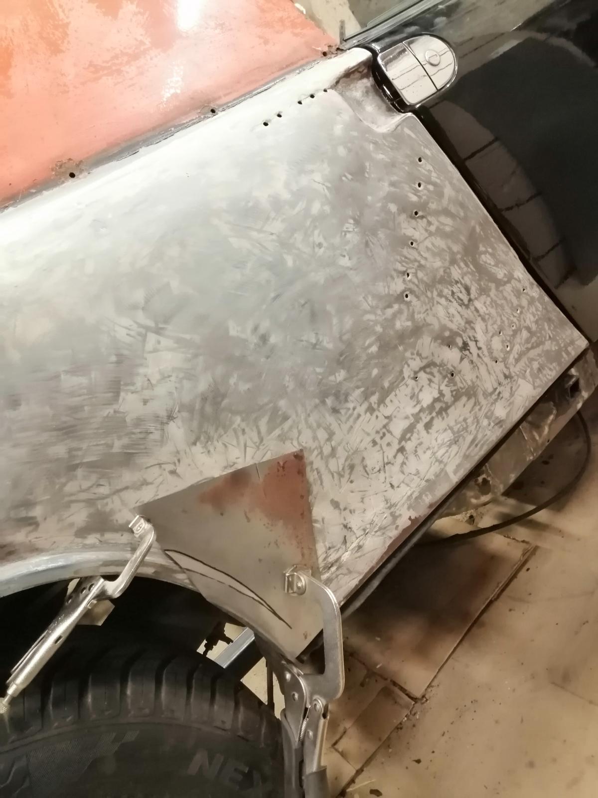

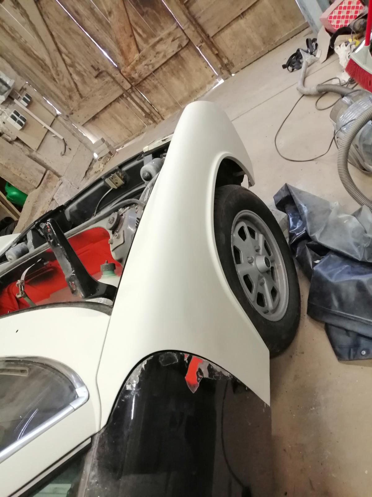

So, that was the next logical step..primer on the passenger side fender (and all around the windshield after taking it also to bare metal) :

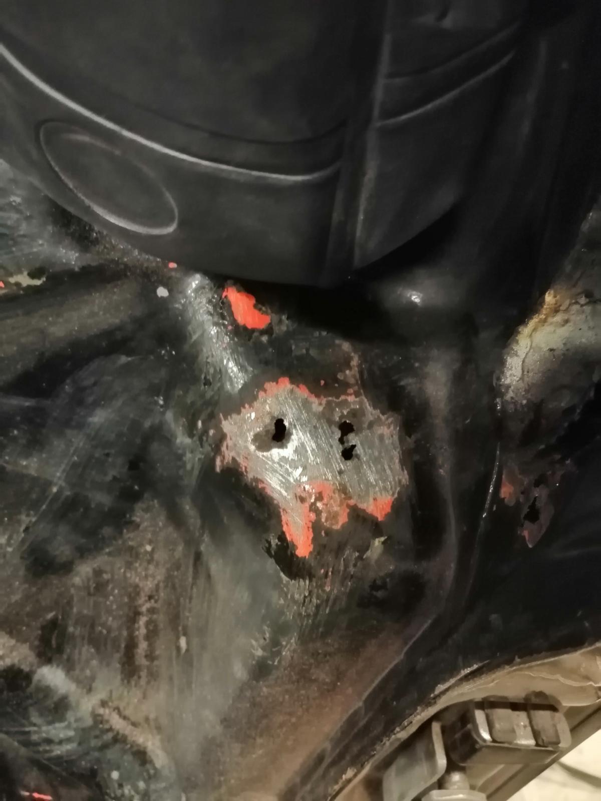

And I took care of a few holes on the driver's side firewall:

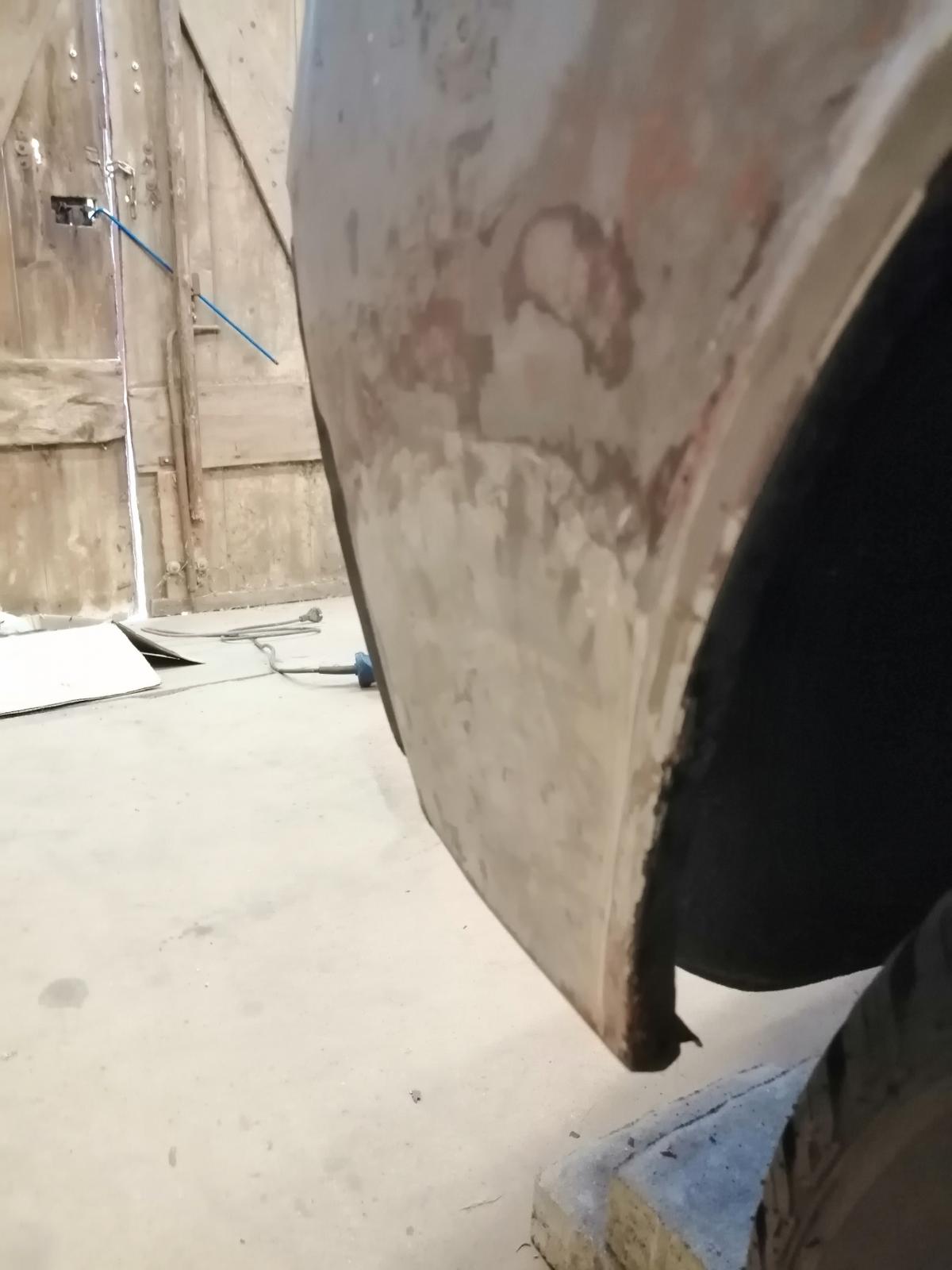

Before starting the body frame /hell hole fix, I wanted to check how the quarter is (part of me knowing I might have to cut it to repair right the right long).. Here the result, quite impressive..

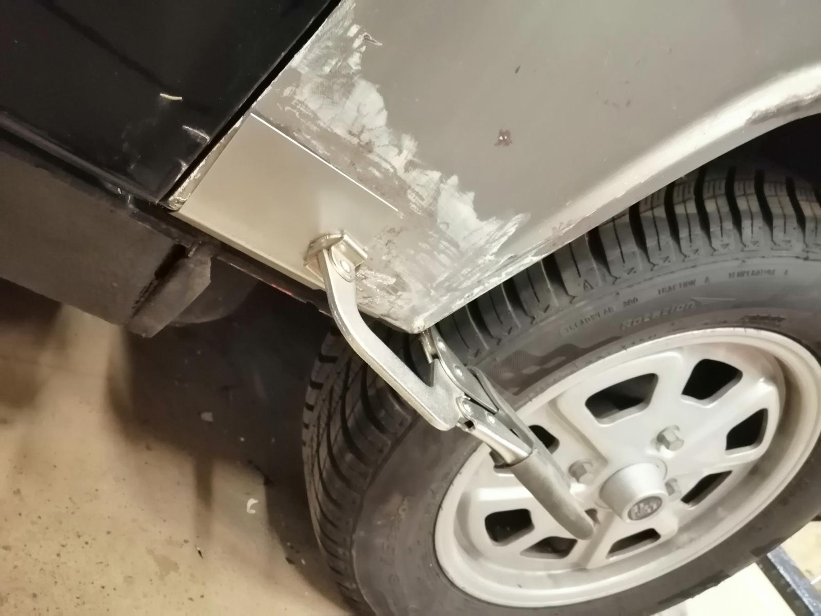

So now I know it.. I will build from scratch that quarter panel and cut it, repair the long, weld my new panel.

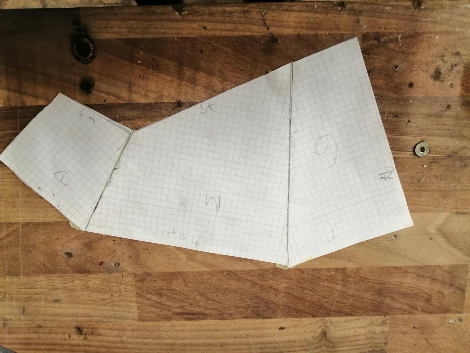

Just for fun I made a small test panel to try the shape of the wheel opening:

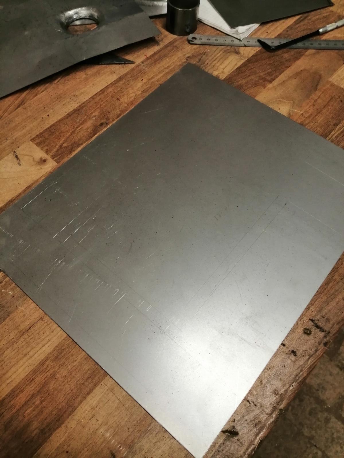

But I hadn't a large enough sheet metal piece to start on the quarter panel so I starte on my body frame..
Fresh metal came:
Welded the long part:
Rest will follow with all the fixations I planned (bumpers, engine, gearbox, front axle, back axle,..) to keep the body square du ring welding.
