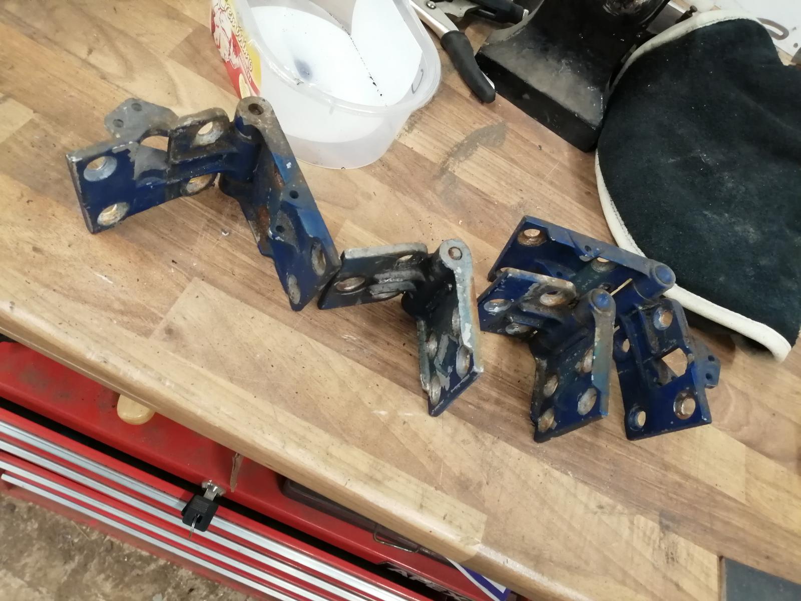

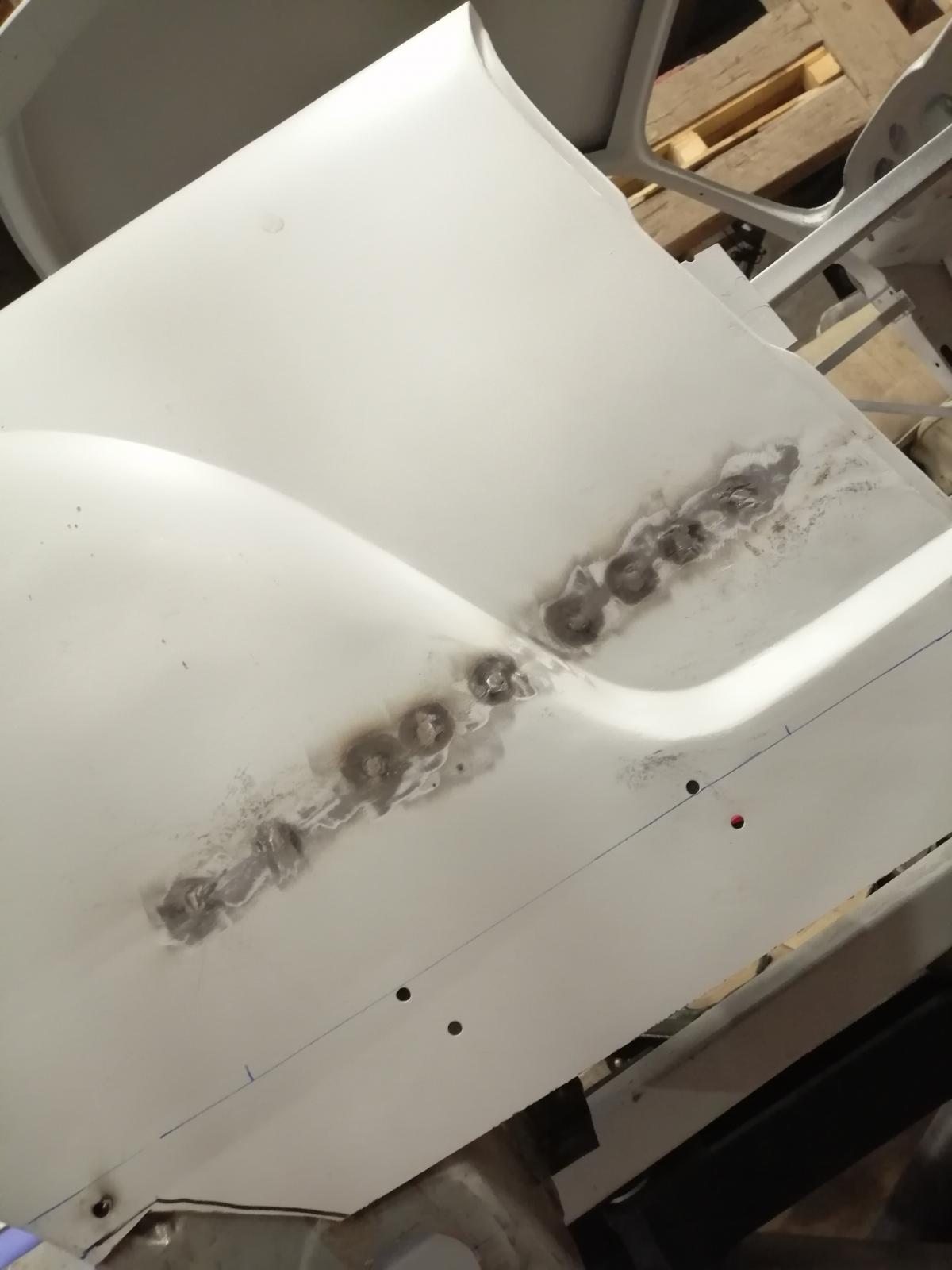

So, before I continue with the metal work, a small part update, as I removed my door hinges:
3 of them are really good, with no play, one has a light play and will need new bushings. And all of them need a cosmetic restoration ����

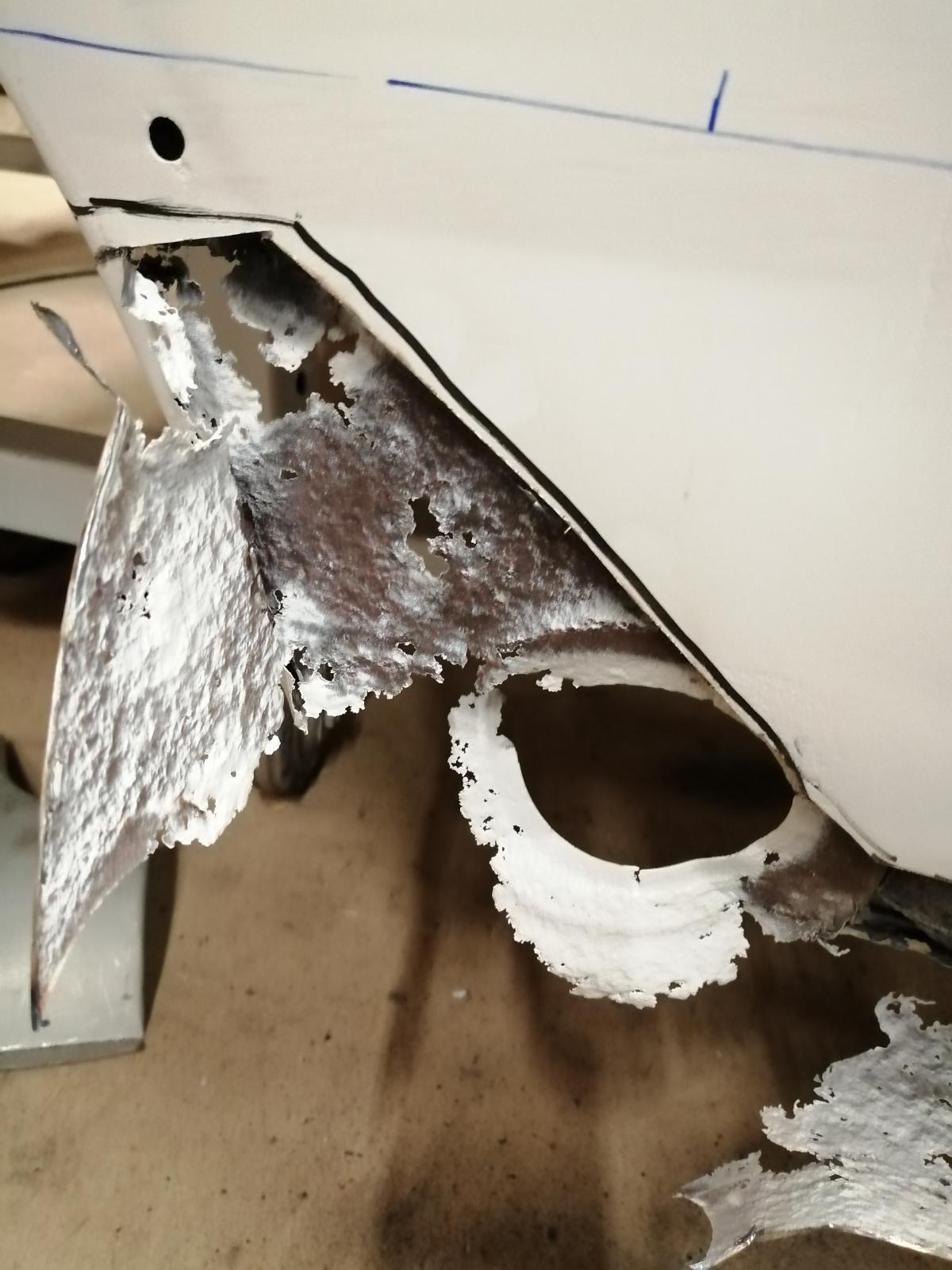

Then back in the right back corner, I luckily have more to show ��

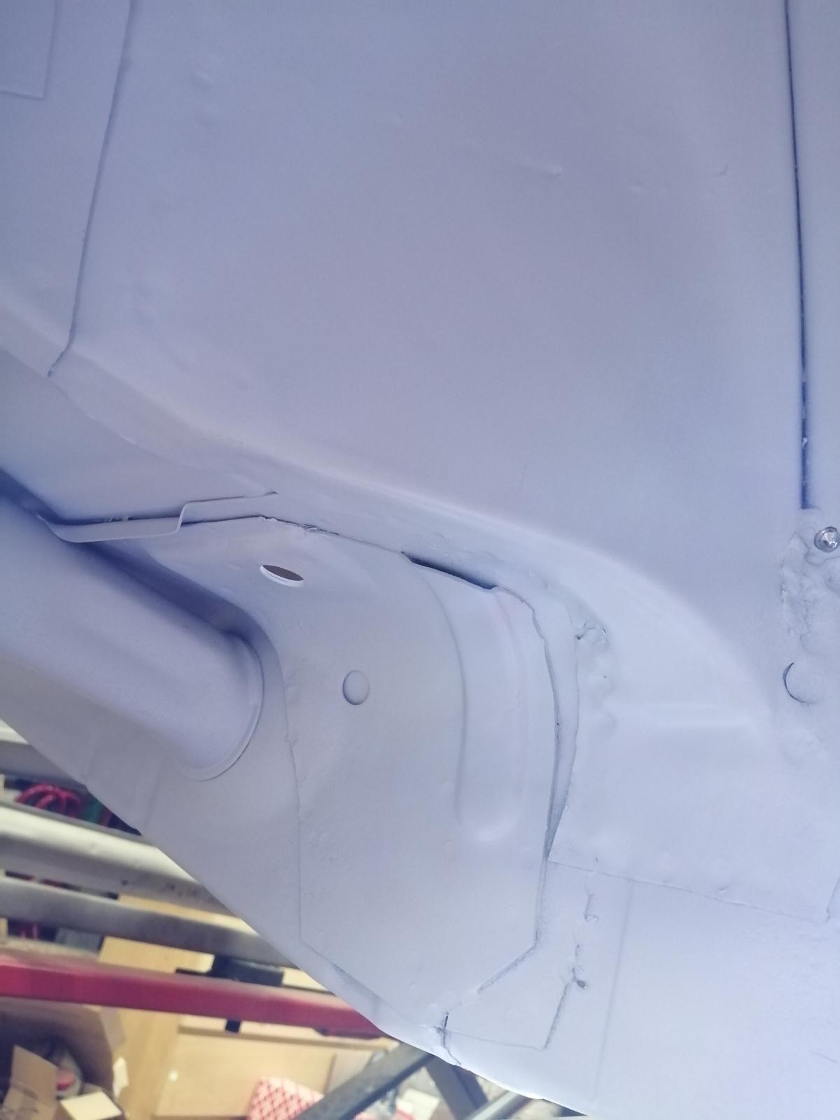

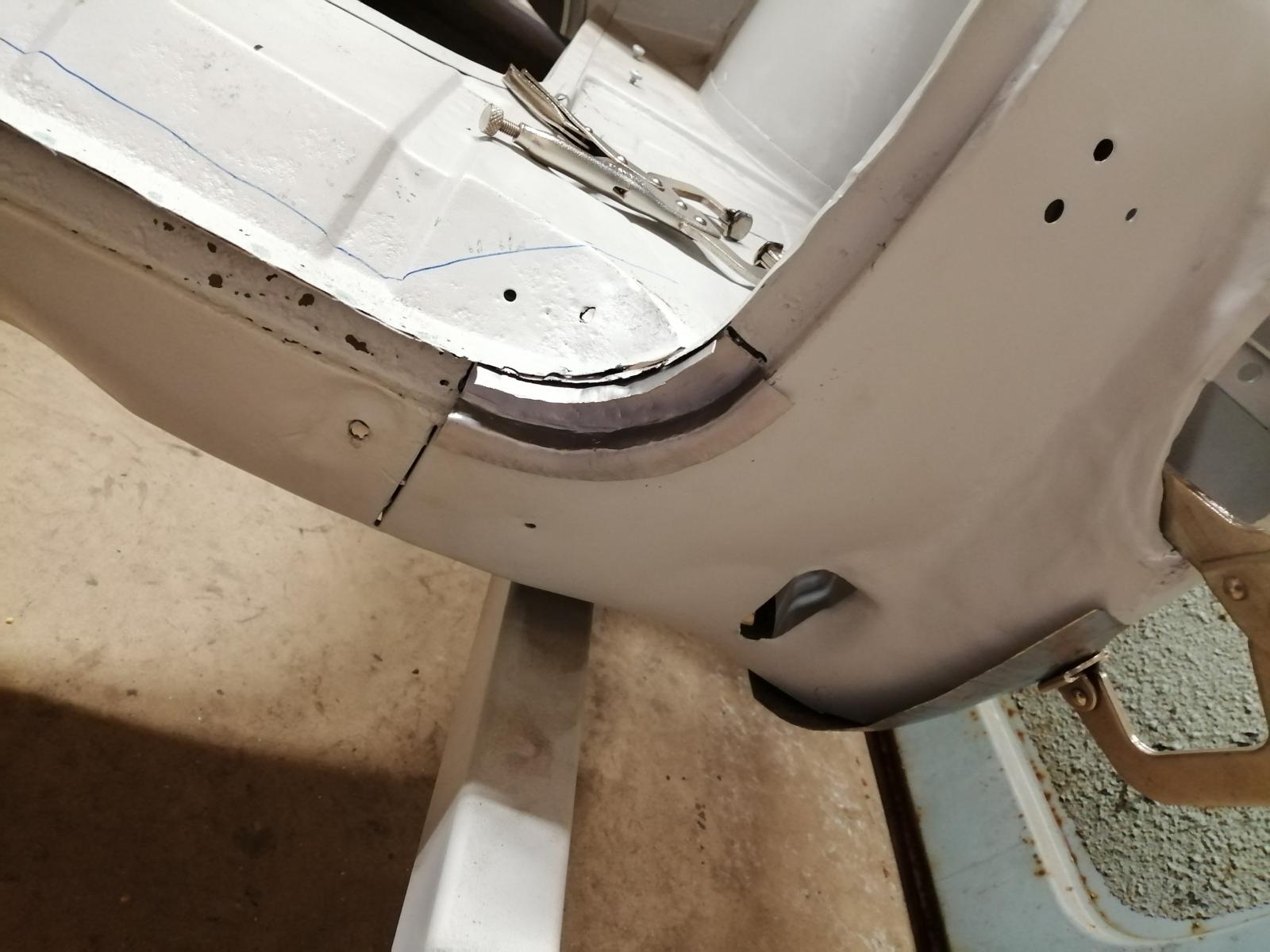

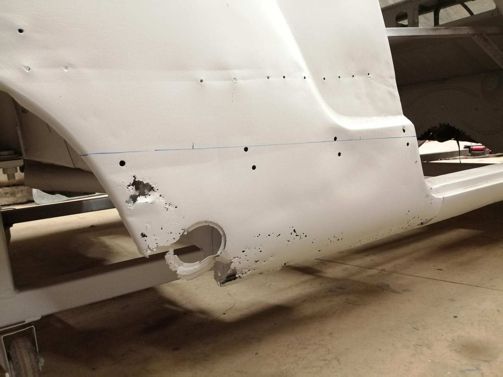

In this seal channel we have also some rust issues:

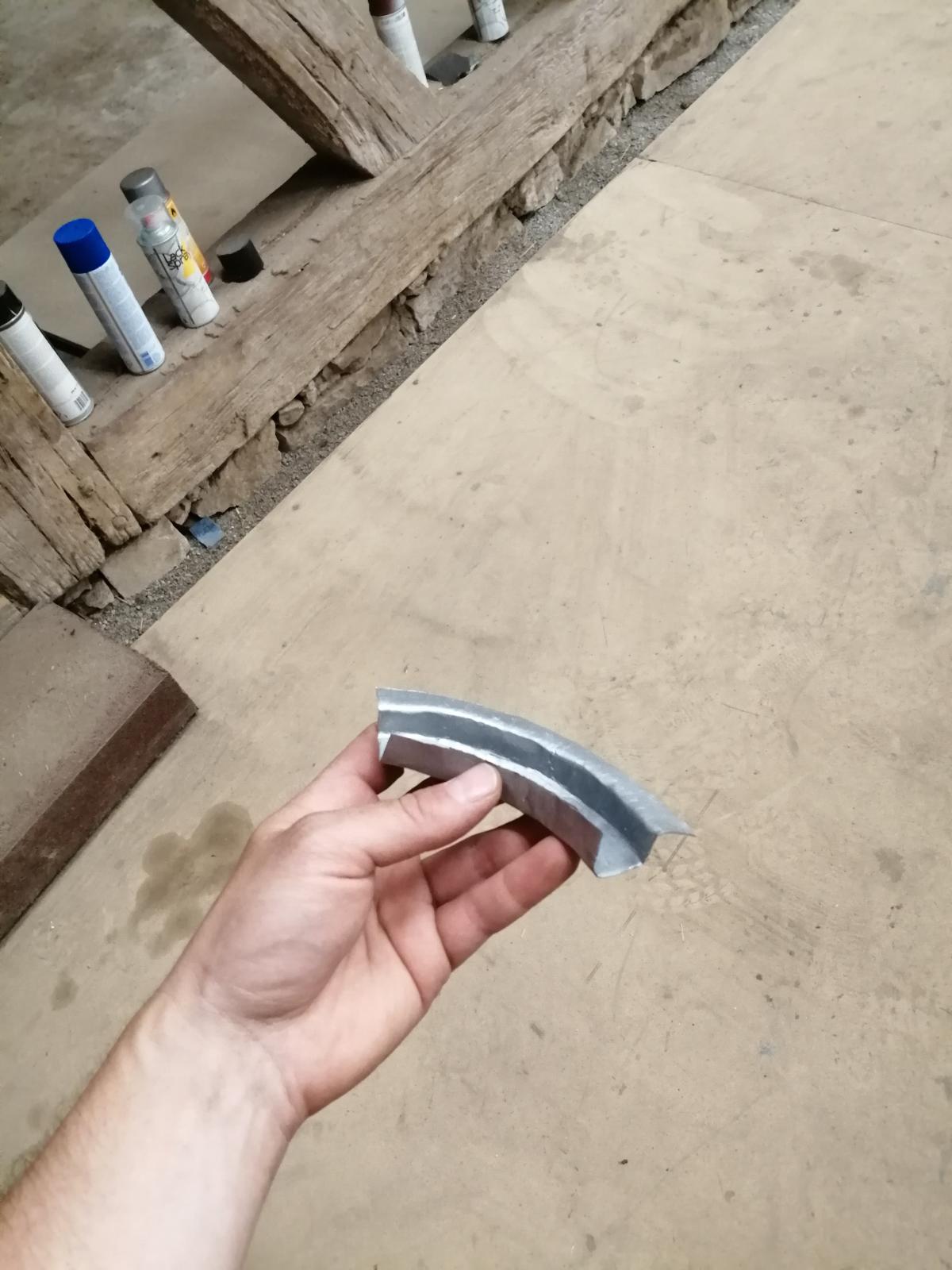

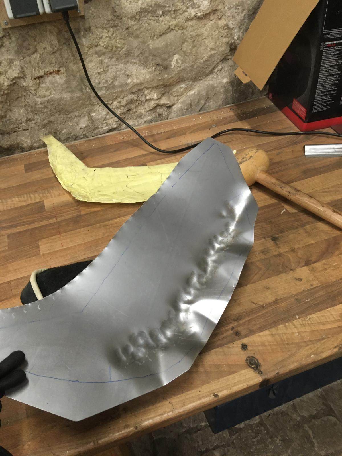

So let's build a patch (only for the right part, I will take care of the apron later as one part) :
First bendings:
And then giving the right form:
And here we are:

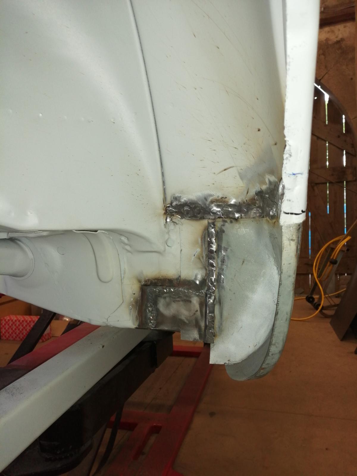

This will be a great welding/assembly session: ����

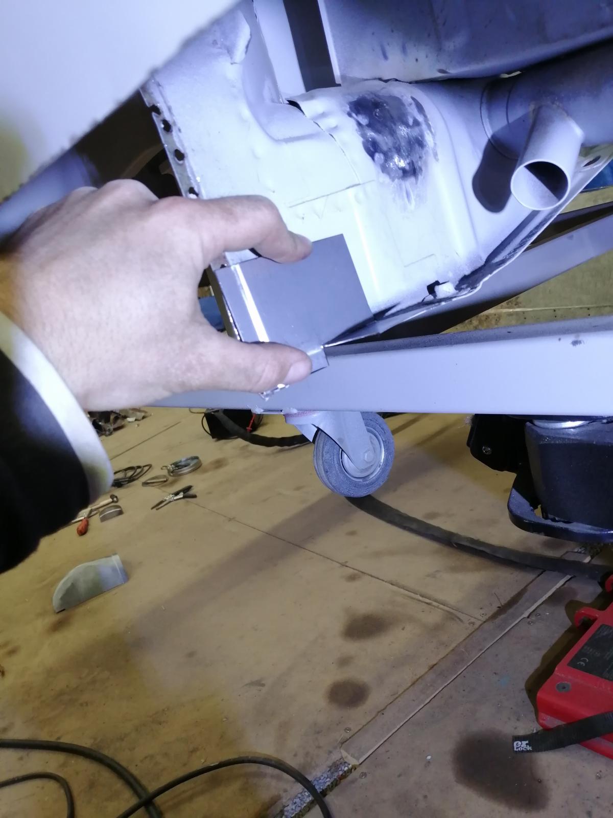

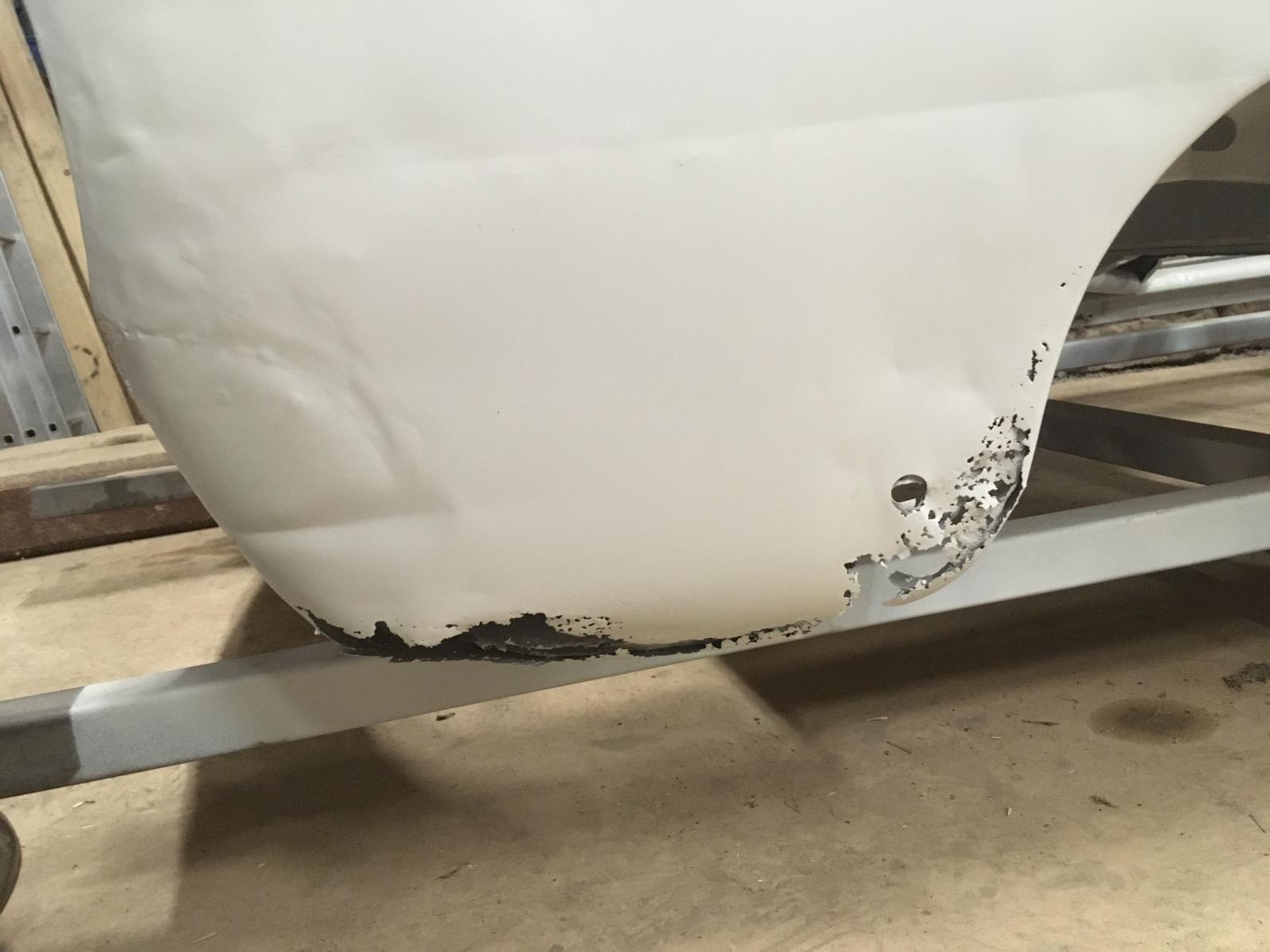

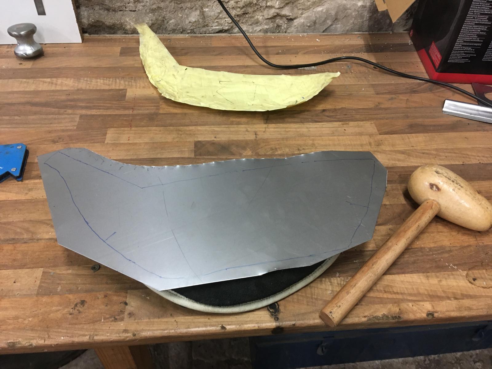

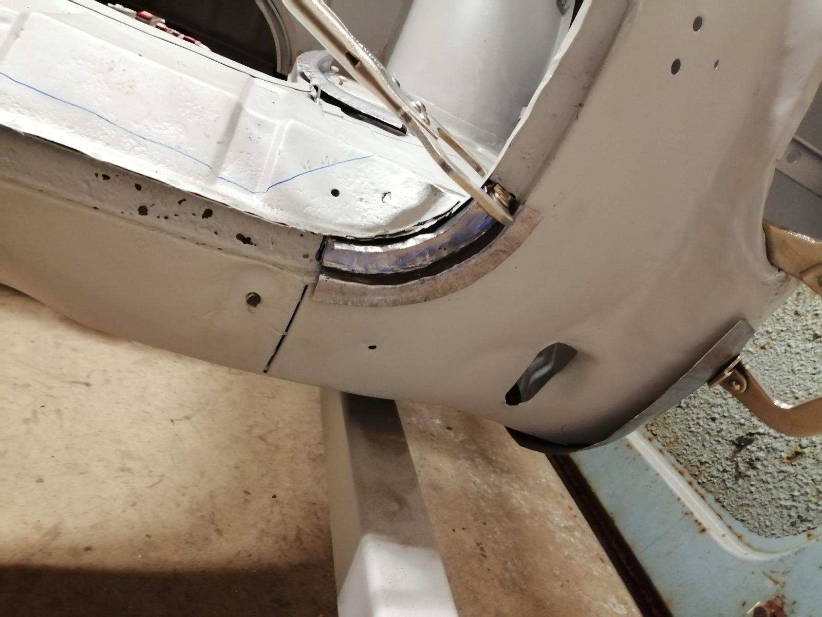

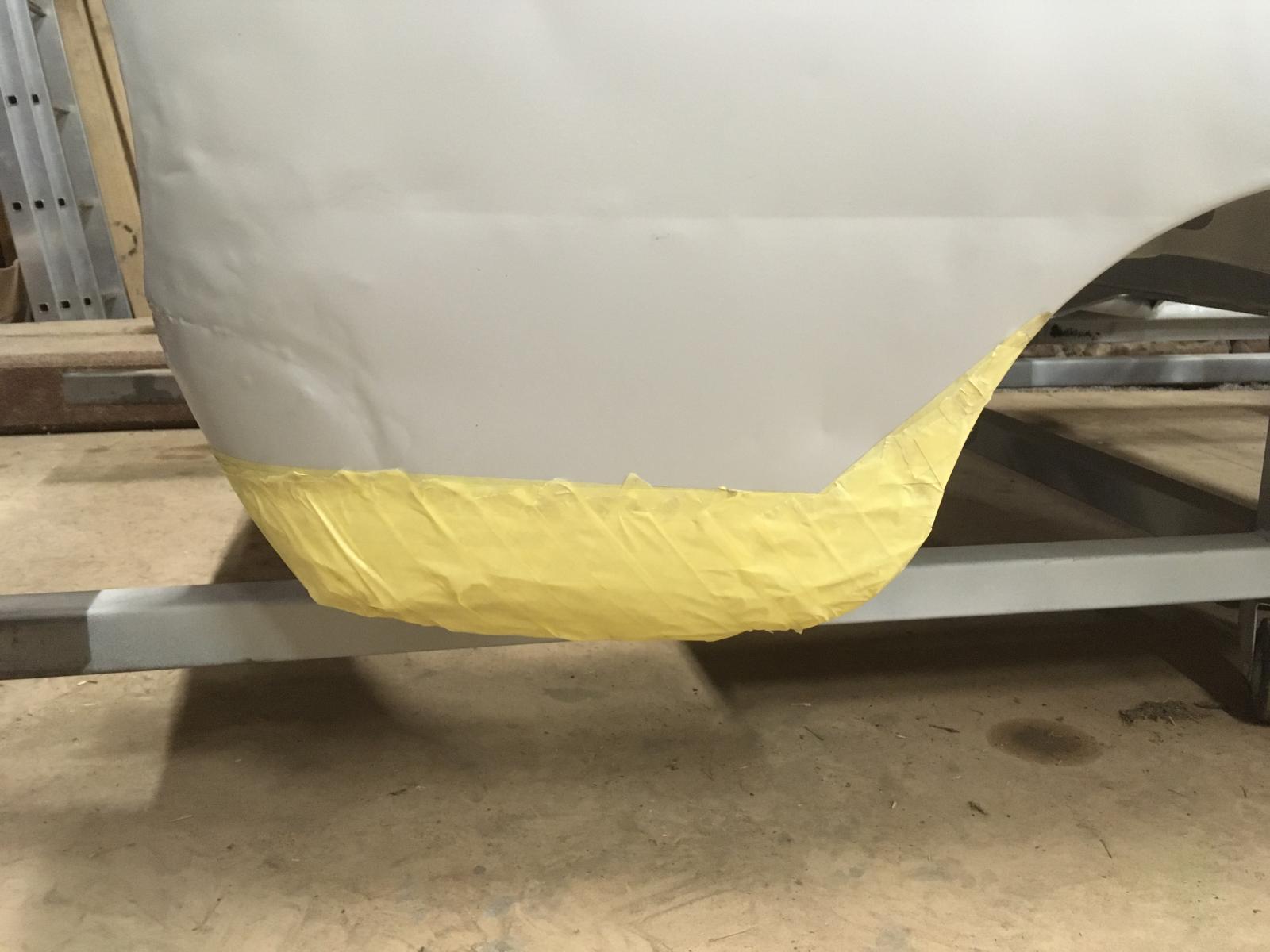

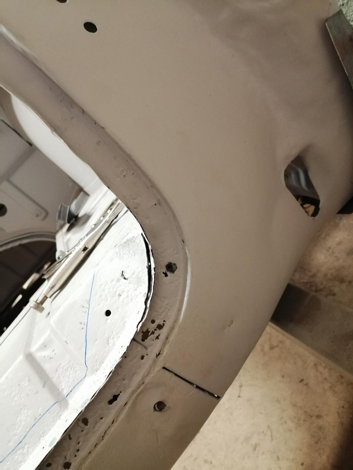

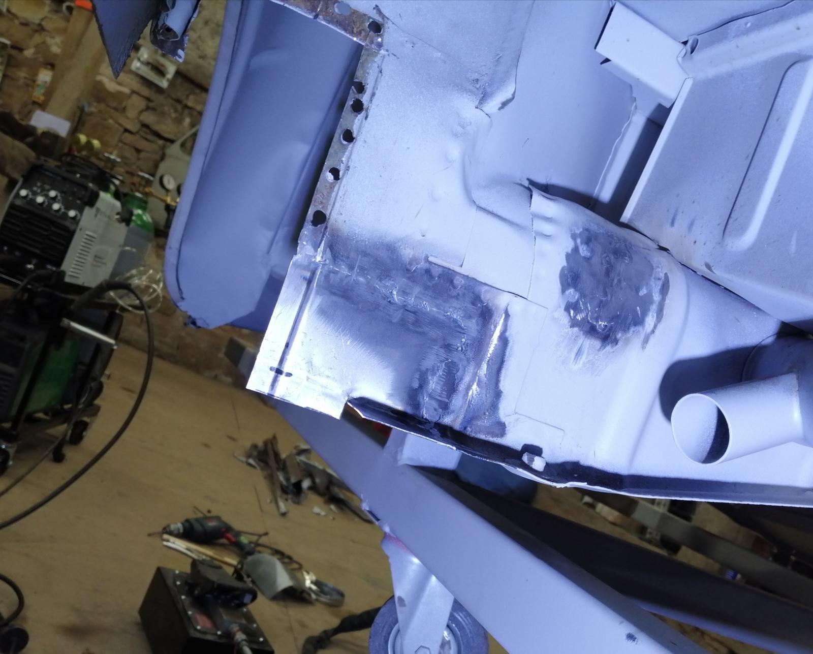

And then the other side of this corner:

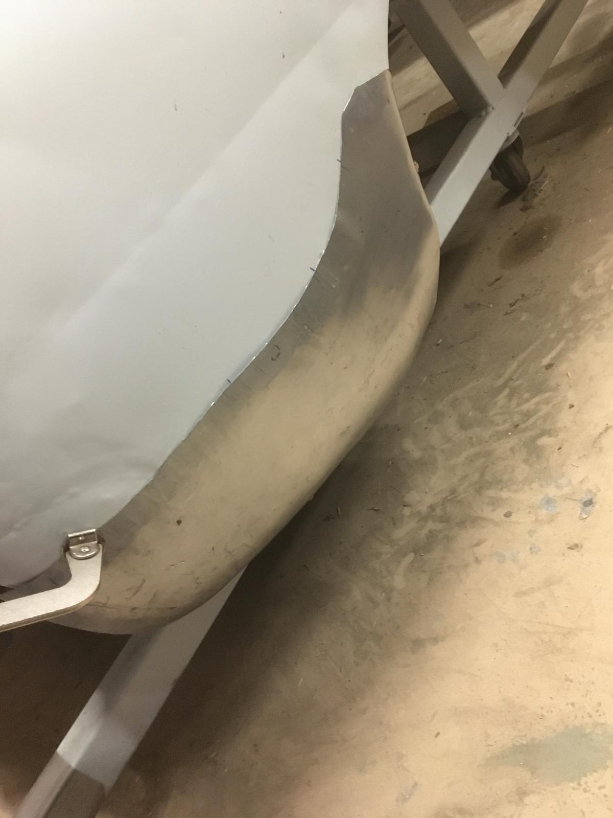

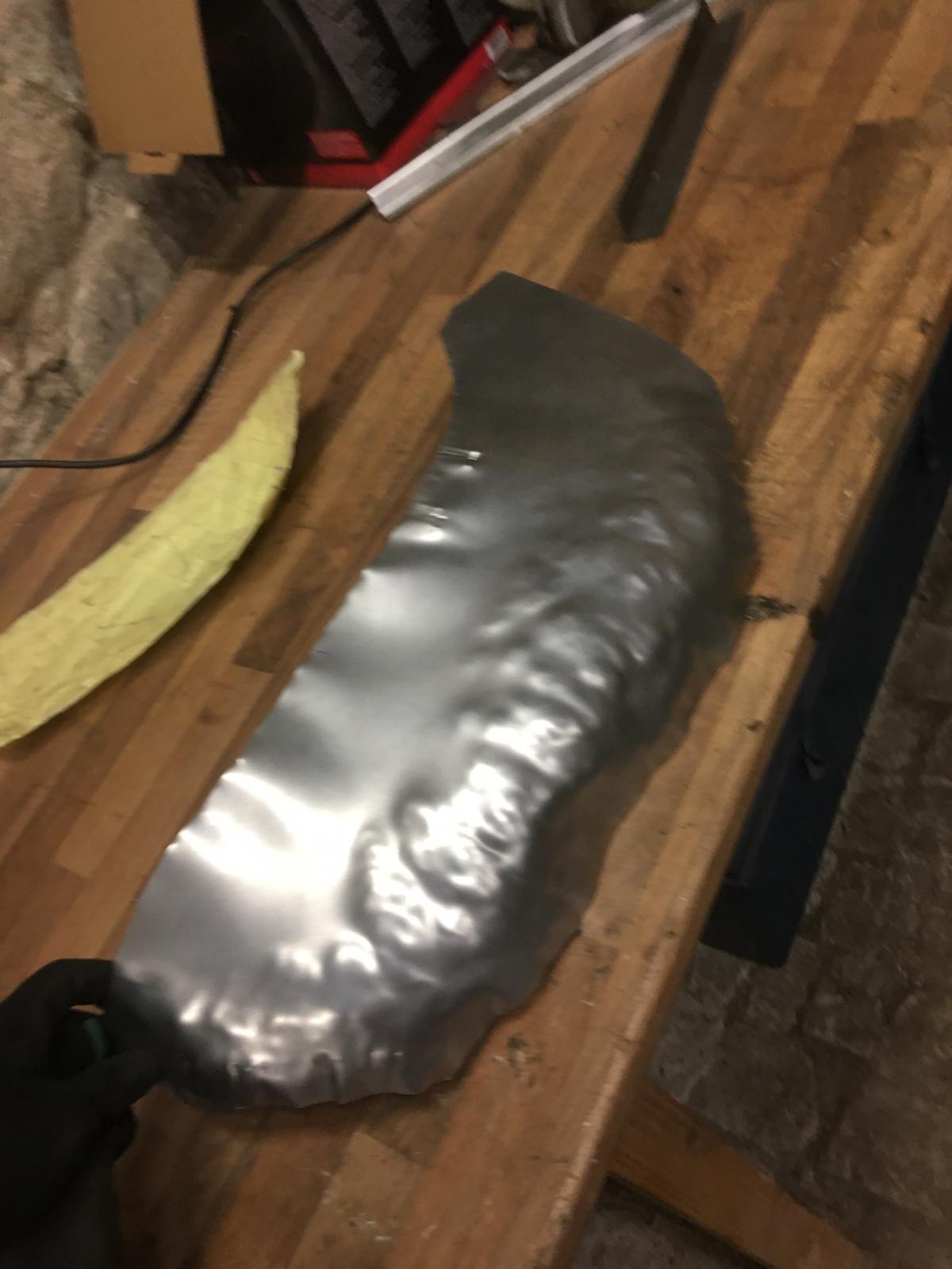

Tried the flexible shape pattern:

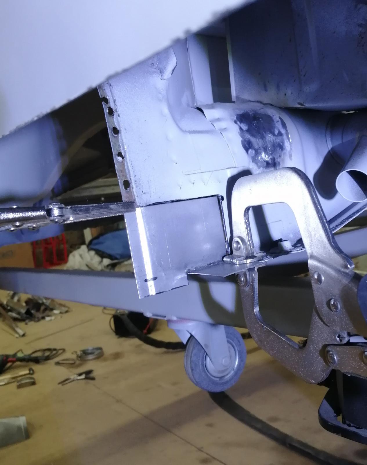

And let's go:

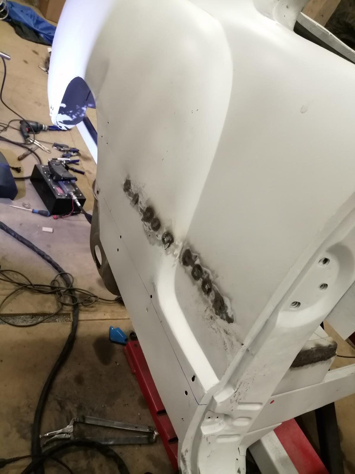

First look close to the car:
And then hammering, wheeling, fitting, hammering, wheeling, fitting,... ☺️��
Looking better:
And here we go:

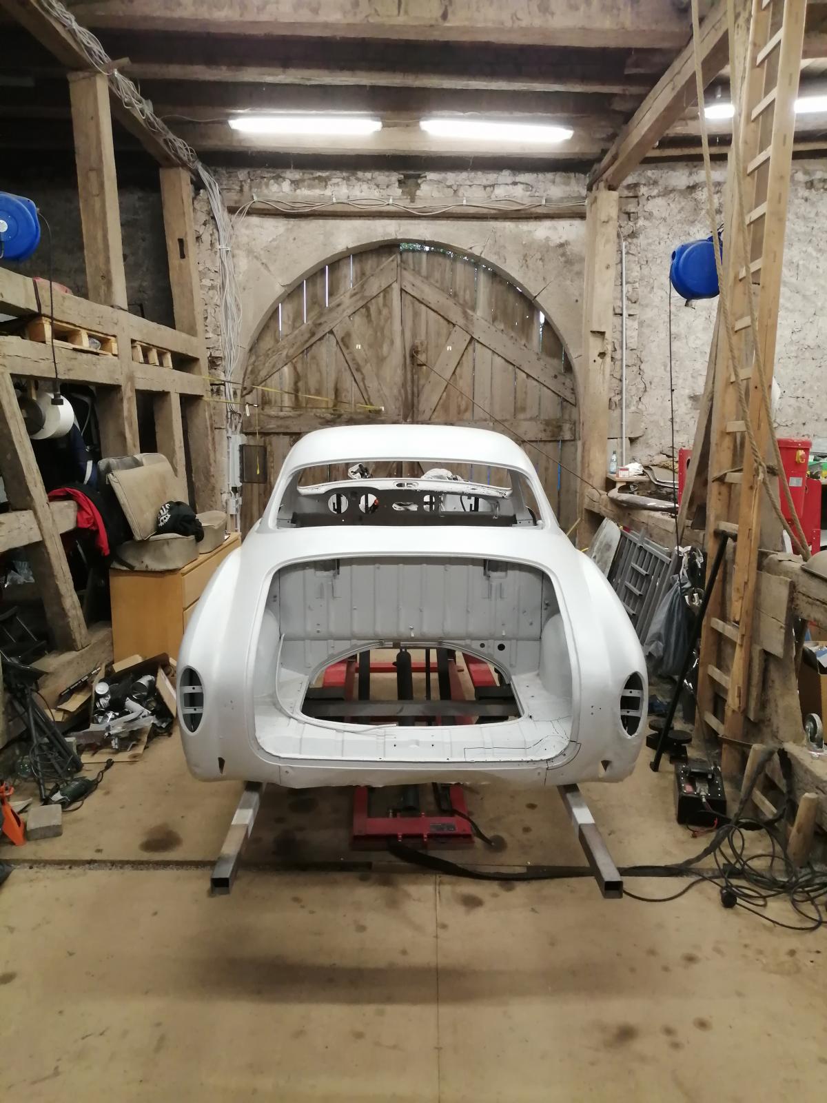

I will weld all this corner when every patches will be ready and the car will be on the rotisserie to have a great access everywhere ��
Which leads to my next plan: I want to have it strong enough for the rotisserie, so next work will be heater channel, in order to have a robust body in the rotisserie and then I will weld all this corner.. Stay tuned !

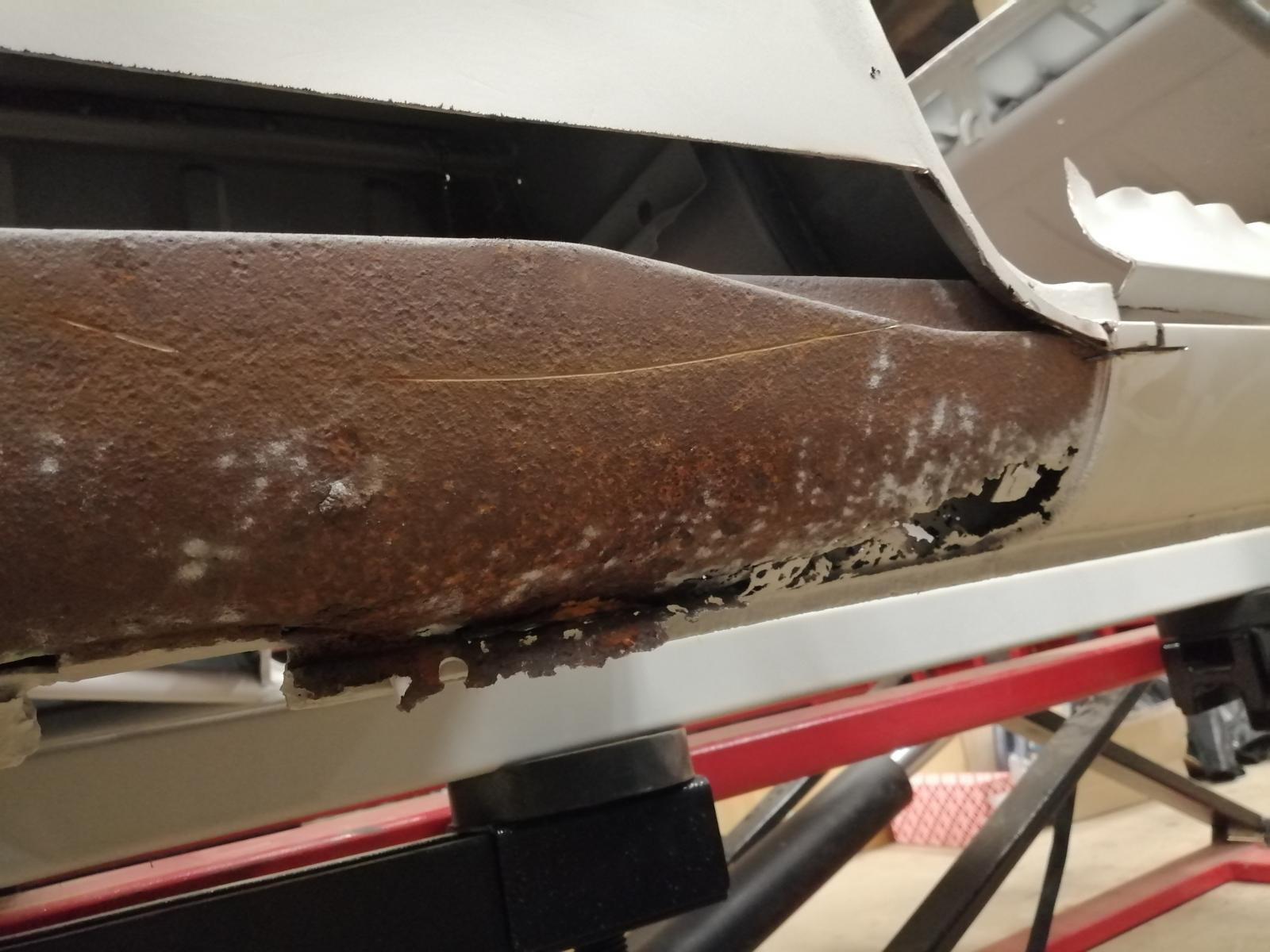

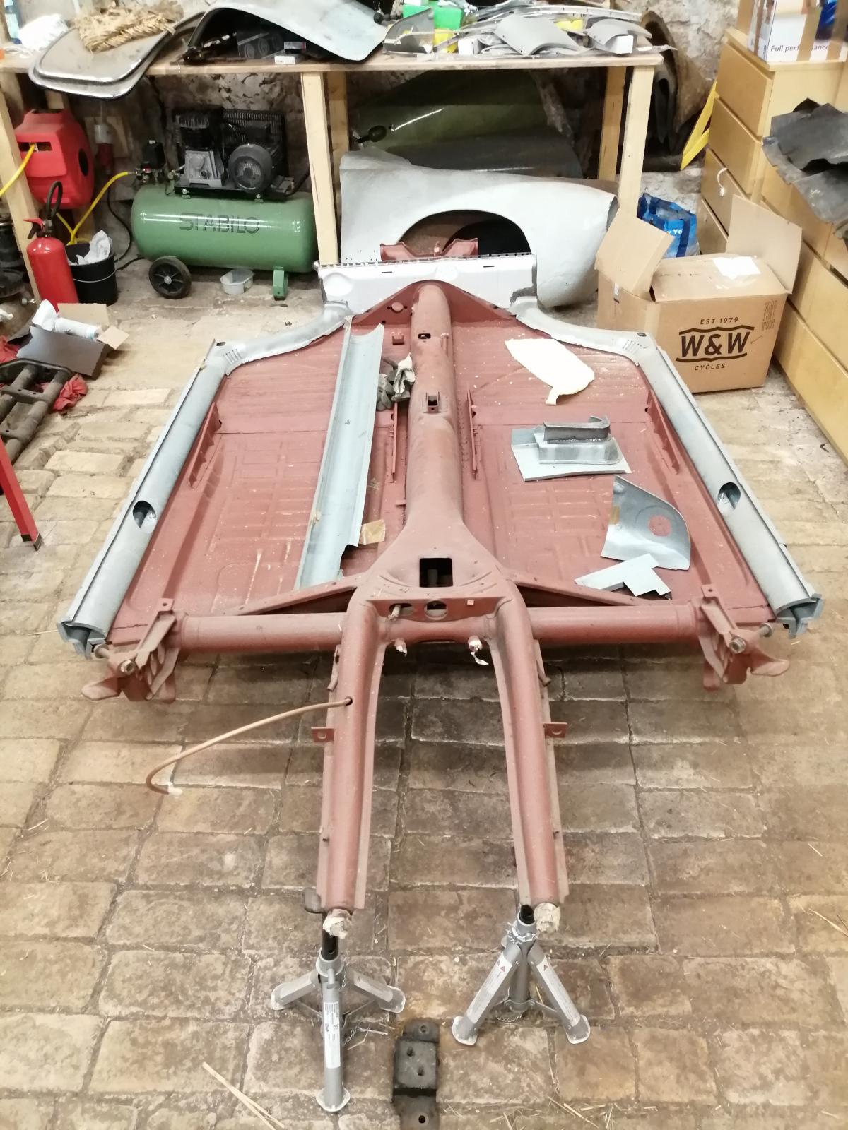

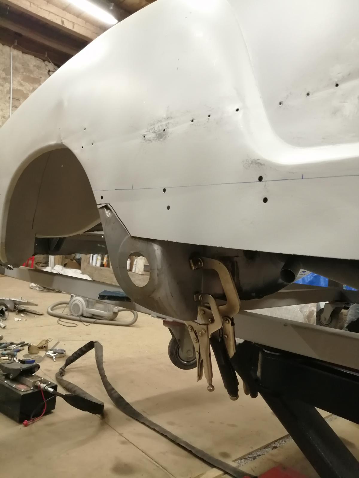

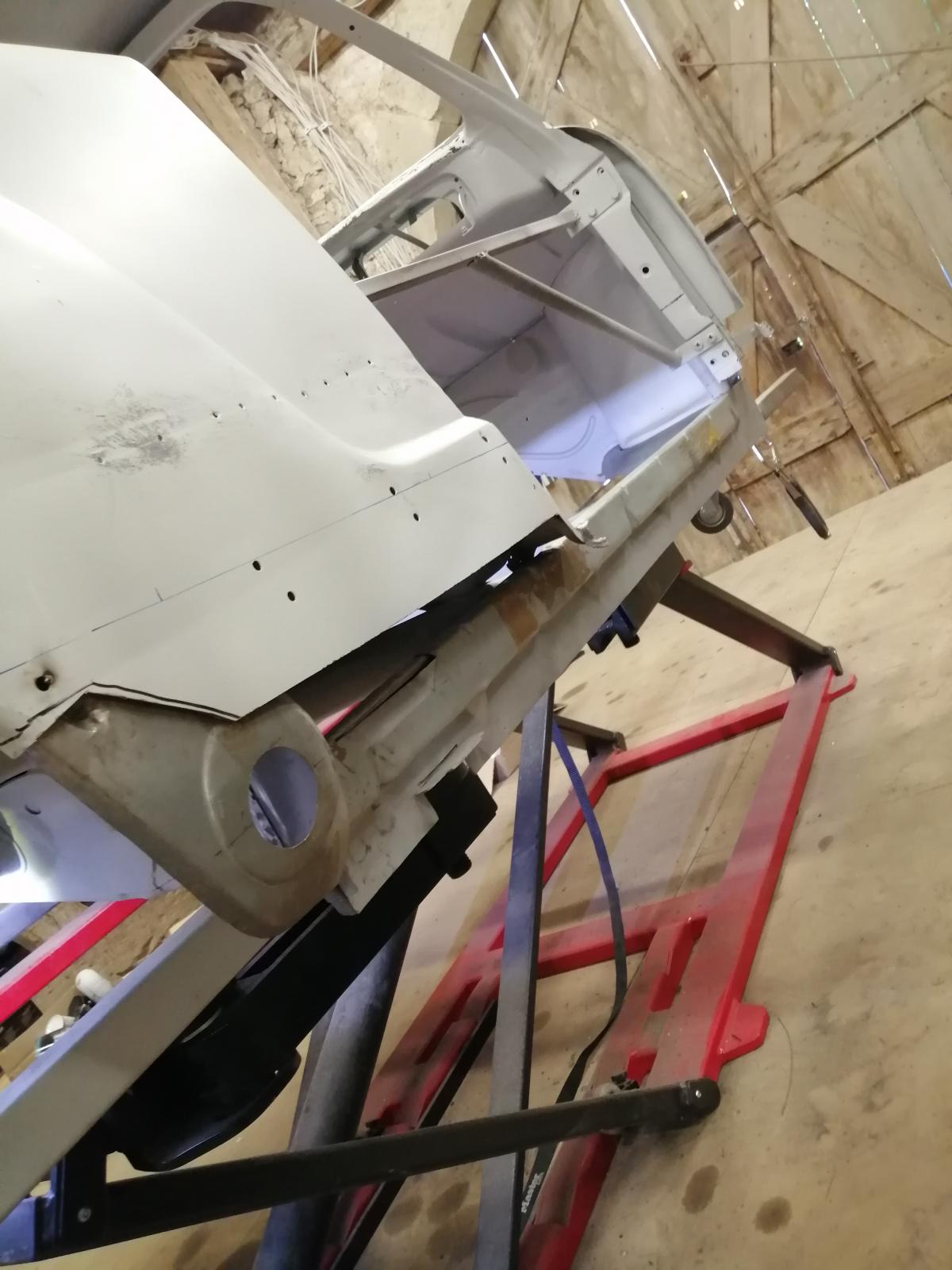

So, as I said before, plan is now to do the heater channels in order to be able to finish the pan parallel to working on the body (I don't want to paint/assemble the pan before using it as a jig for my heater channel :wink: )

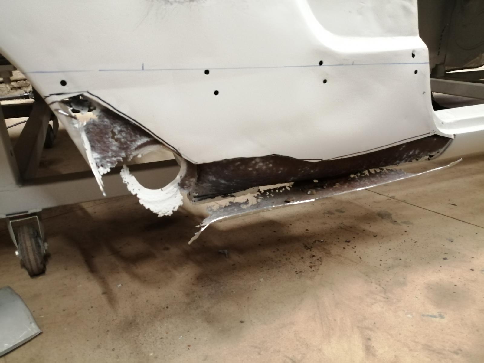

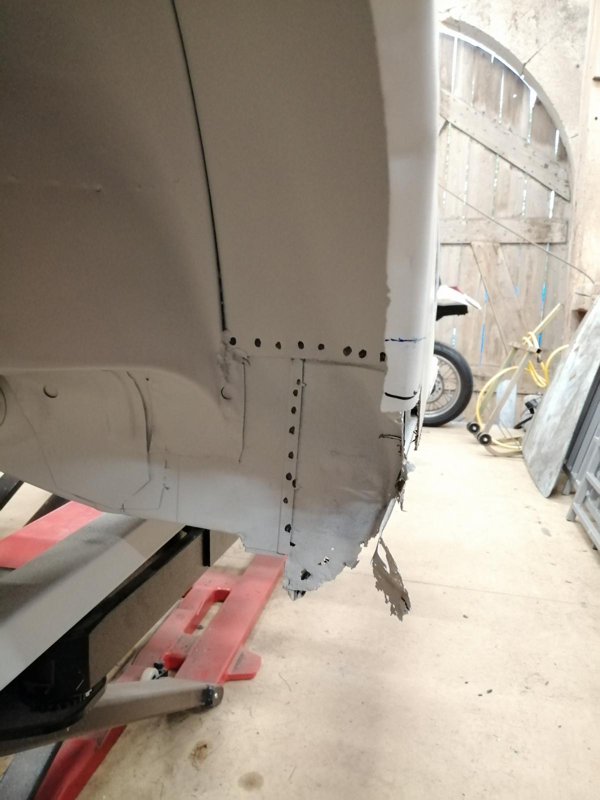

So, I started on the right side:
and soon enough found some rust

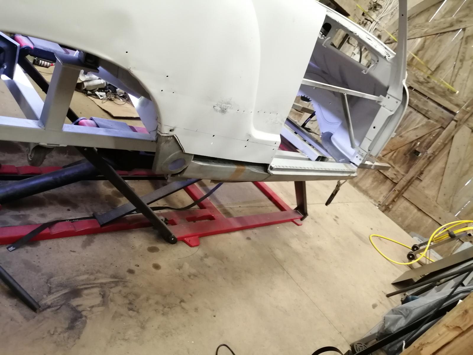

I put the ghia on the lift and worked my way further:
it takes time but I try to remove everything without damaging something else, so removing every weld point separately like here:
my heater channels will be welded on the body while screwed on the pan to ensure that it works together:
and at the end of the day, I did in fact got a lot of rusted metal together again:

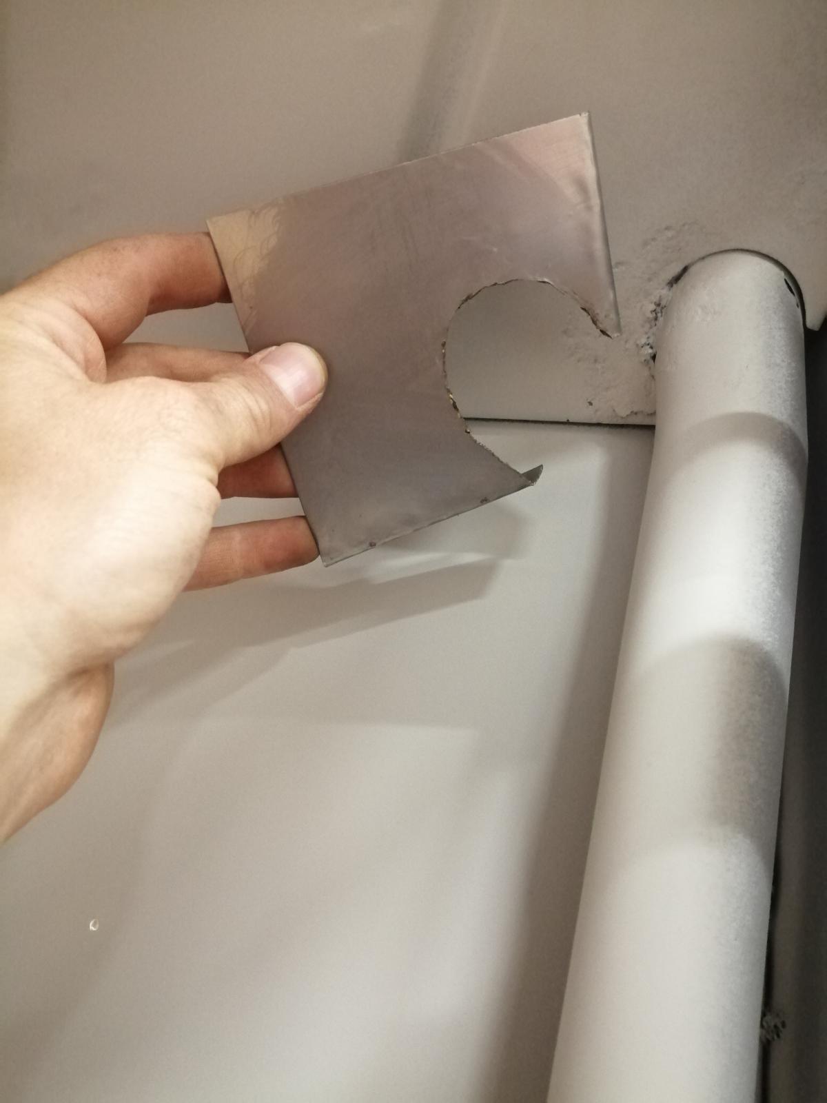

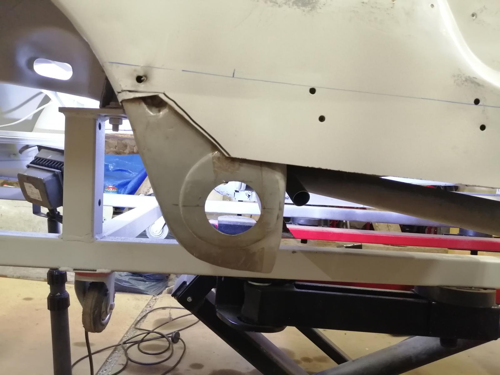

So, time for a new update..been working further on the right heater channel and it's connexions to the body
My stock of rusted metal grow again:

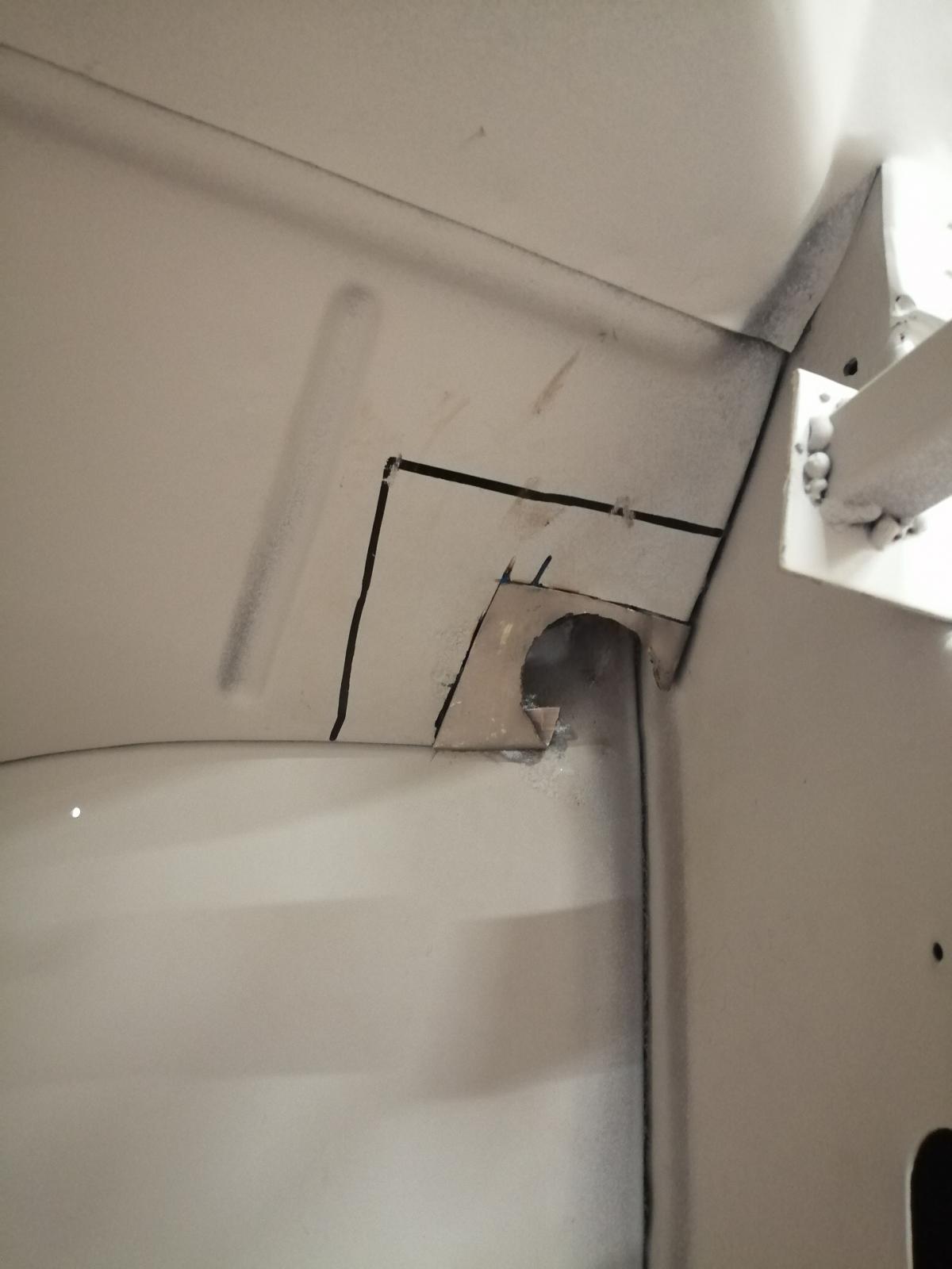

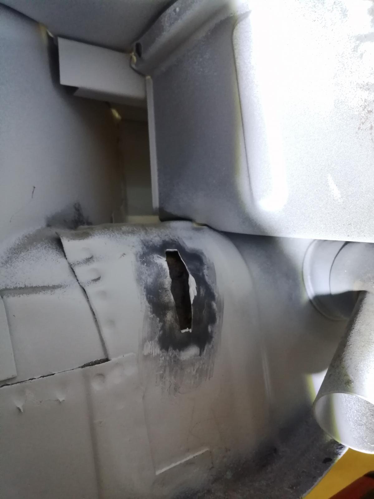

and I discovered a hole I didn't knew :roll:
the reason is this opening behind that let the humidity there:

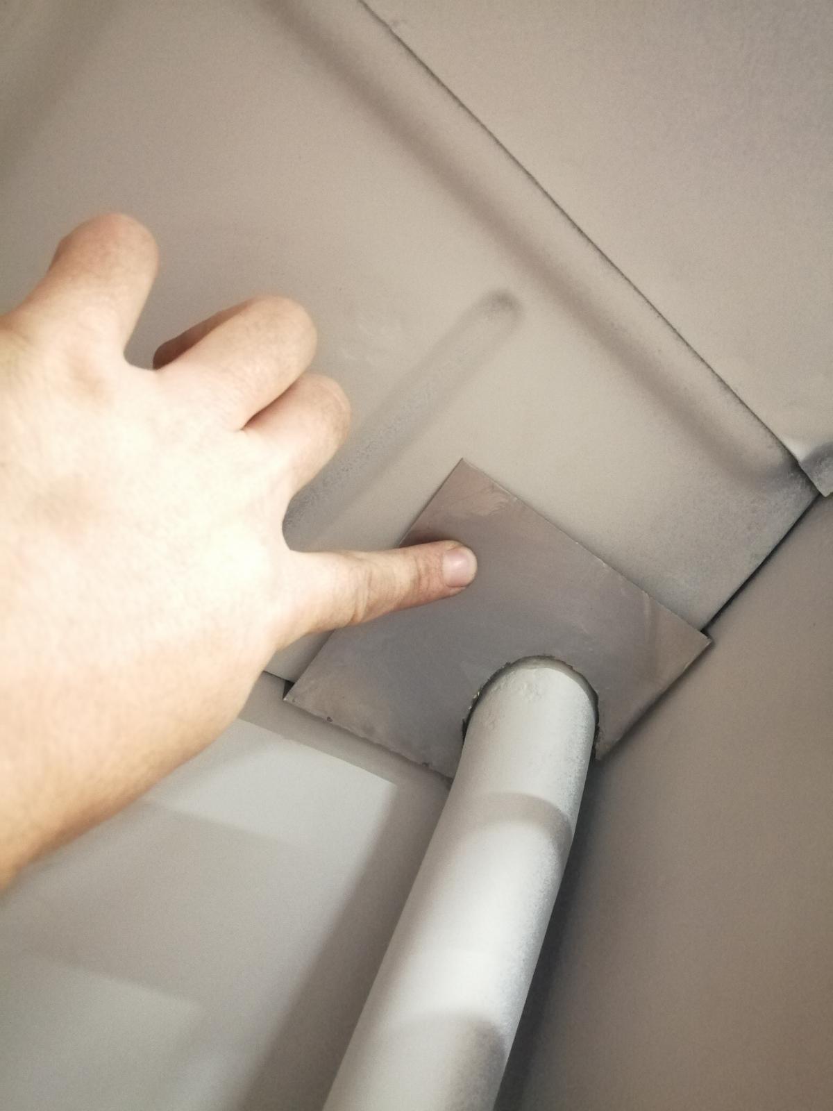

so I cut up to good metal, cleaned everything, put some primer, made a patch and welded it:

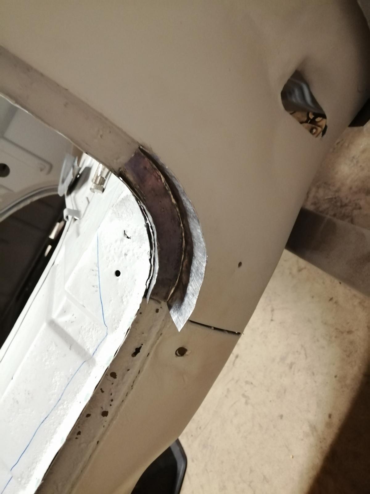

Then I remade this closing panel:
and welded:
then it was time for some test fit:
and then some welding:
already looks better, a short before/after: :twisted:
and then again some test fit:
looks quite good:
but before welding there, I need to fix the A-Pillar, then test fit it on the pan,... and before all of that, I enjoy the better access to take care of the holes and accident-traces from the past:
Now we are up to date, need to work to bring you the next update ops:

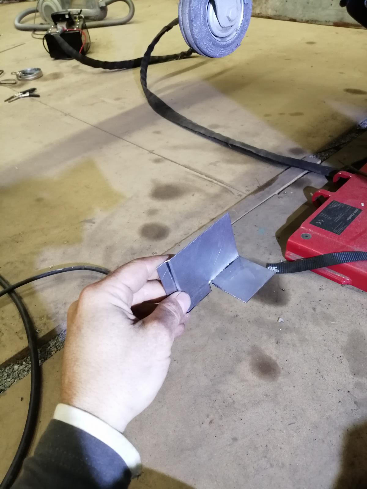

Some more small steps done:

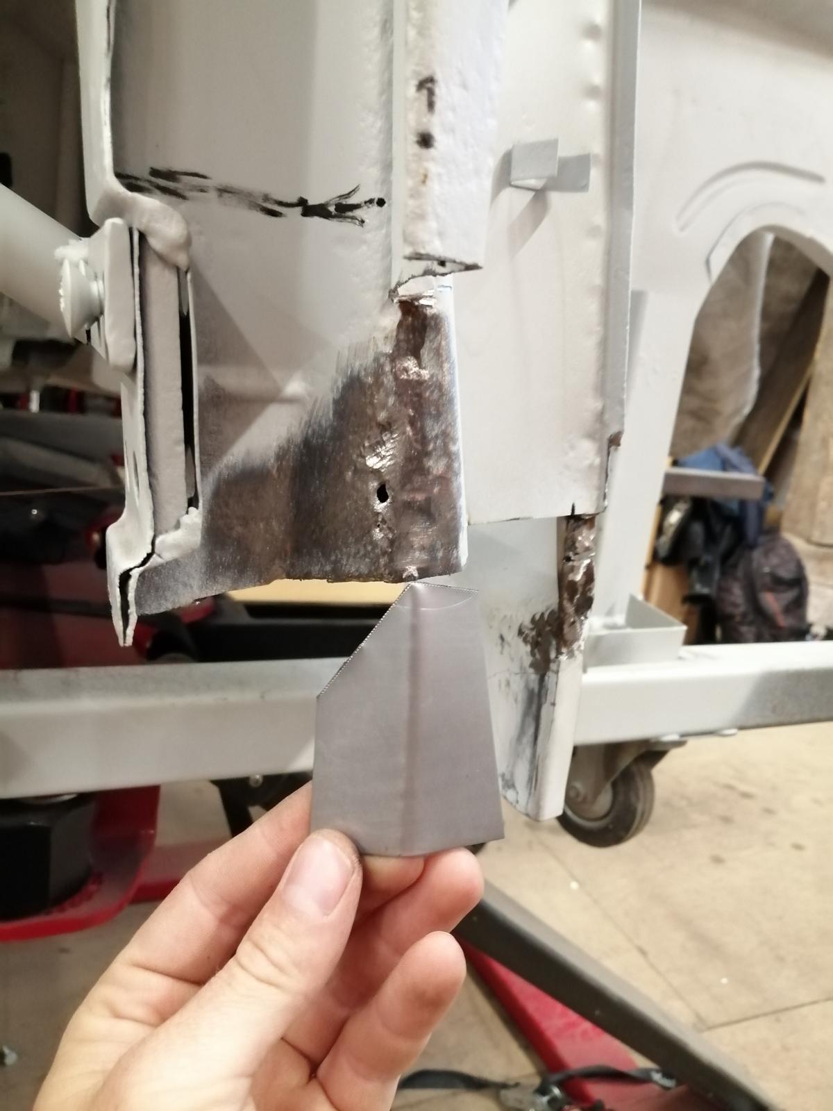

-here I found some more rust :
Yes here:
So I made a patch:

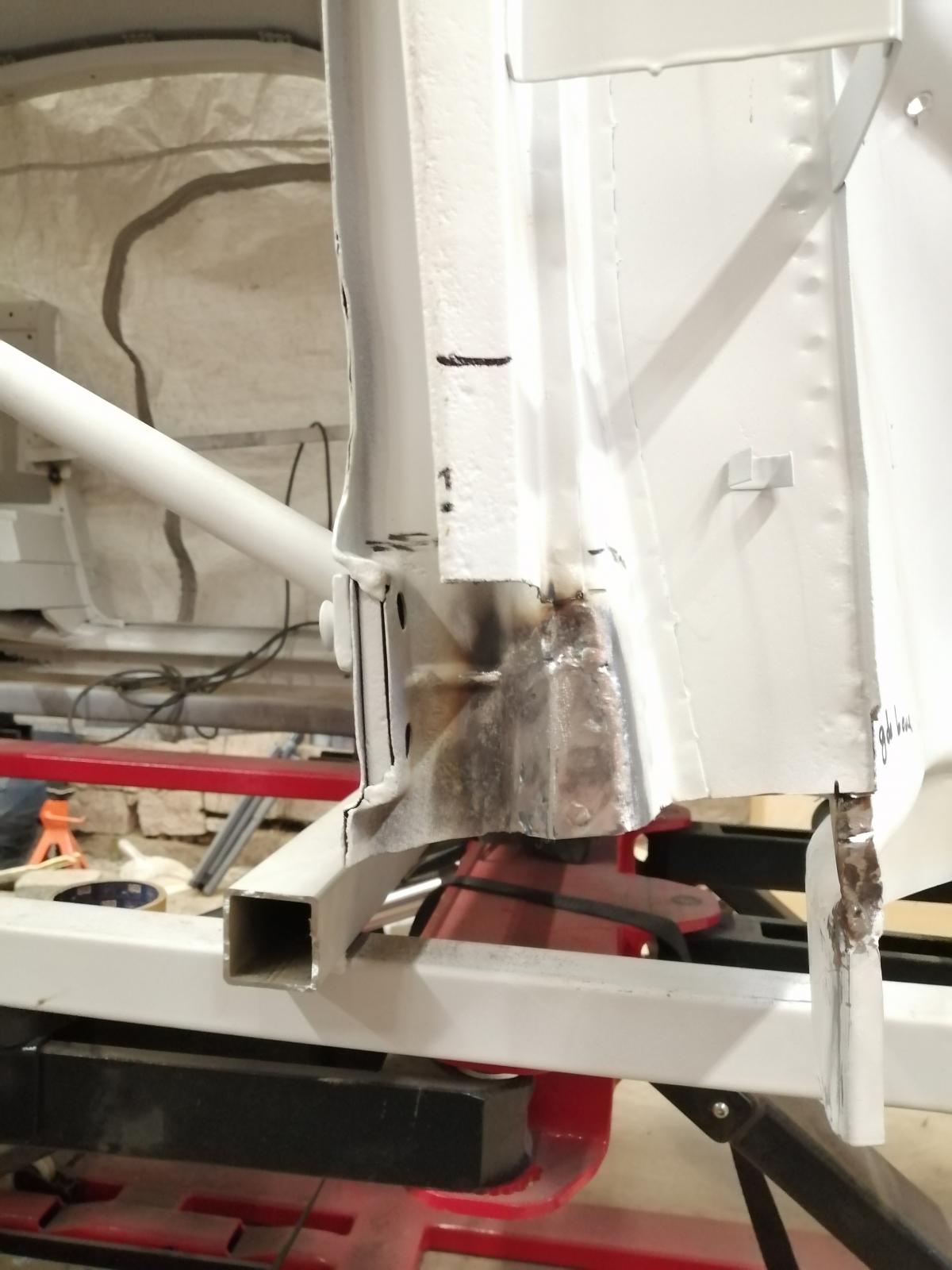

And onto the A pillar. I want to save as much original metal as possible so let's fix this part:
Next step is the bottom of the "flat part" of the A pillar, final adjust of the heater channel, to weld it in place and then finish the A pillar 👍
