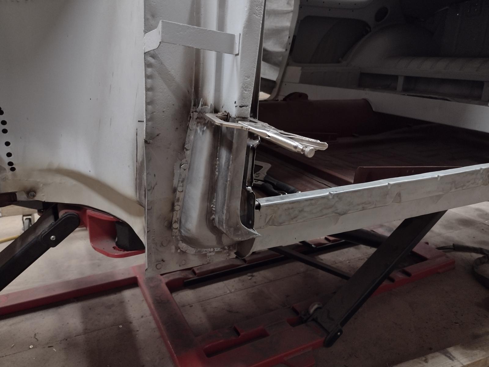

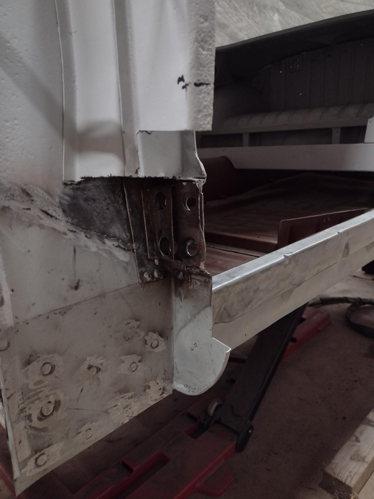

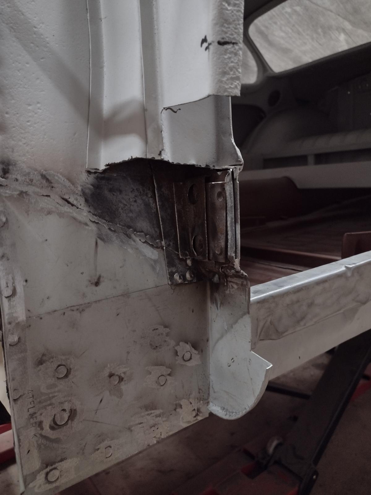

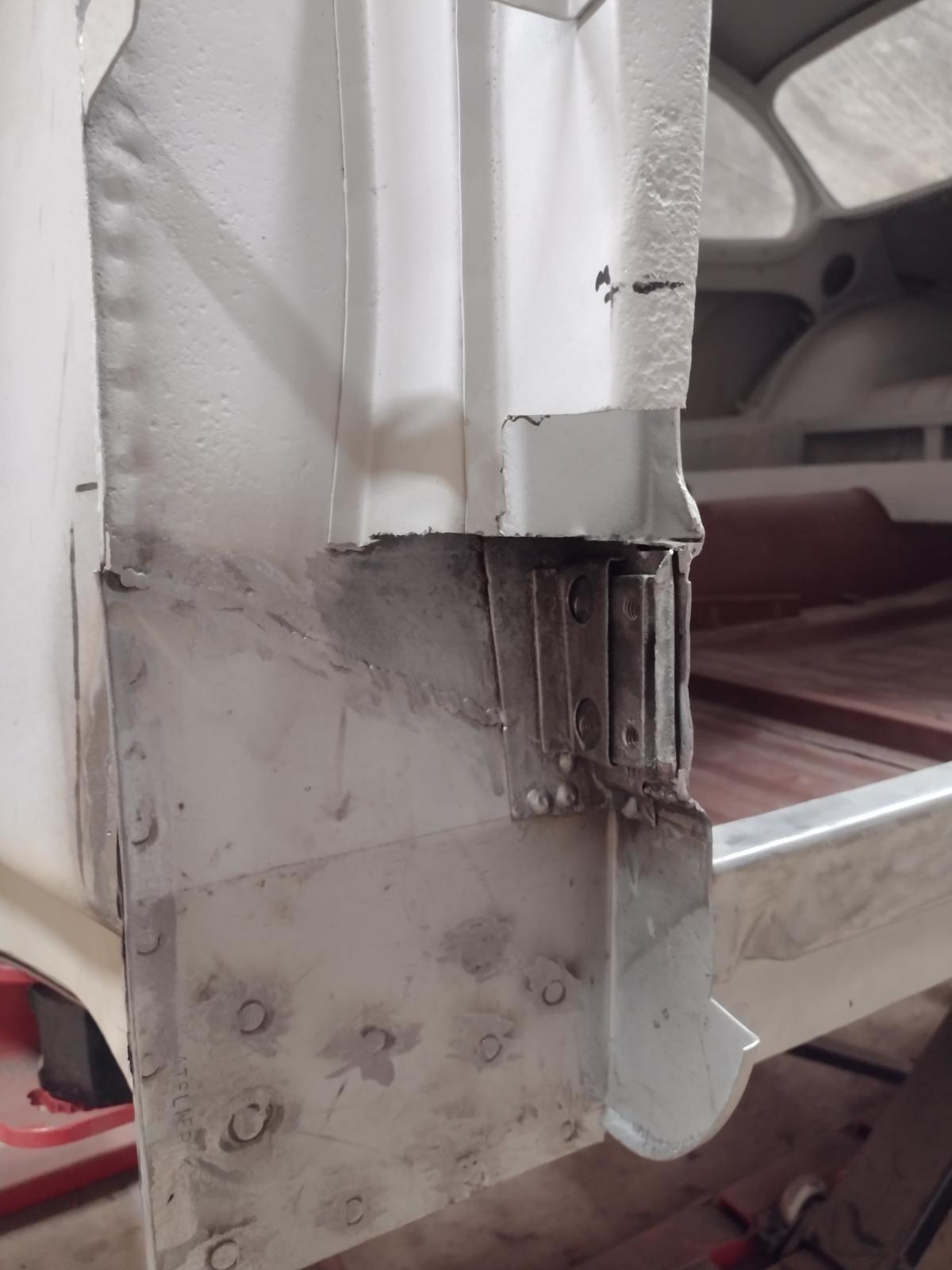

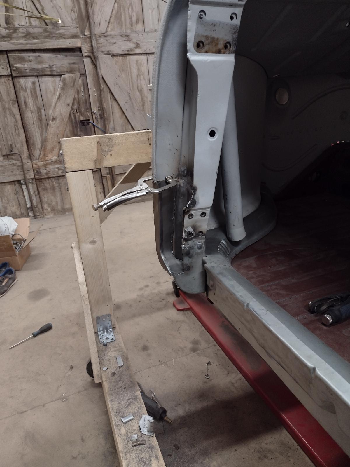

Went further on the A-post, first check with the replacement part:
Marked where to cut:
And made some space and started the cleaning:

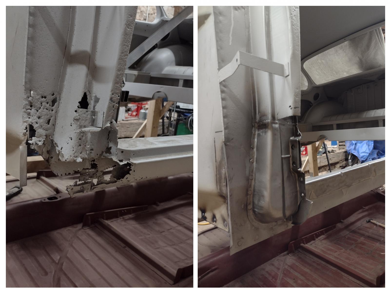

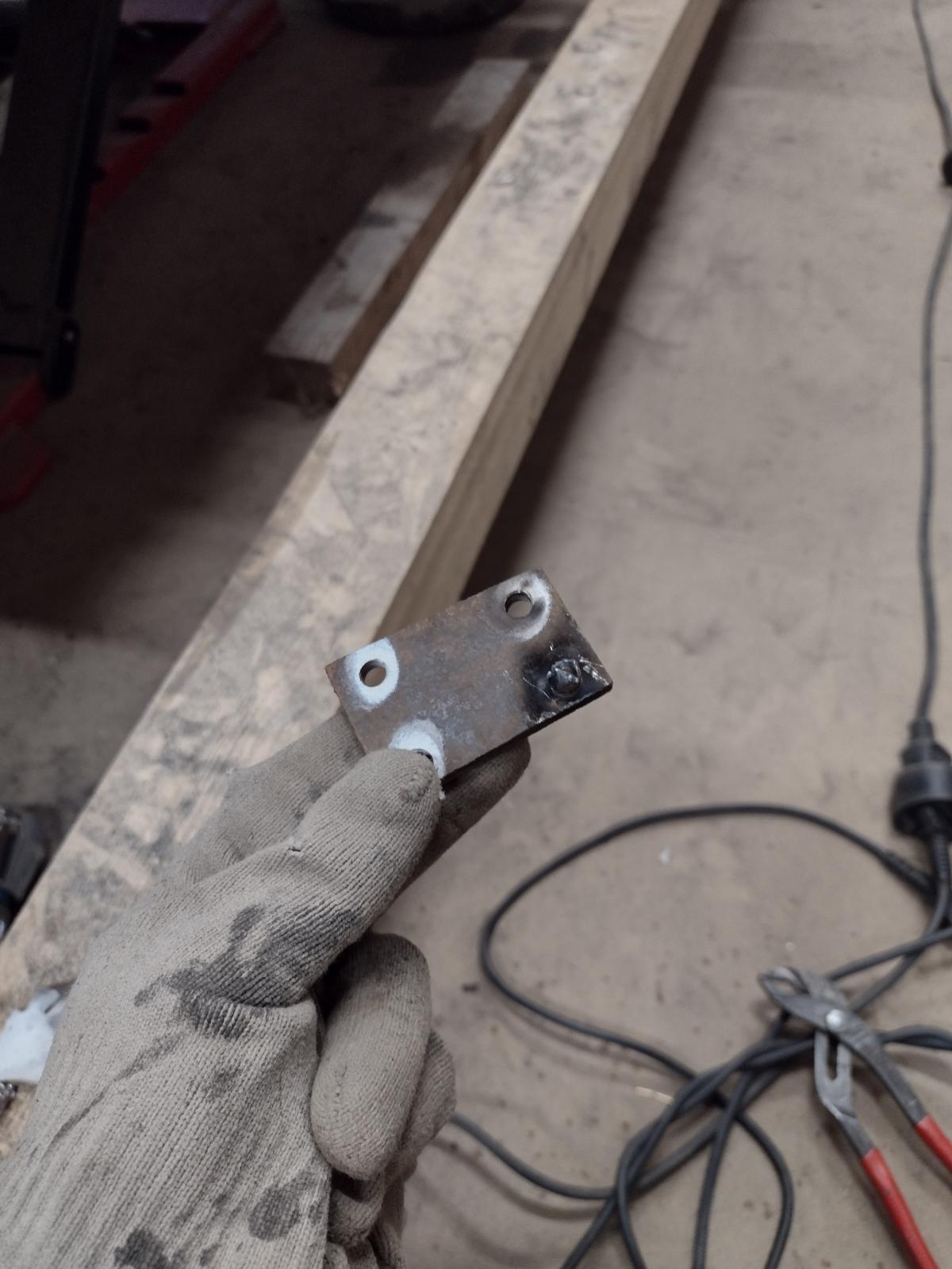

And removed the locking plate to take care of the broken screw and the Rust:
And cleaned, blasted, ..:
Mounted again, A-post all cleaned and primed:
And adjusted the replacement part..and welded it :
Here we are,no more rusted-through A-Post:
This part will come when adjusting the front fender:

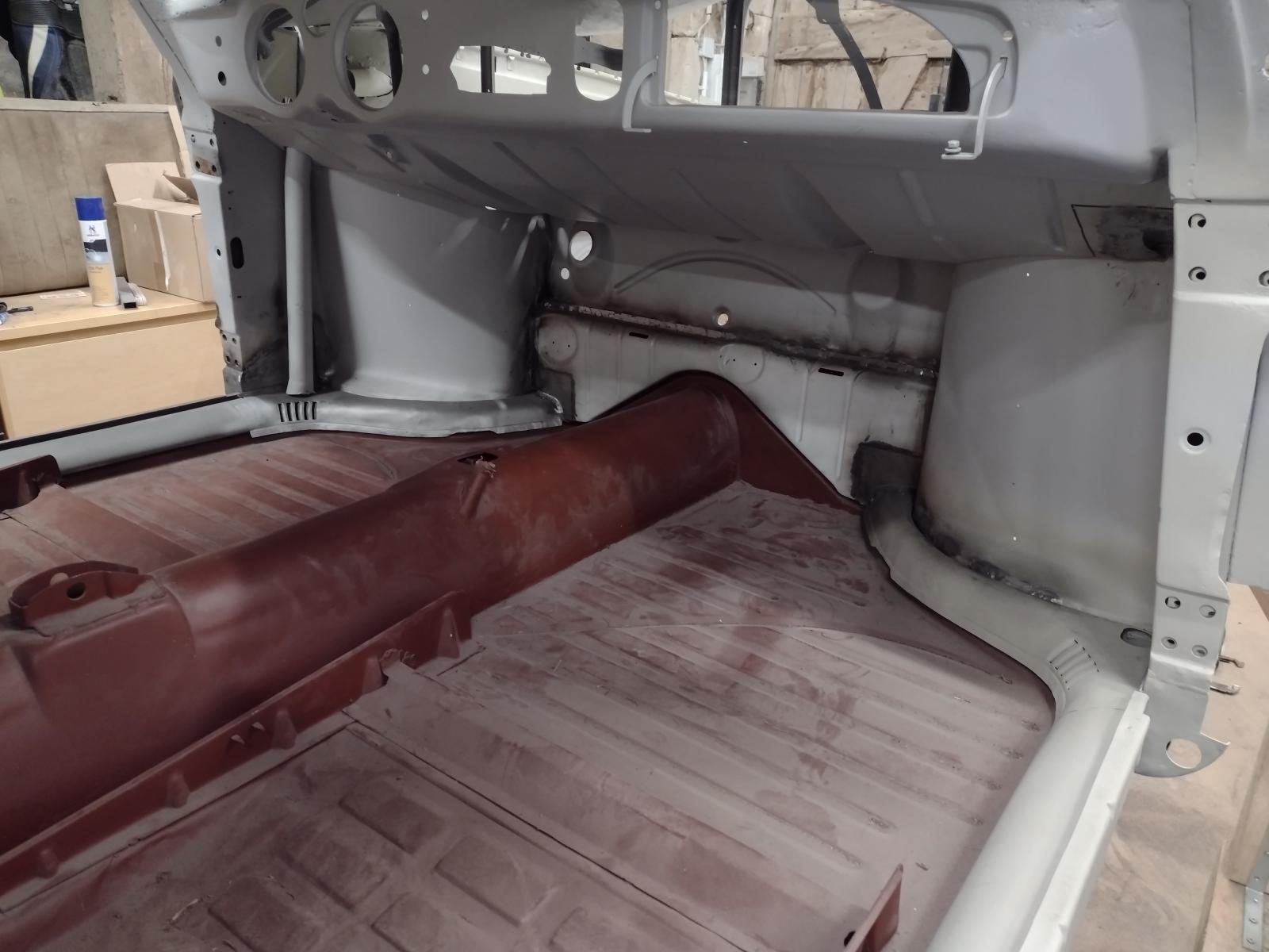

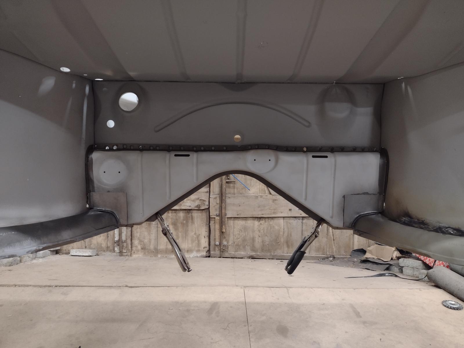

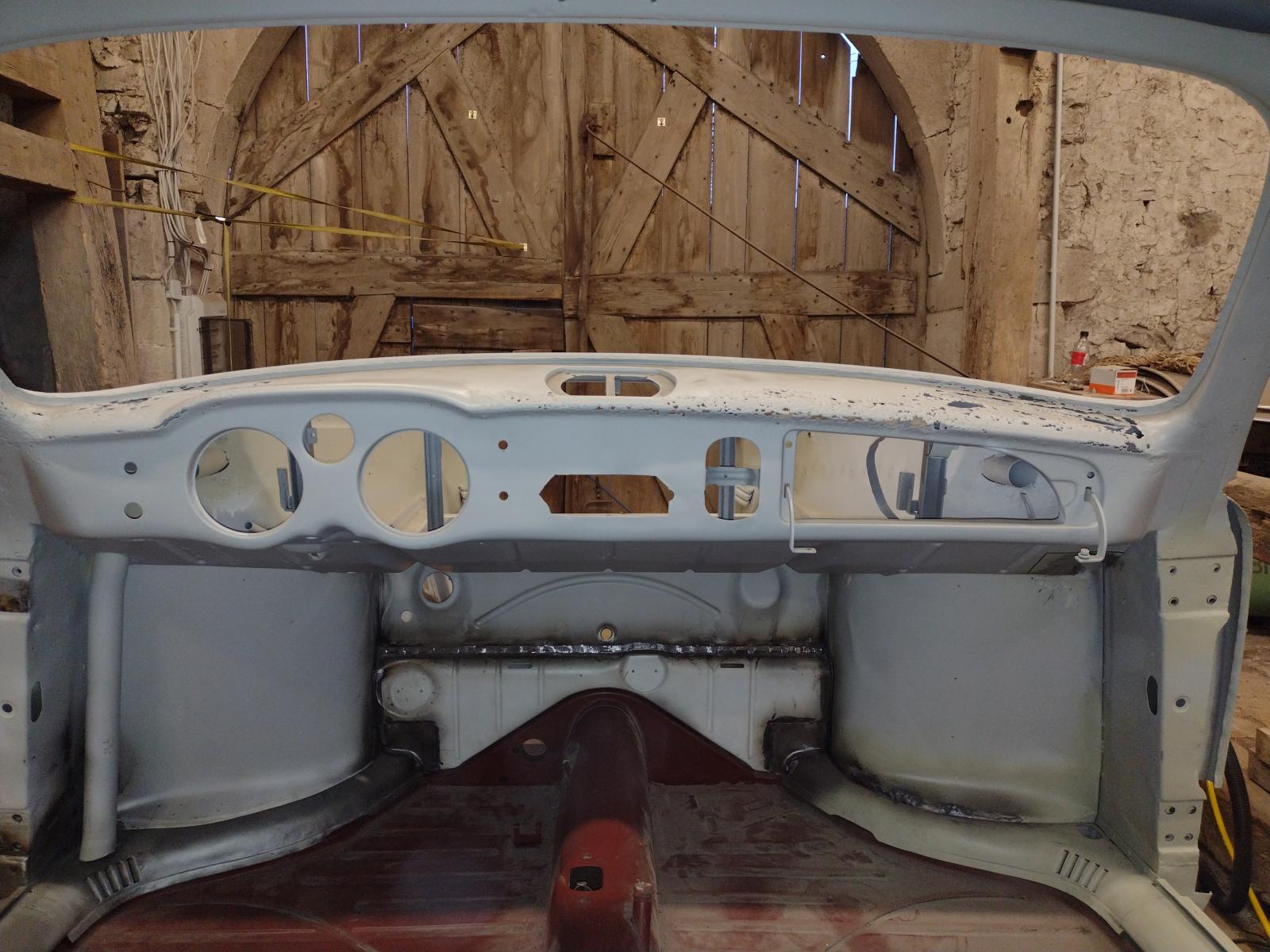

Thanks so much guys for the support and the kind words, much appreciated!! I really do love this project and learning metalshaping on it !

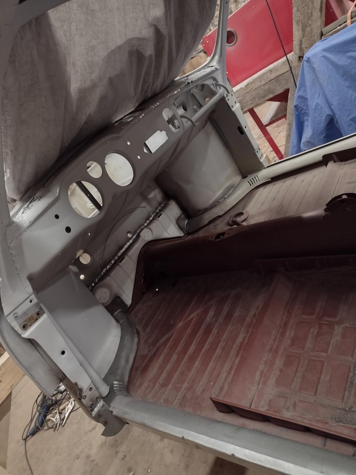

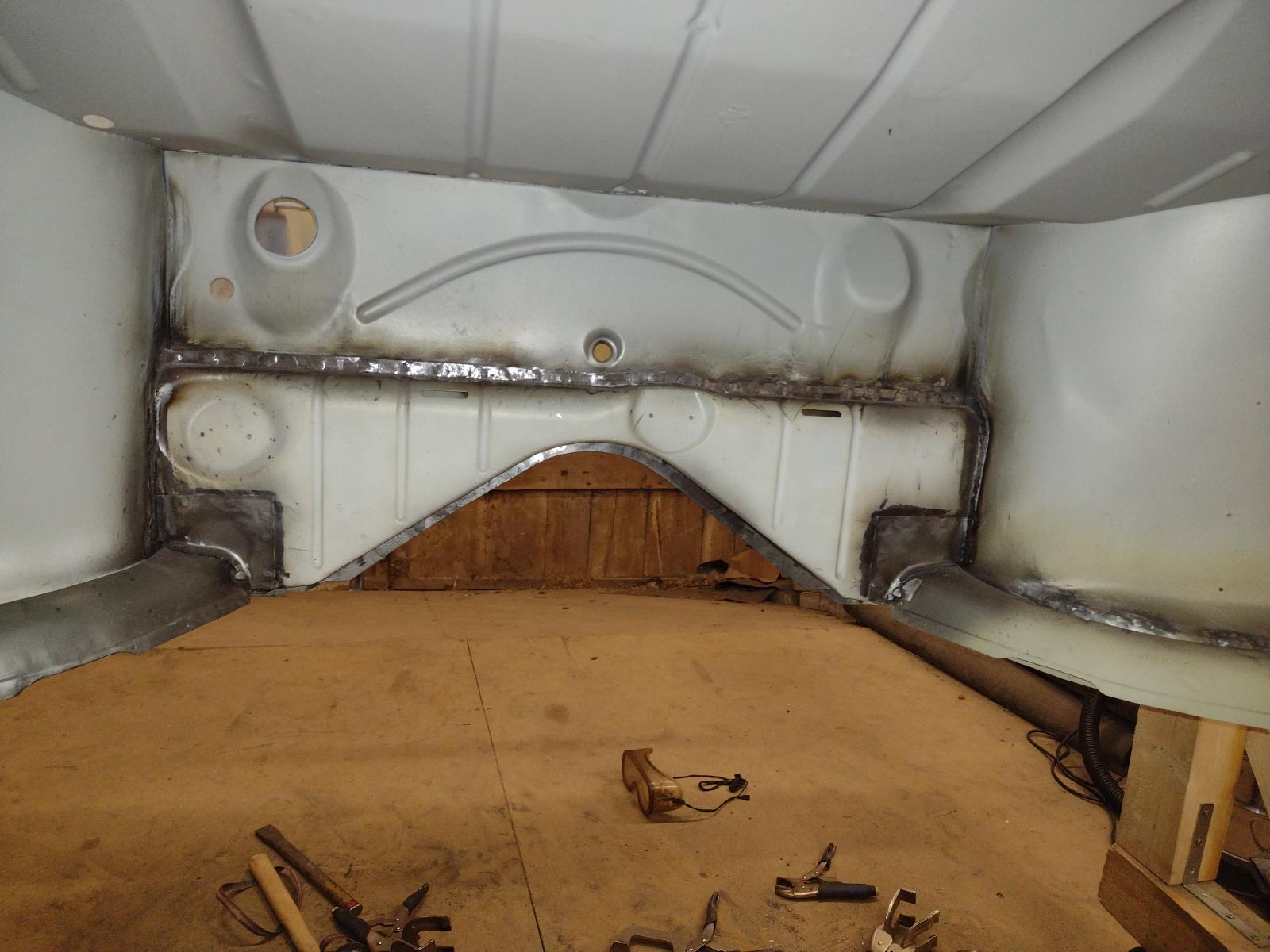

So, continuing with the underdash part, I did repair it before, putting in position :
Looking good but something is missing here :

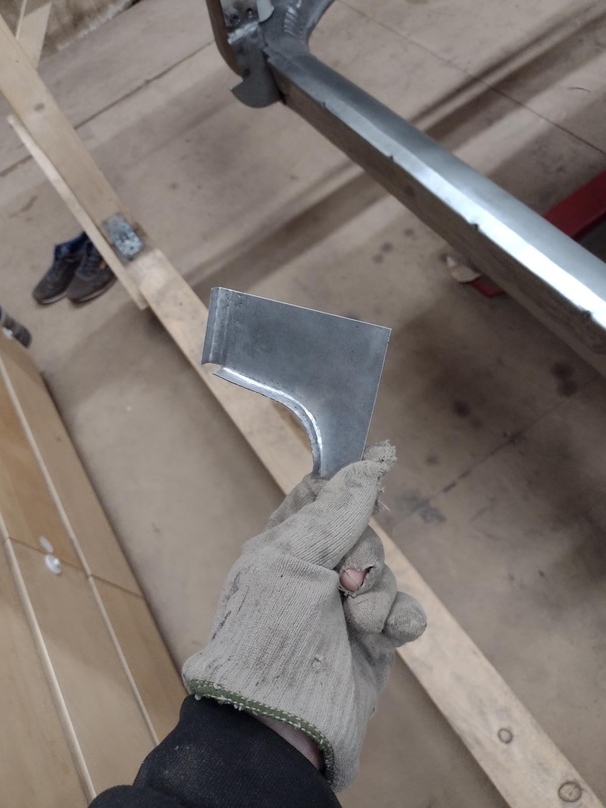

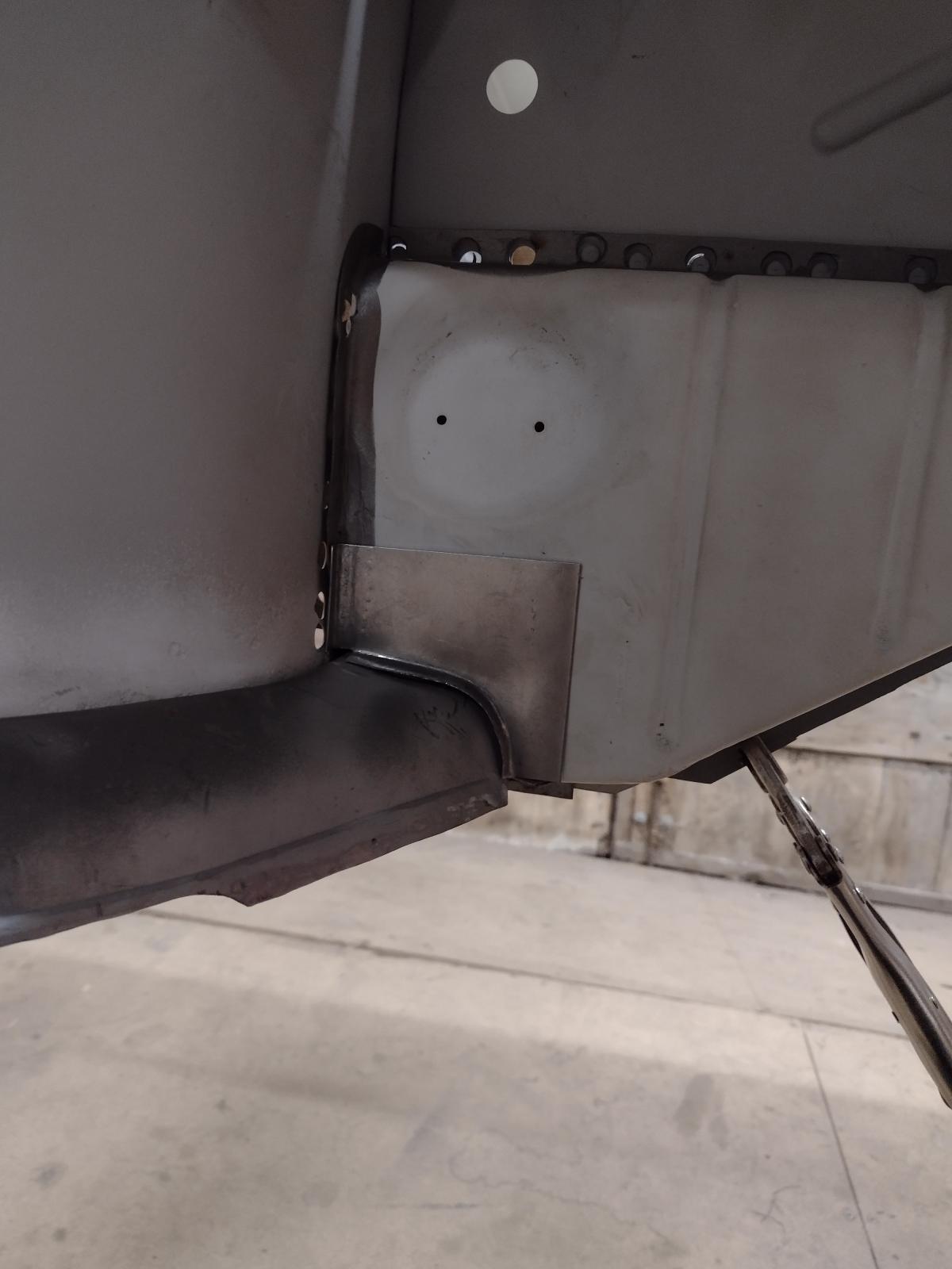

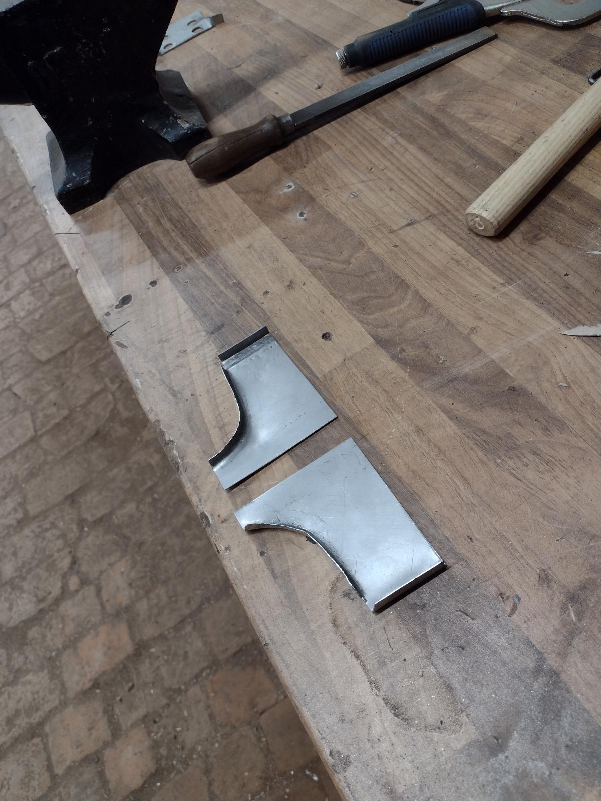

Yes the connection part to the heater channel so I am building it:
Test fit:
Looks good so building the second one:
Test :
And welded on:

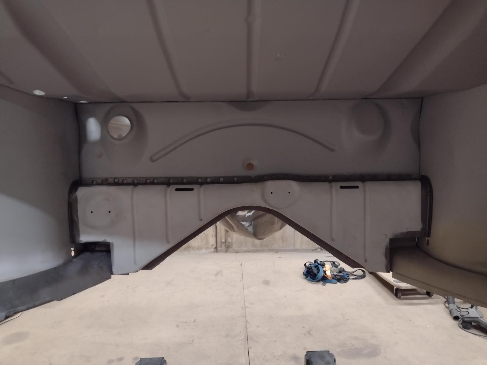

All welded back on the body:
And checking the fit with the pan:
Loving this view:
