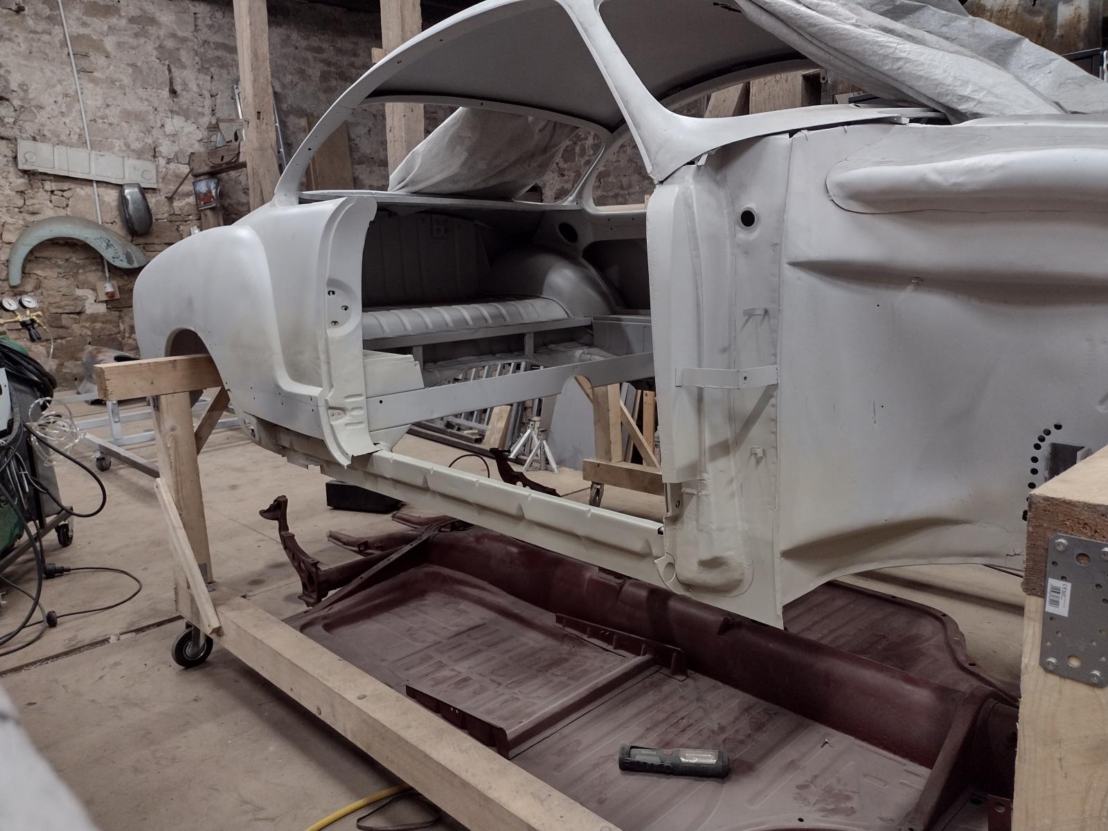

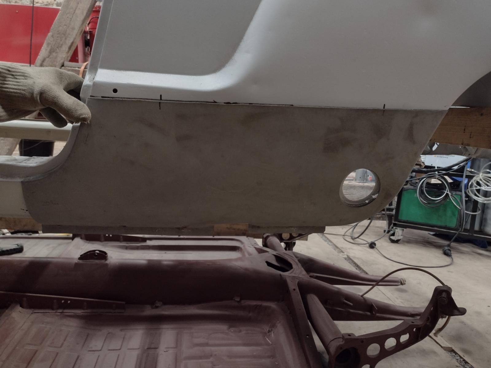

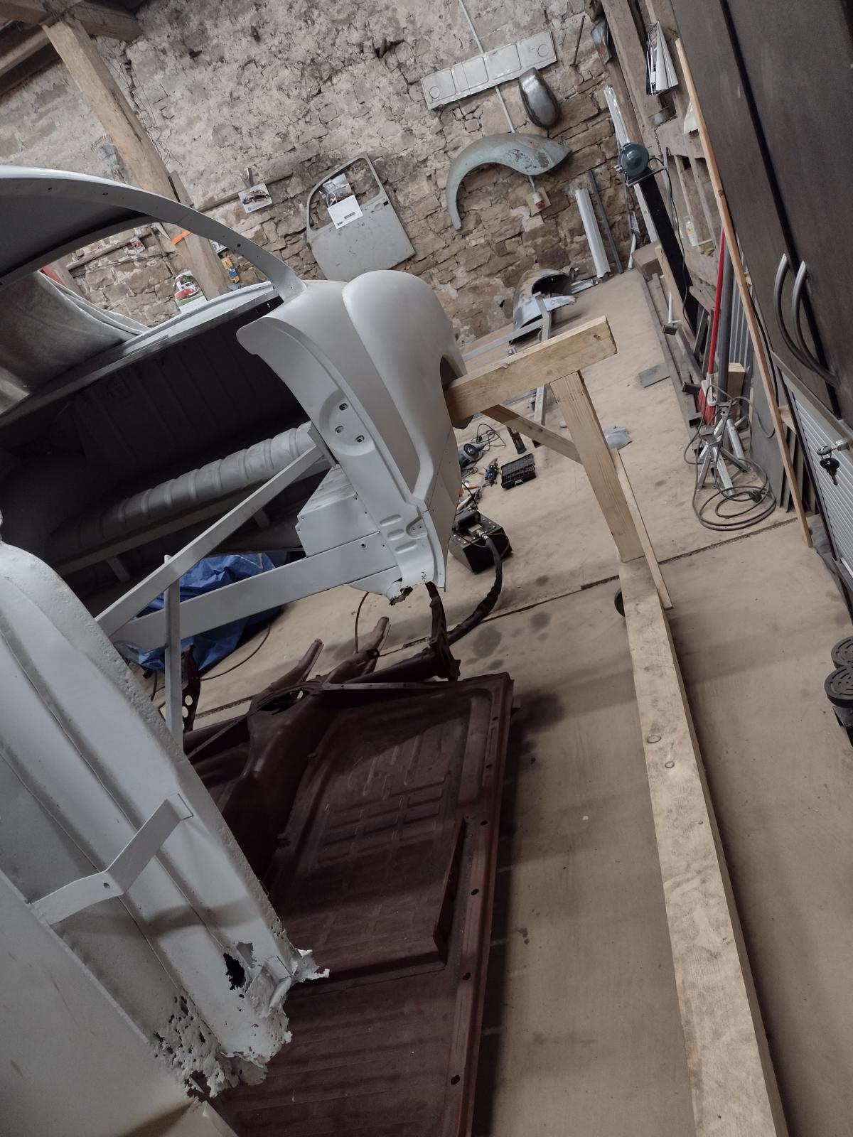

Thanks a lot, that's exactly the point, I am having a lot of fun in this build :-)
Time is rare but the heater channel is now fully welded and in epoxy primer :
Driver's side comes next!

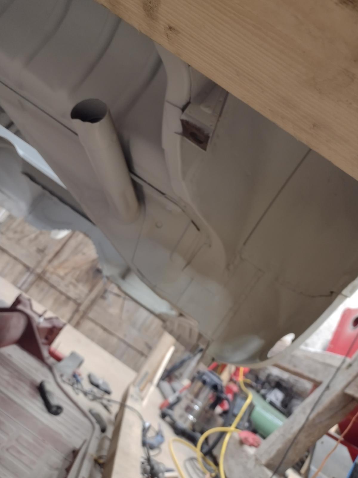

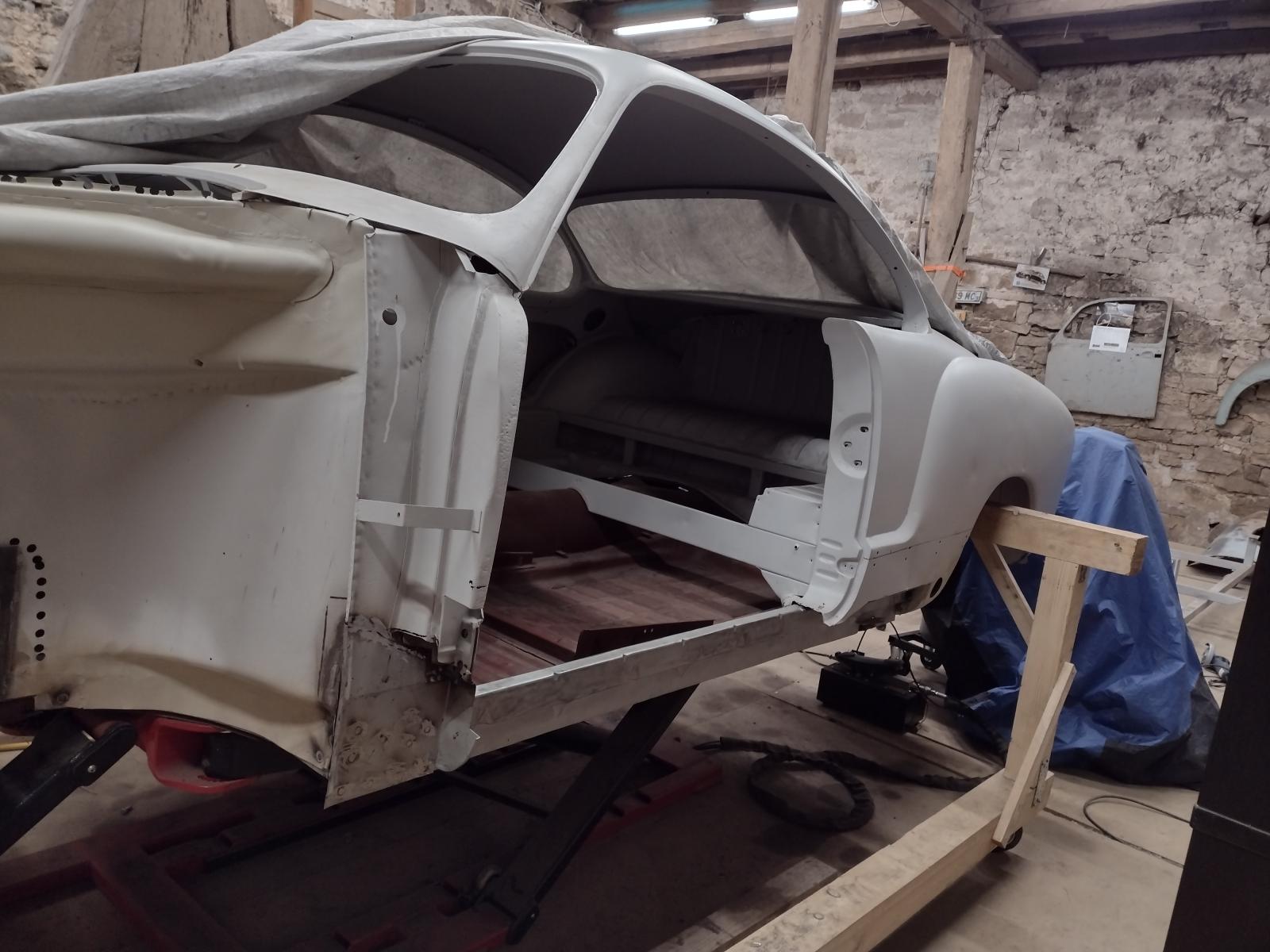

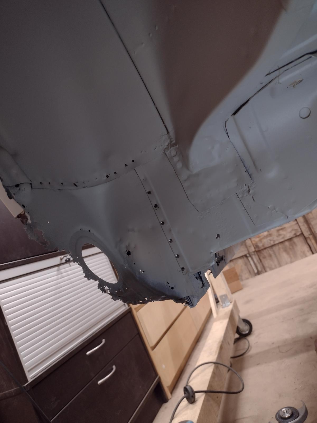

Looking at the driver's side, fun times are coming:
Starting (as the other side) with the back. I do have parts I did order at the start of the project so will save some fabrication time for this part of the car. So, let's start:
Really nice here ahah:
So let's remove the corner by cutting every weld point:
In order to weld this part:
Here:
I hope to have time next week for it.. let's see !

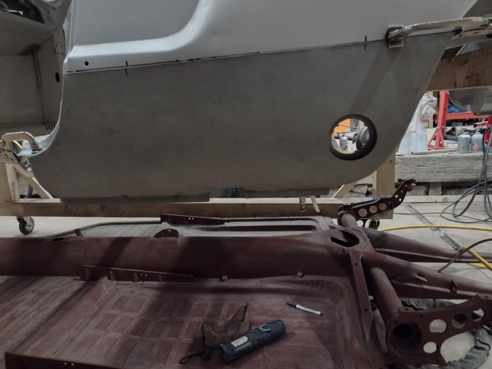

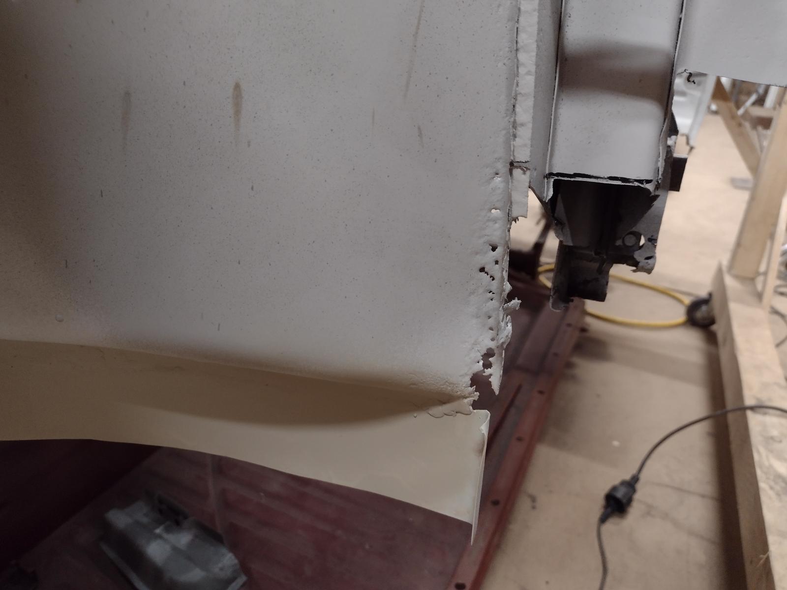

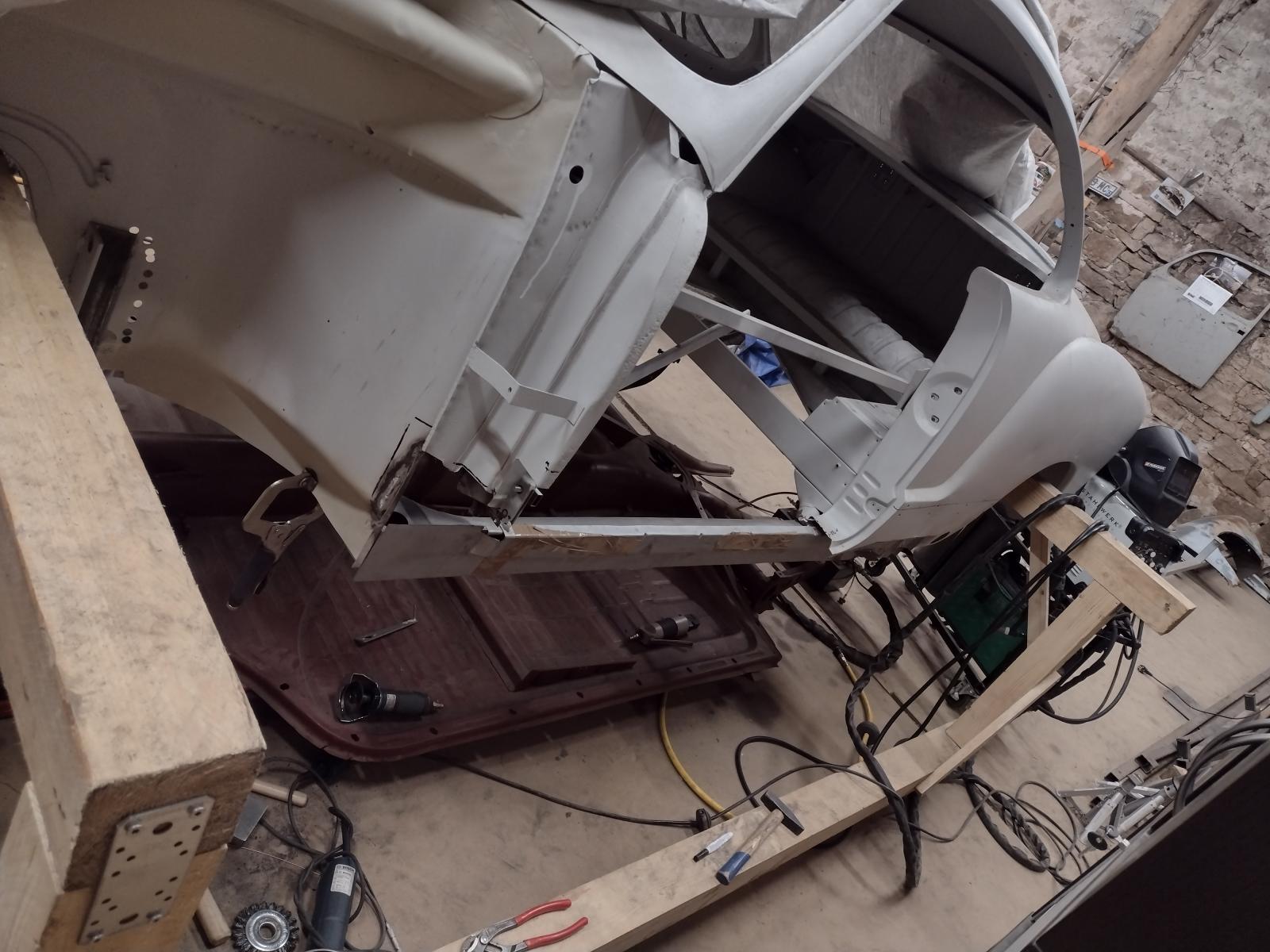

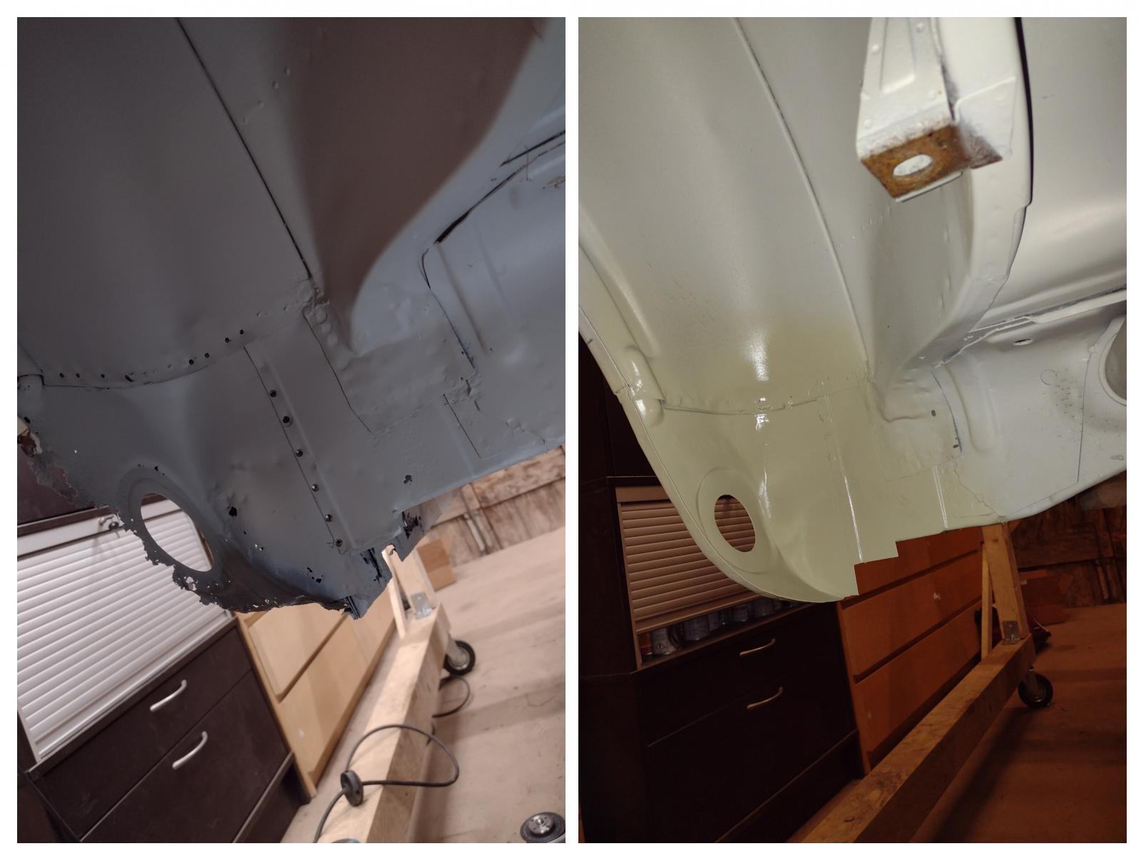

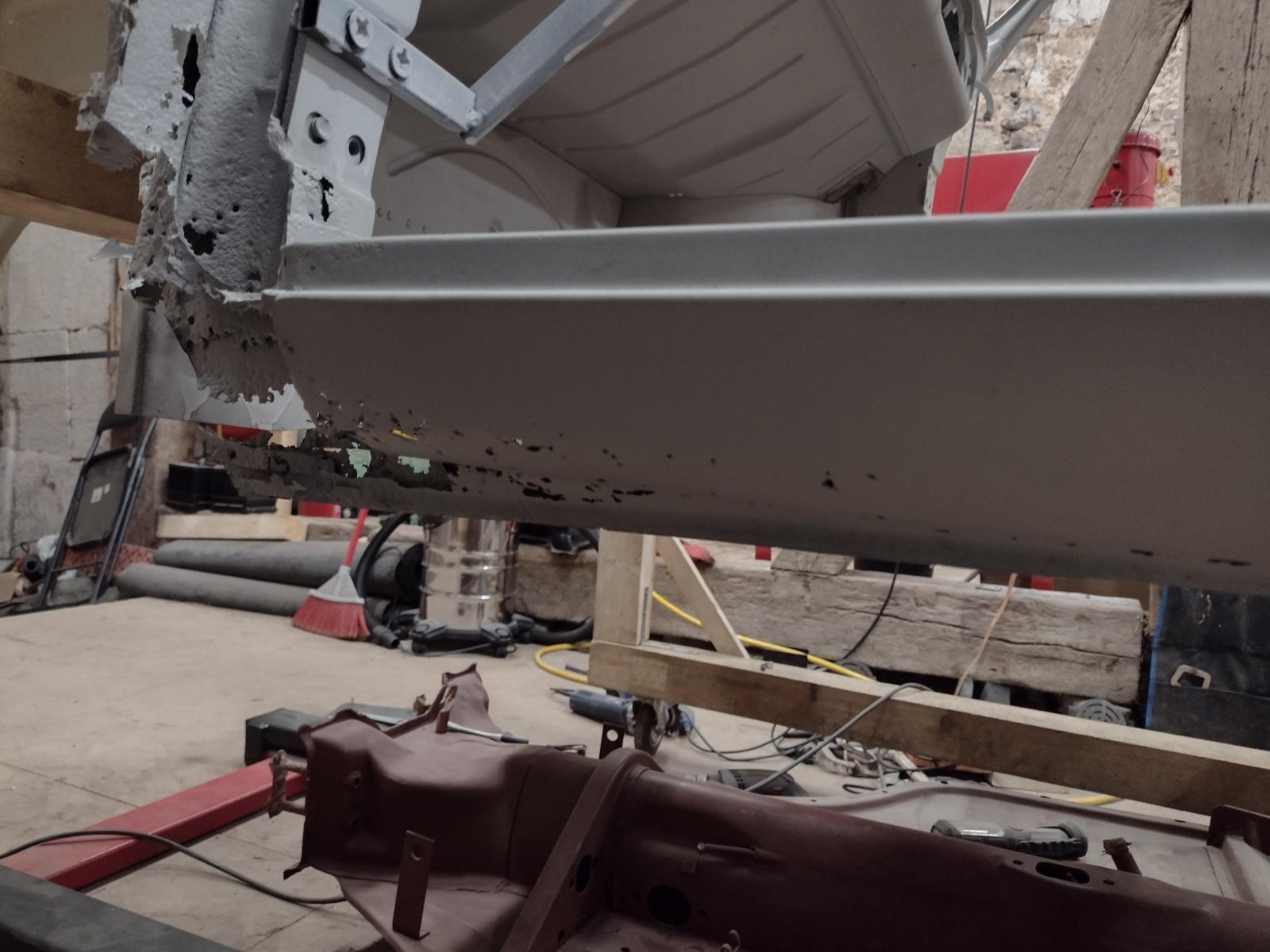

So, I did continue a bit, first by removing the end panel I needed to replace:
You can also see that the bottom corner of the panel next to it was also to replace, that's why I marked it.

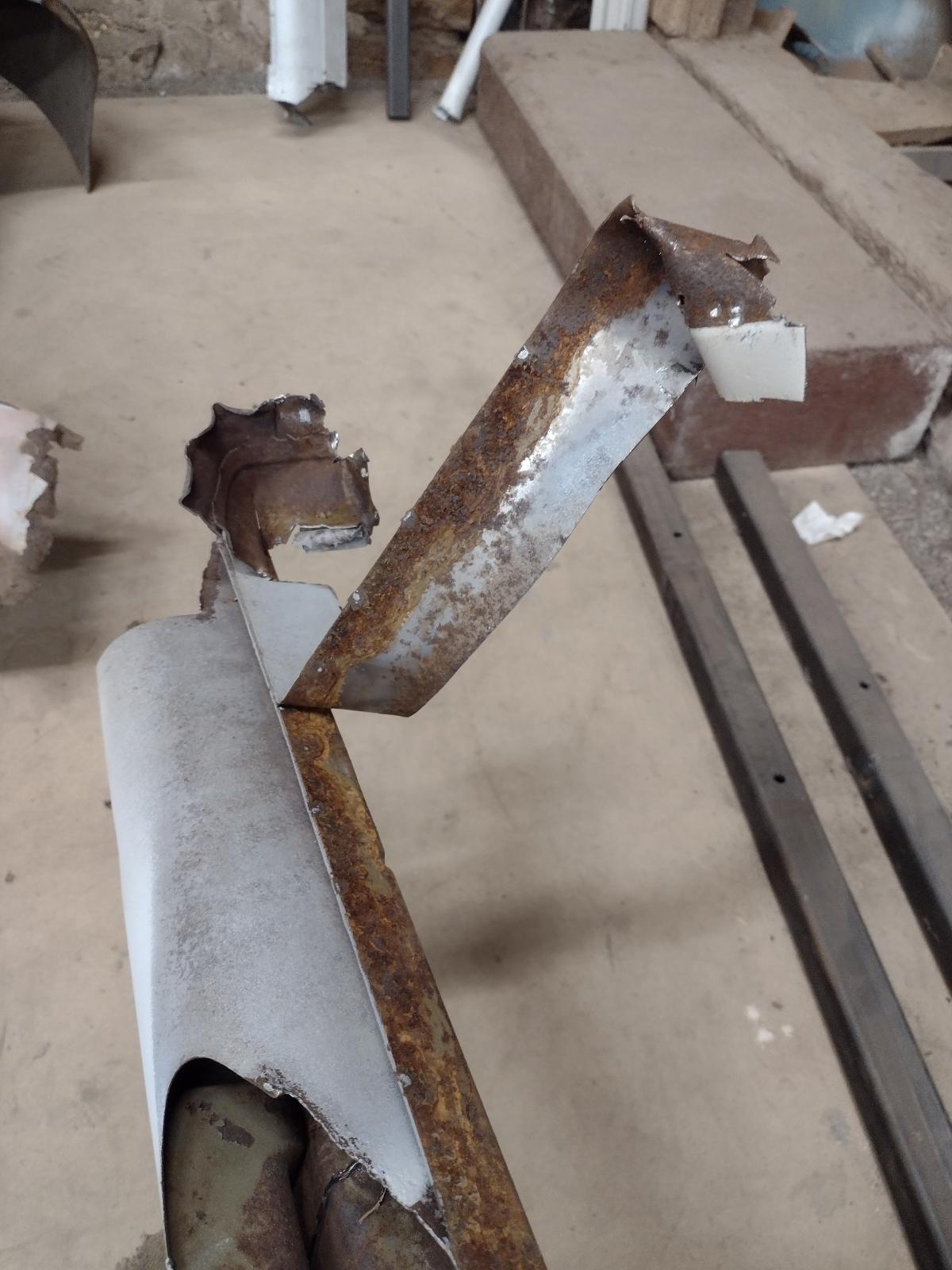

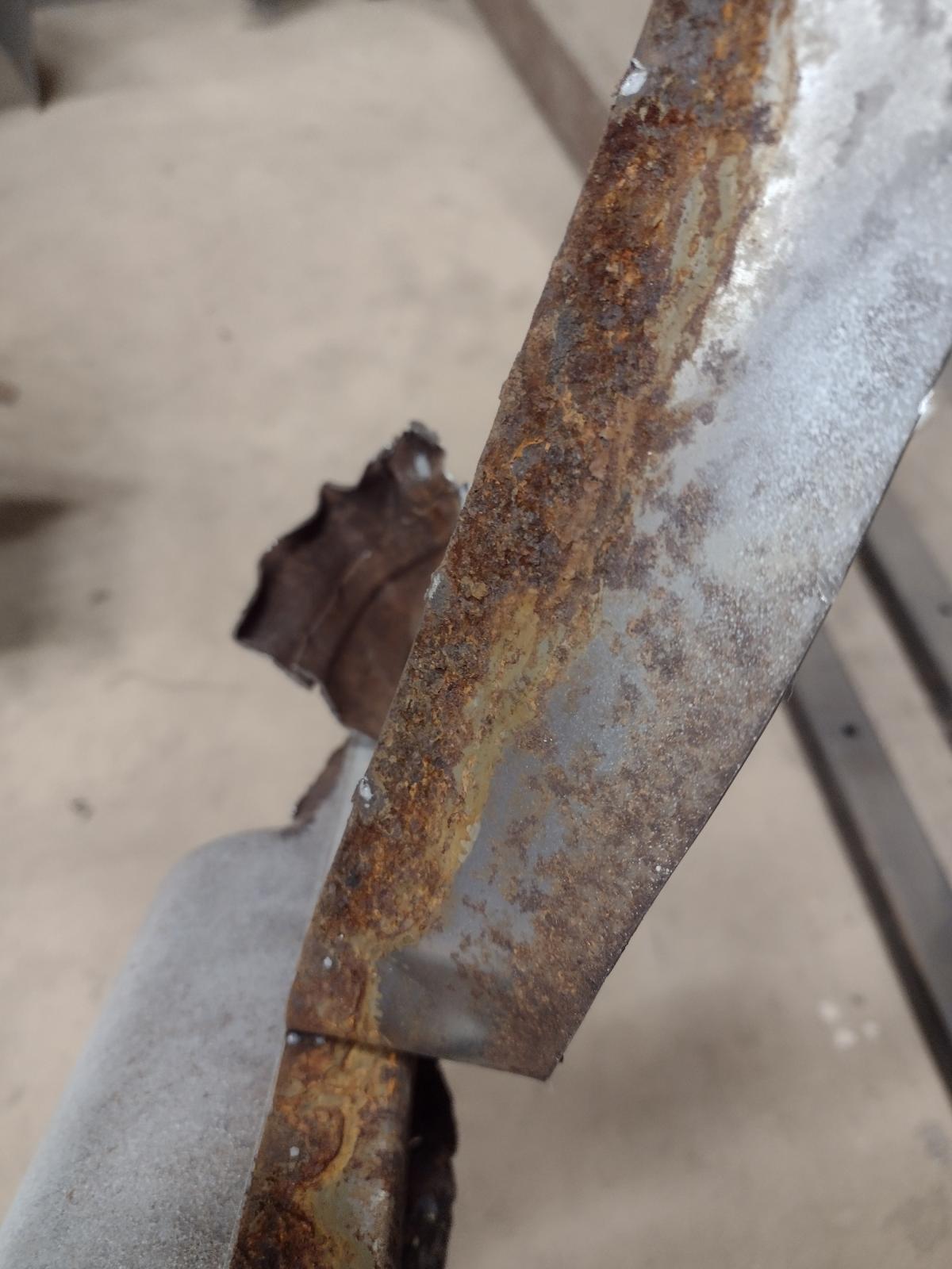

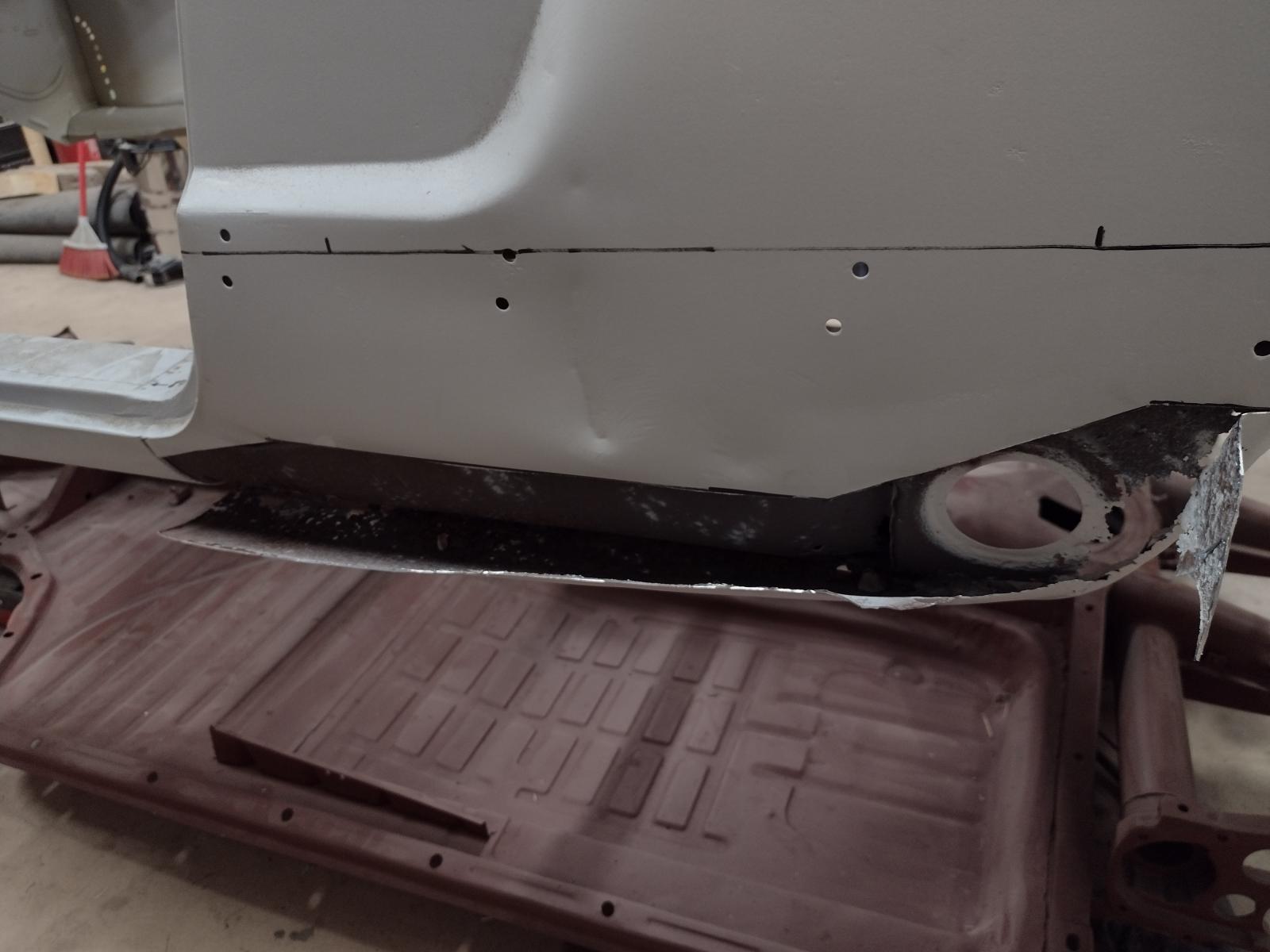

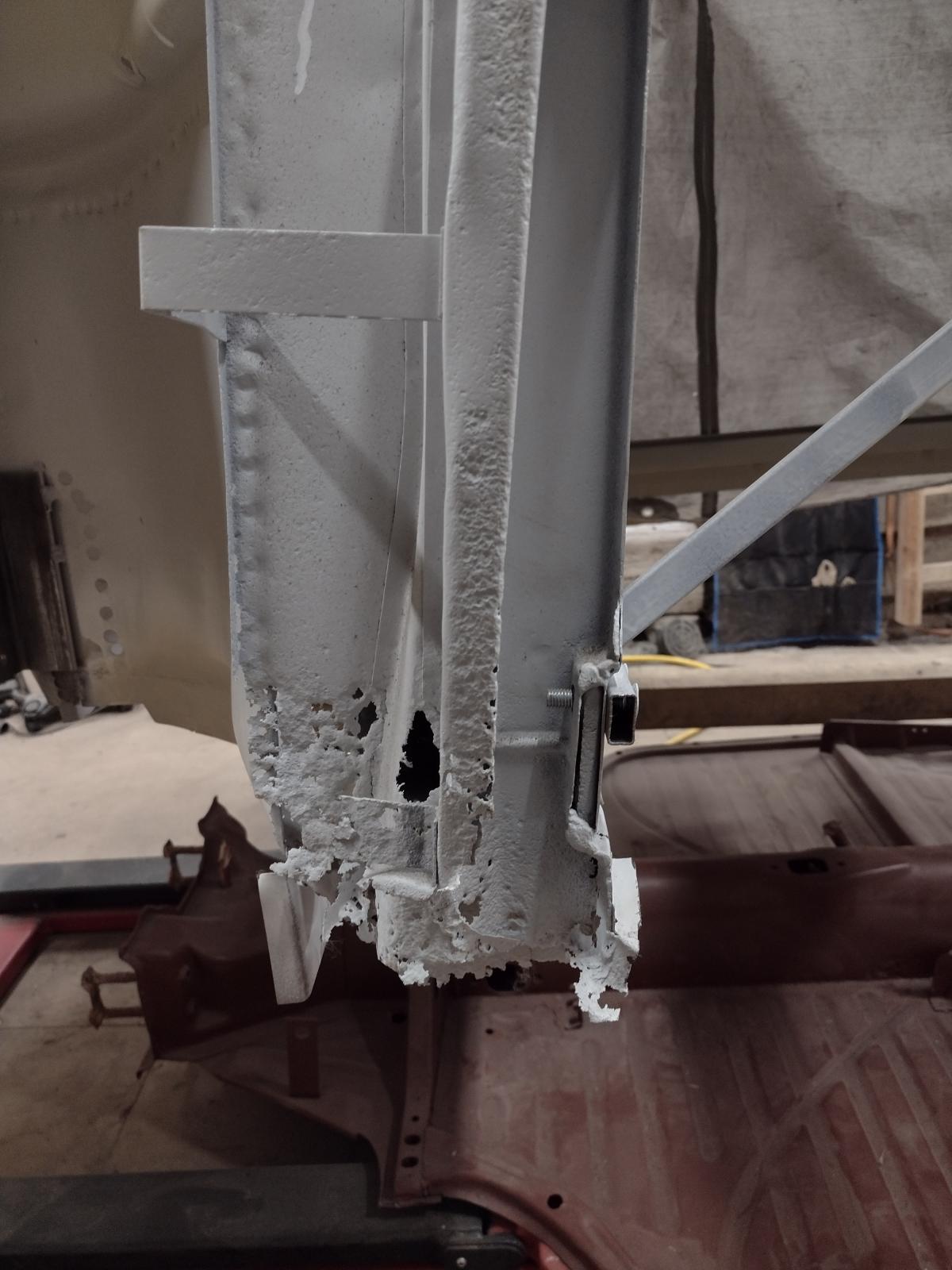

Then I removed the whole heater channel :
You can see why they all rust from inside-out, you find bare metal inside the heater channel..

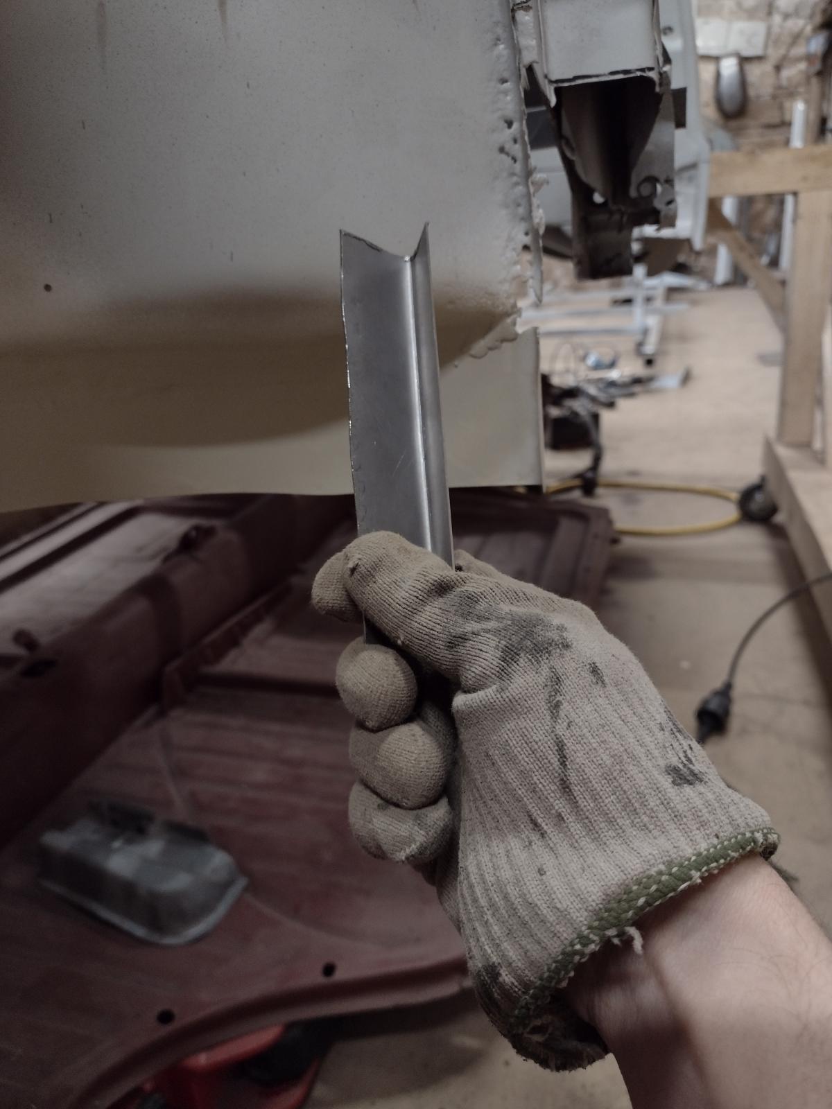

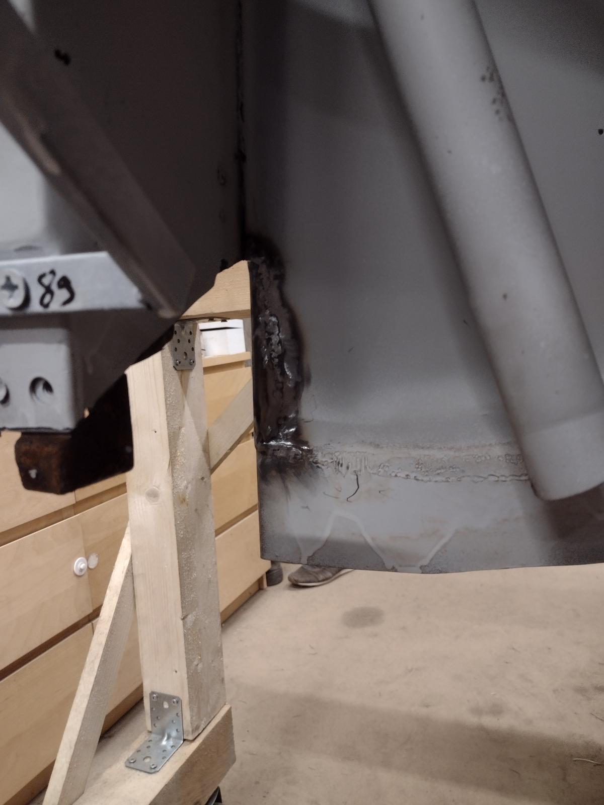

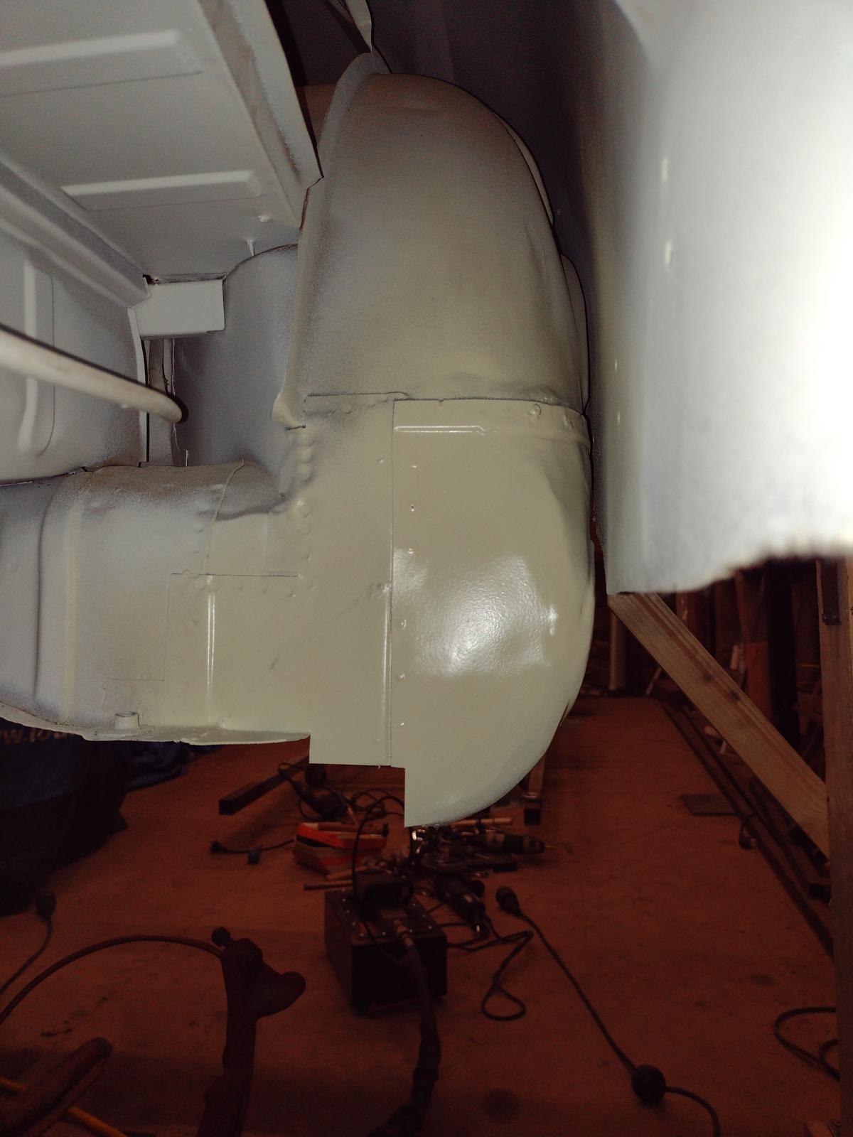

I then started on the little corner :
Making the patch:
And fully welded:

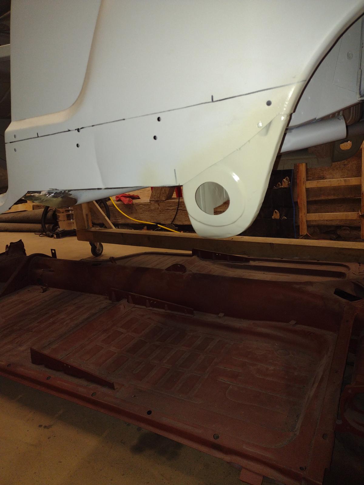

Then adjusting the end panel:
And welding:
Some epoxy primer:
And some before/after, always good for the motivation :

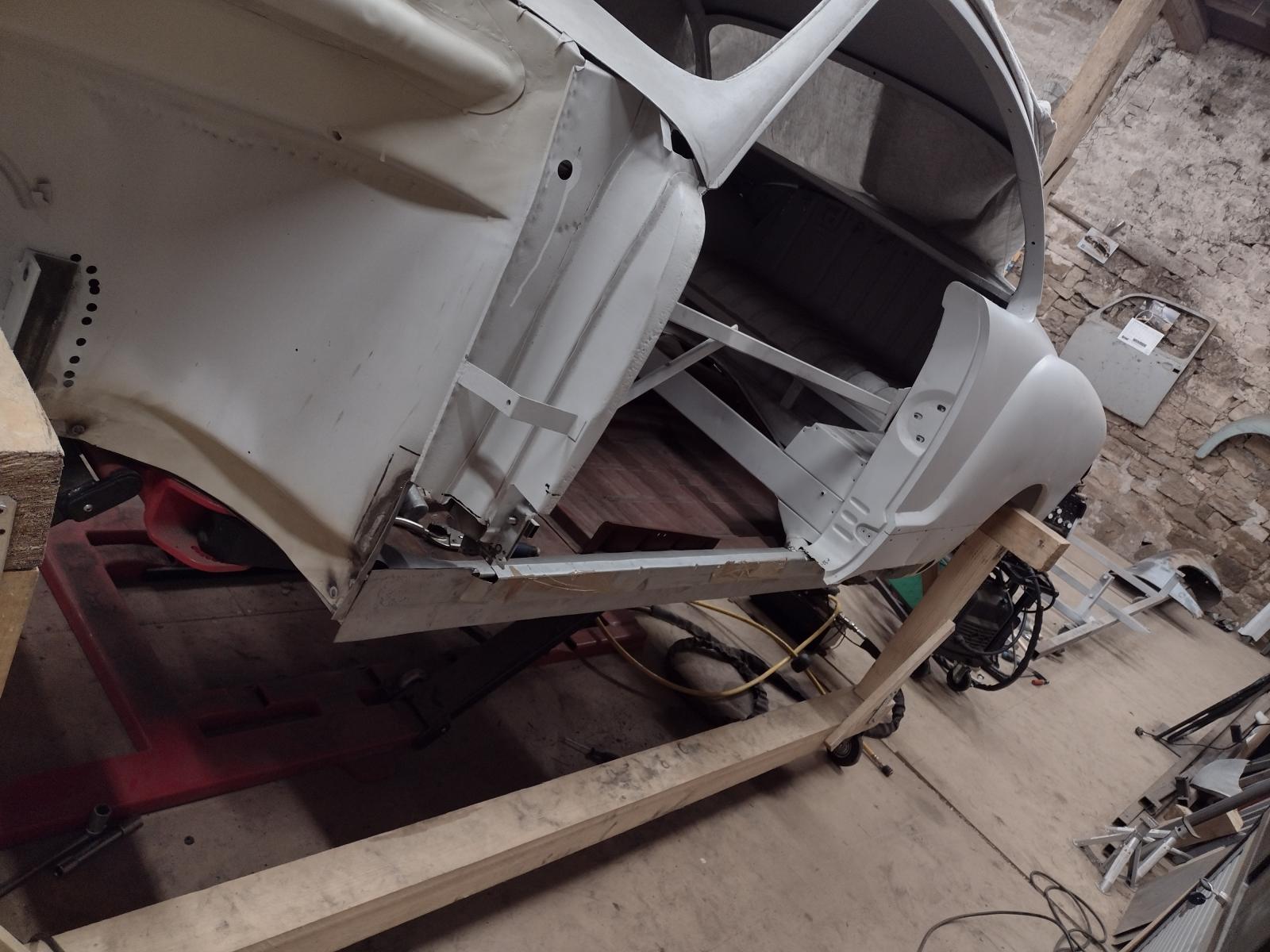

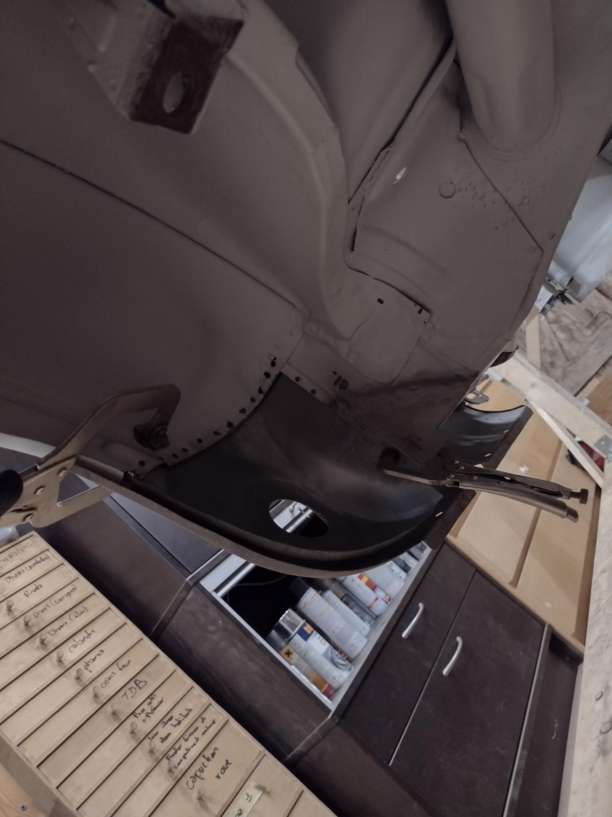

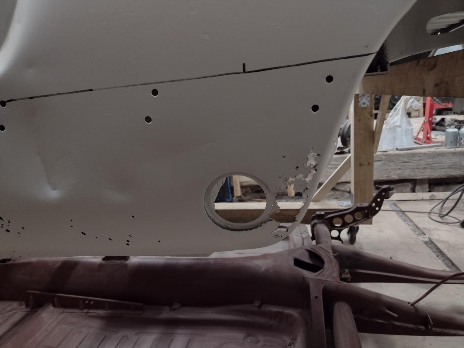

So, I did make some progress here :

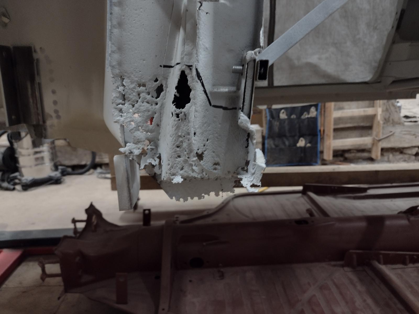

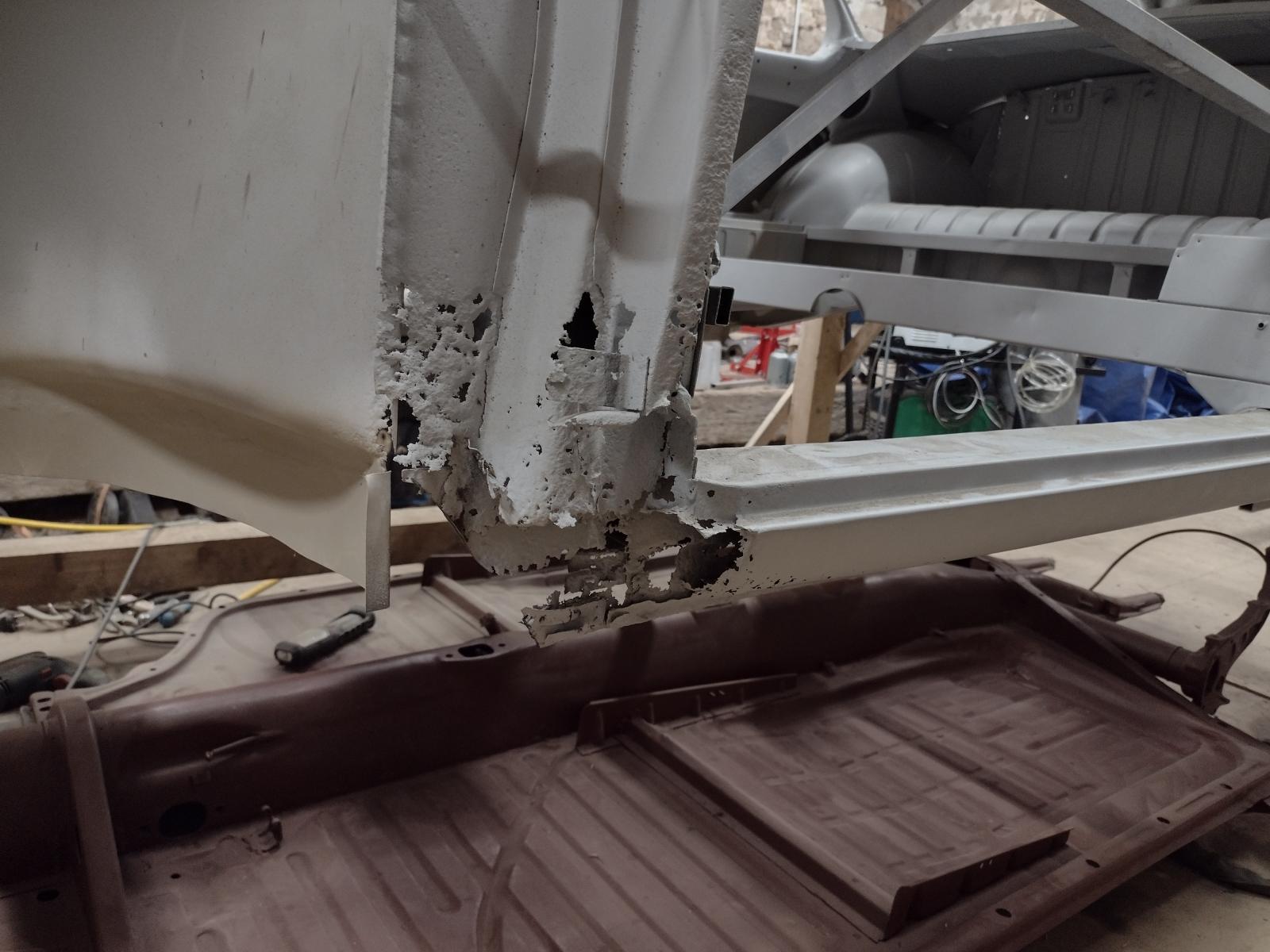

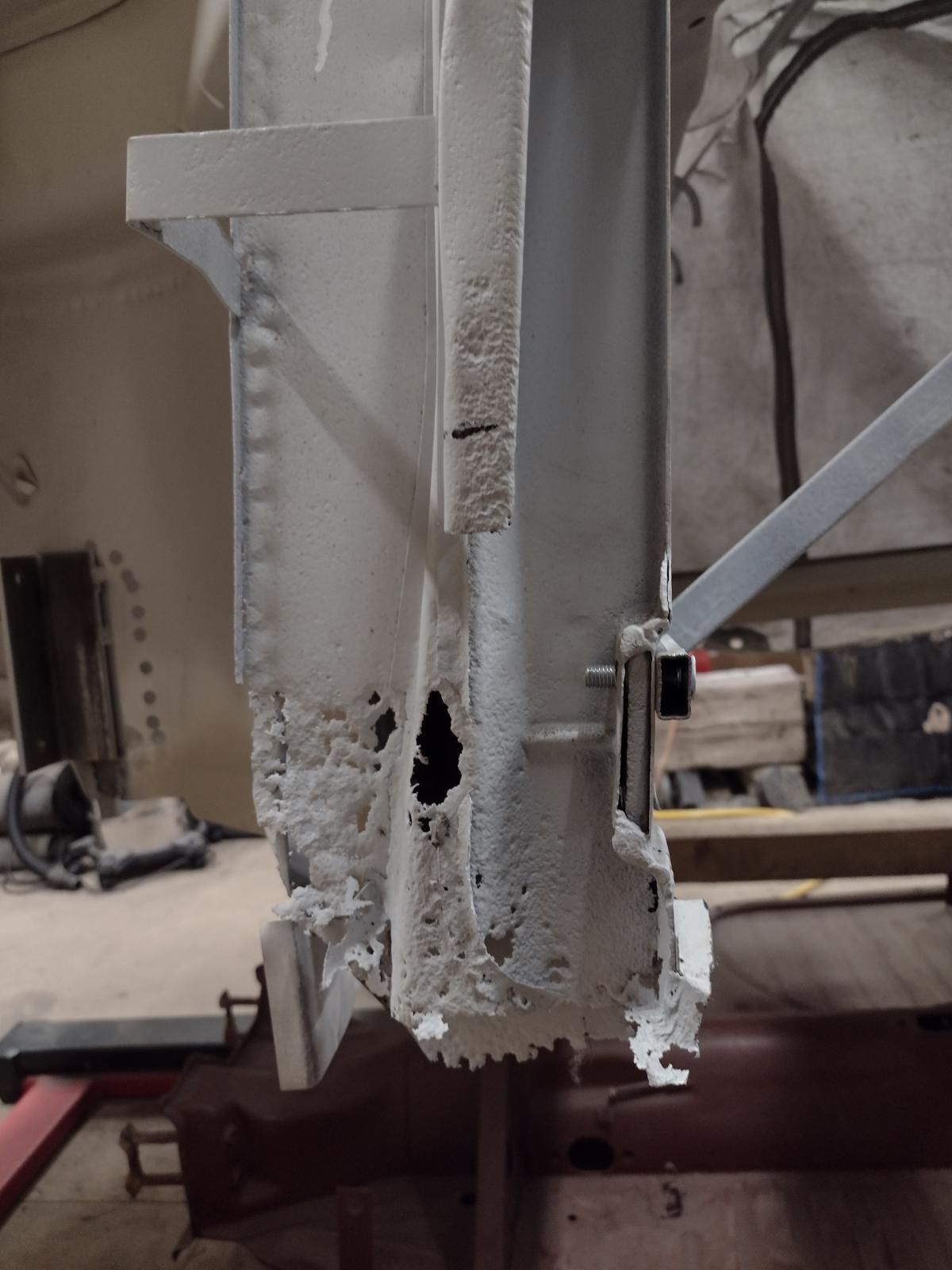

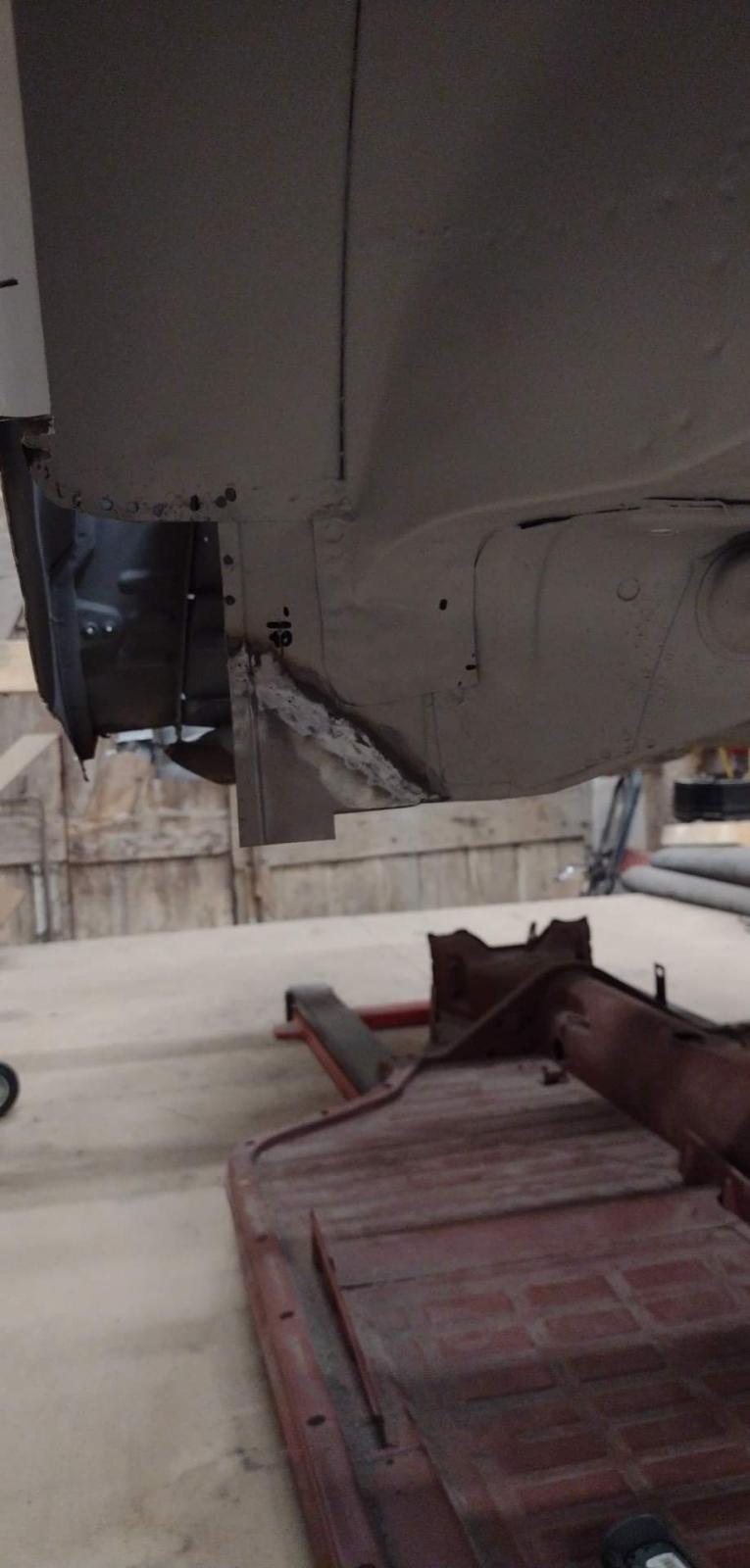

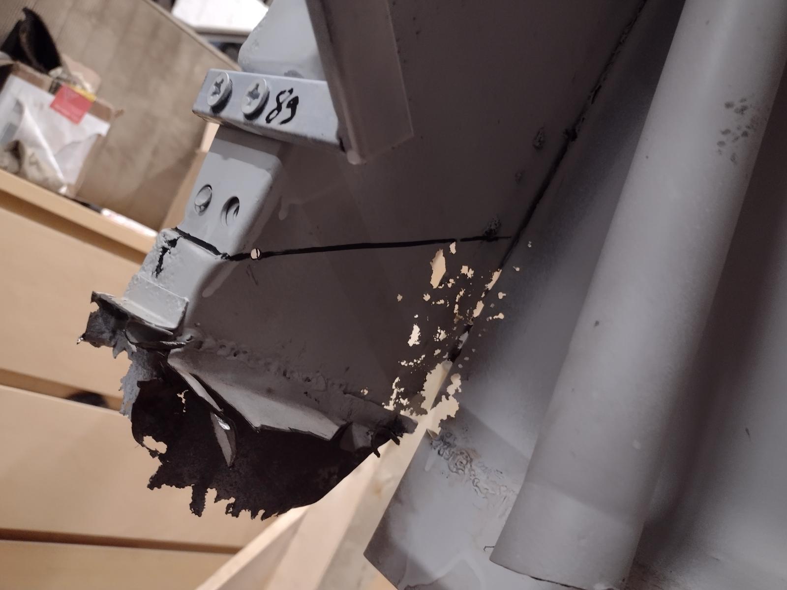

Turned my attention to the A-pillar :

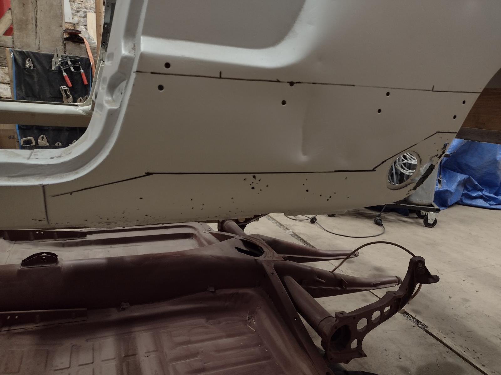

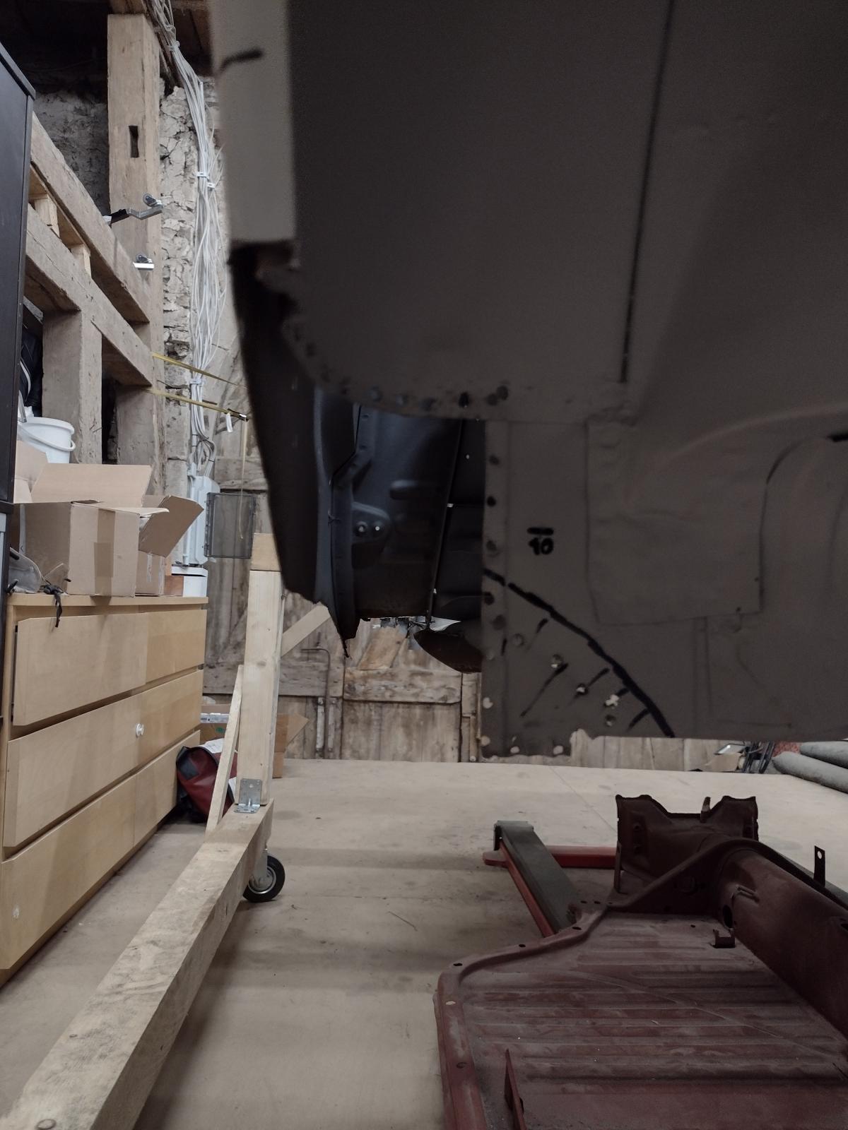

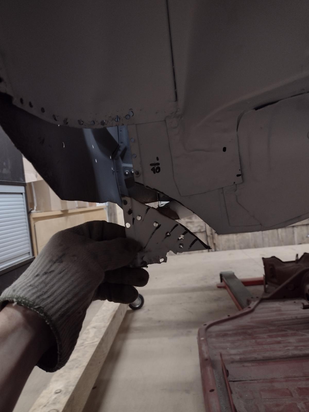

Removed the connection to the fender on the bottom:

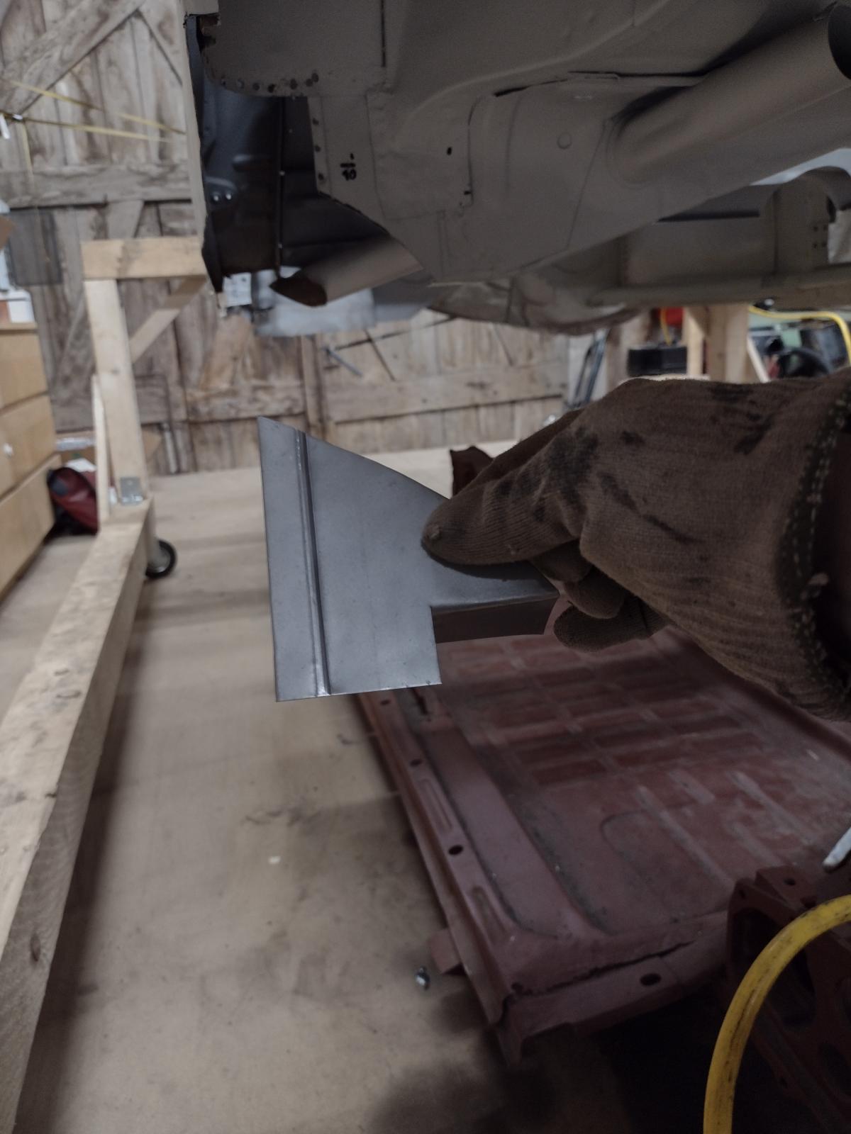

And draw the minimum amount of metal to replace:

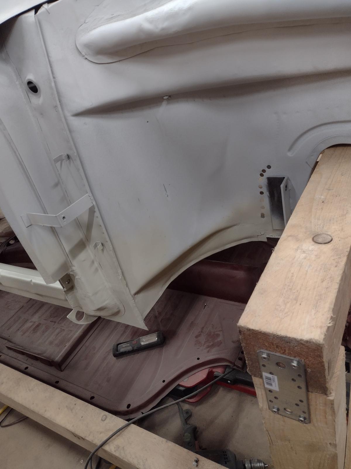

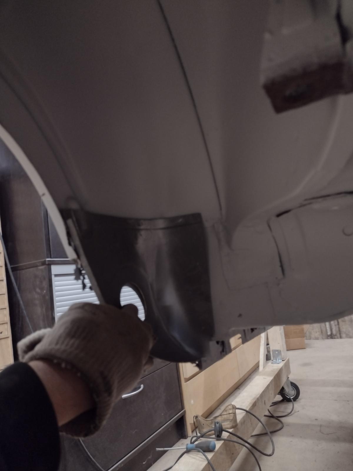

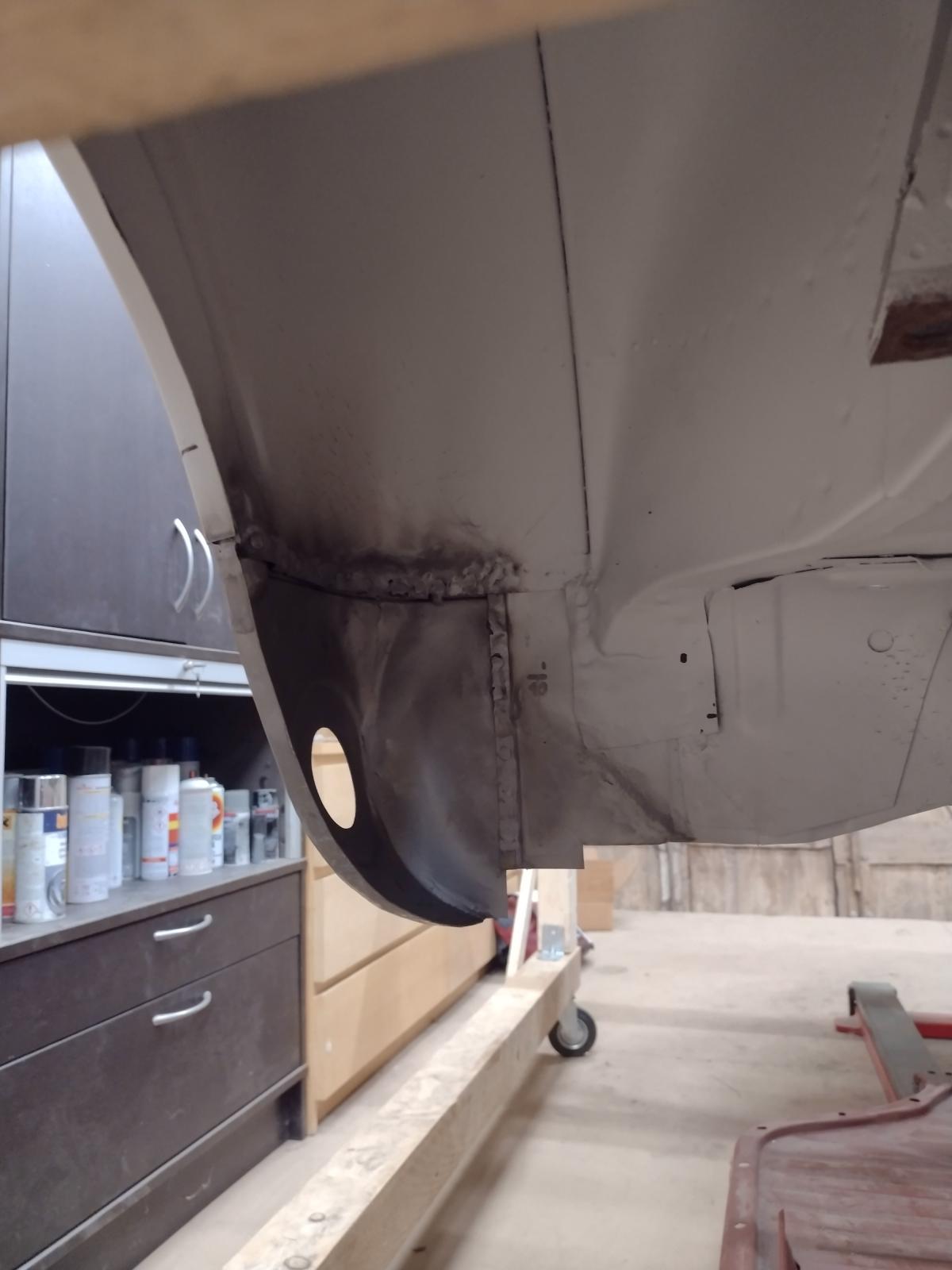

Made some space:

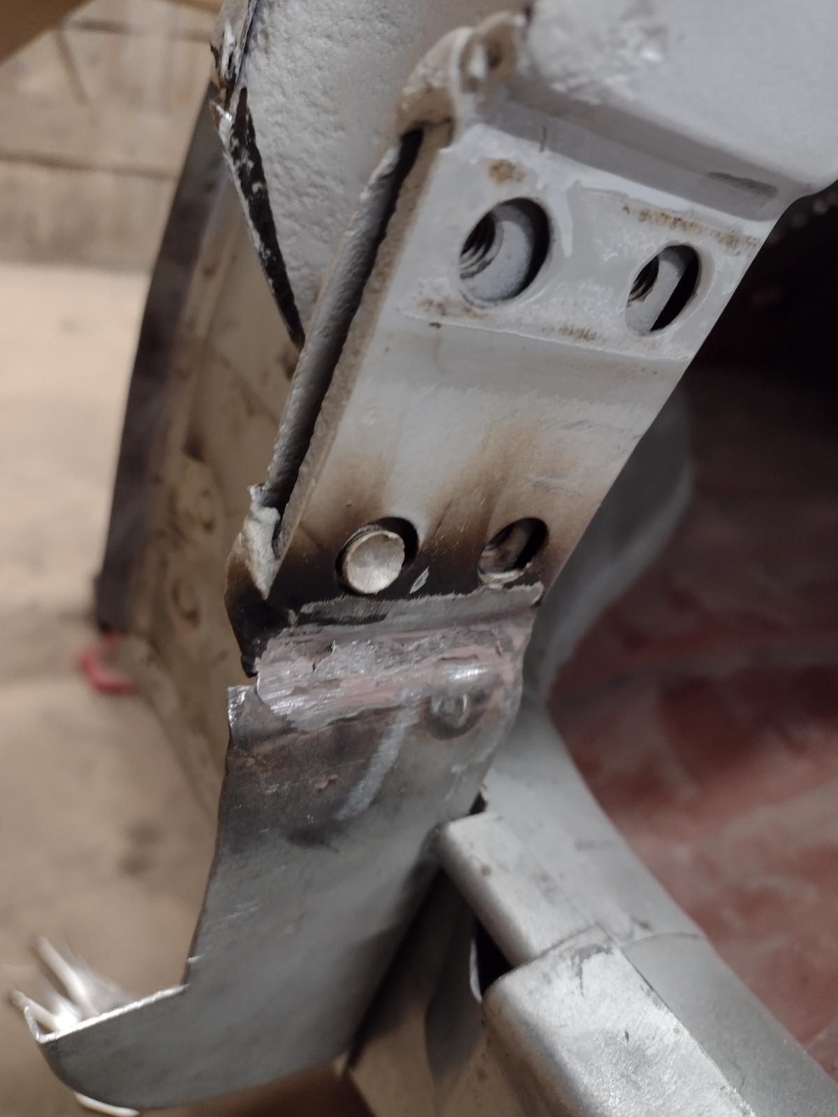

And repaired the part in the wheel well:
Stay tuned,

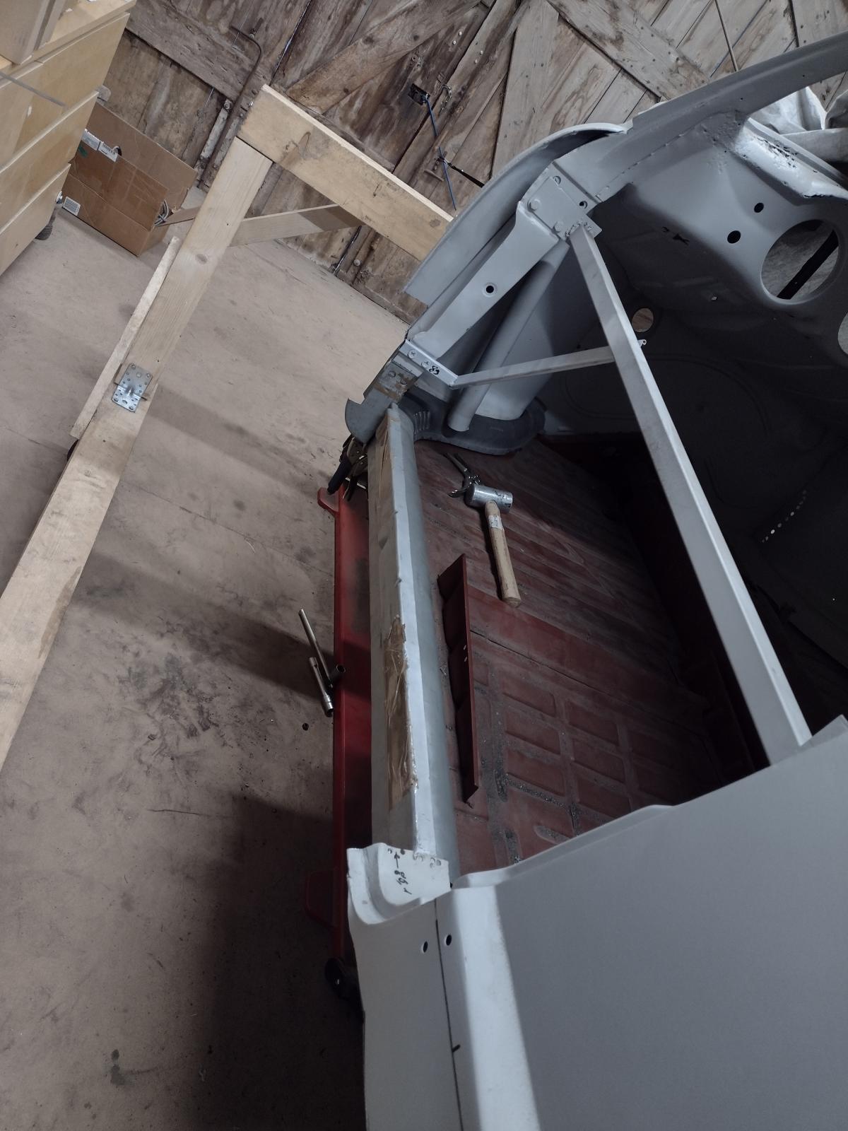

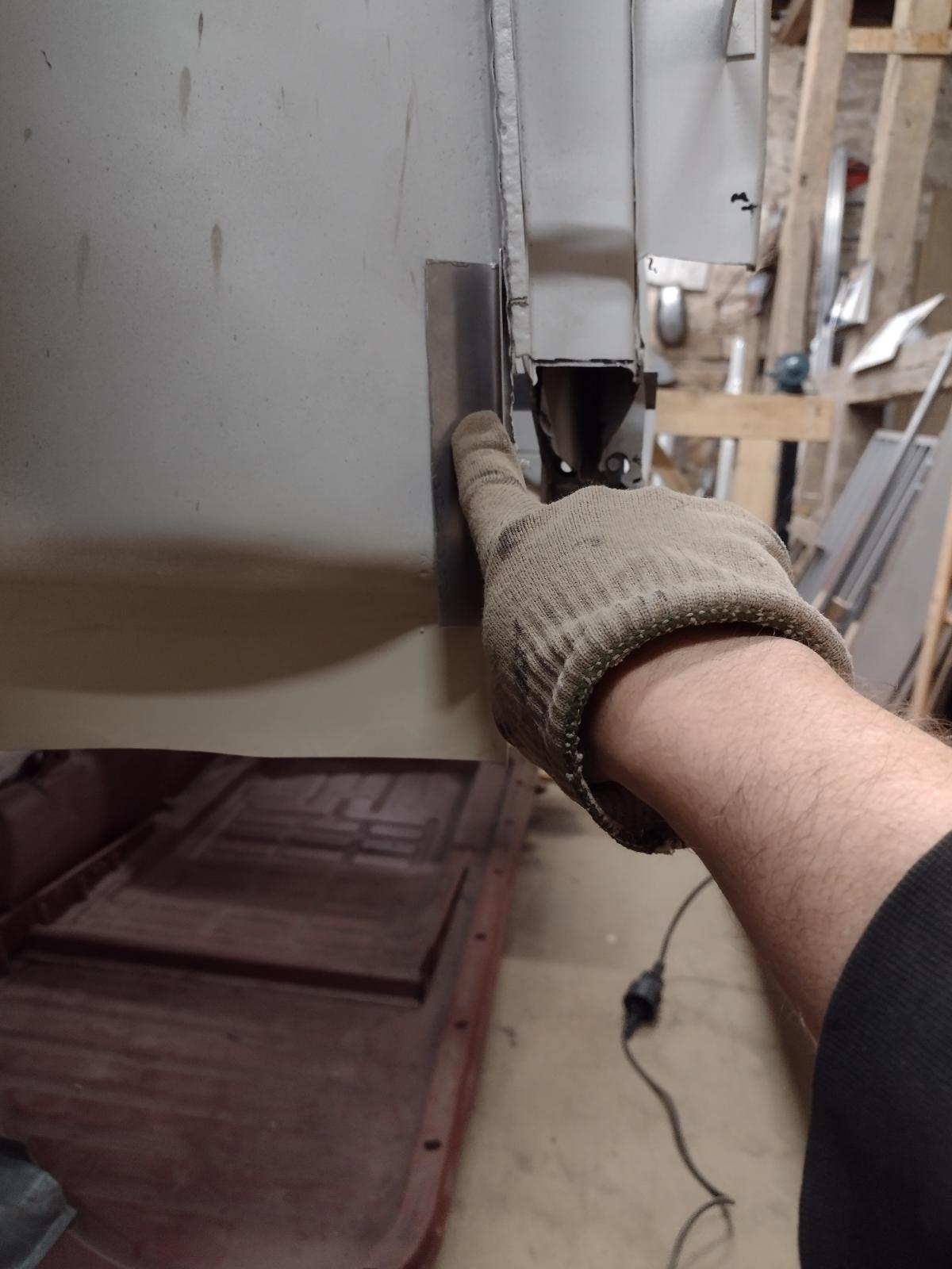

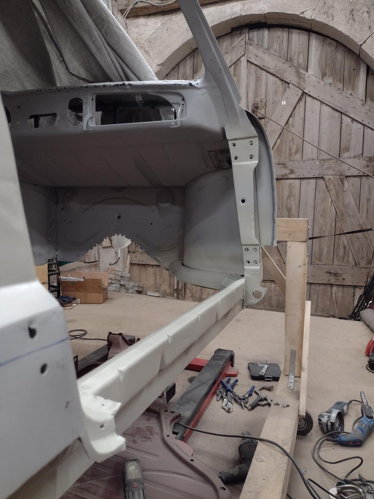

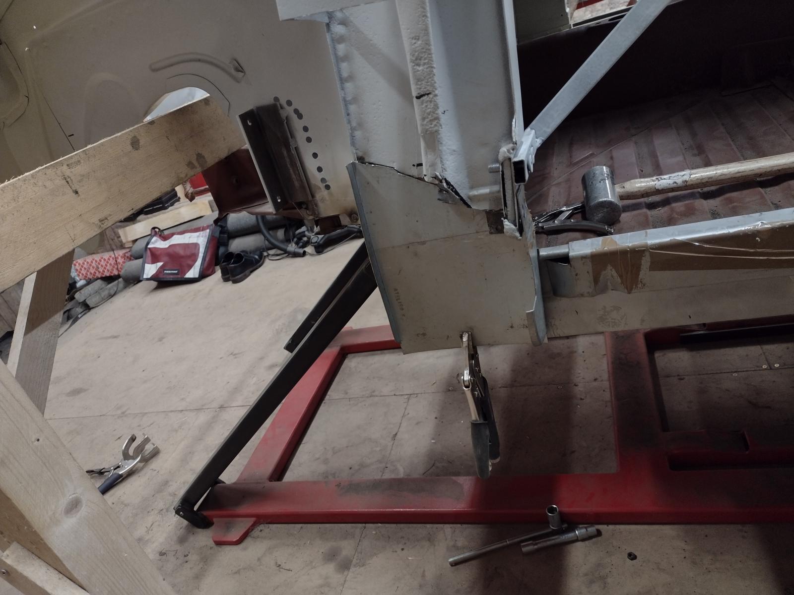

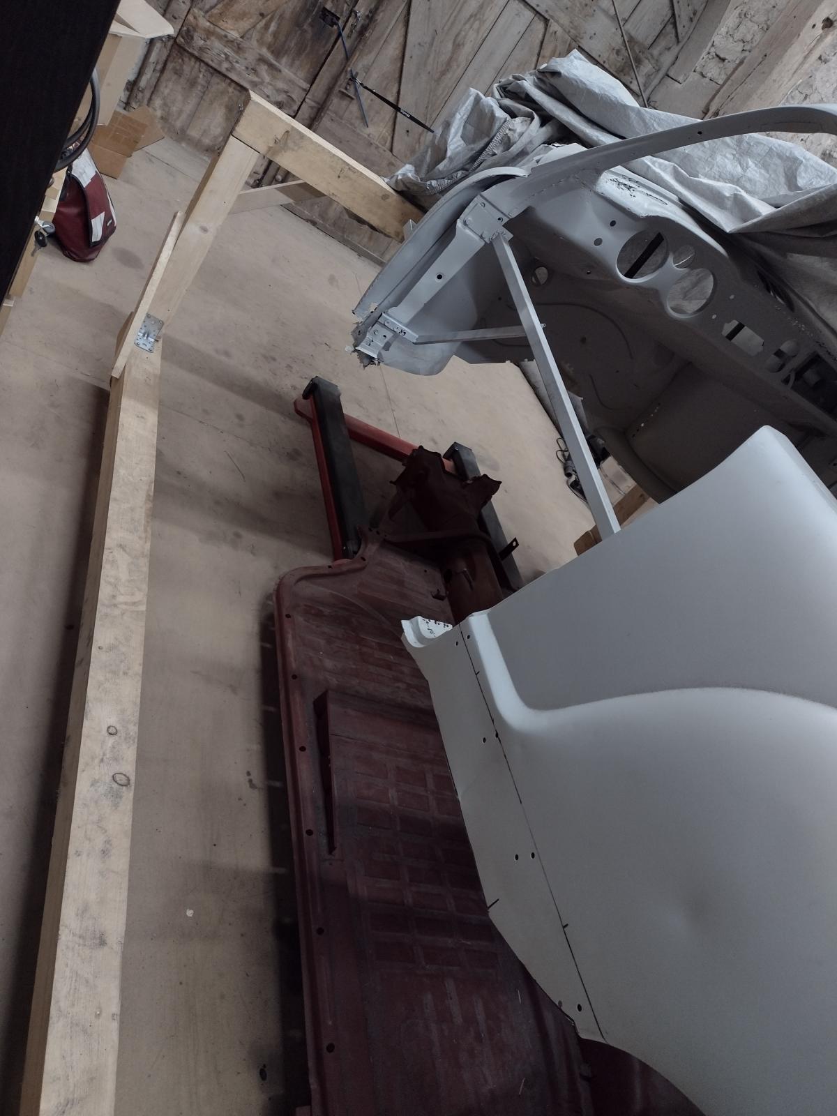

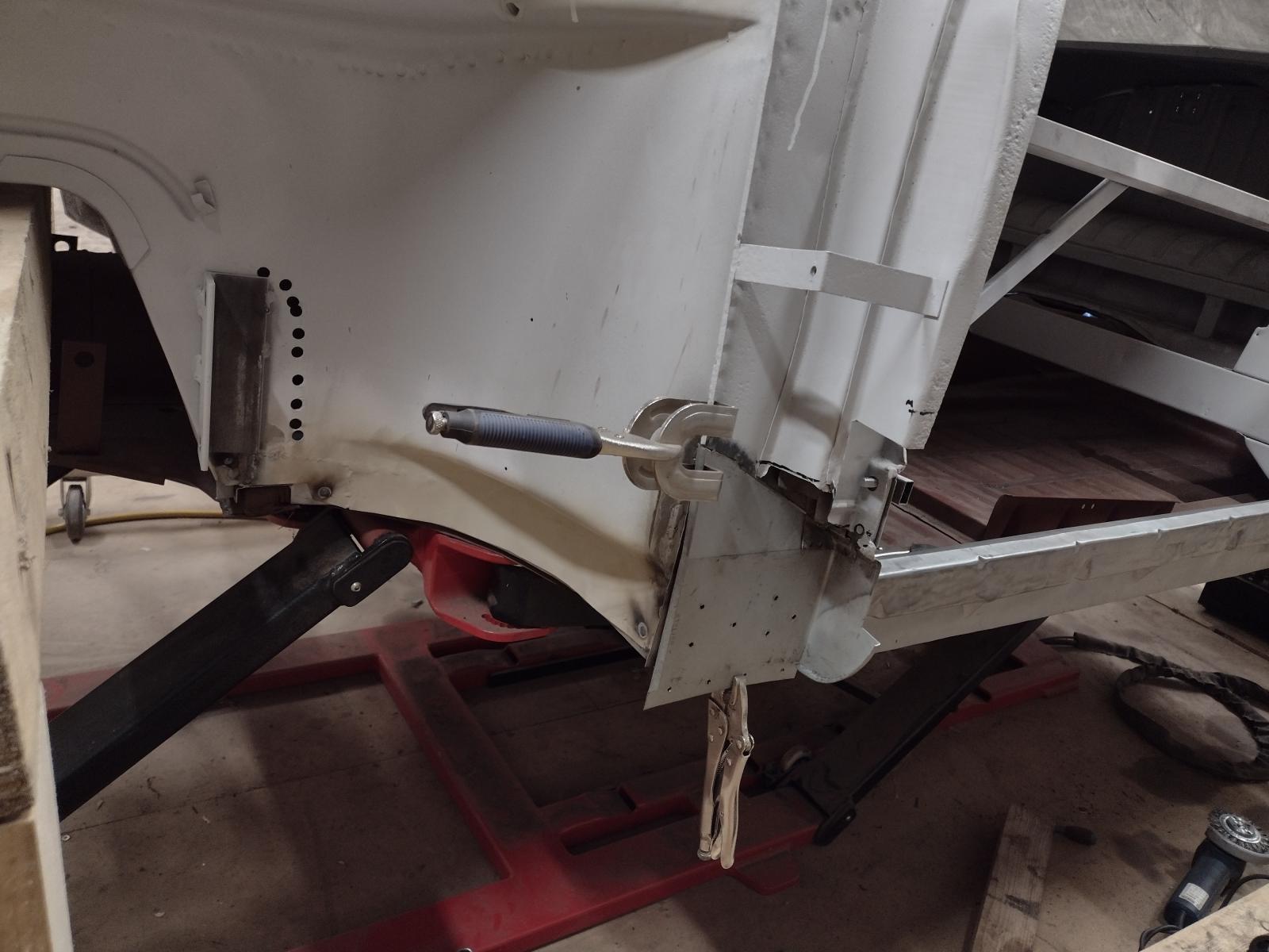

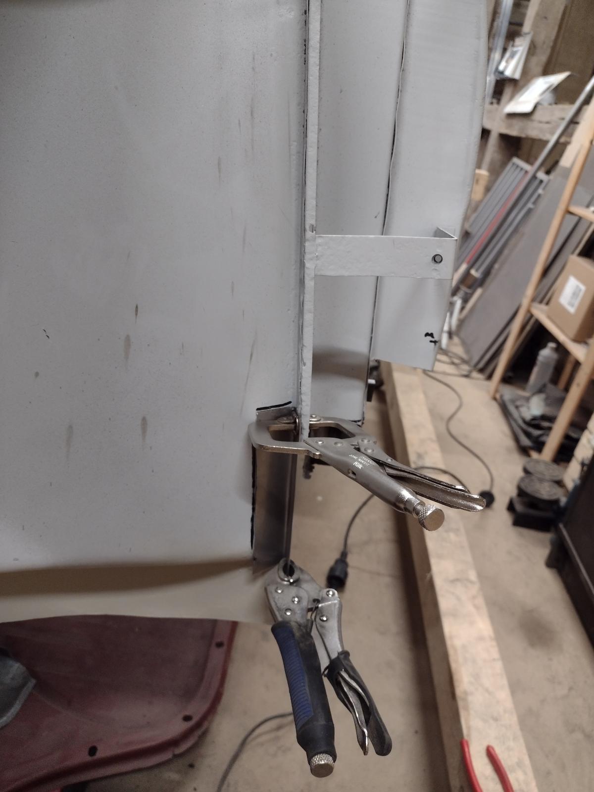

Quick check how the back part of the pillar will look:

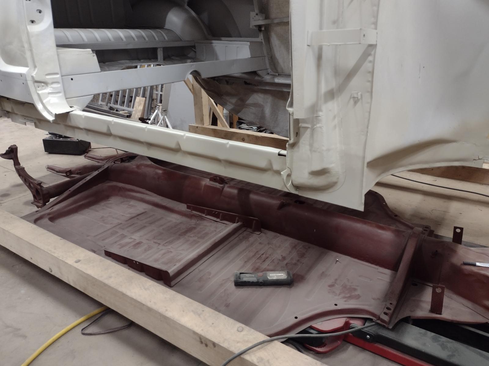

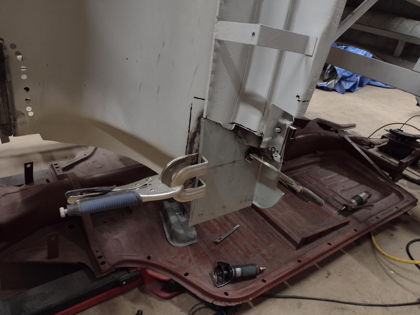

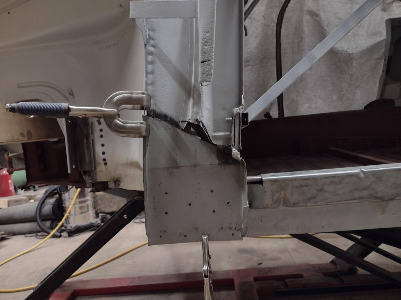

So,in order to adjust well my A-pillar and confirm all my measurements, I started by positioning my heater channel:
And then adjusted with the pan, screwed to it :
And a couple of spotwelds, it's in position:
To be continued!

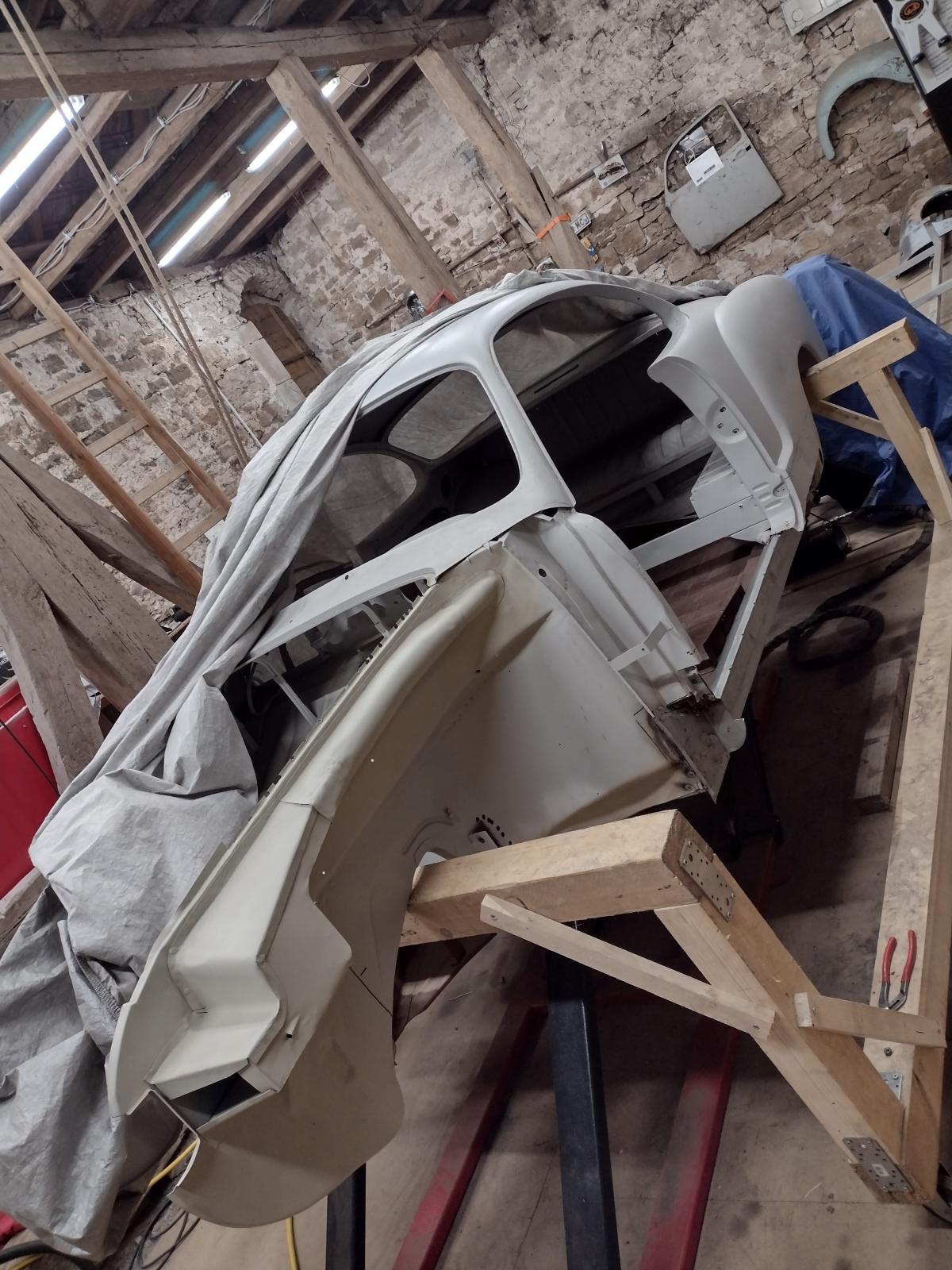

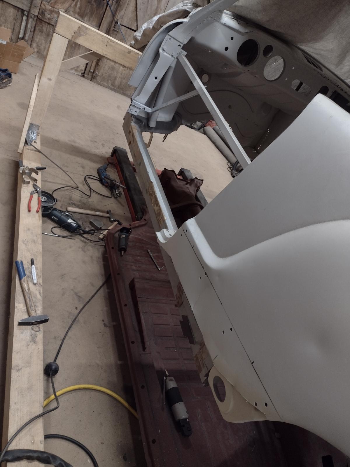

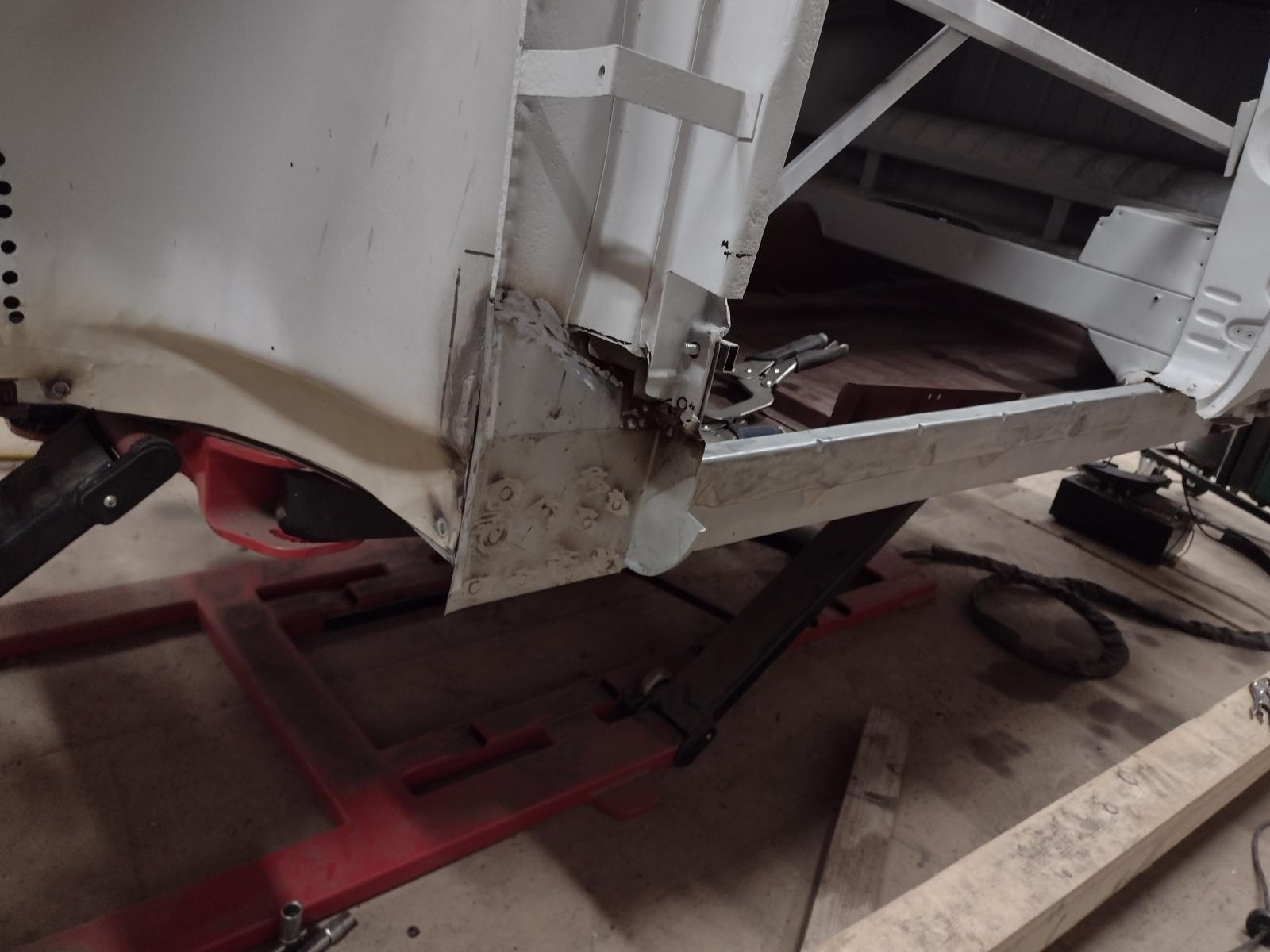

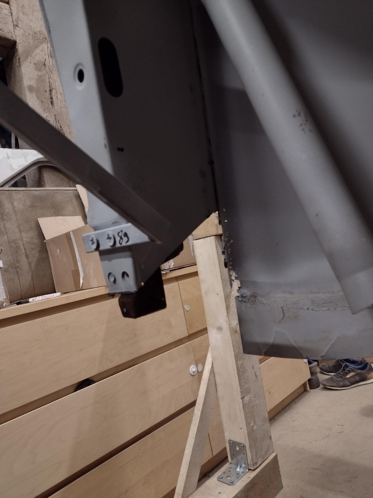

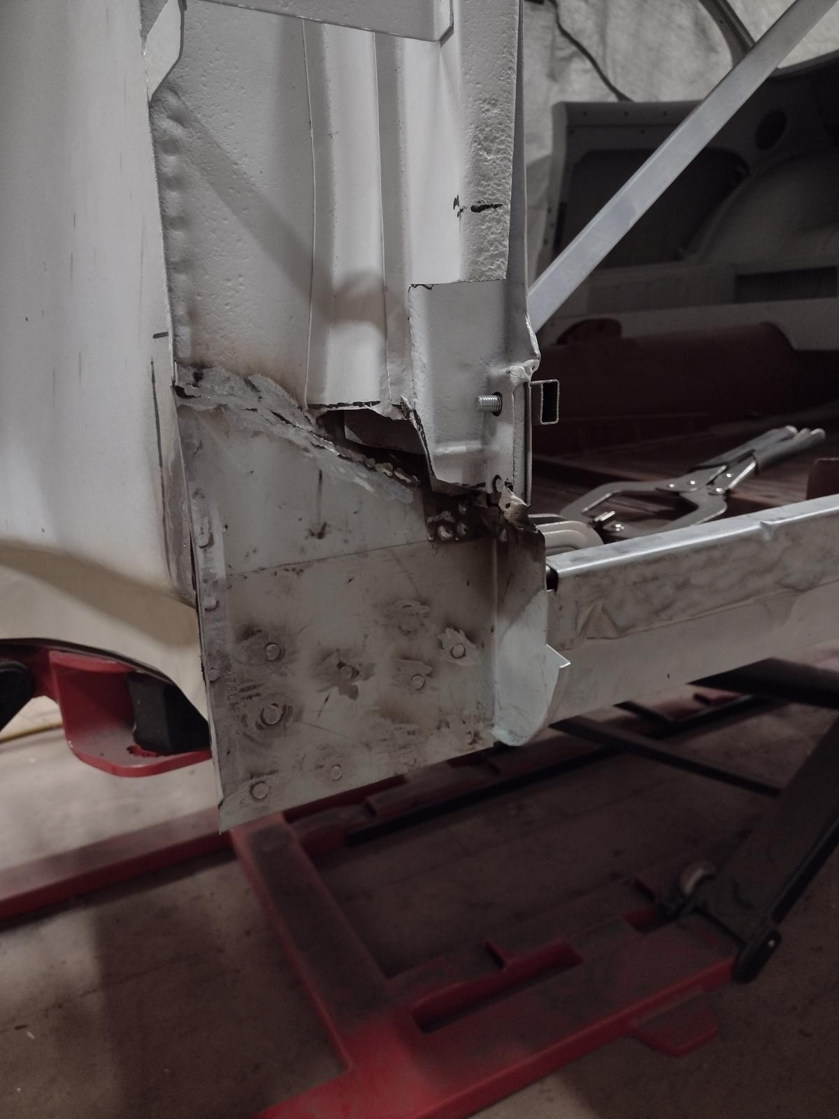

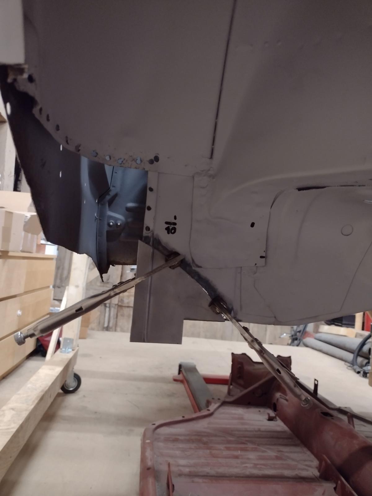

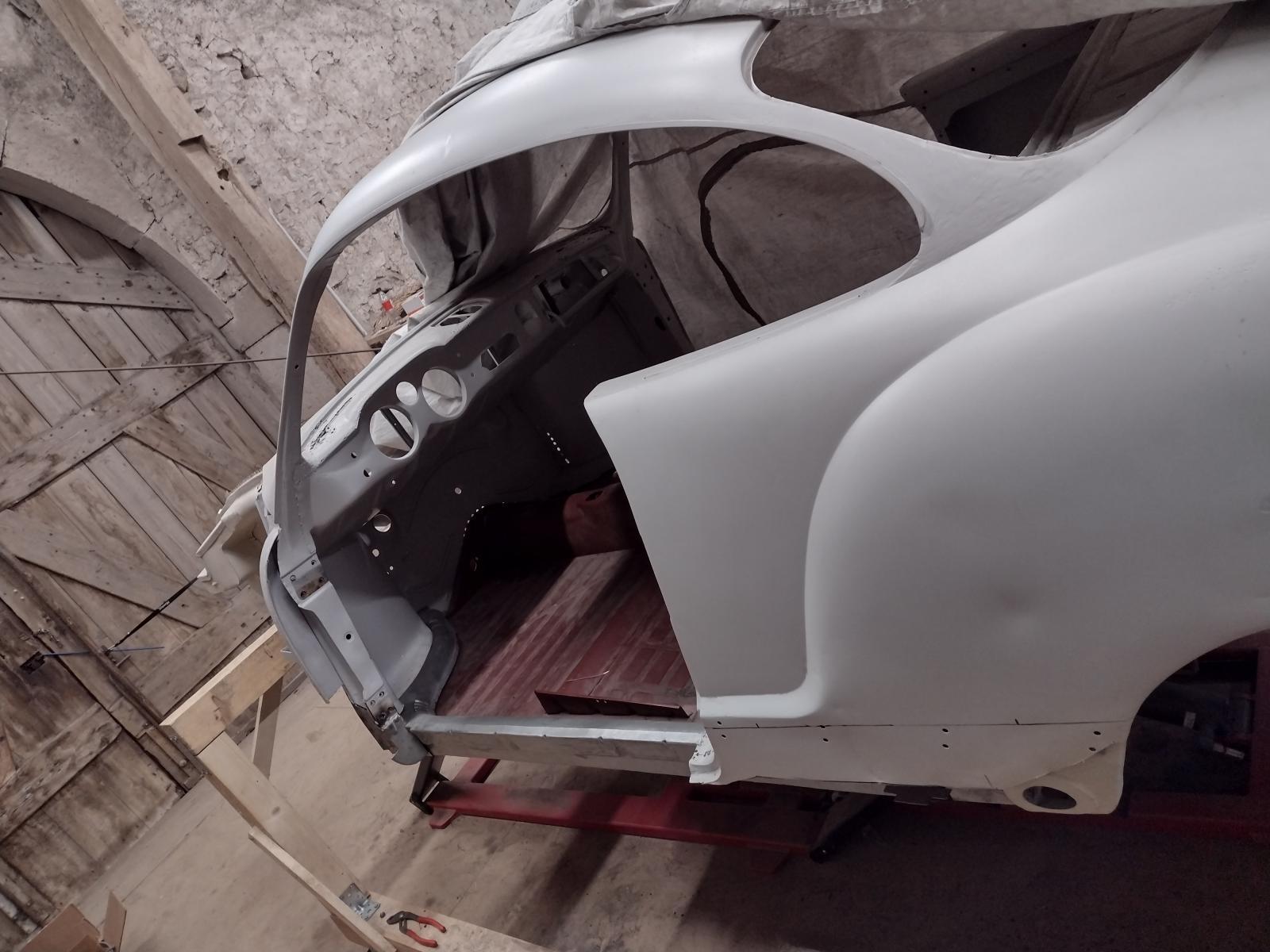

So, after the heater channel was positioned, I could adjust the A-post:

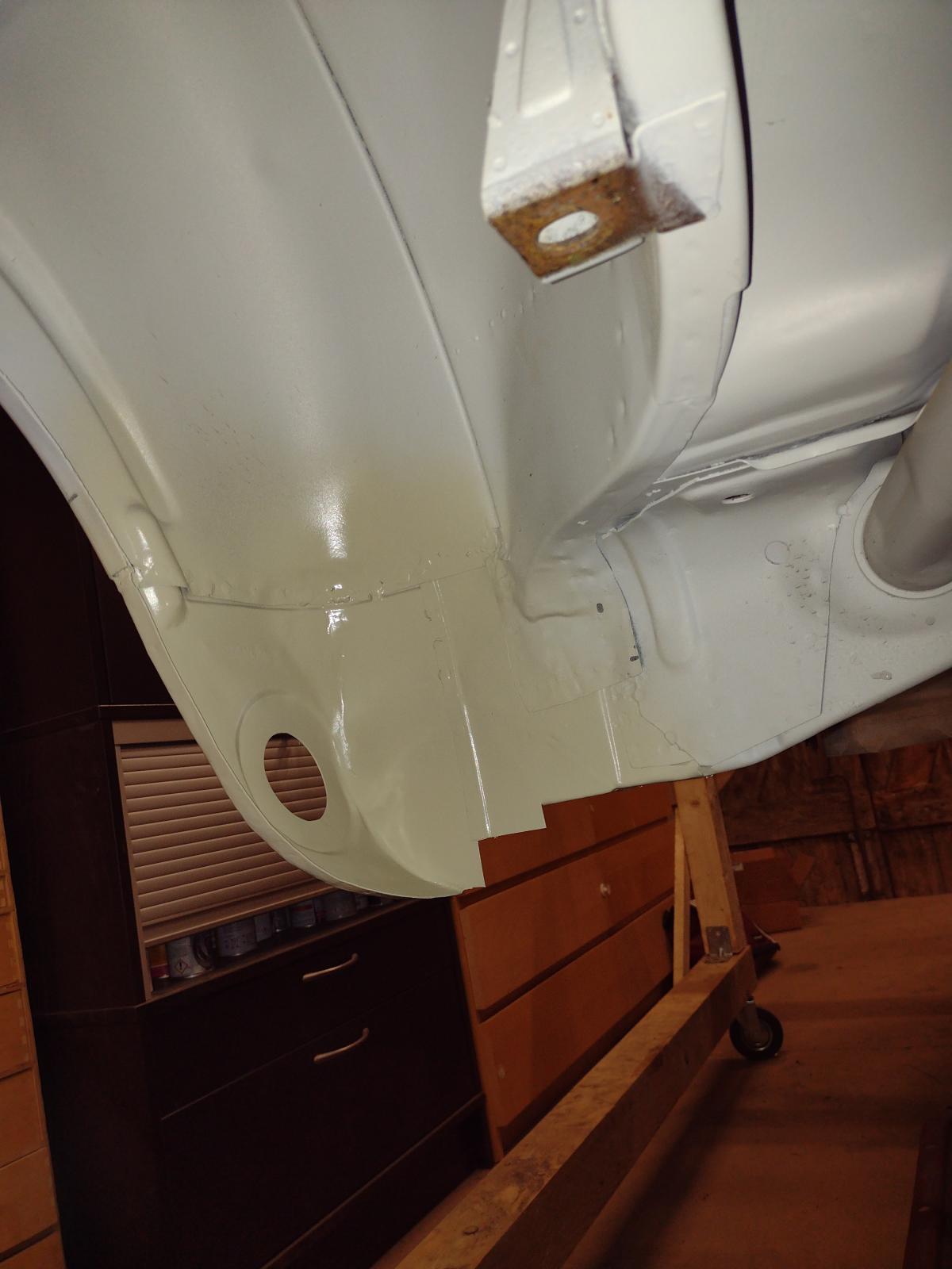

And after all checks, put some welding primer, made some holes for the welding..and go:

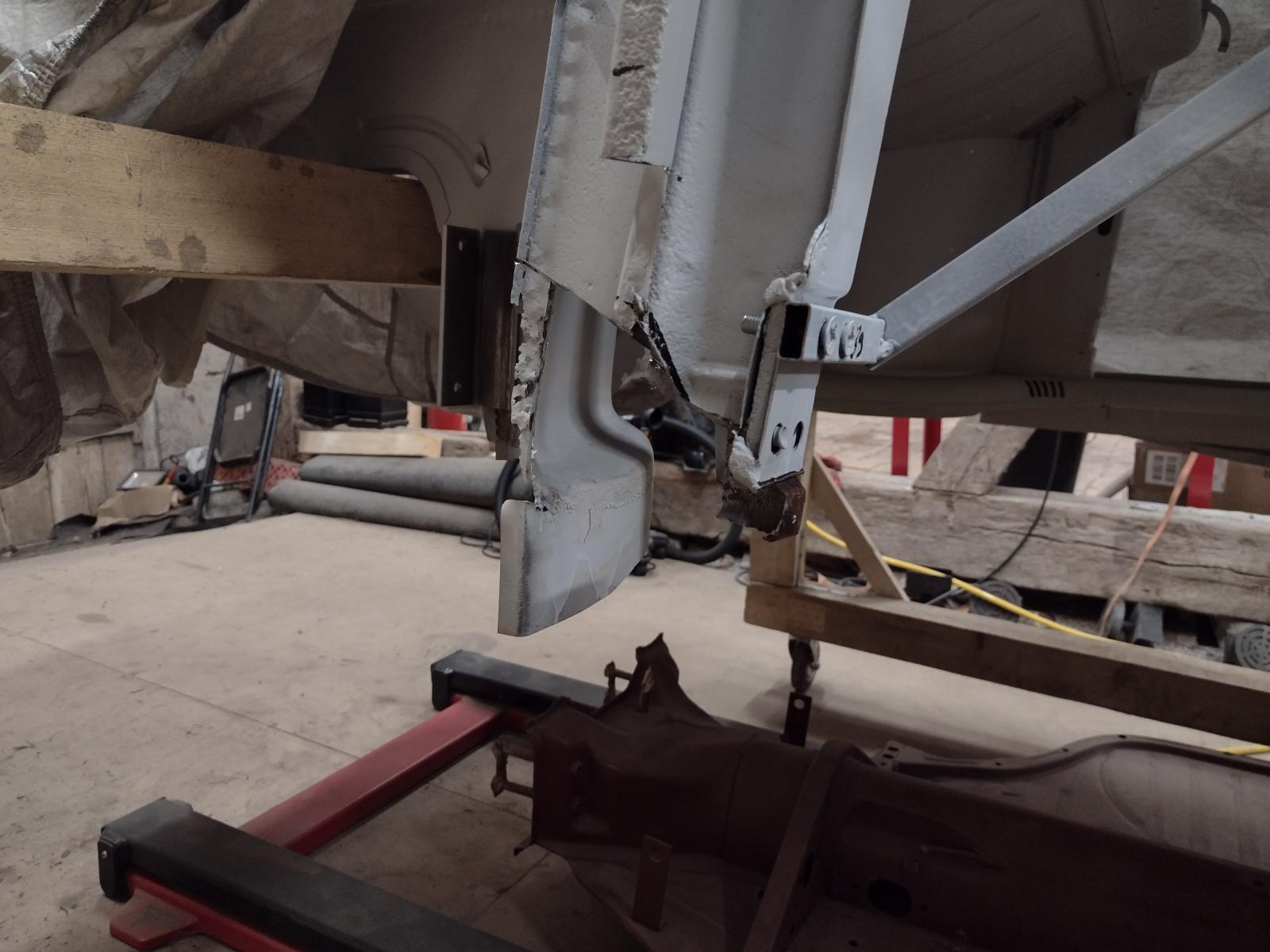

And here we are, the A-post is already looking quite better:
And finally, after 5 years, no more braces at the door opening!! The body stays square alone !!
Next will be to finish the A-post with the part enclosing the hinges..
