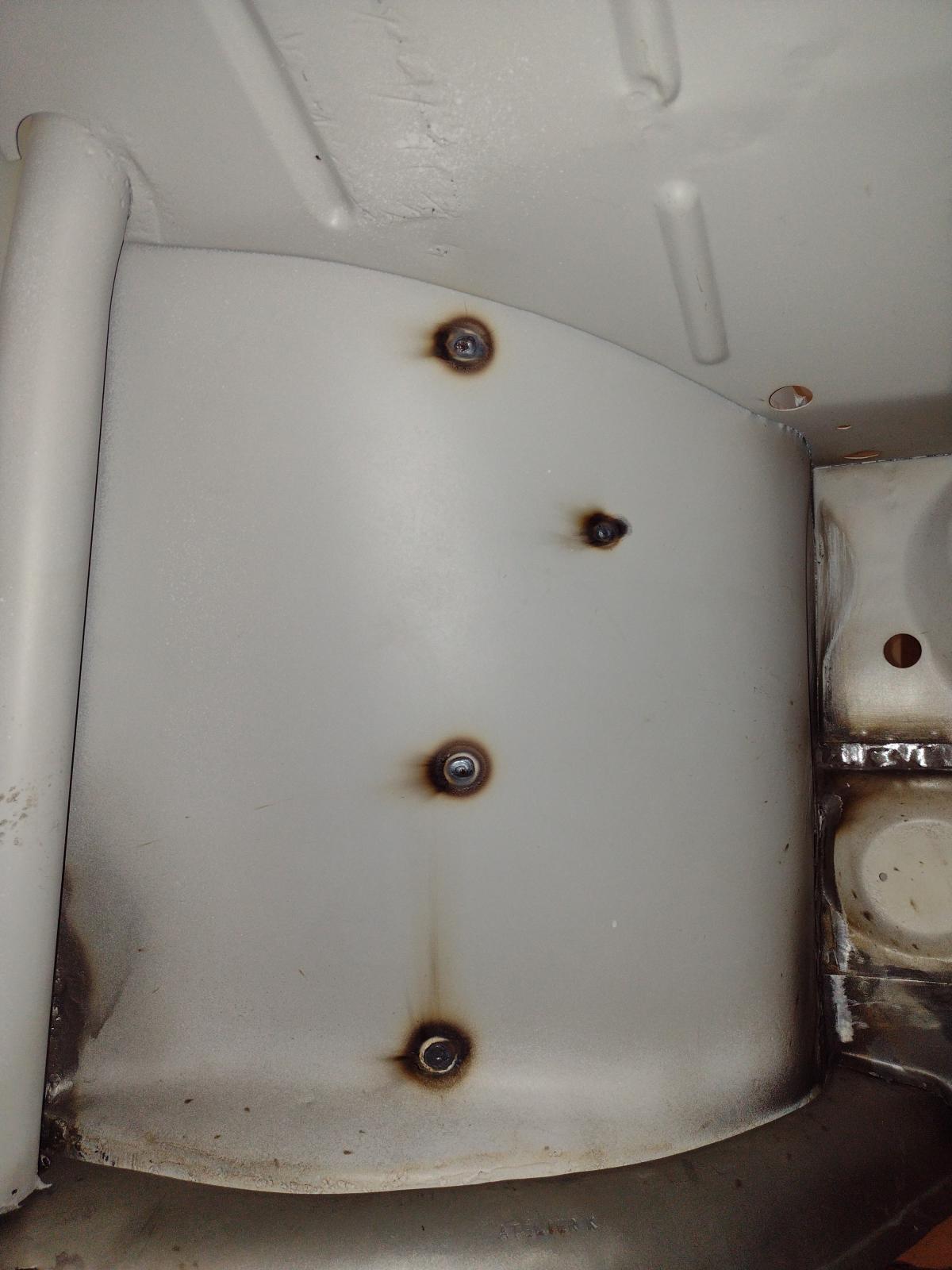

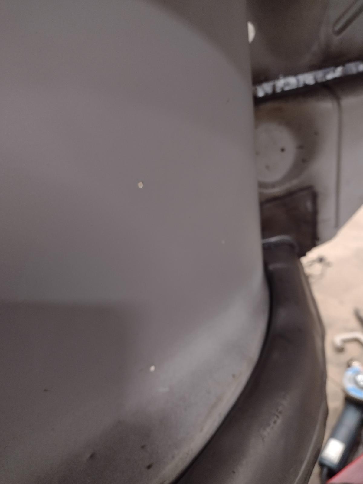

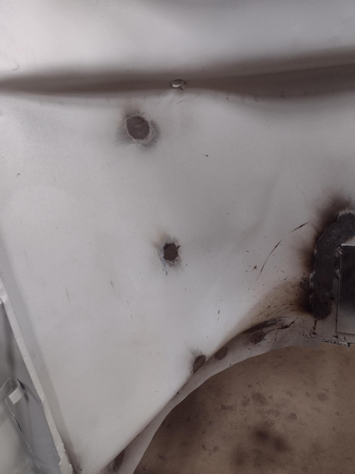

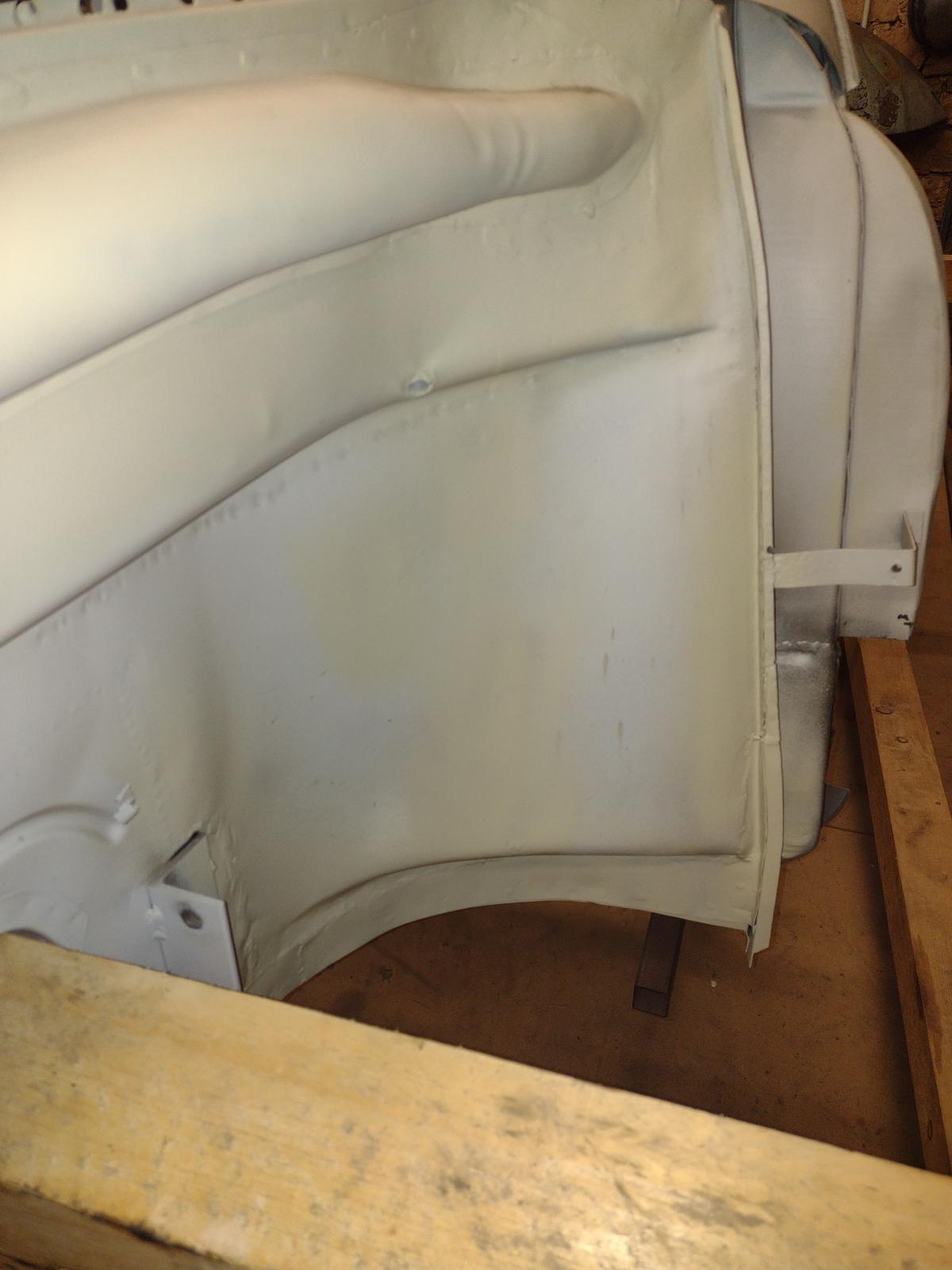

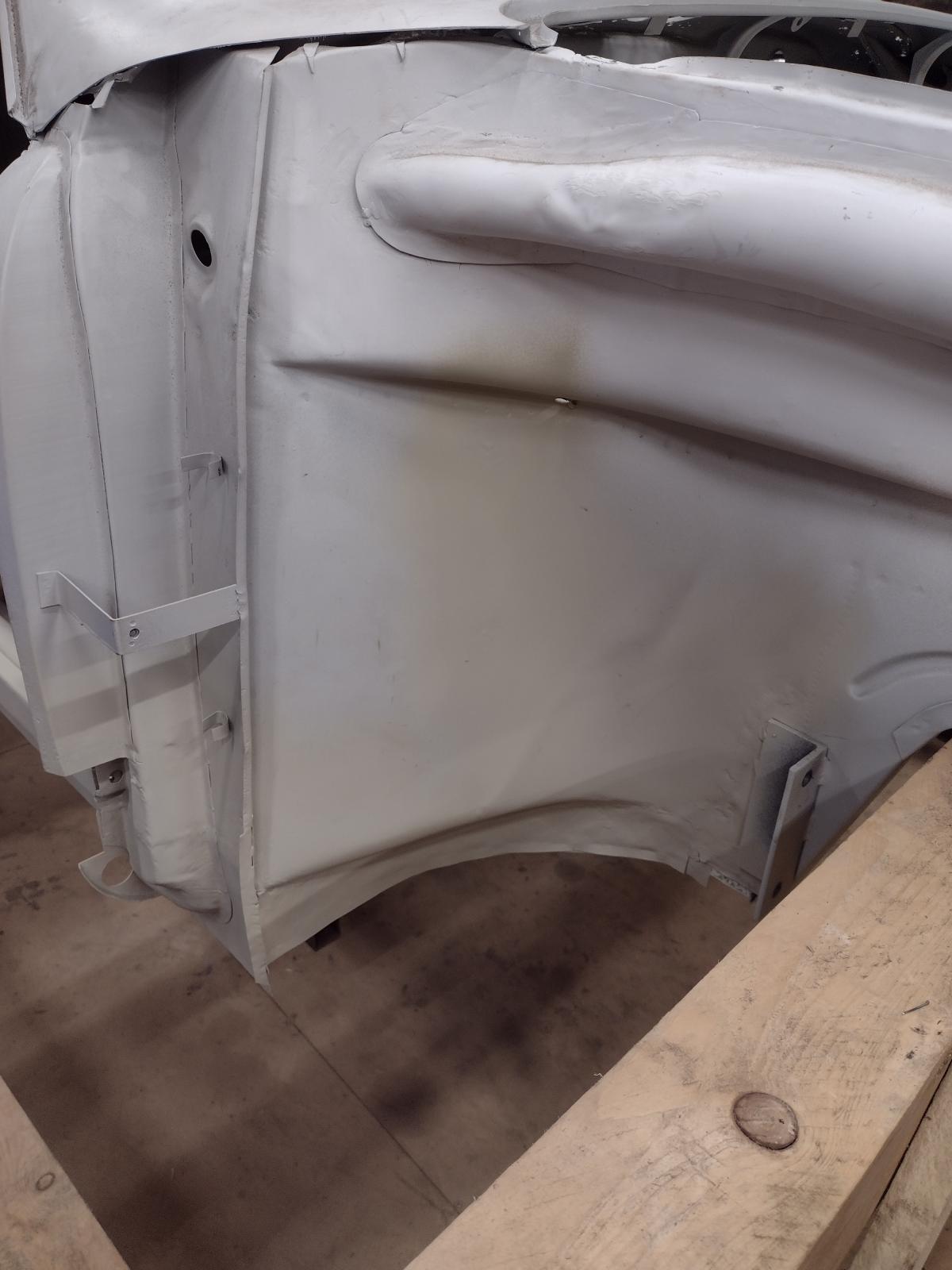

While I was working on that part of the body I took care of a couple of holes that were made in the wheel housing:
Before:
During:
And after:
And some epoxy primer on it :

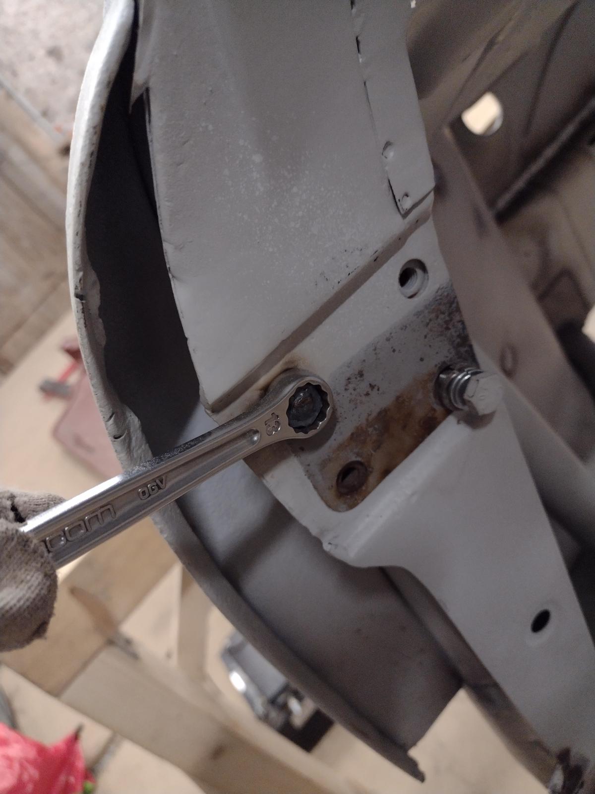

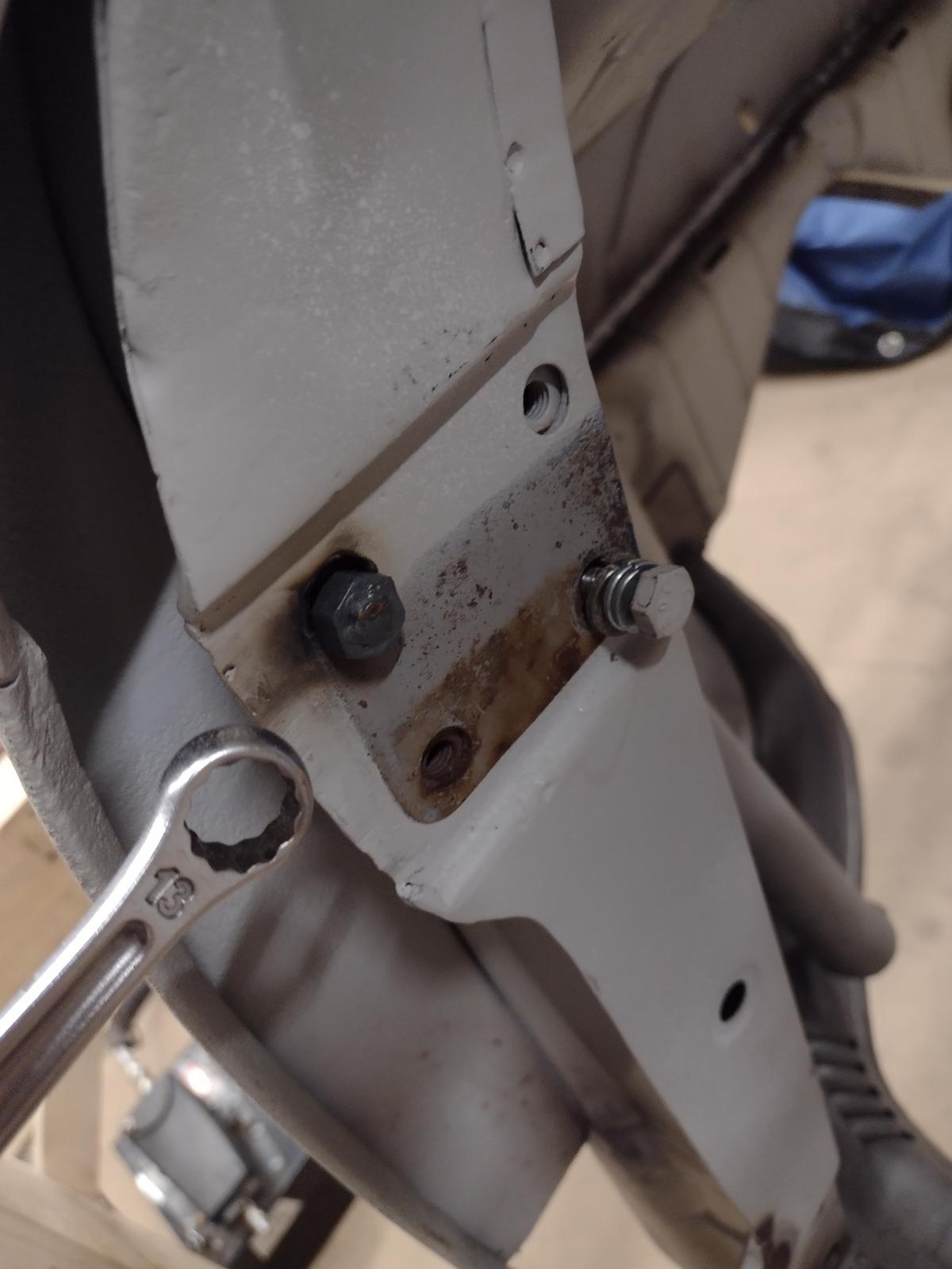

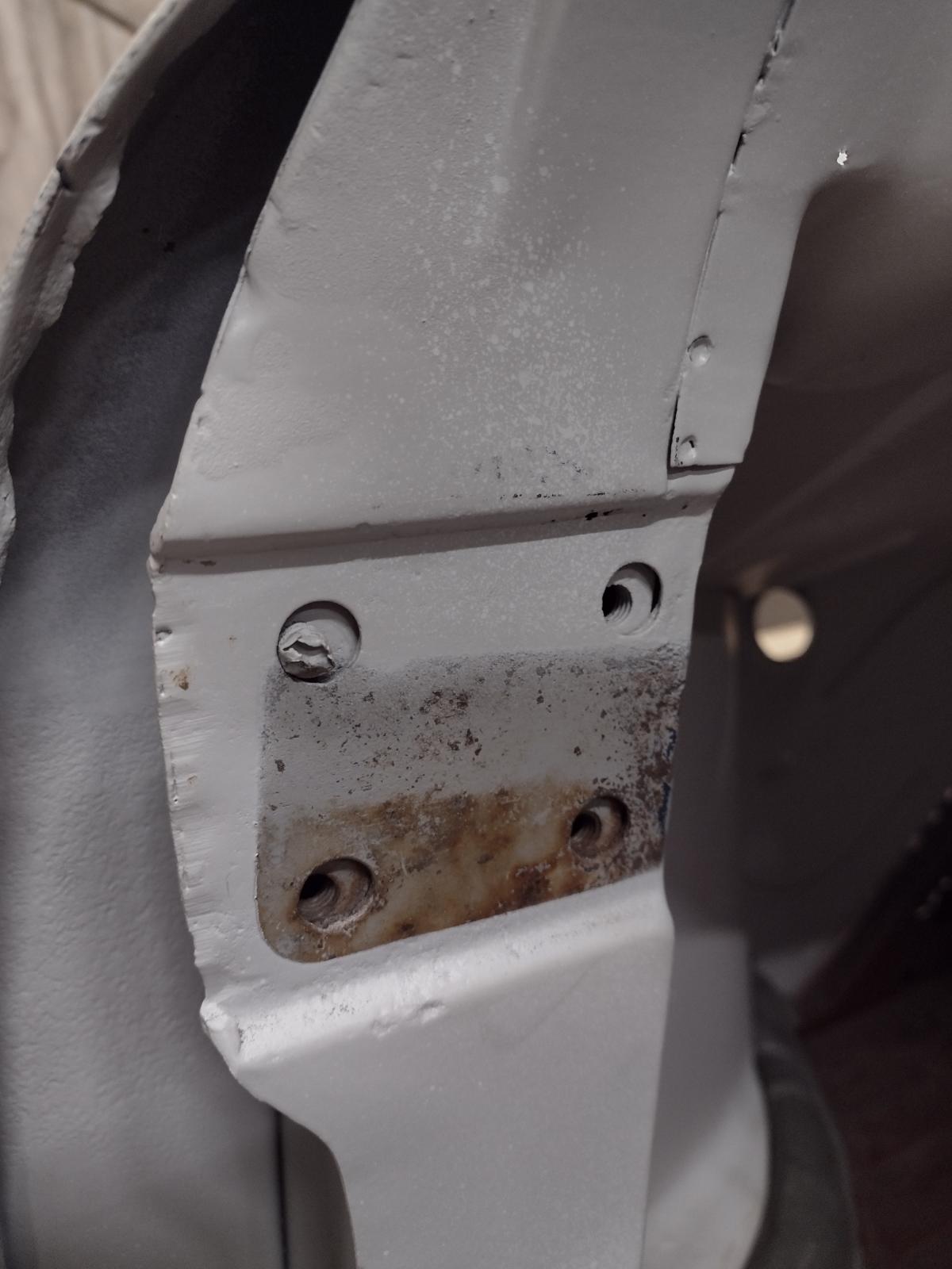

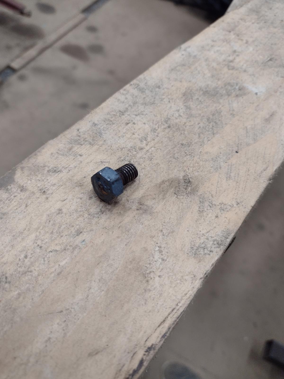

I also removed the broken screw in the upper door fixation plate:
By making it longer via Tig-welding some extra metal to make it longer and finally welding a nut on it :
And it's out:
I could almost re-use it as a screw:
