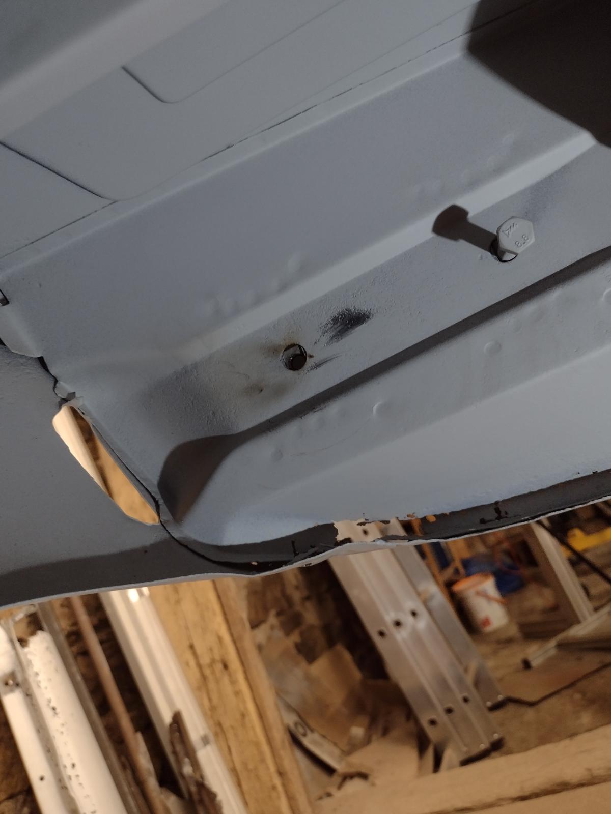

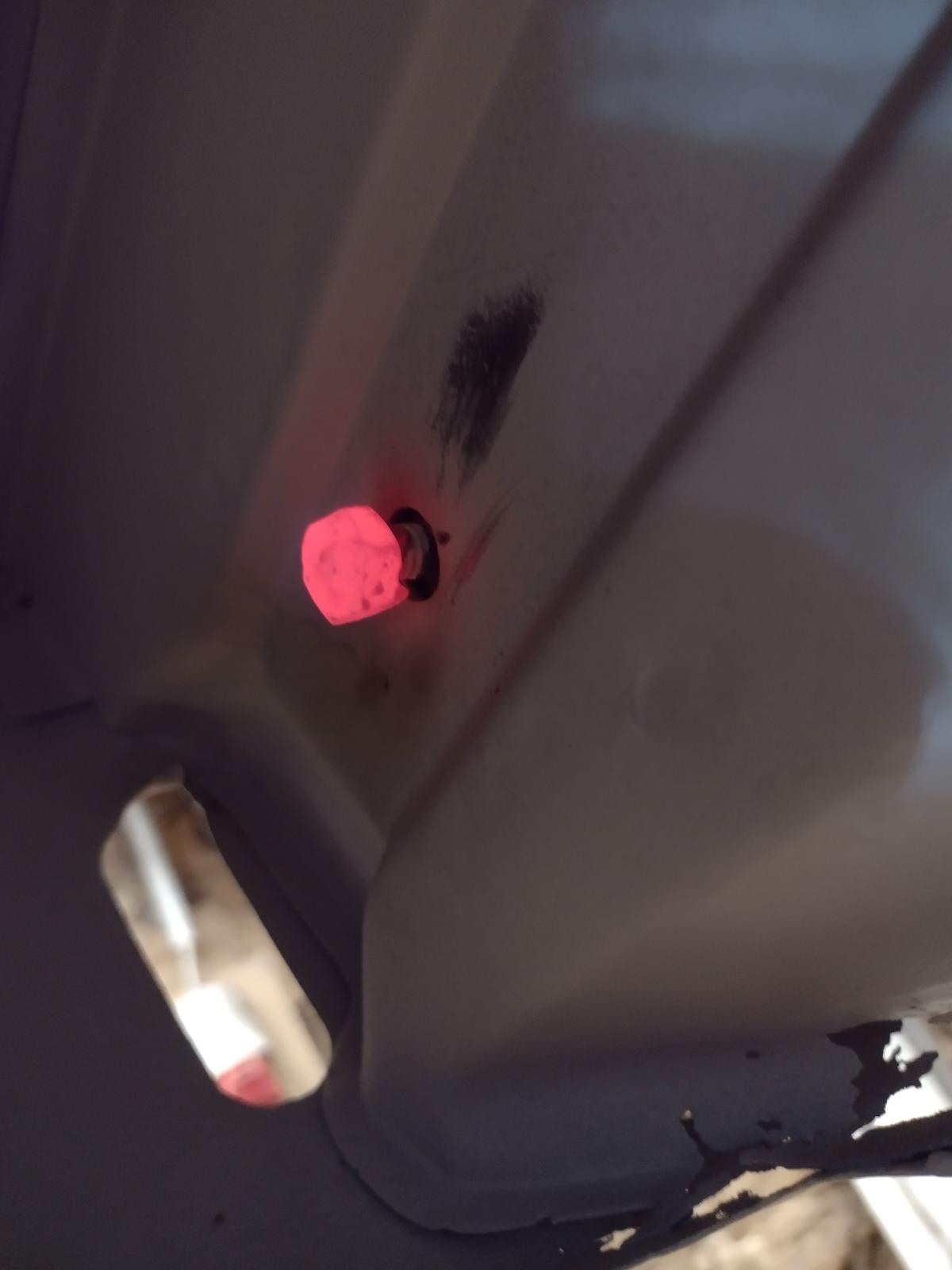

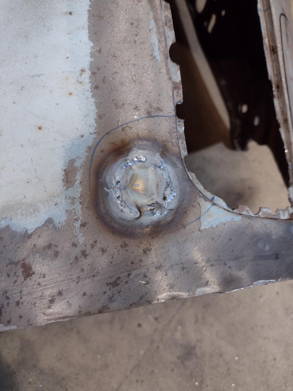

Little side work, I rebuilt (by replacing some parts of it) the front bumper mounts: And removed the broken bolt on the rear left bumper mounts: Stay tuned, Antoine

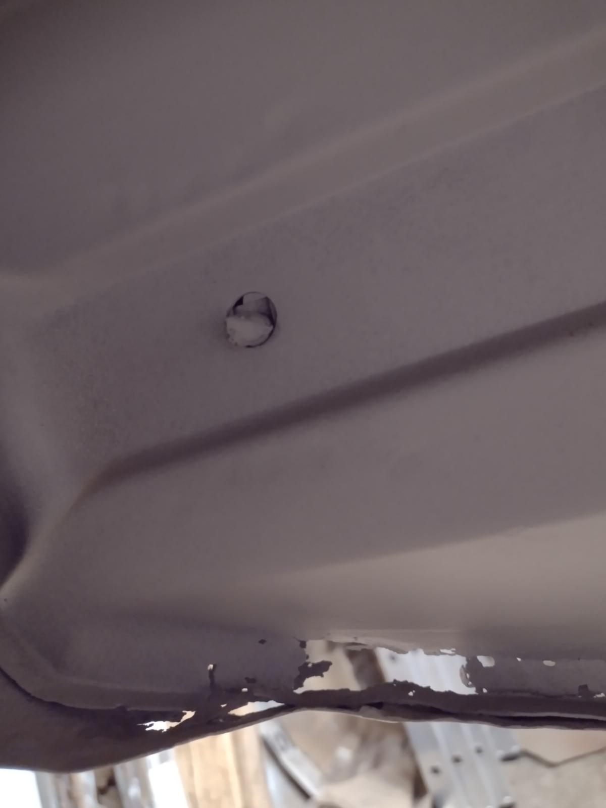

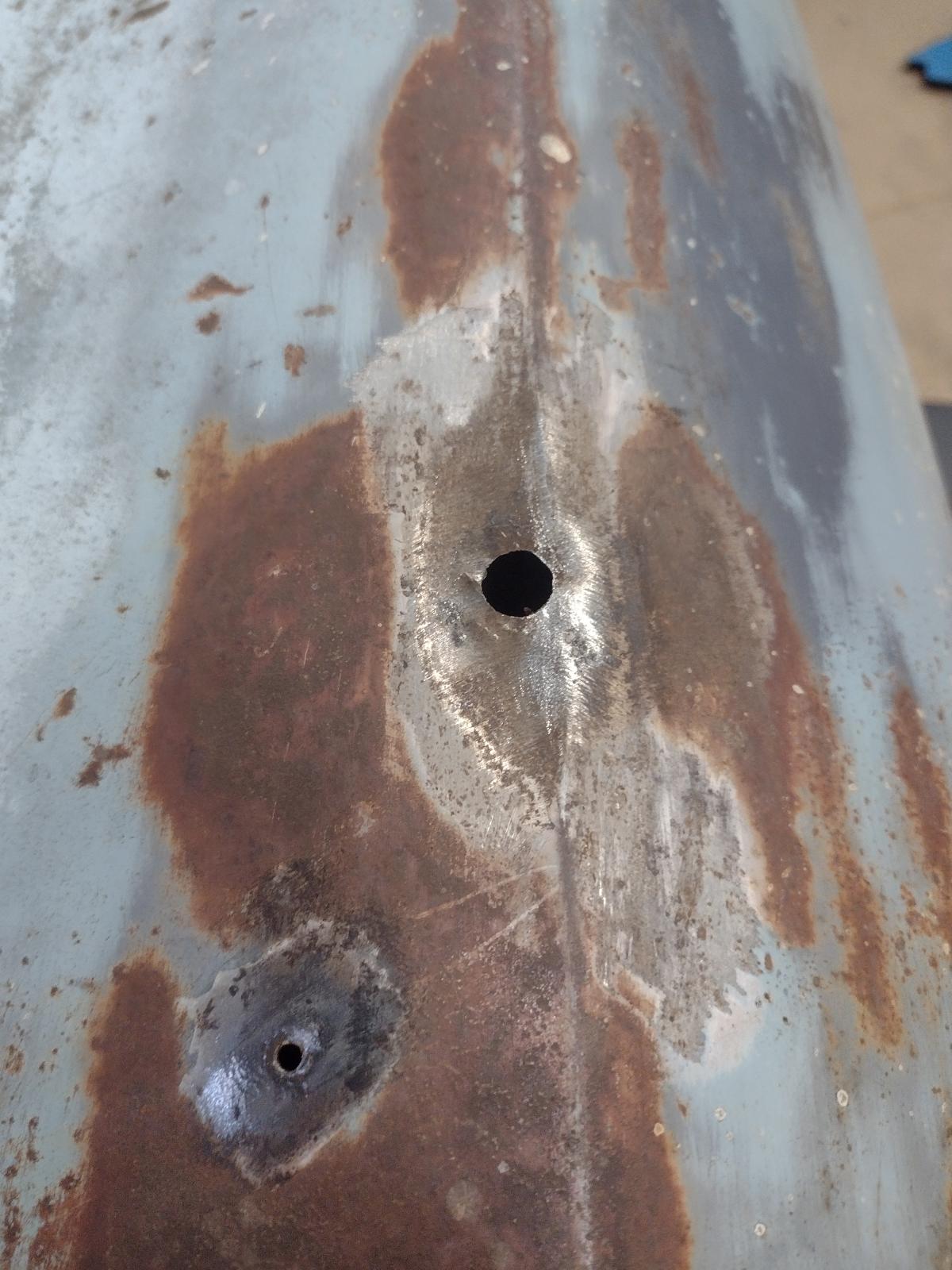

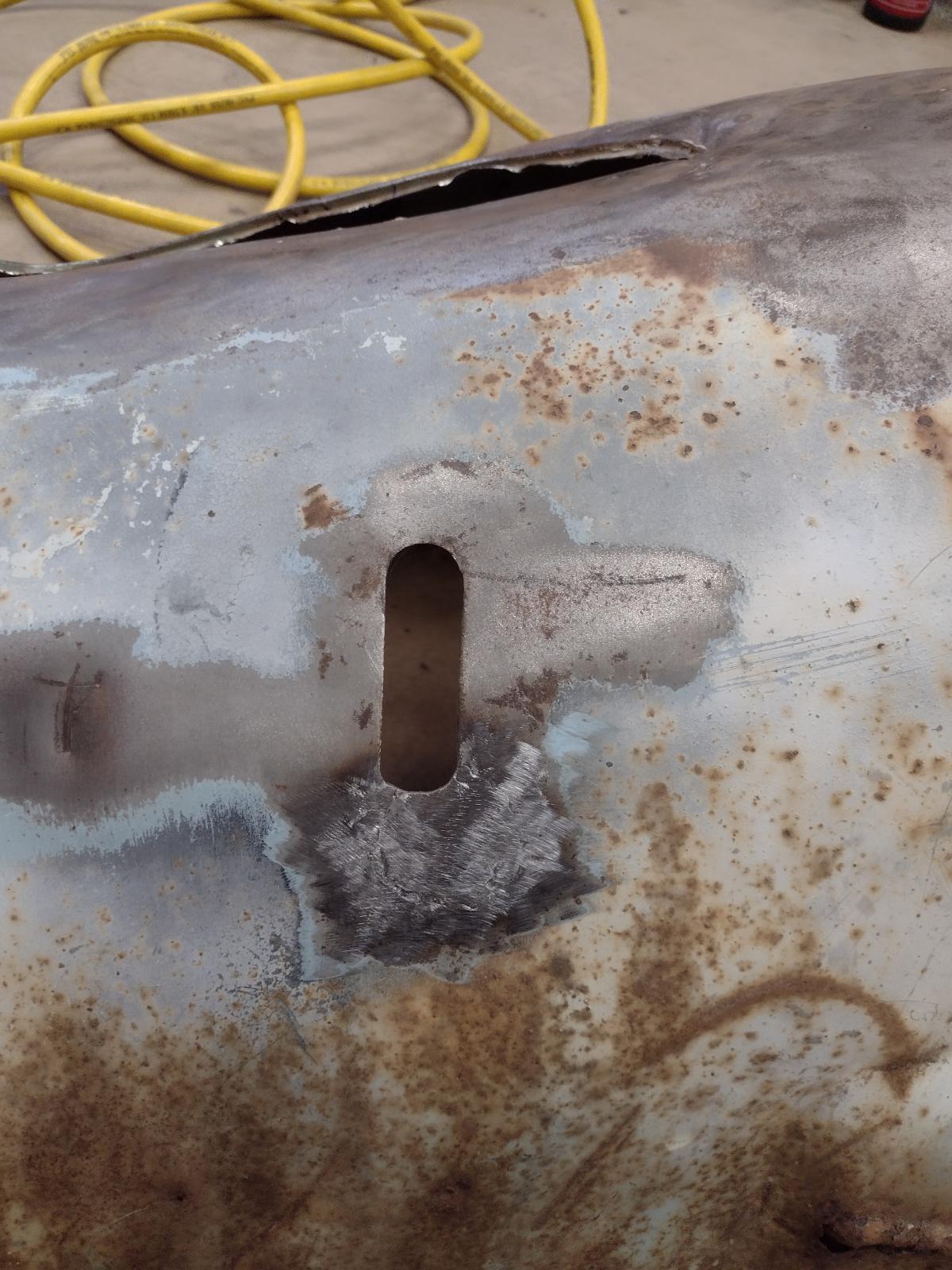

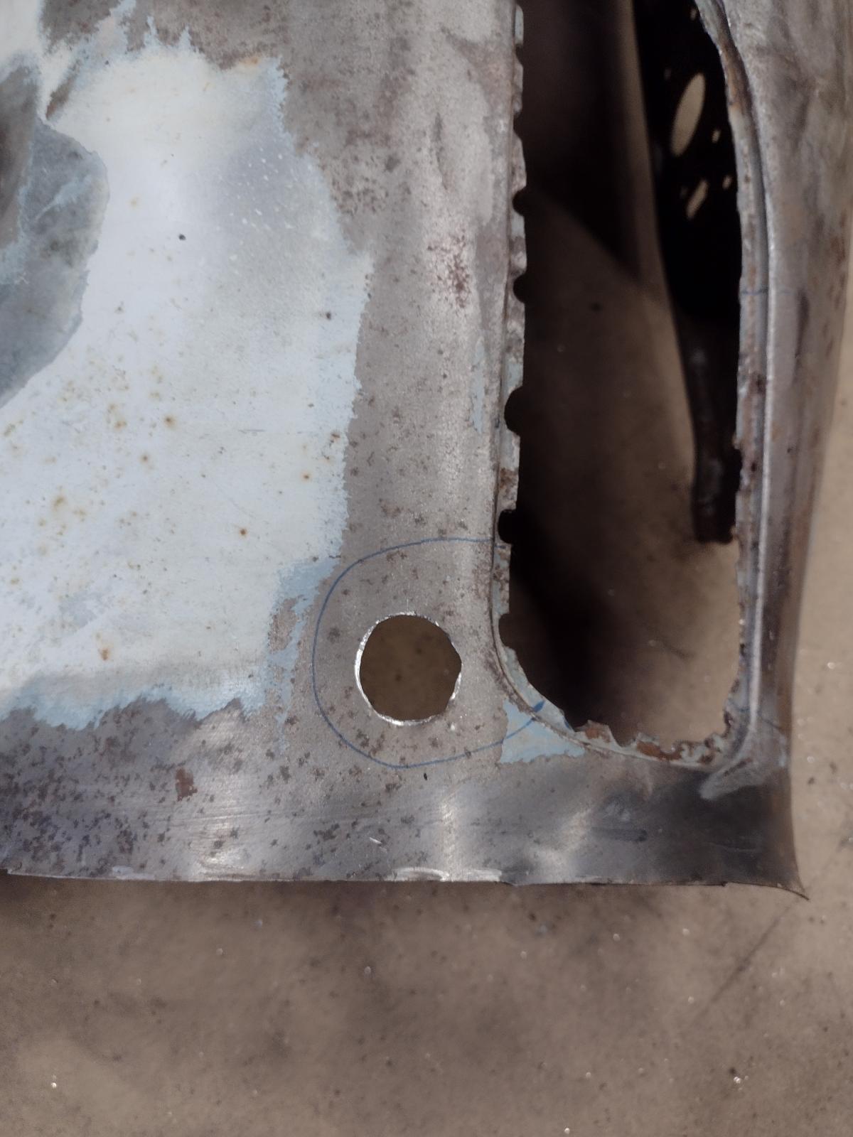

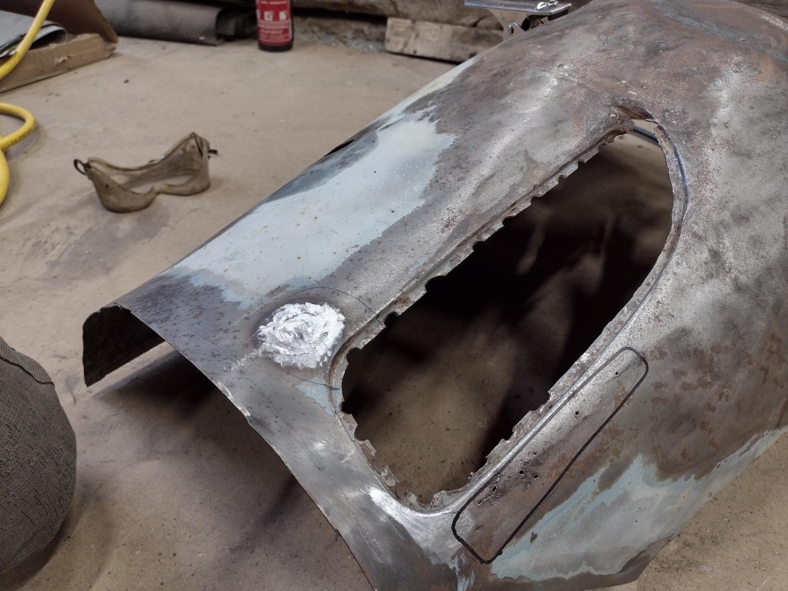

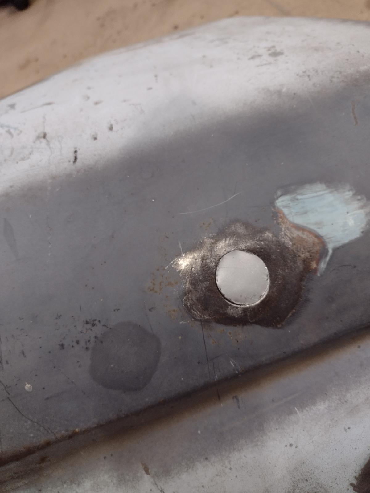

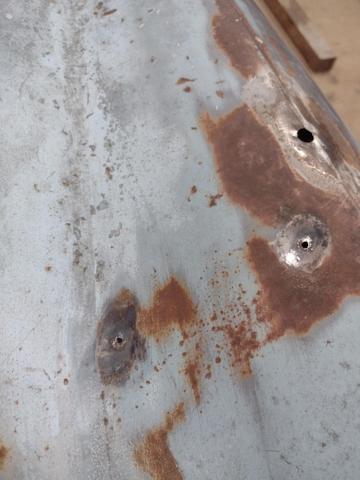

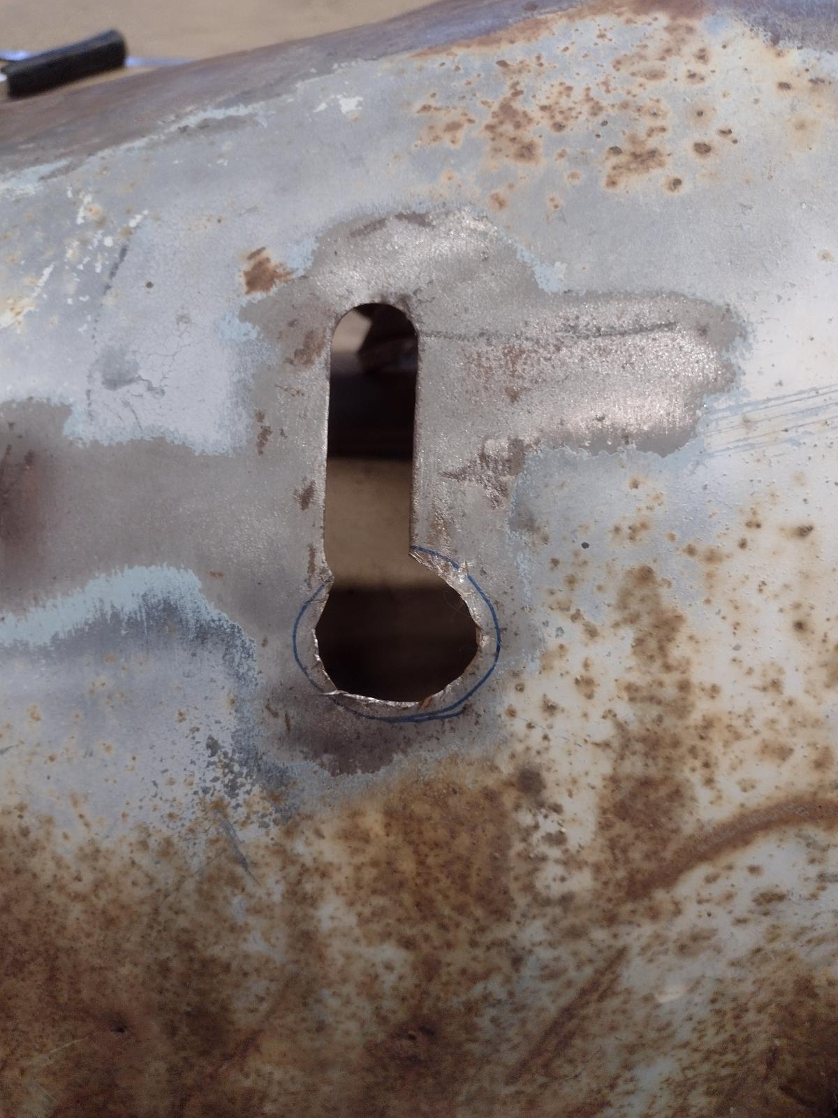

So, let's make another update as I do have more to share!

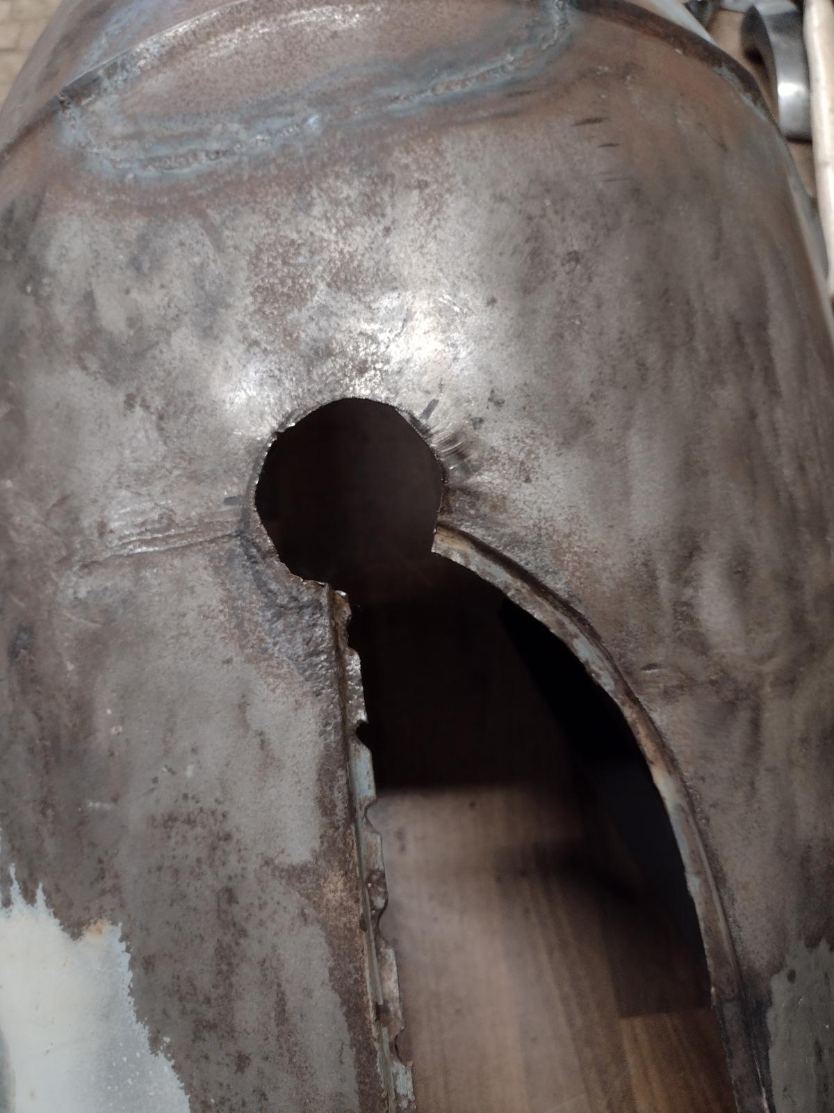

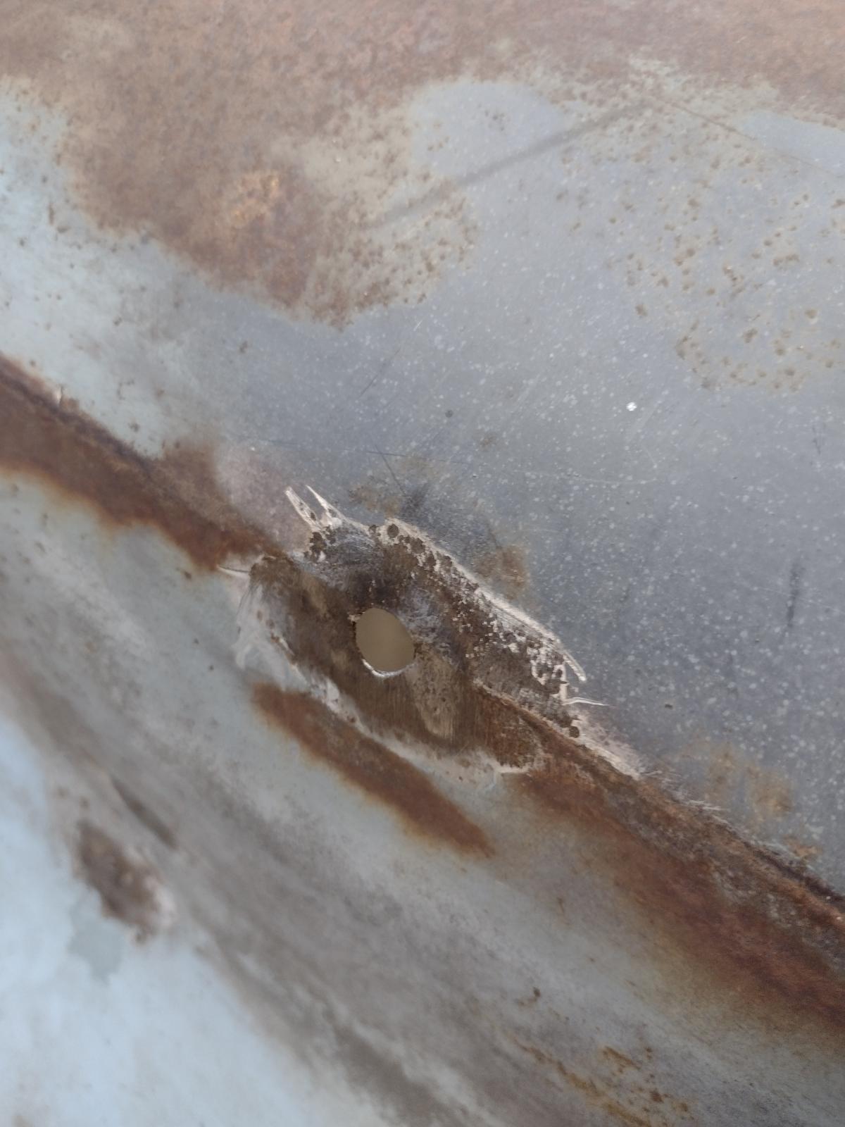

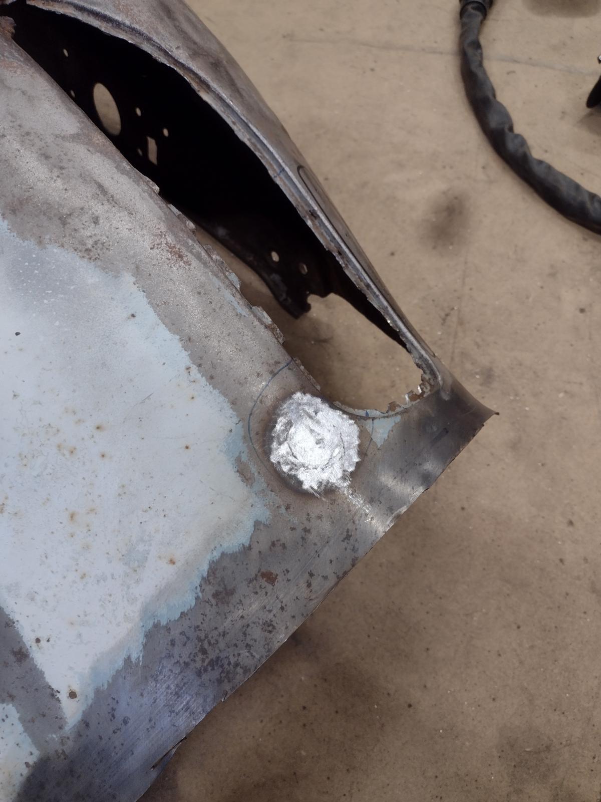

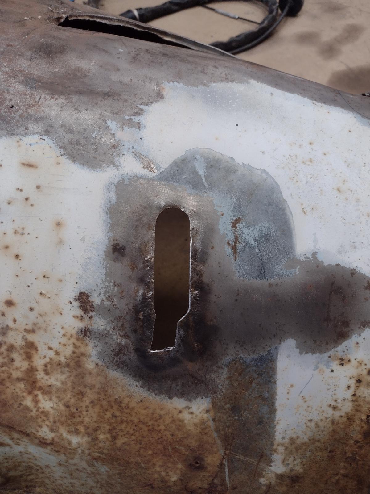

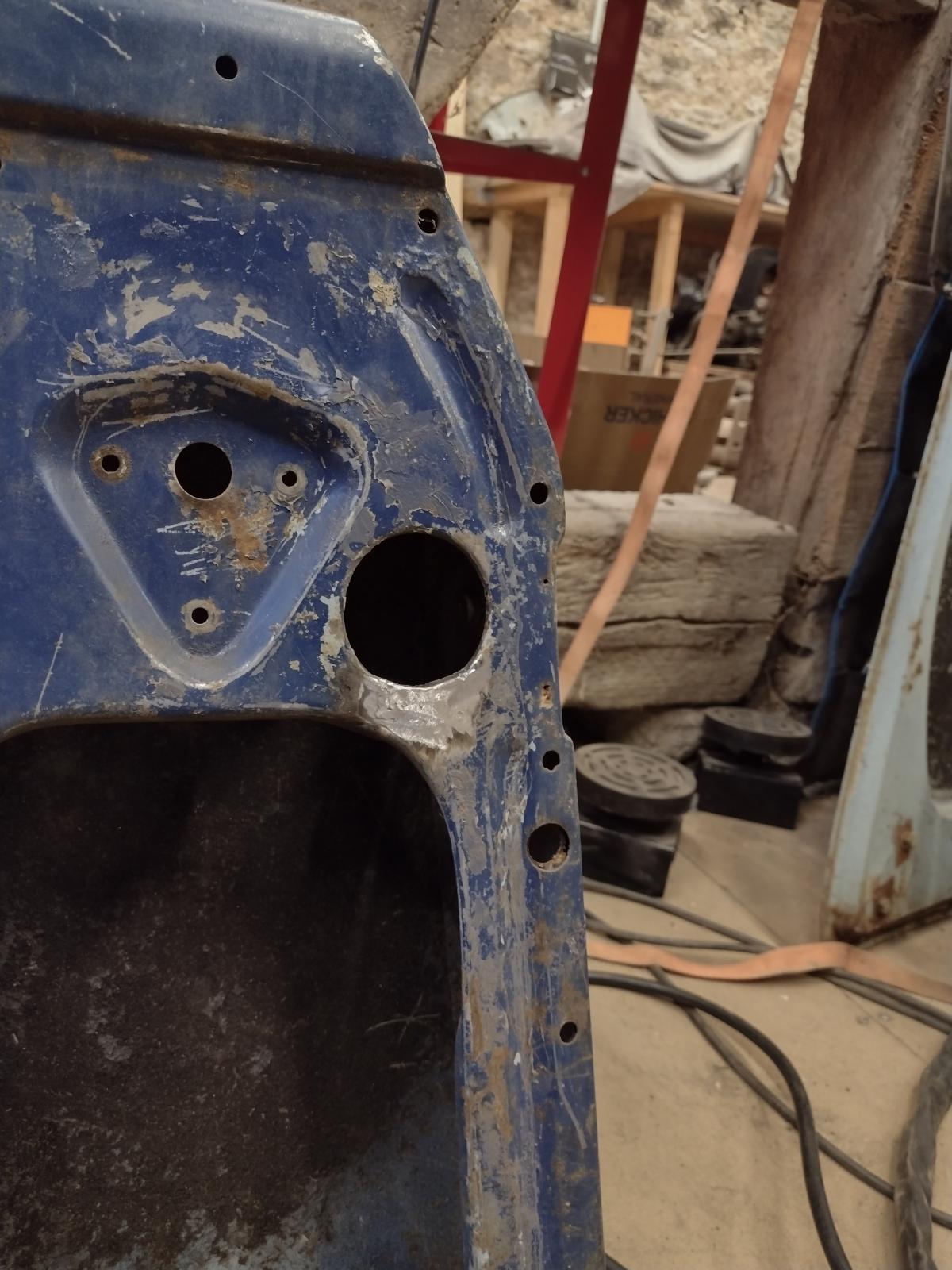

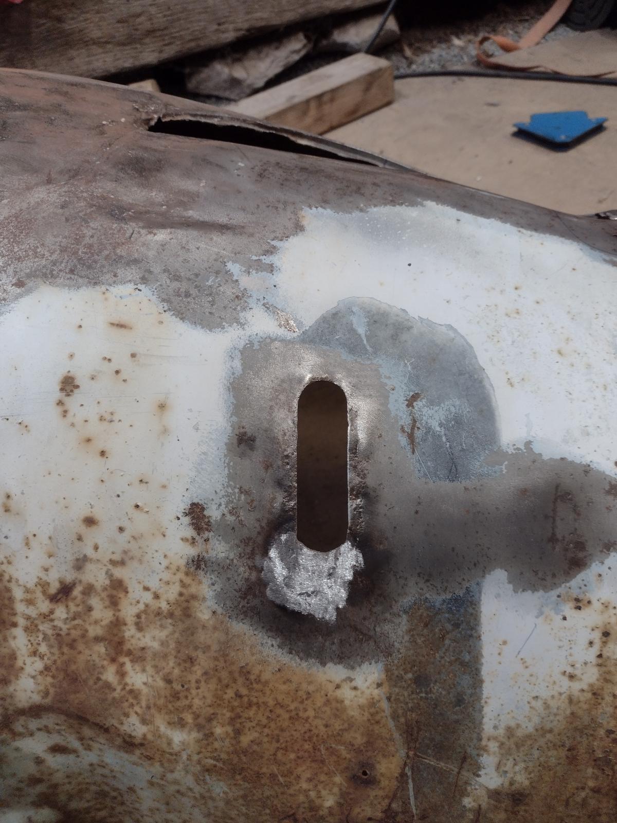

The front and rear parts of the fenders will be adjusted on the car but they had a lot of holes from either bad fixes or accessories that needed to be taken care of and it's easier with them disassembled so: Driver's side: And fixed: Passenger side: And fixed: And the antenna hole (my car won't have a radio, I love the look with the plate and only hear the flat 4-sound in my VWs): Bests Antoine

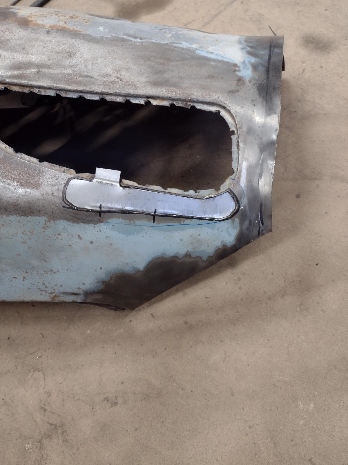

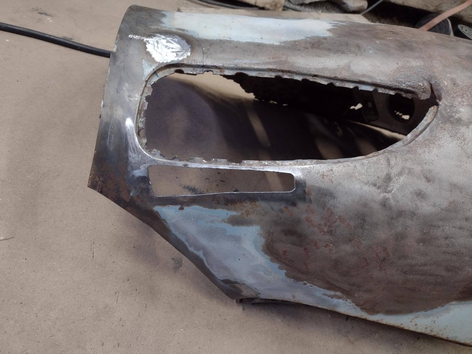

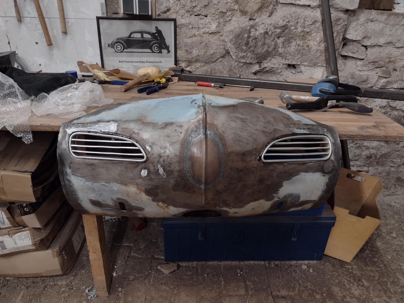

#225
Thanks a lot !

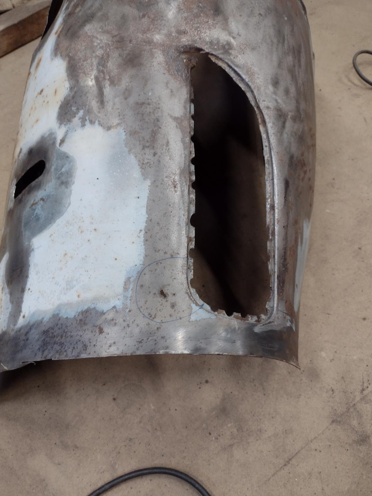

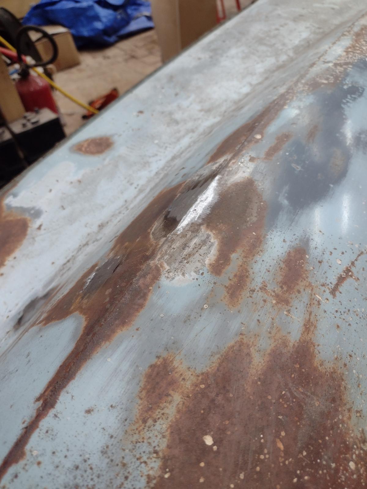

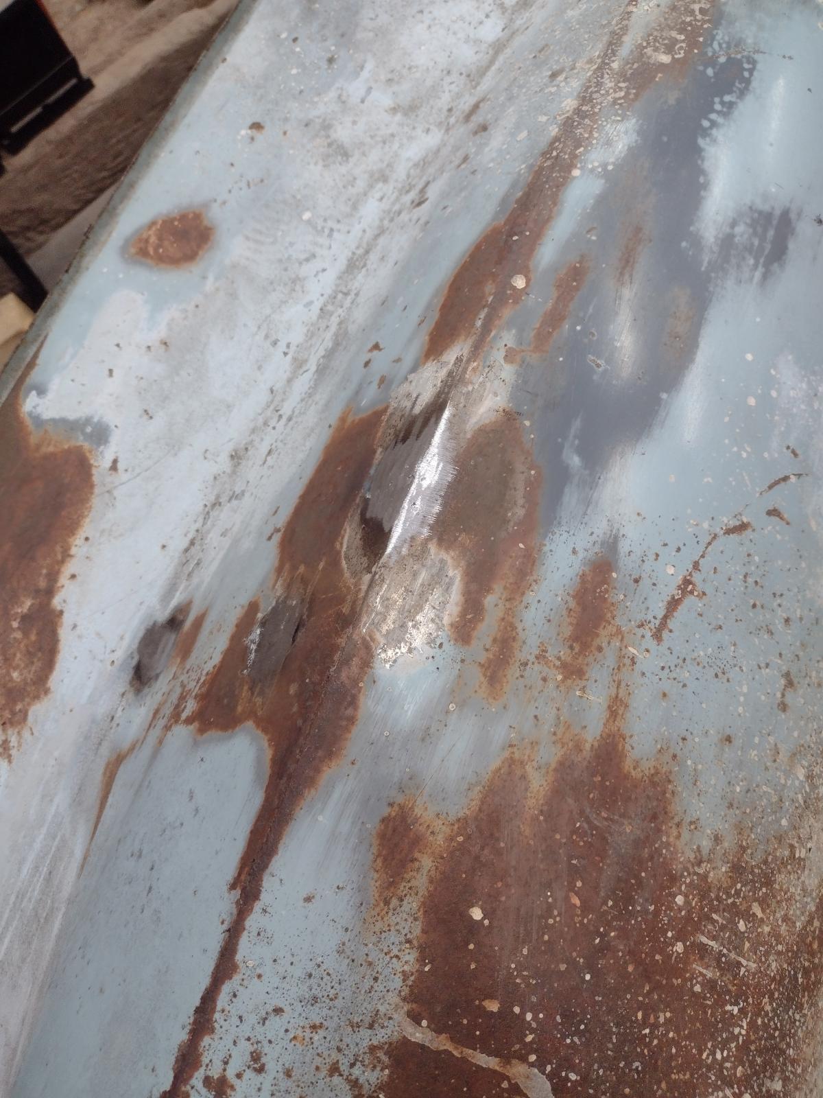

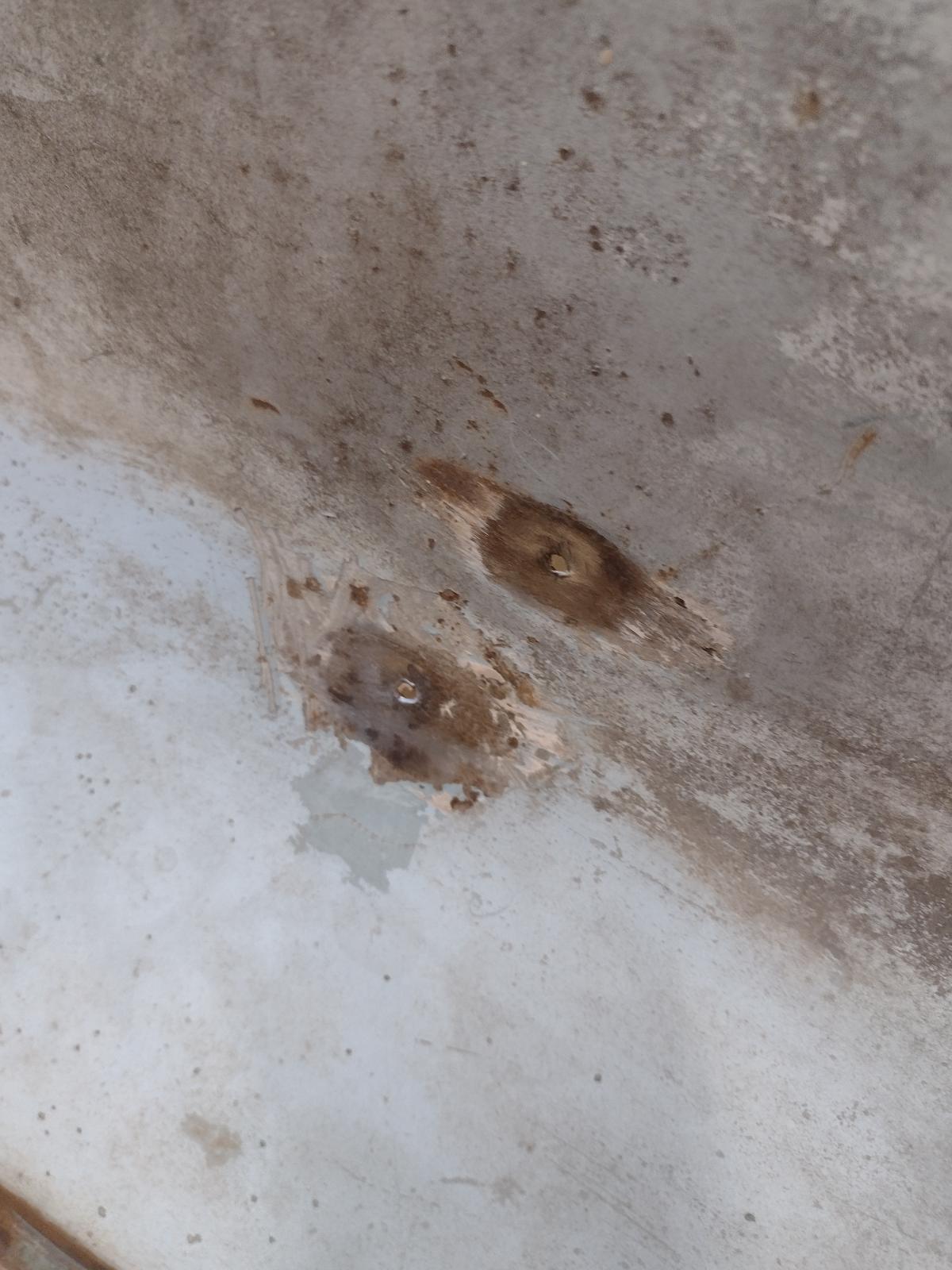

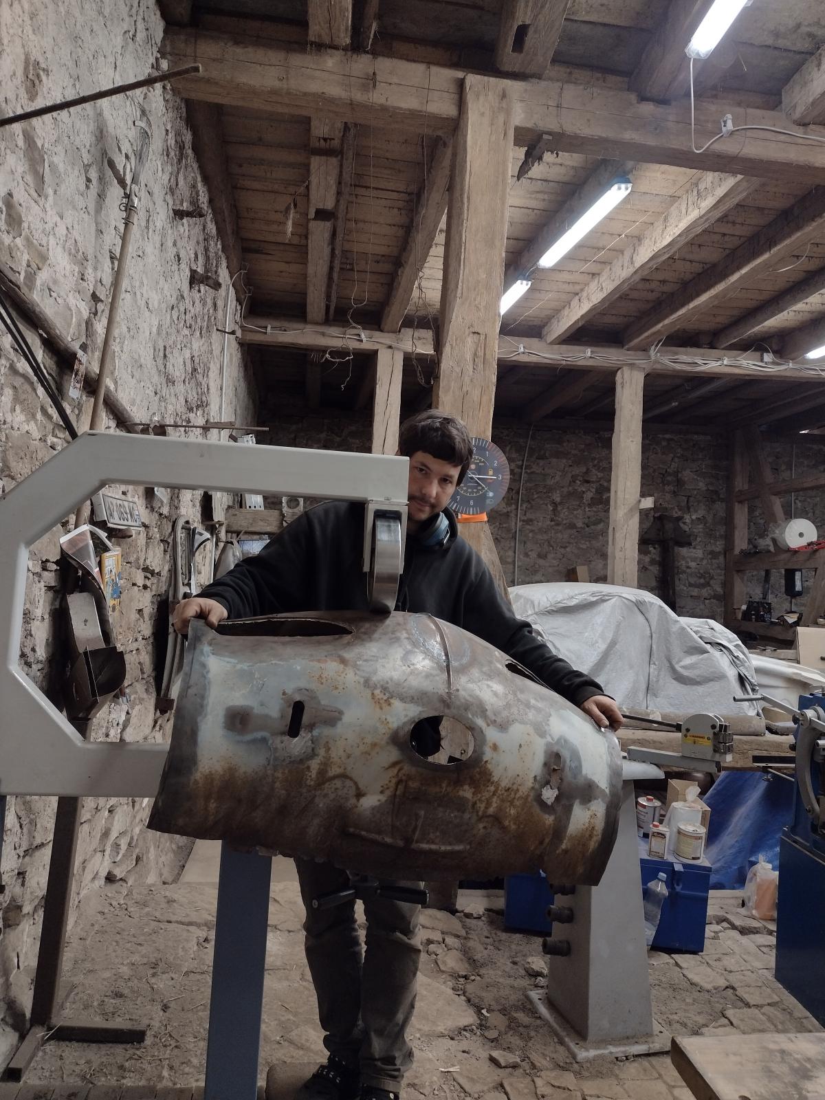

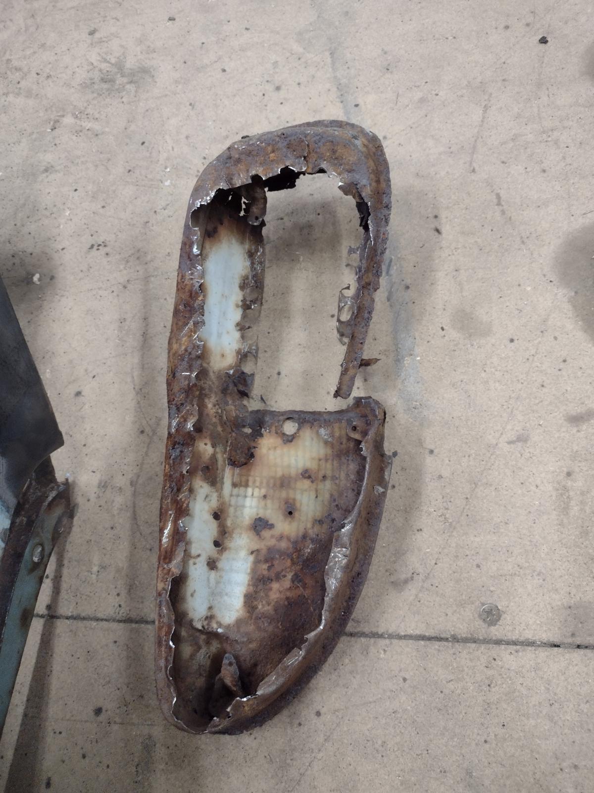

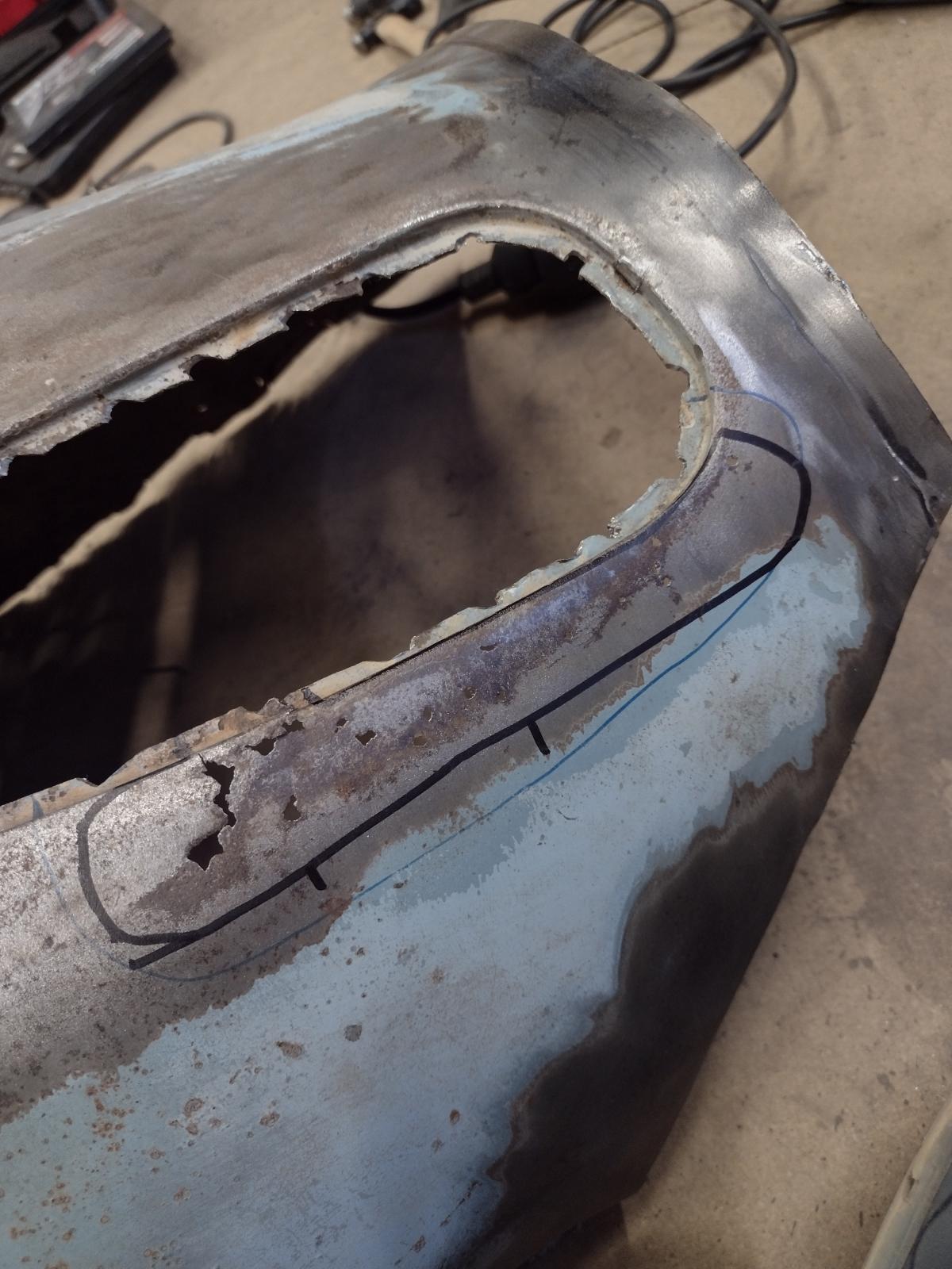

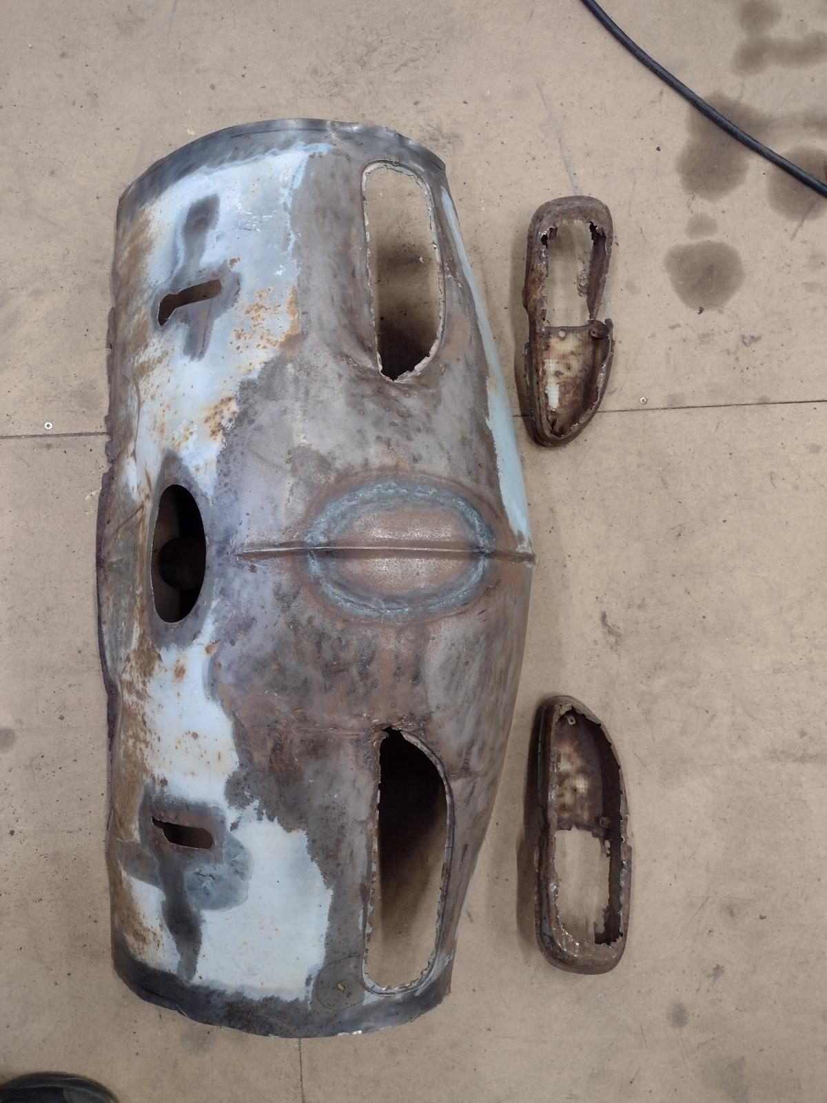

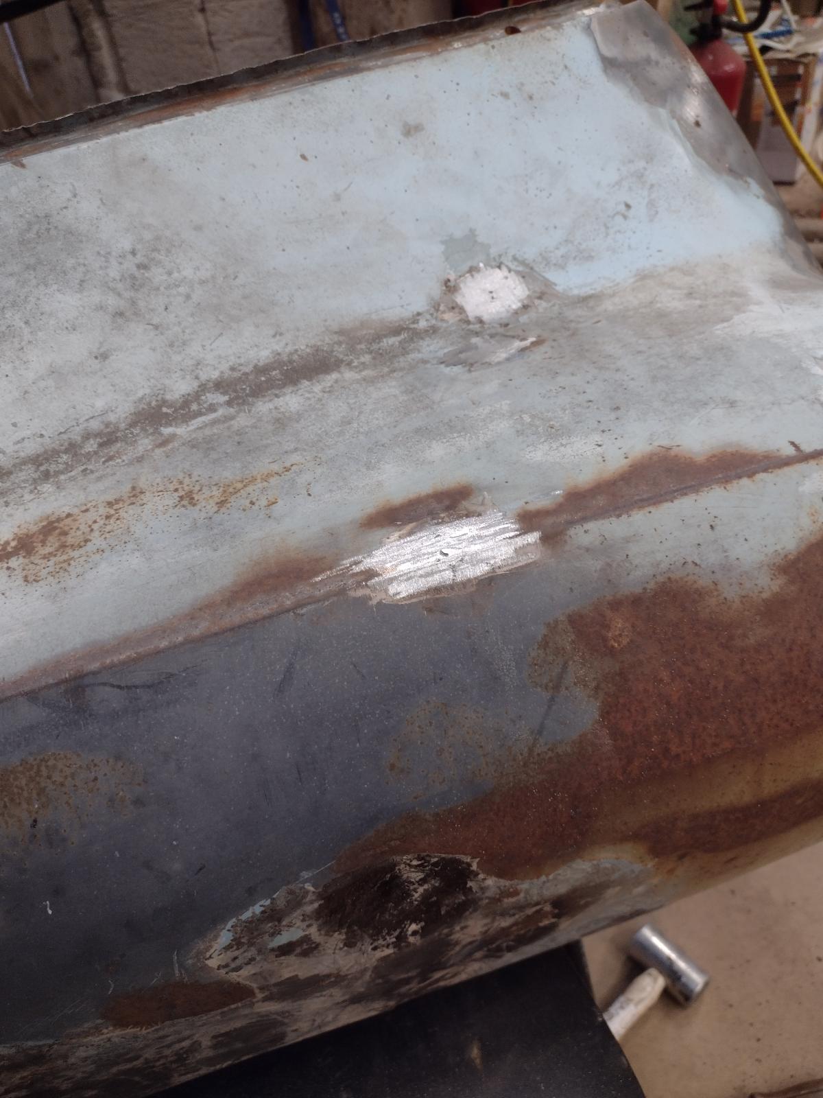

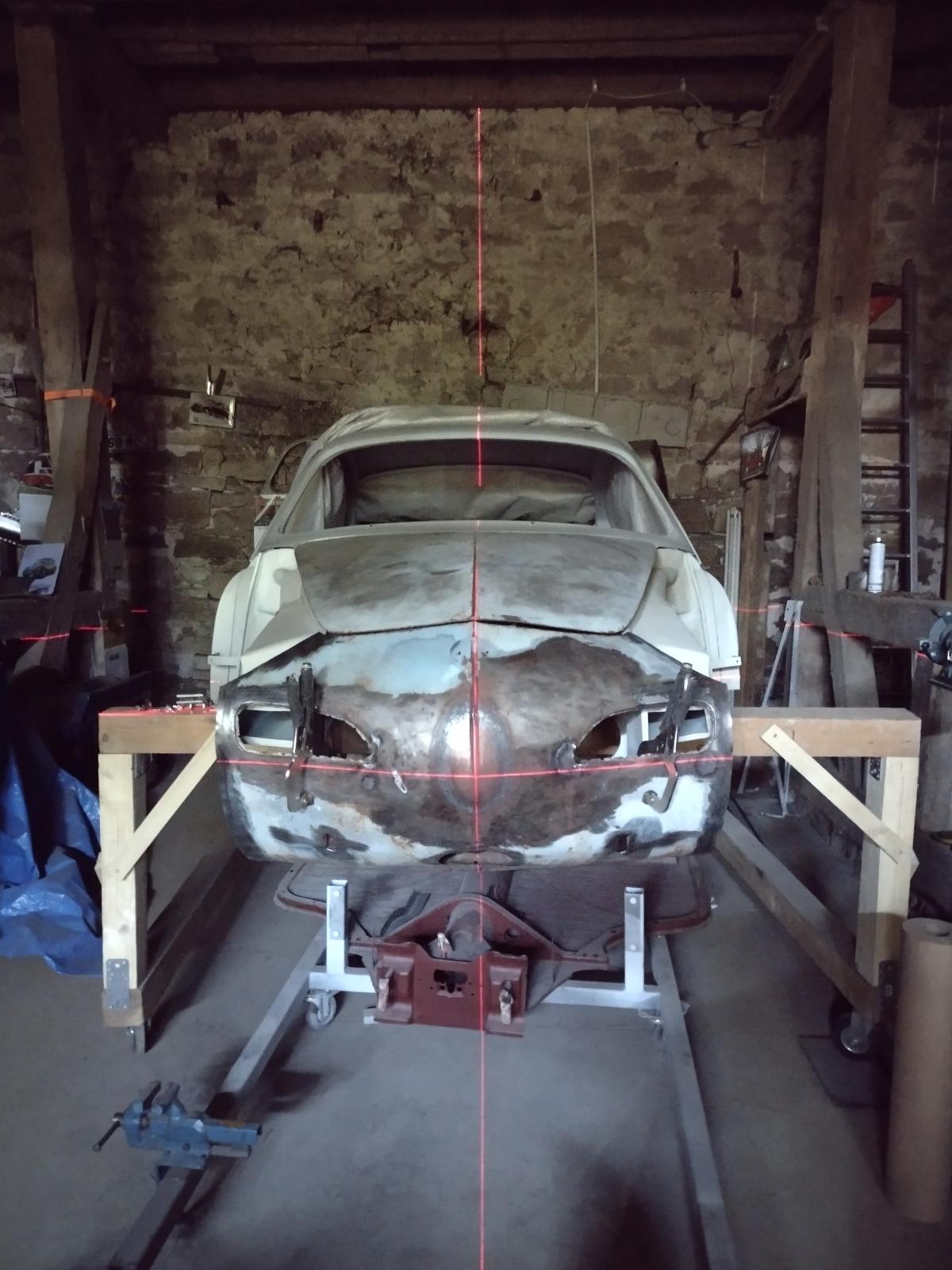

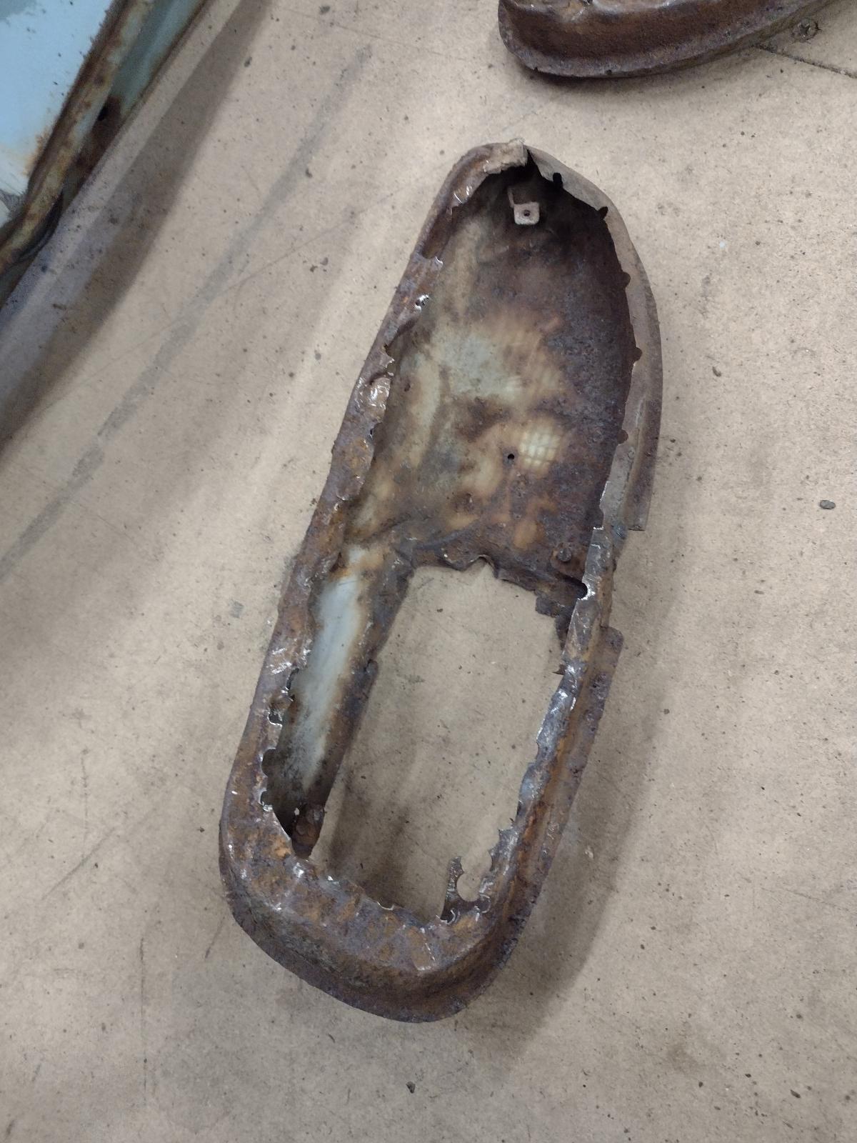

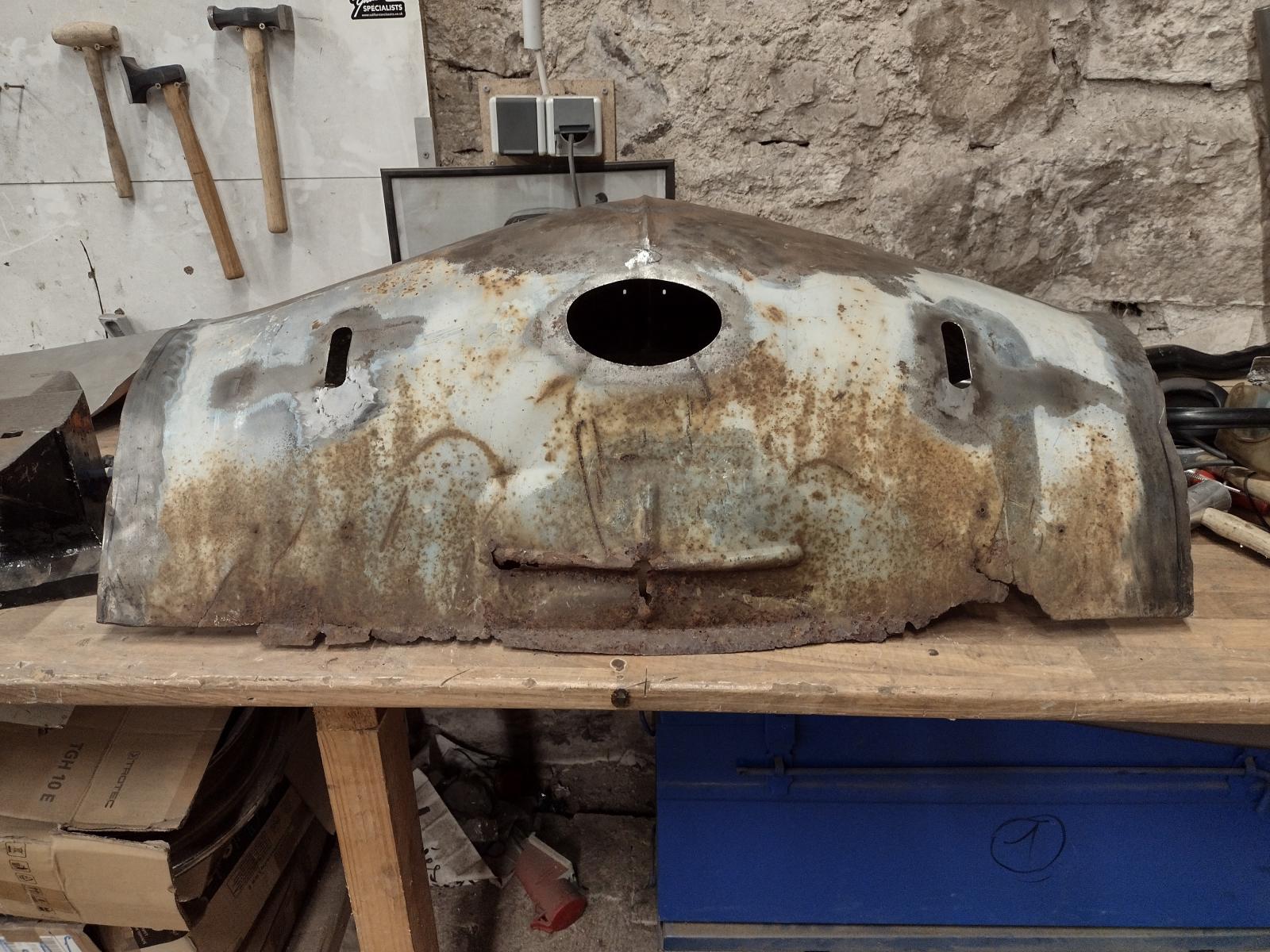

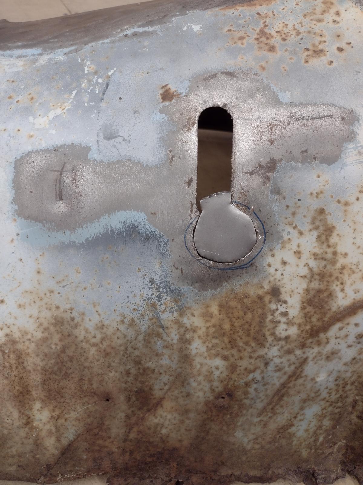

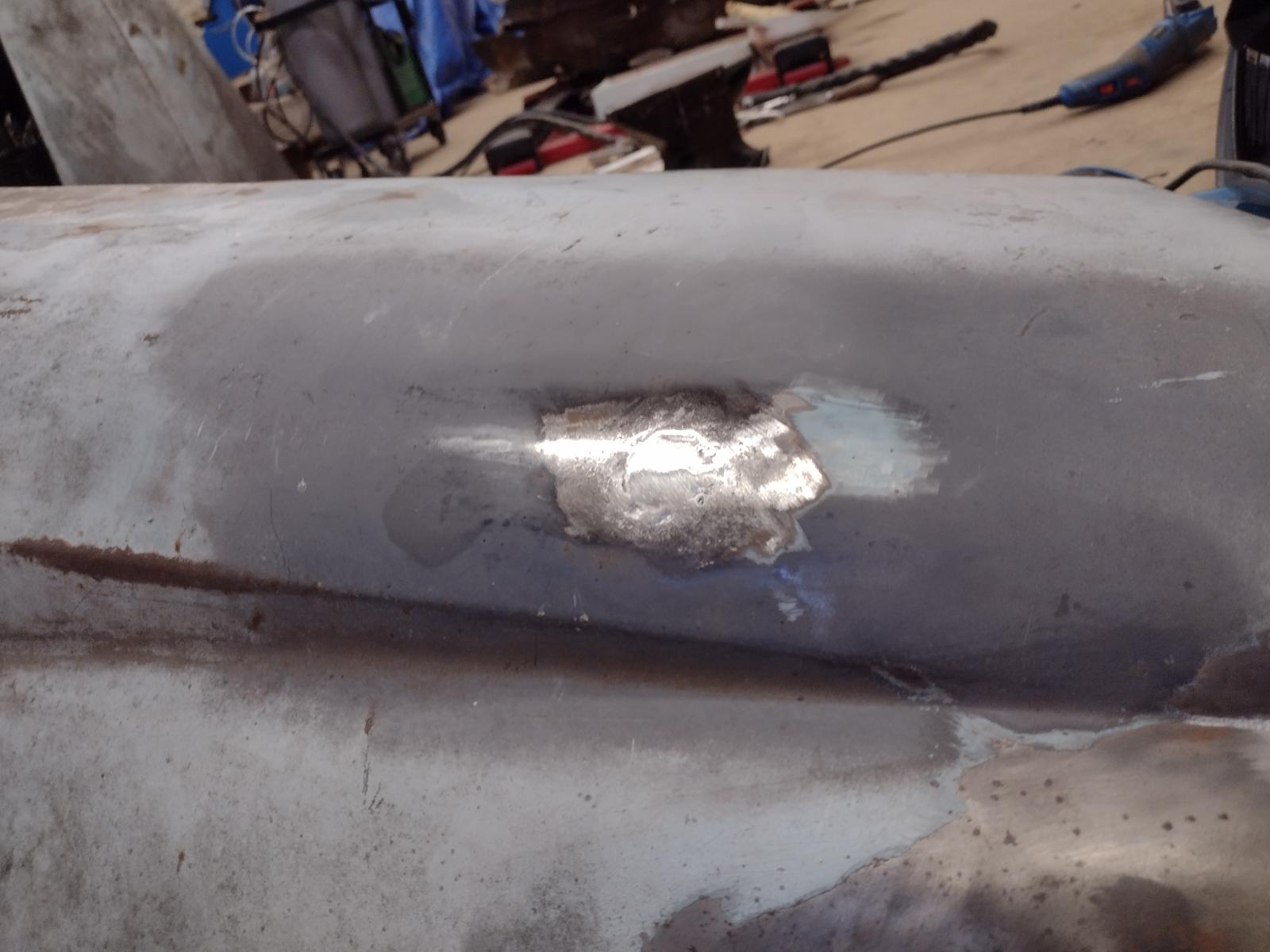

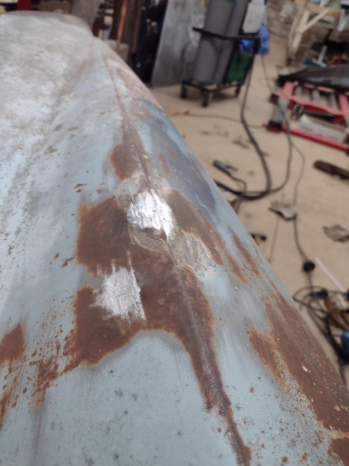

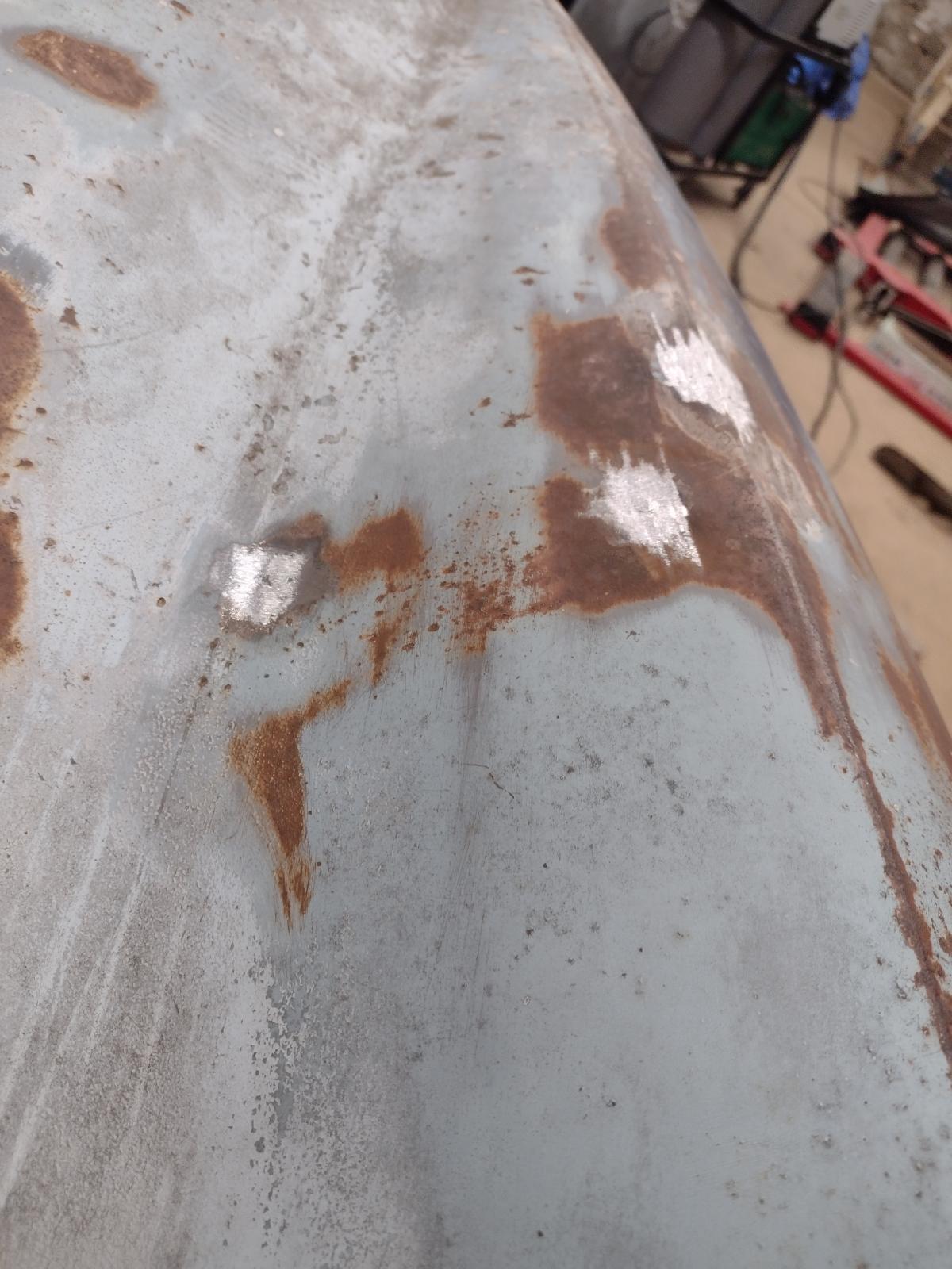

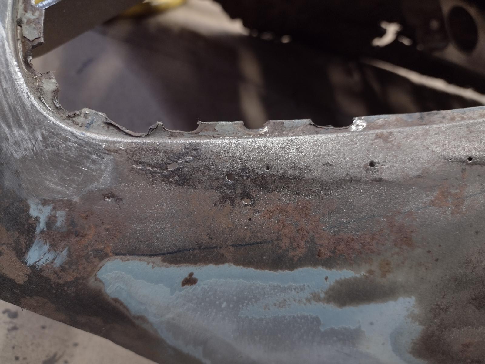

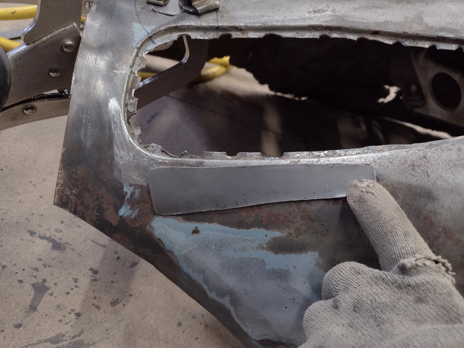

So, long time no update but a lot of work in the background! Since I will be finishing the bottom/front of the fenders when everything will be mounted/aligned, I thought I should start on the front mask. I know, it is available as a repro but where is the fun, right? So, first removing the rest of the air-boxes to have a good access: They will require a lot of work (or I will build new ones!): But focus is the mask first. Lots of small repairs: Before: During: After: Before: During: After: Before: After: Before: During: After: Before: During: After: Before: During: After: Before: After: What is left is the bottom part: But first I focused on getting it back in shape as it was completely out of form: Lots of checking: And trial mountings: It is starting to look good, at least good enough to position it and use it to mount the fender. But before that, some steps are still necessary, stay tuned! Antoine

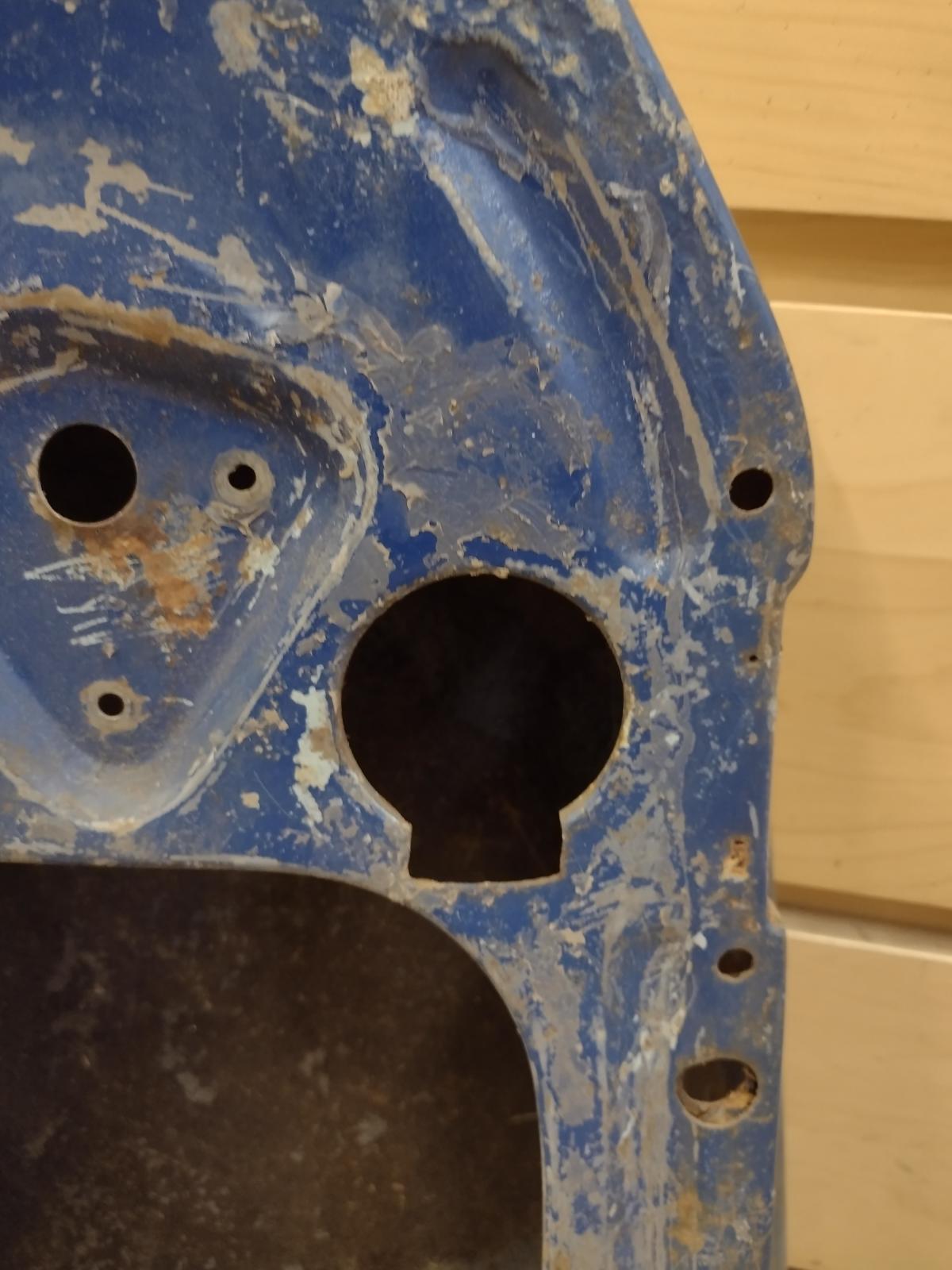

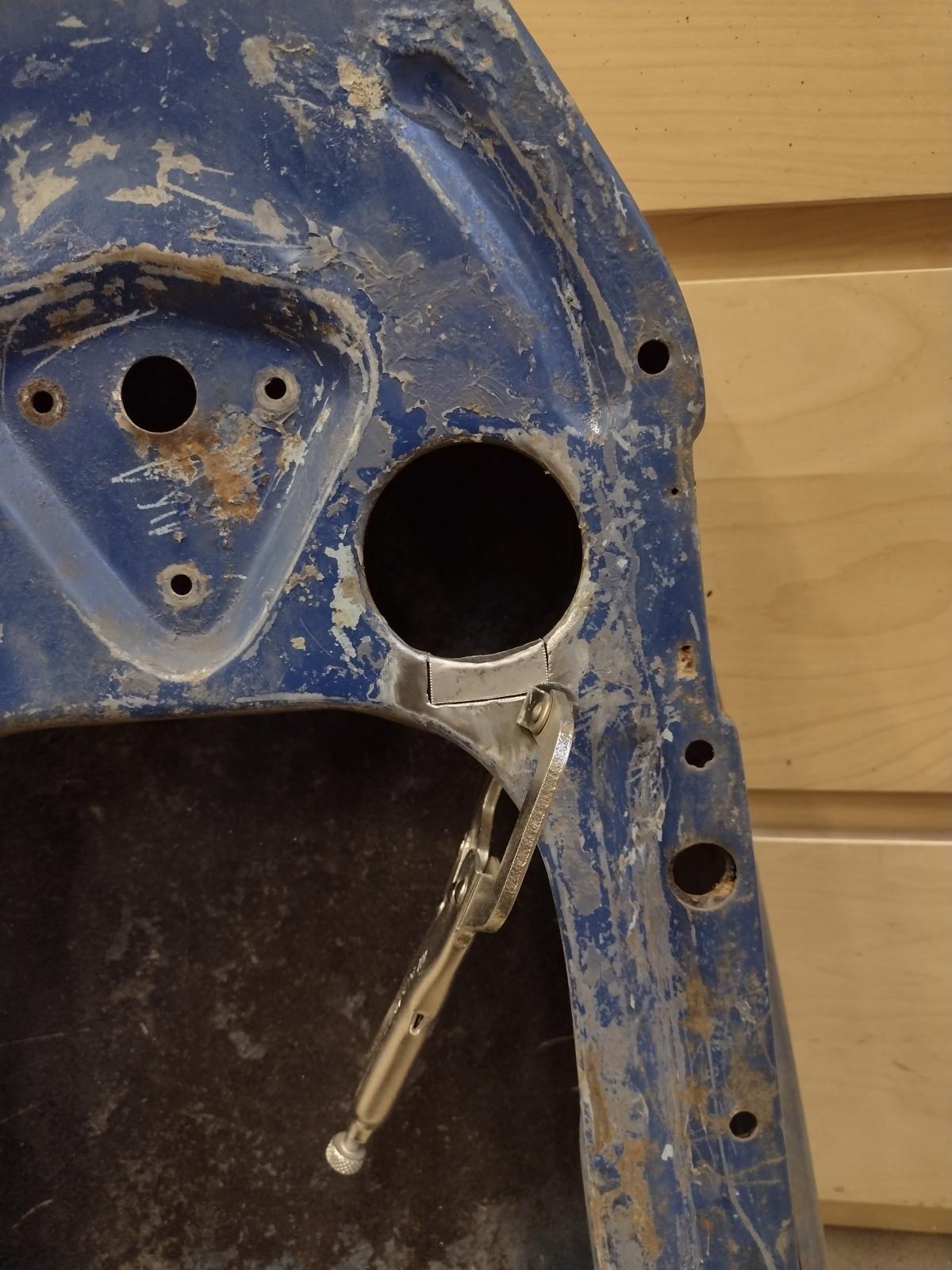

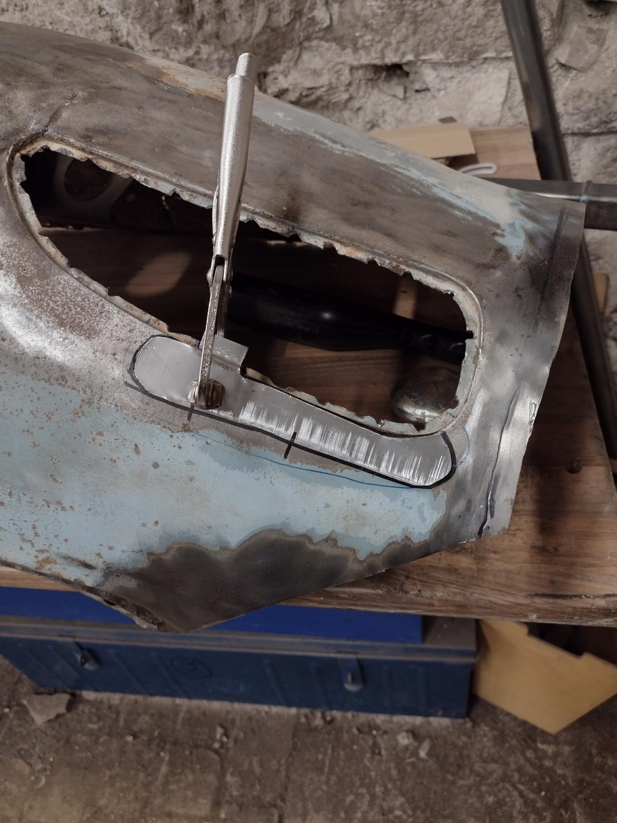

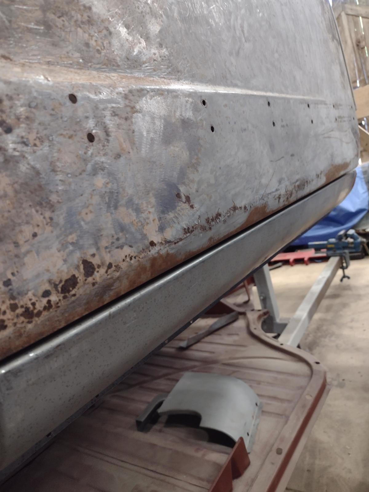

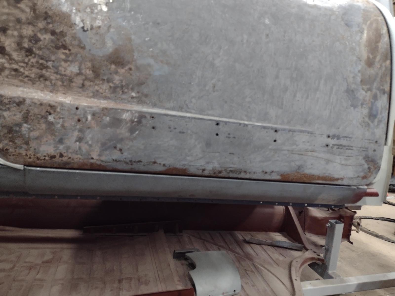

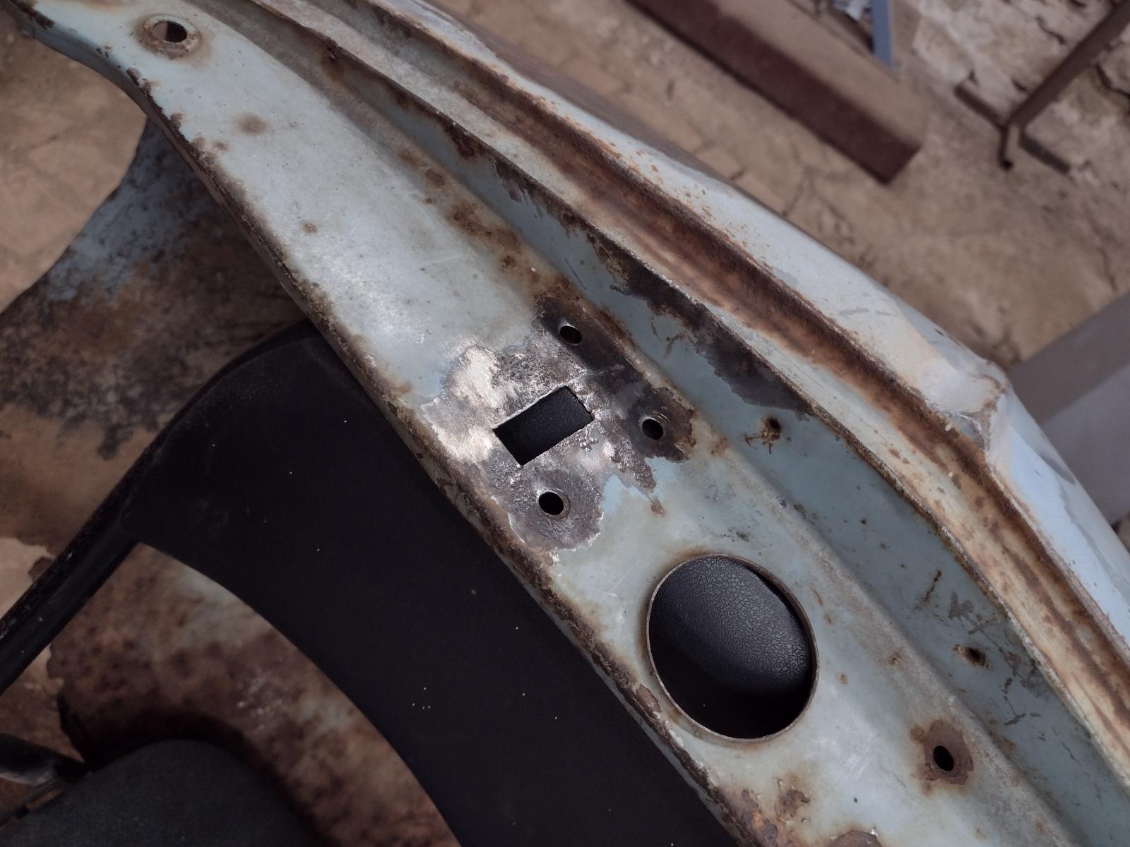

There will be much more to do on the doors but I was tired of seeing the cut there so I fixed it:
Before: During: After: And the second door: Before: After: Bests Antoine

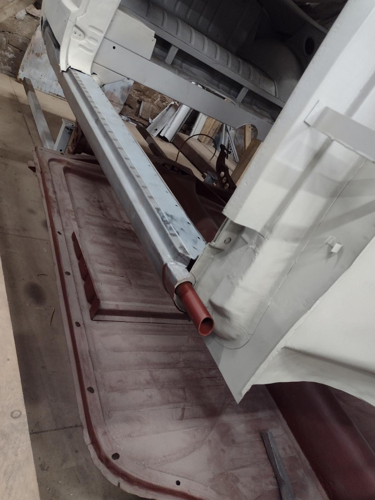

#227

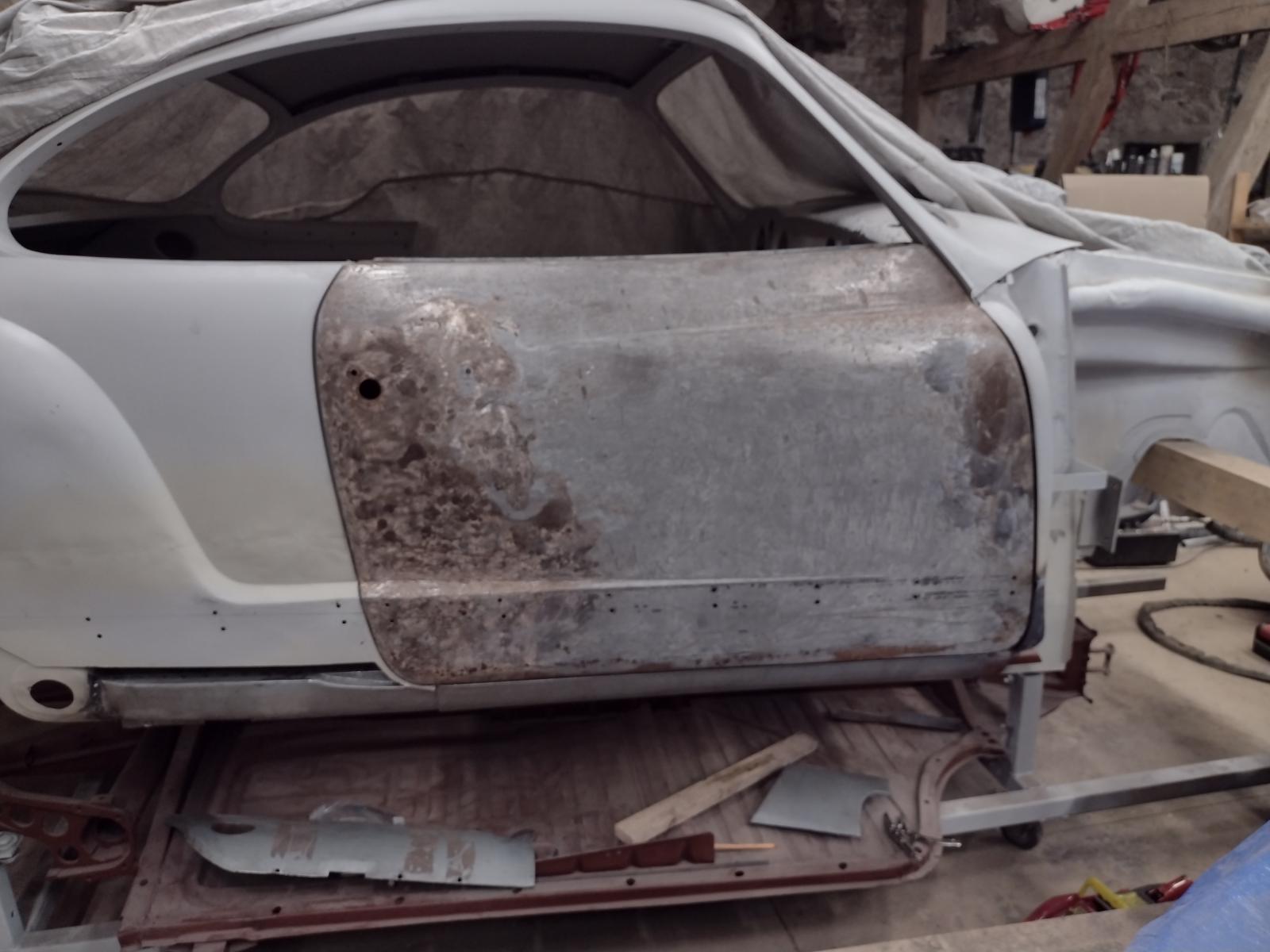

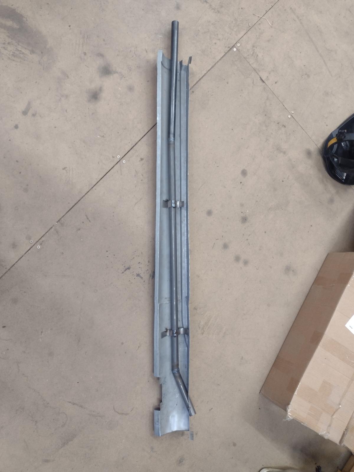

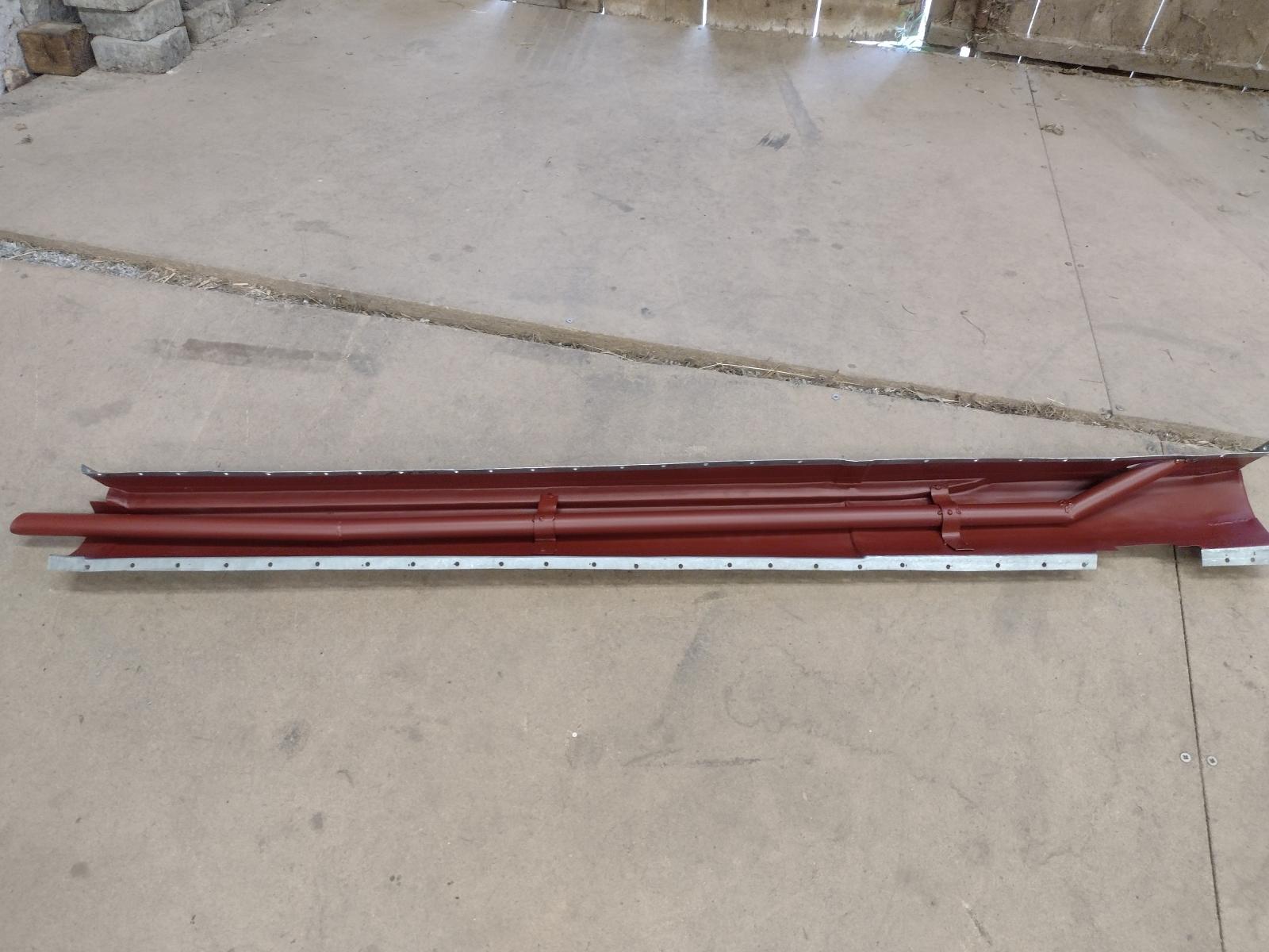

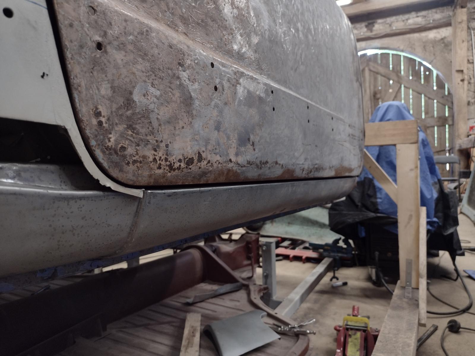

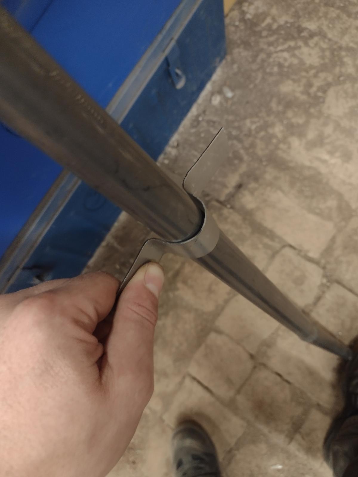

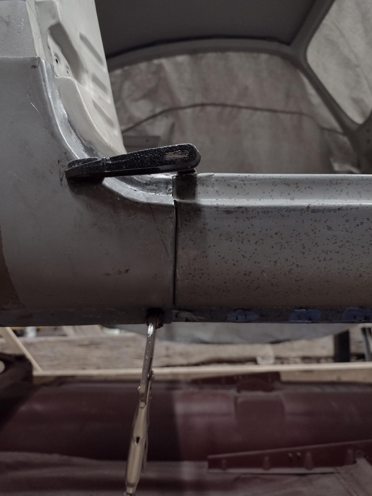

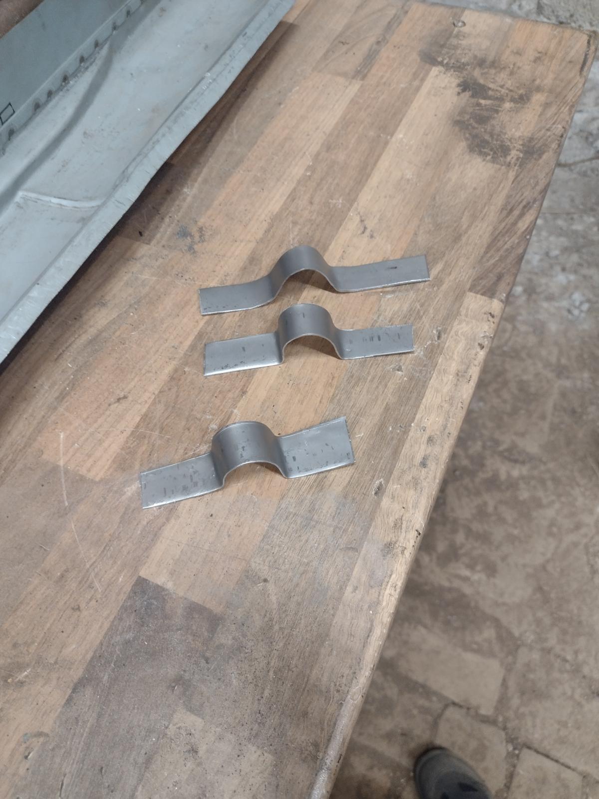

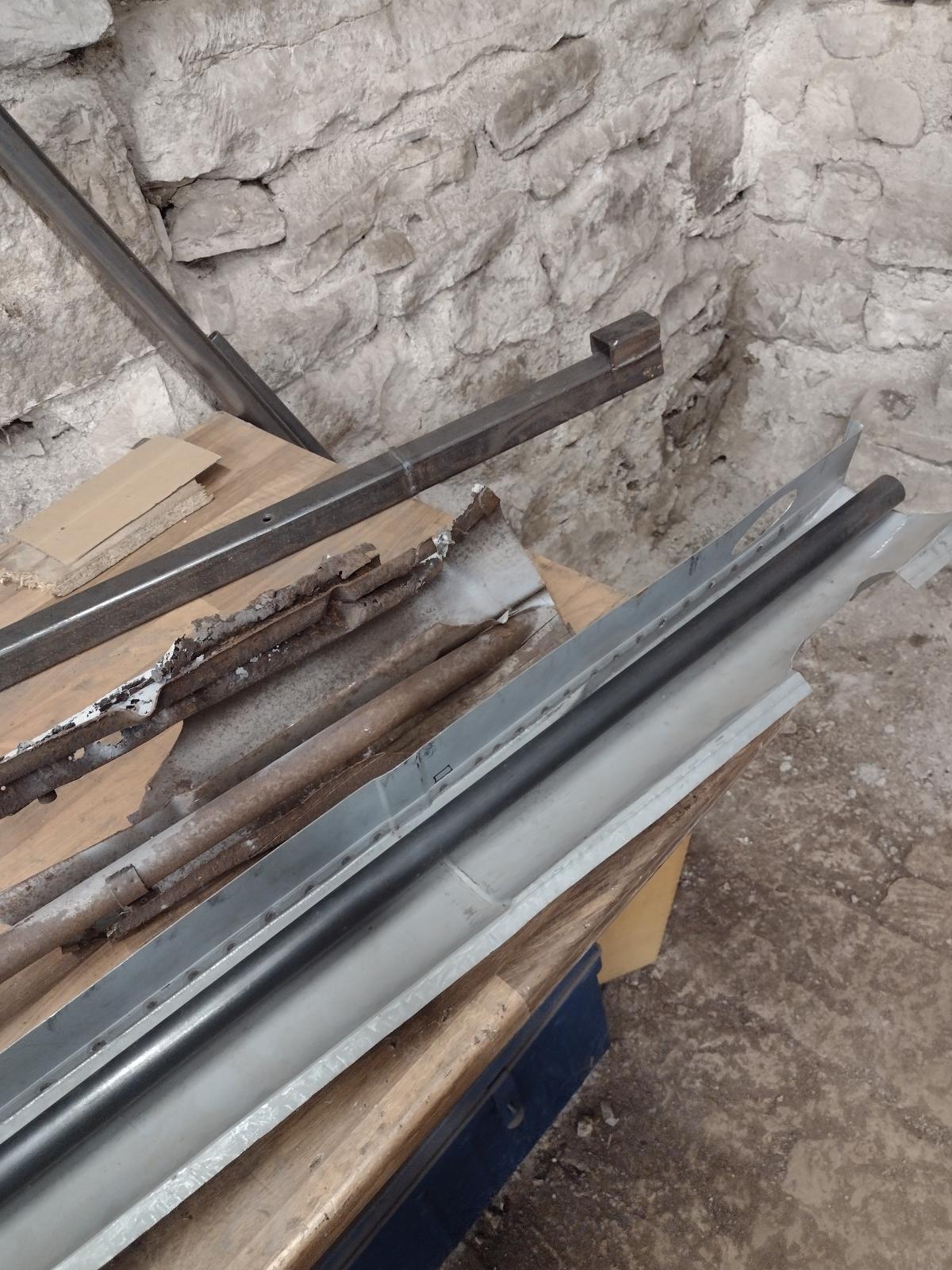

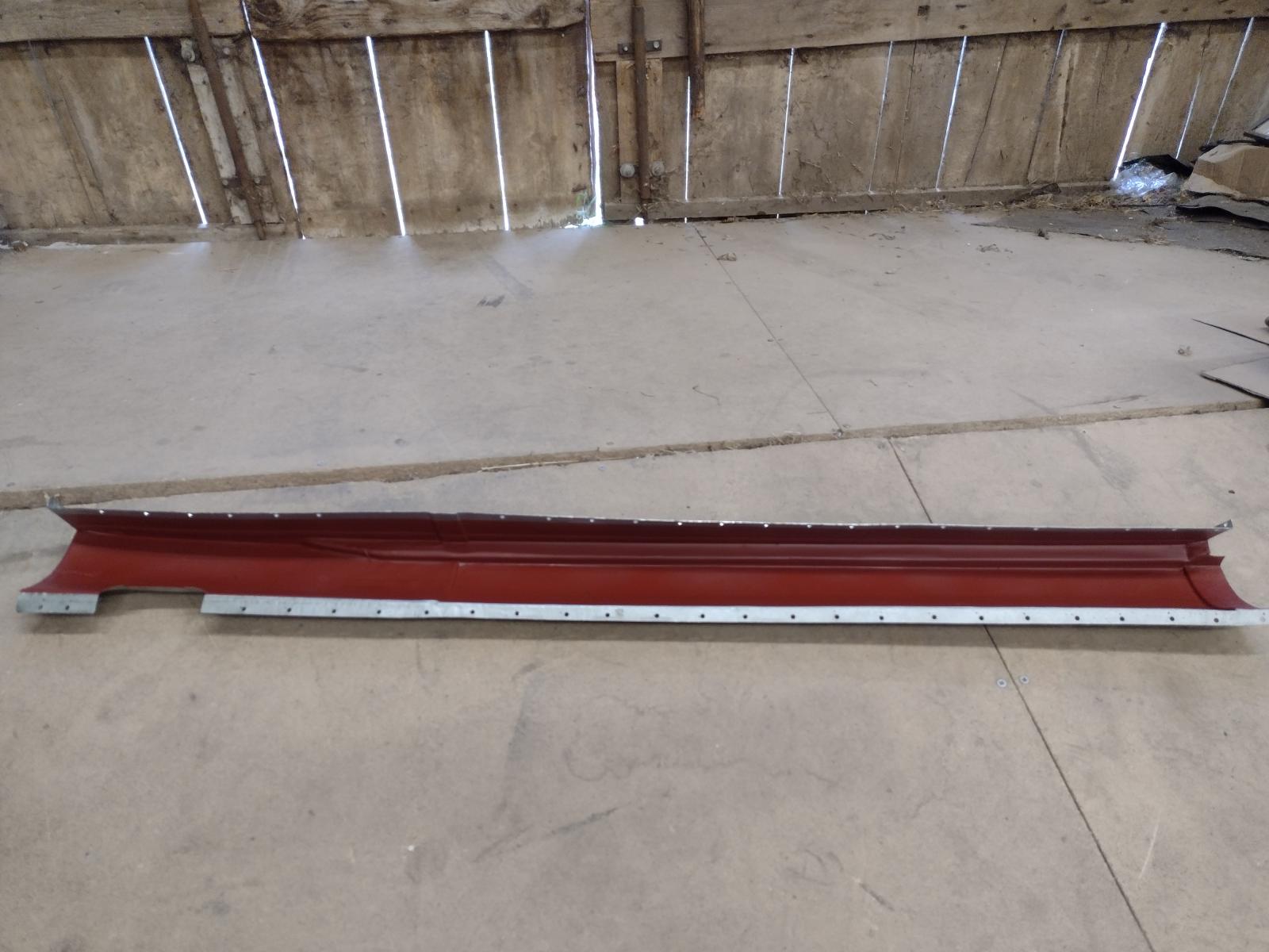

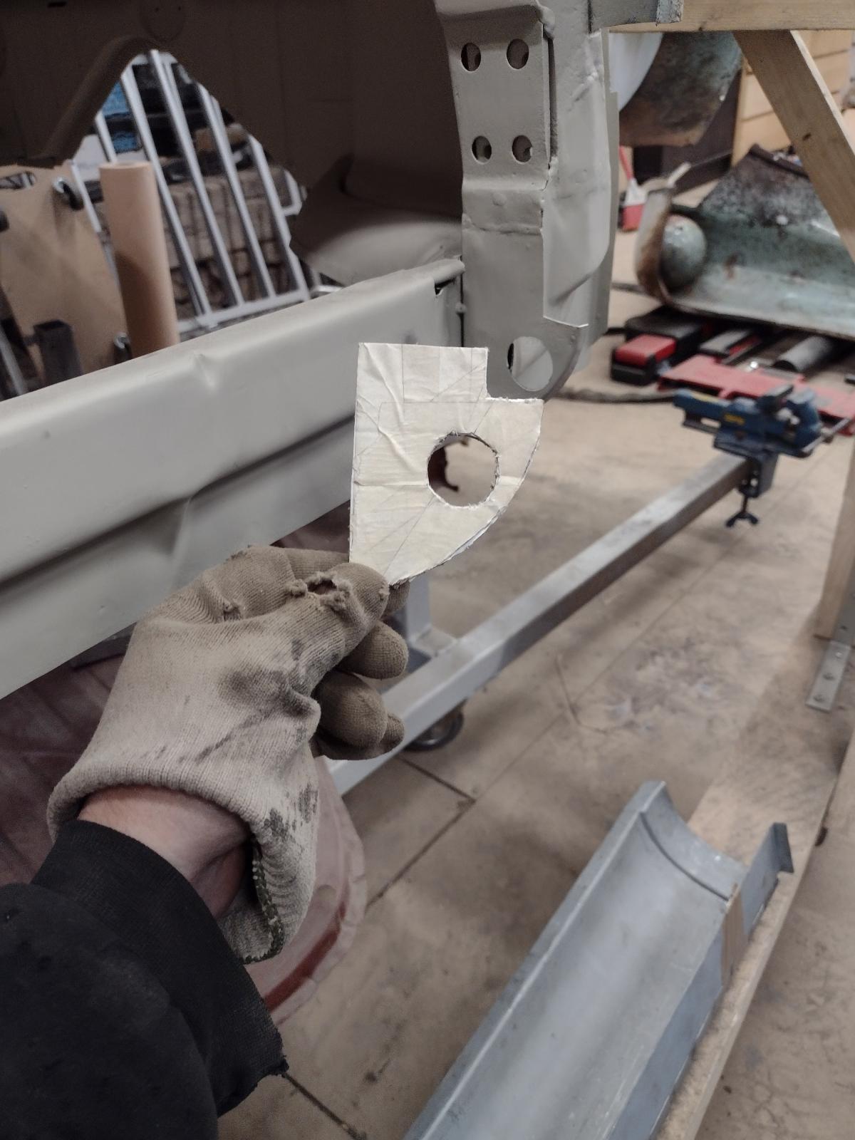

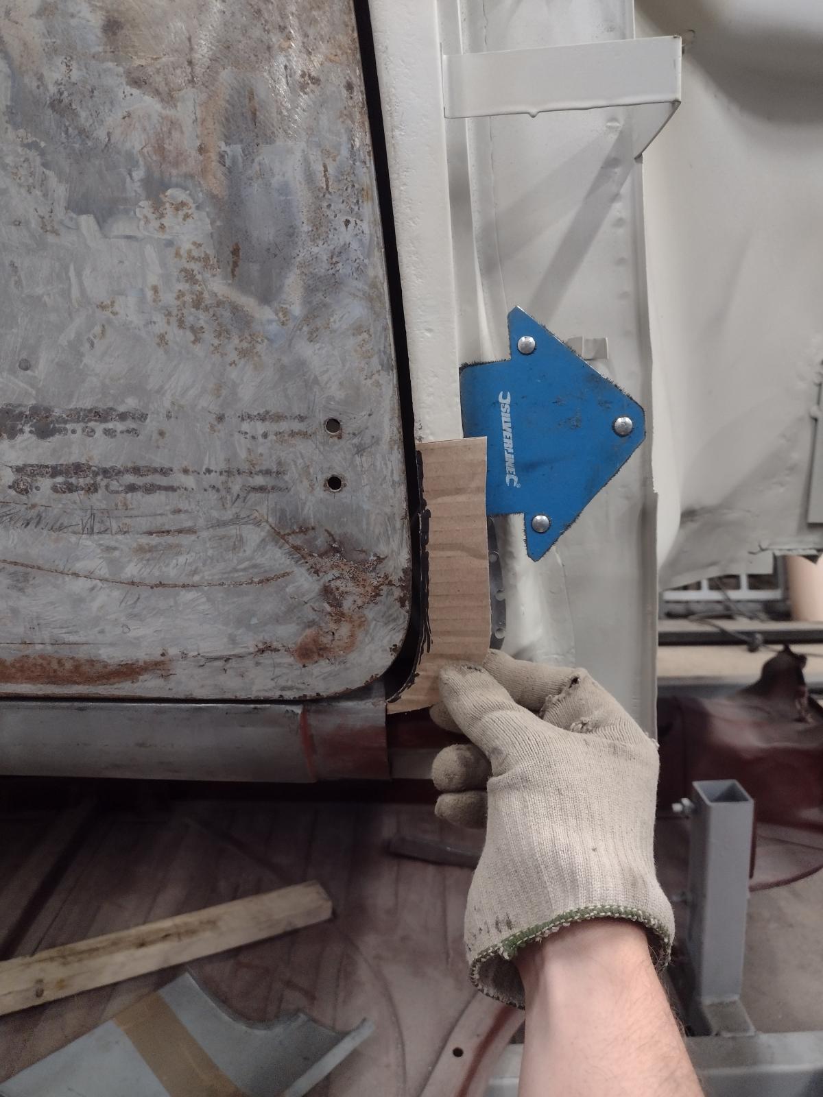

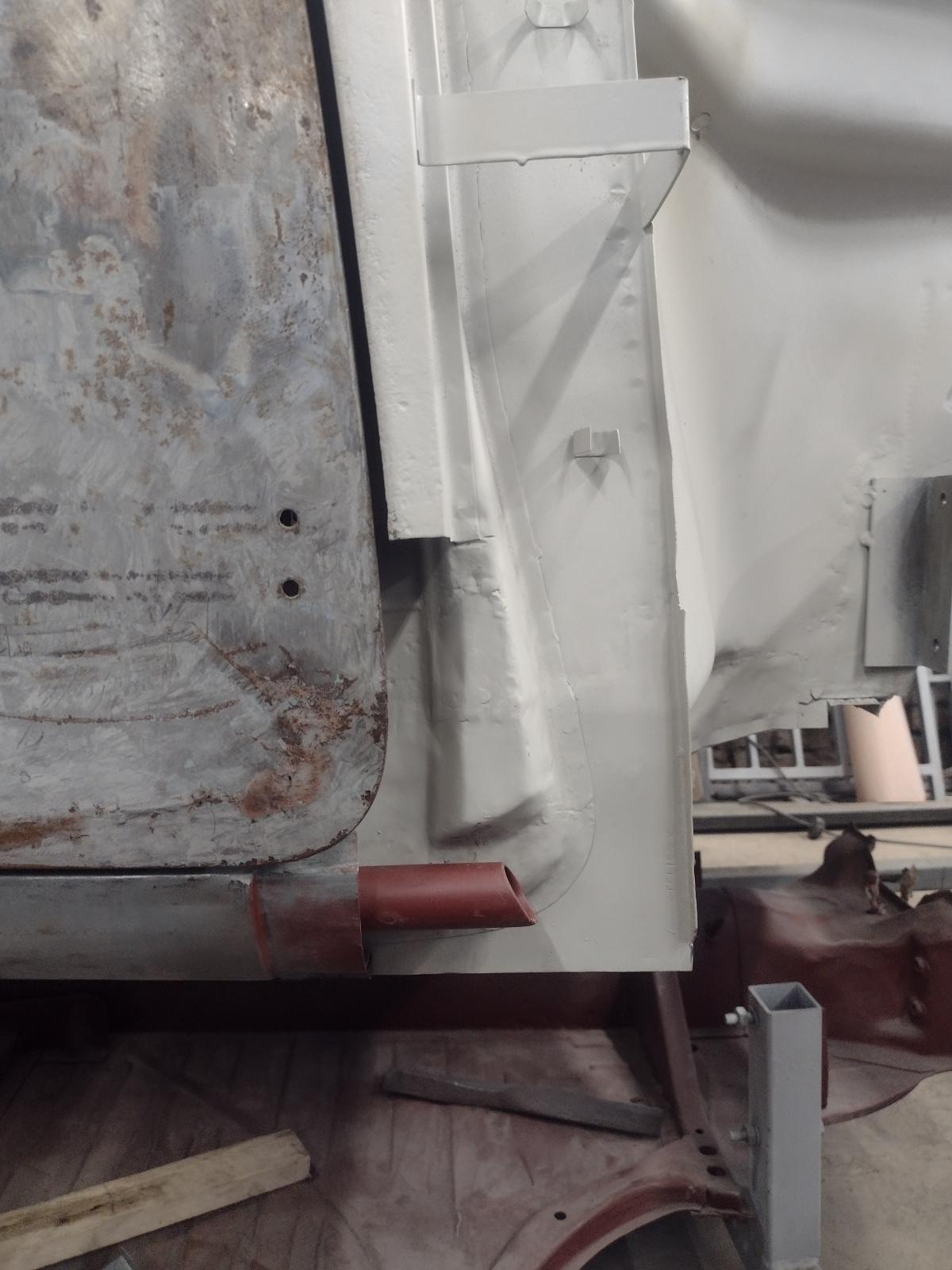

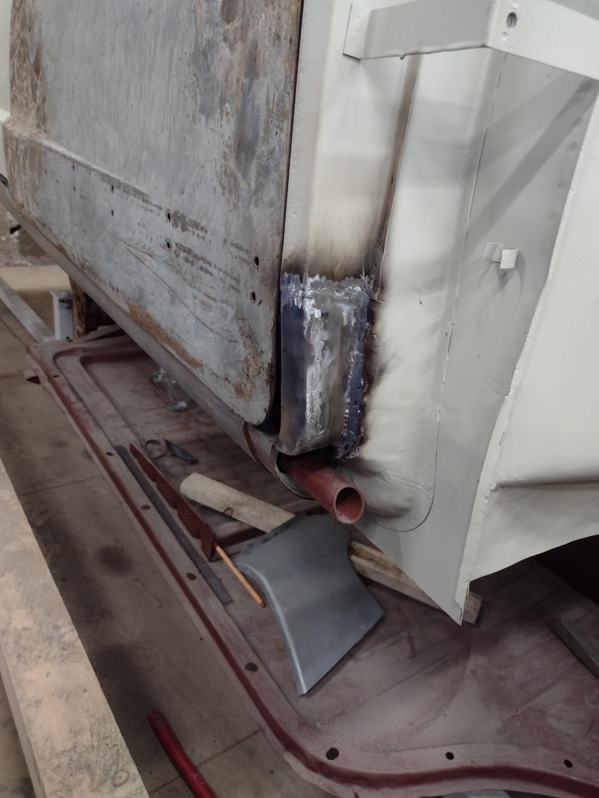

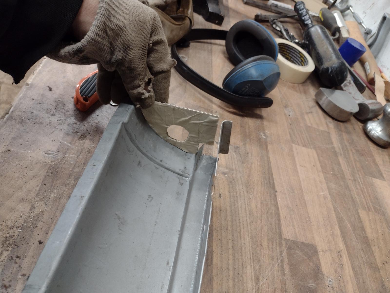

So, I took the doors out of the storage to use them to adjust the parts under and around them but before adjusting on the car, I had to put the tube for the wiring harness like here on the orginal part:
So let's start: But it has to go through the A post so I made a template: To get the position : And I made the fixations: And welded it : And some paint to protect it durably: Then it was time to adjust it: And welding: Door fits well: And A-Post was next: One day this will fit like that: But some more work left before..stay tuned, I am already further but late with updating! Antoine

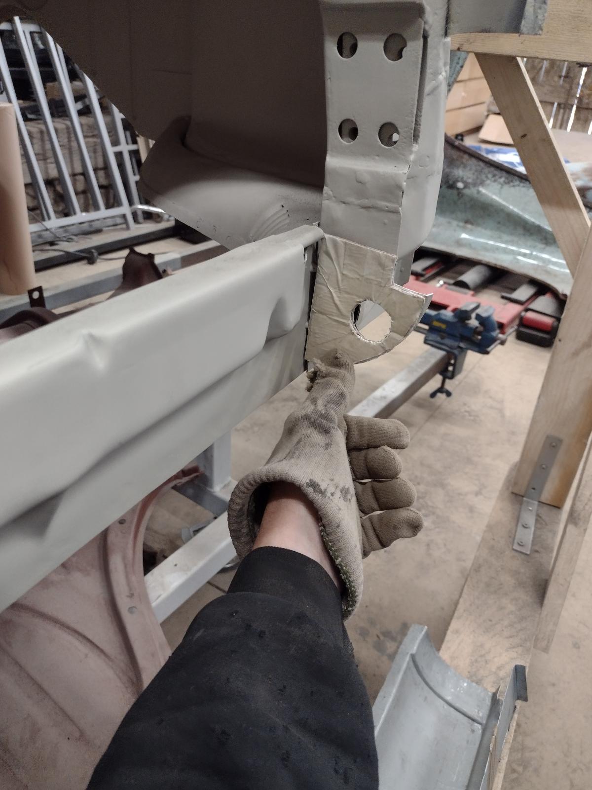

#228
Thanks a lot, happy if it helps!

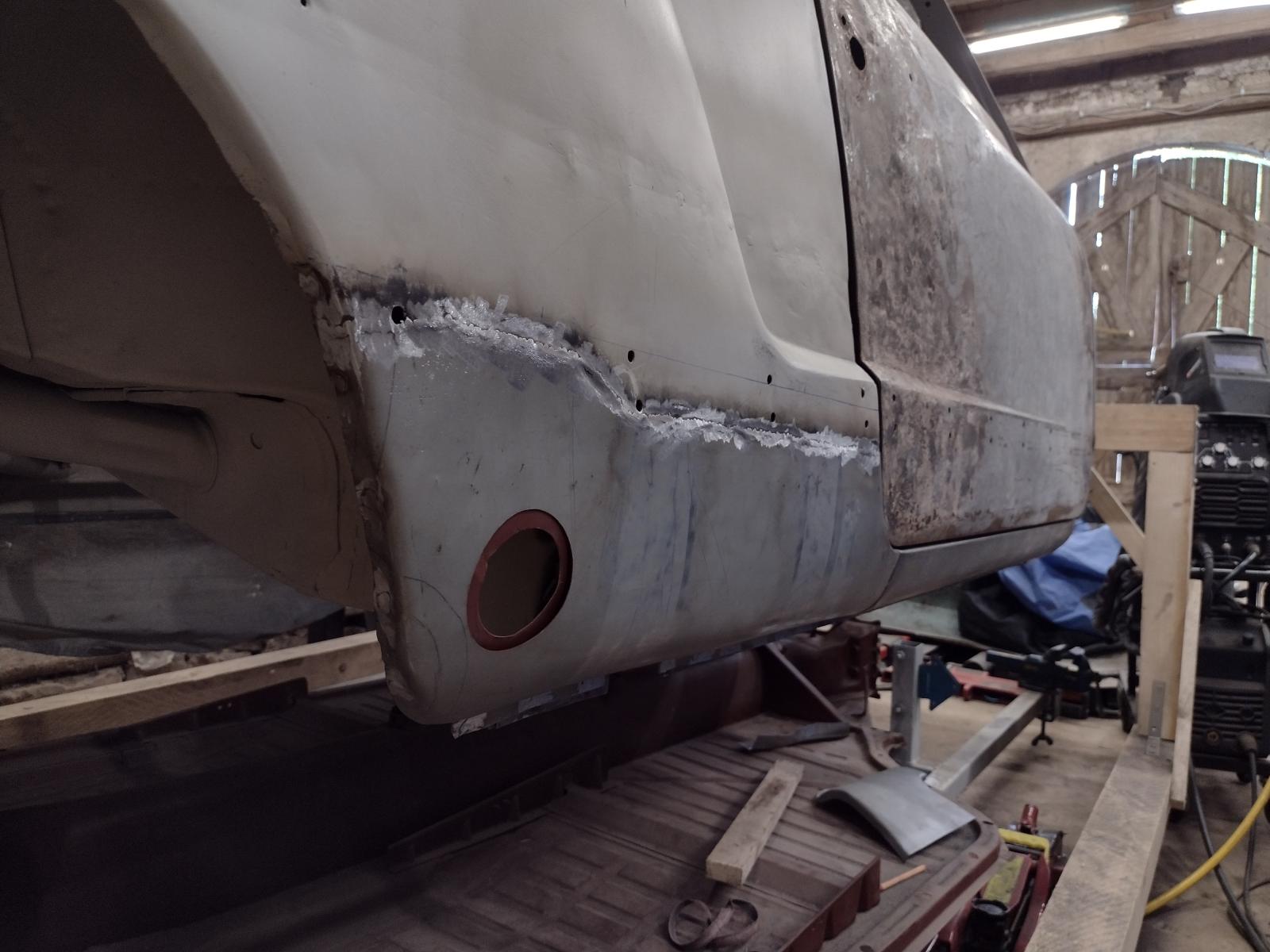

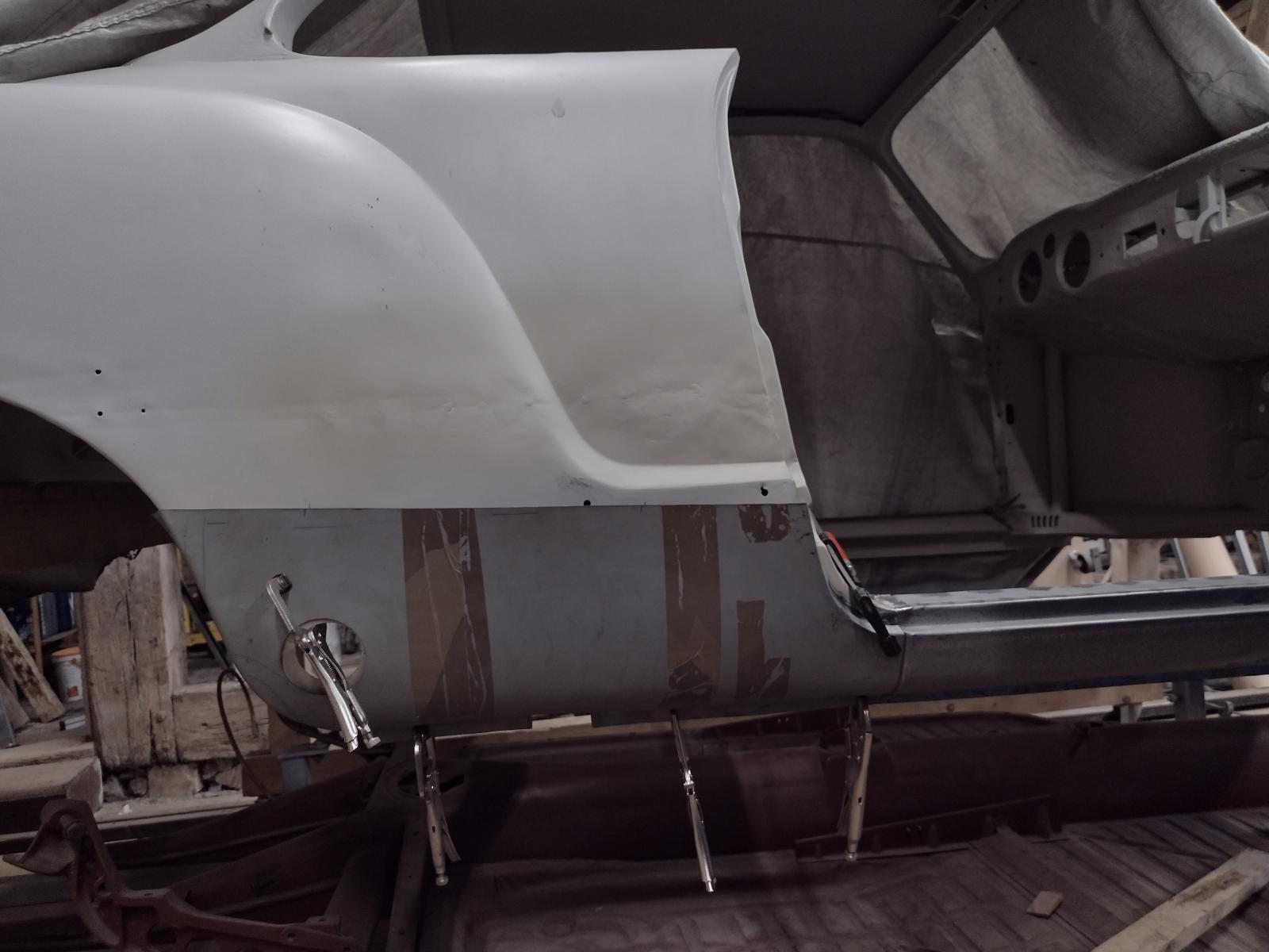

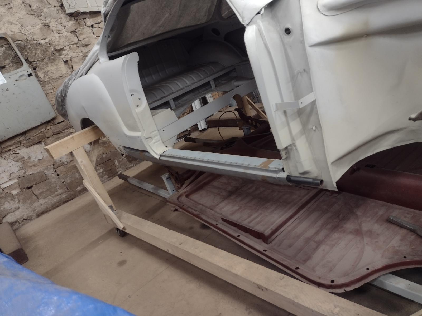

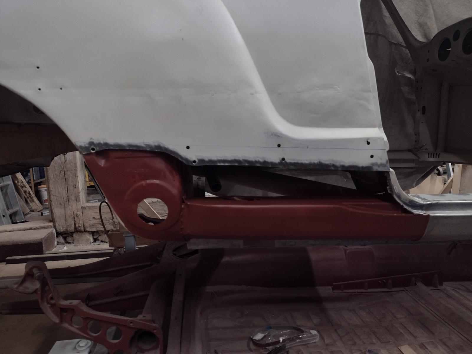

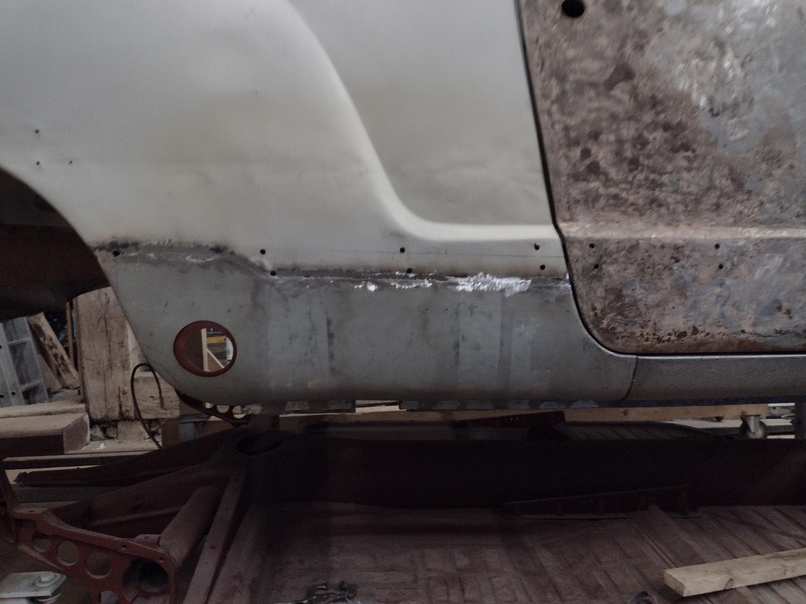

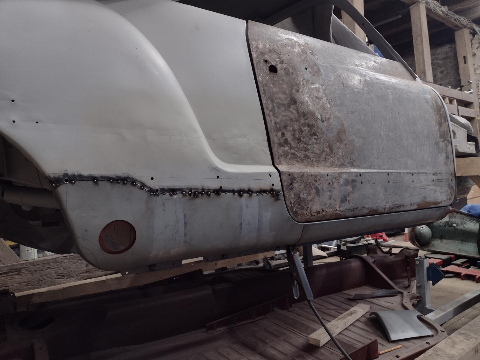

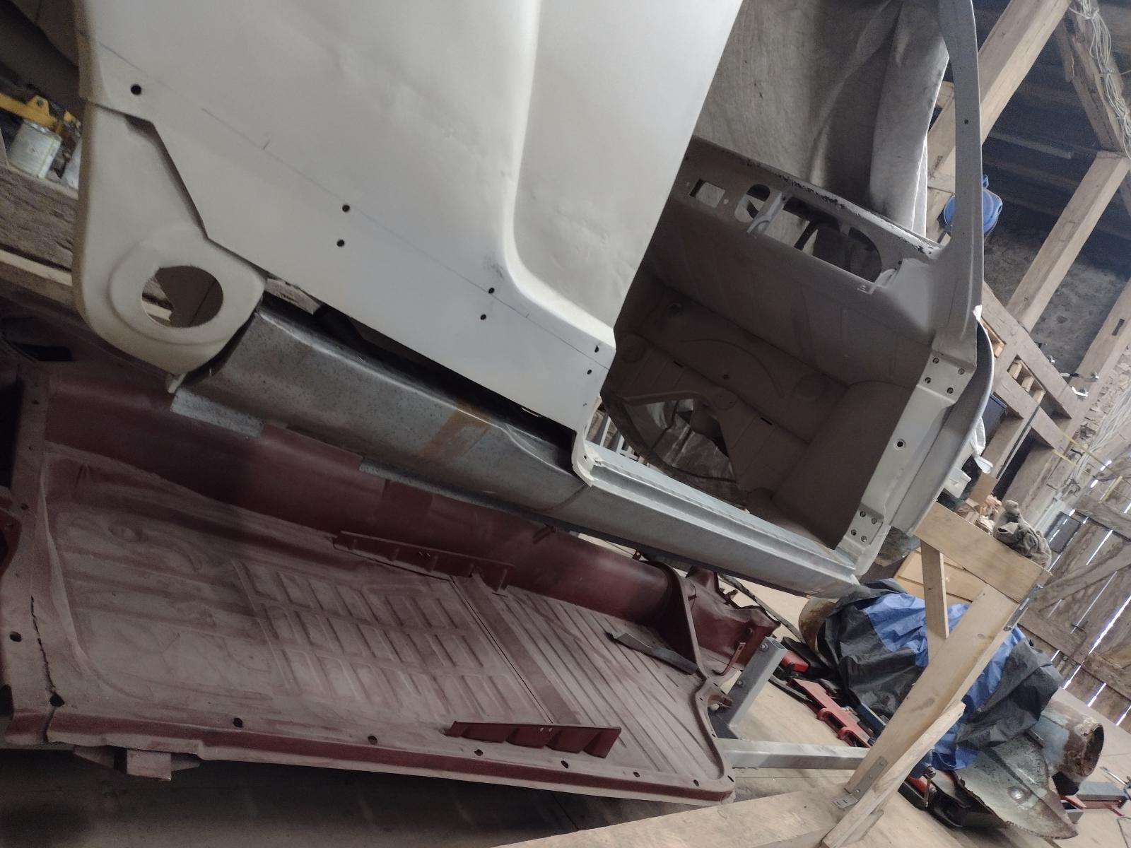

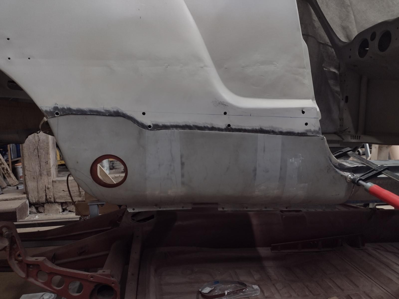

So, after the sill and A-post, it was time for the rear quarter : Checking: Adjusting it: Rust protection and paint behind it : Tacked in place: And fully welded: Bests Antoine
