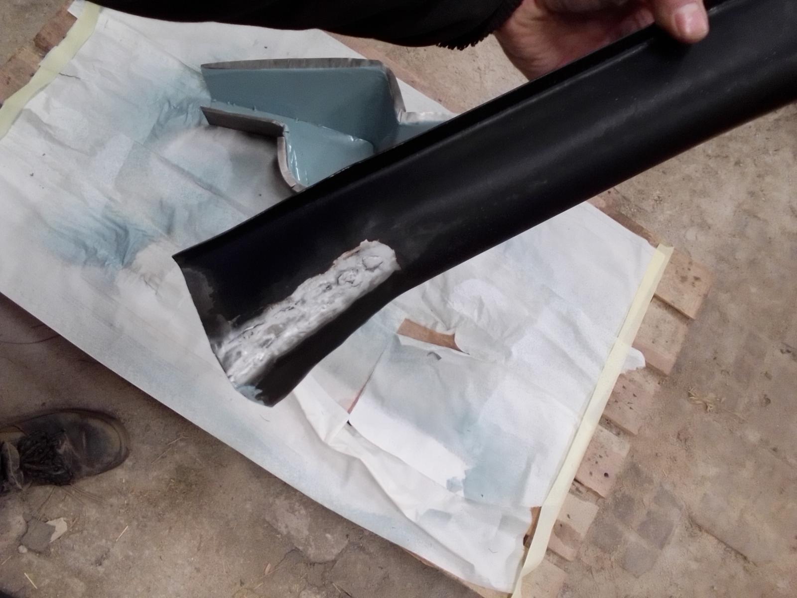

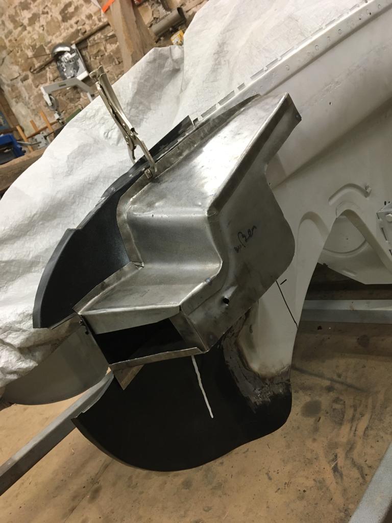

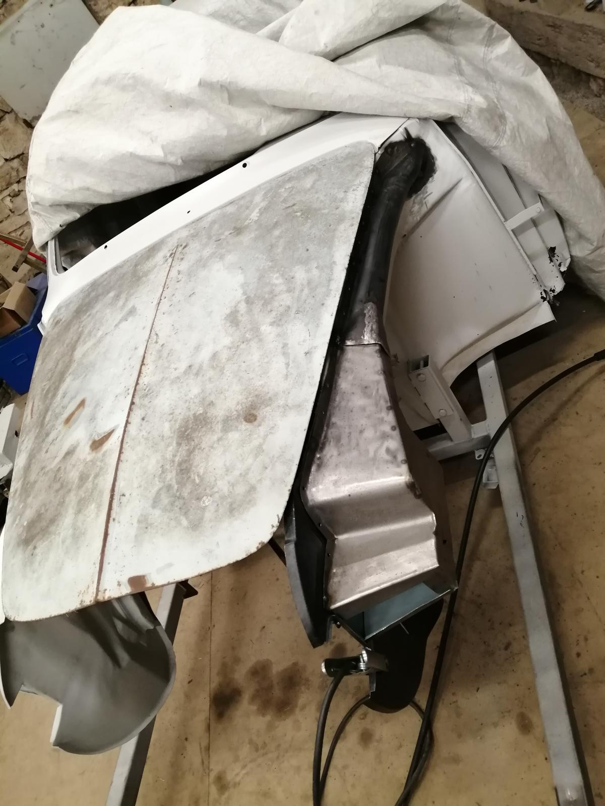

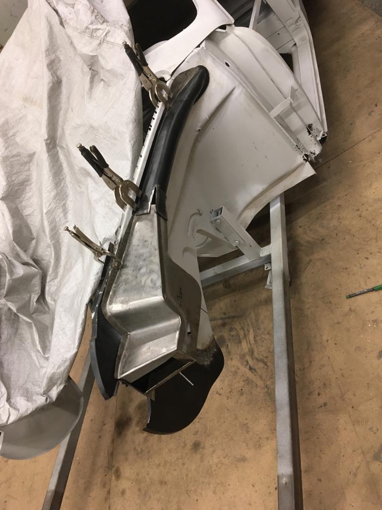

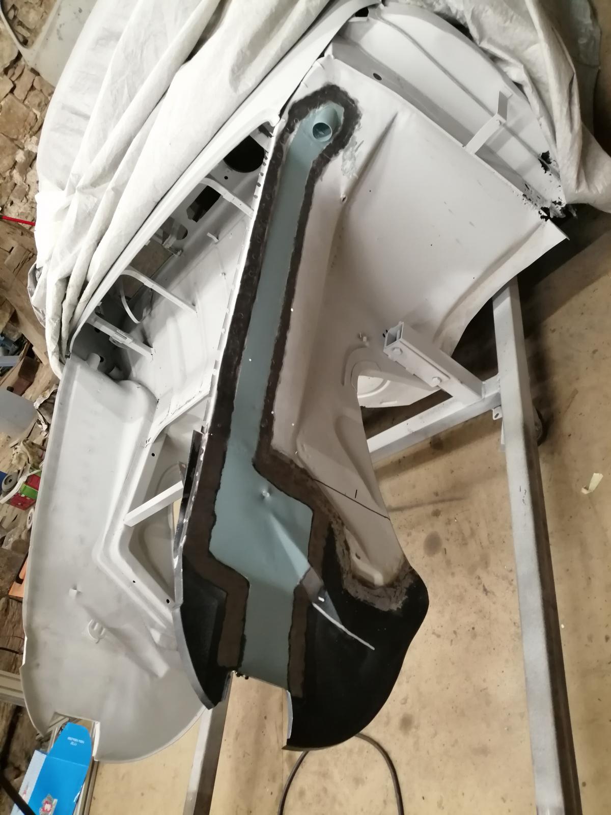

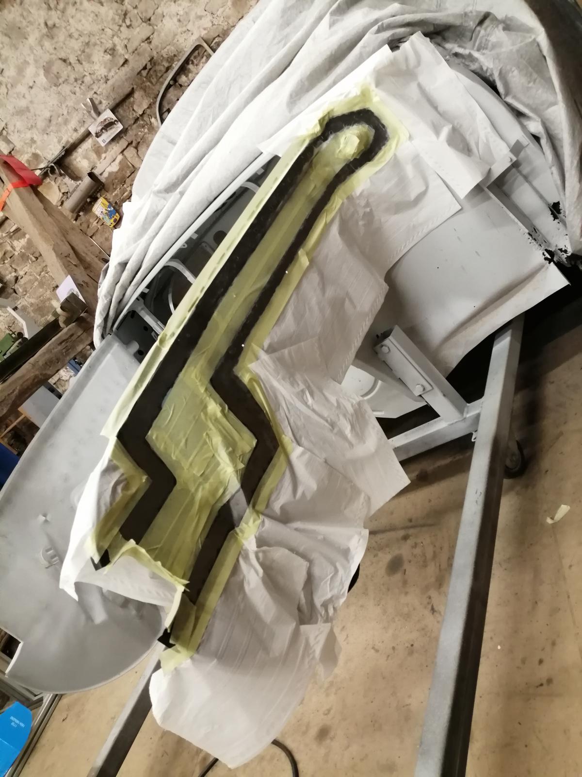

After the welding primer dryed out, it was time to tack weld the airbox, only a couple tacks at the beginning to check it assembled:
Seems to fit good:

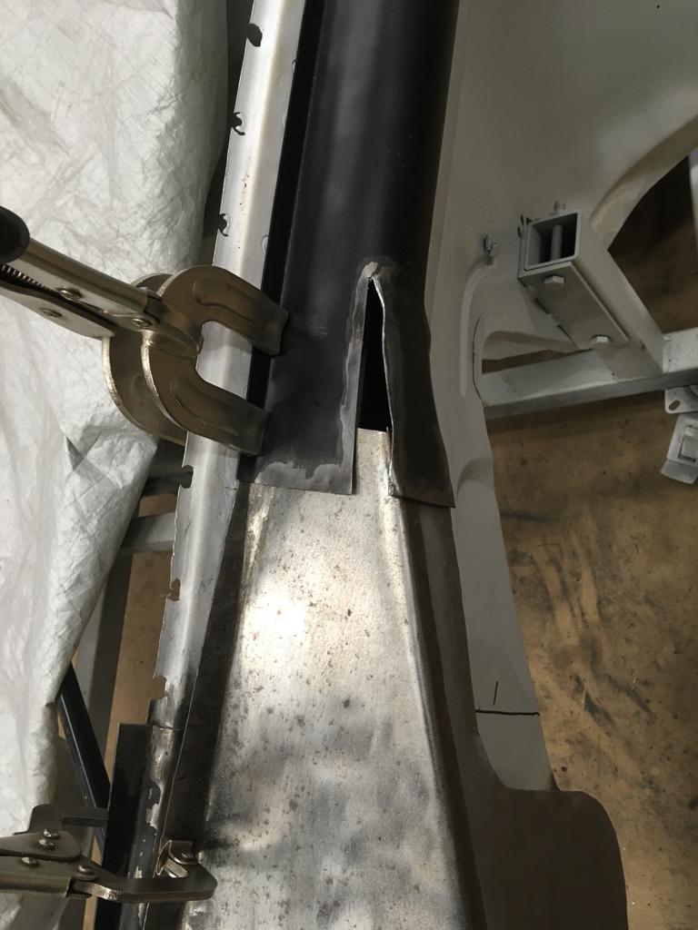

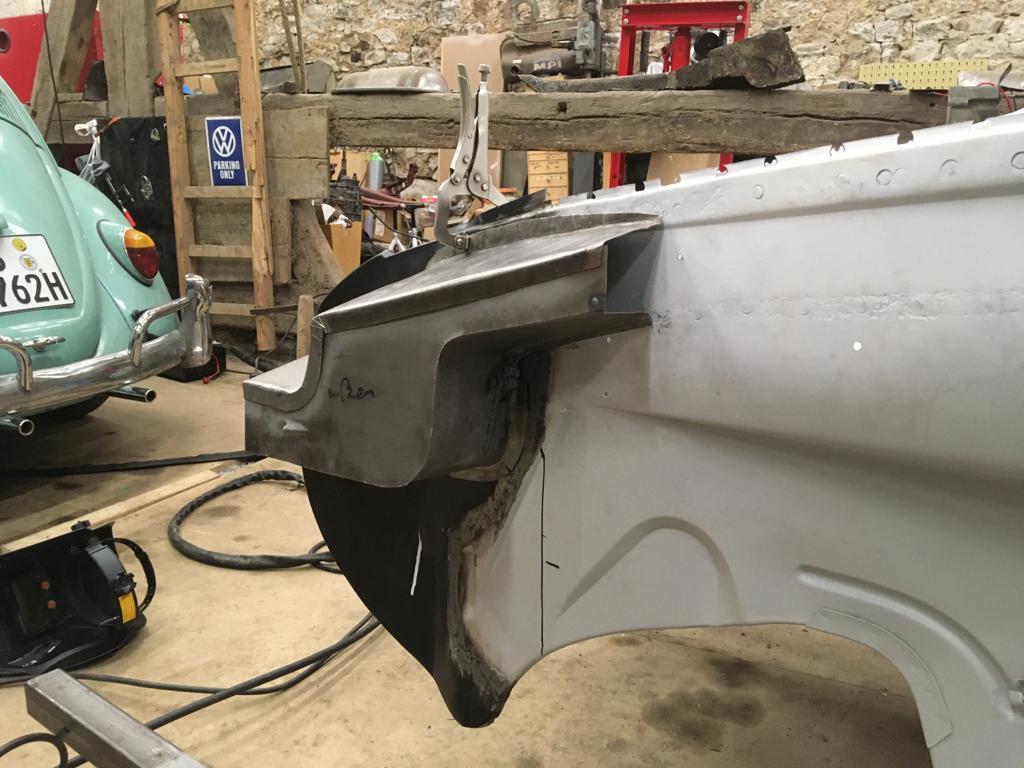

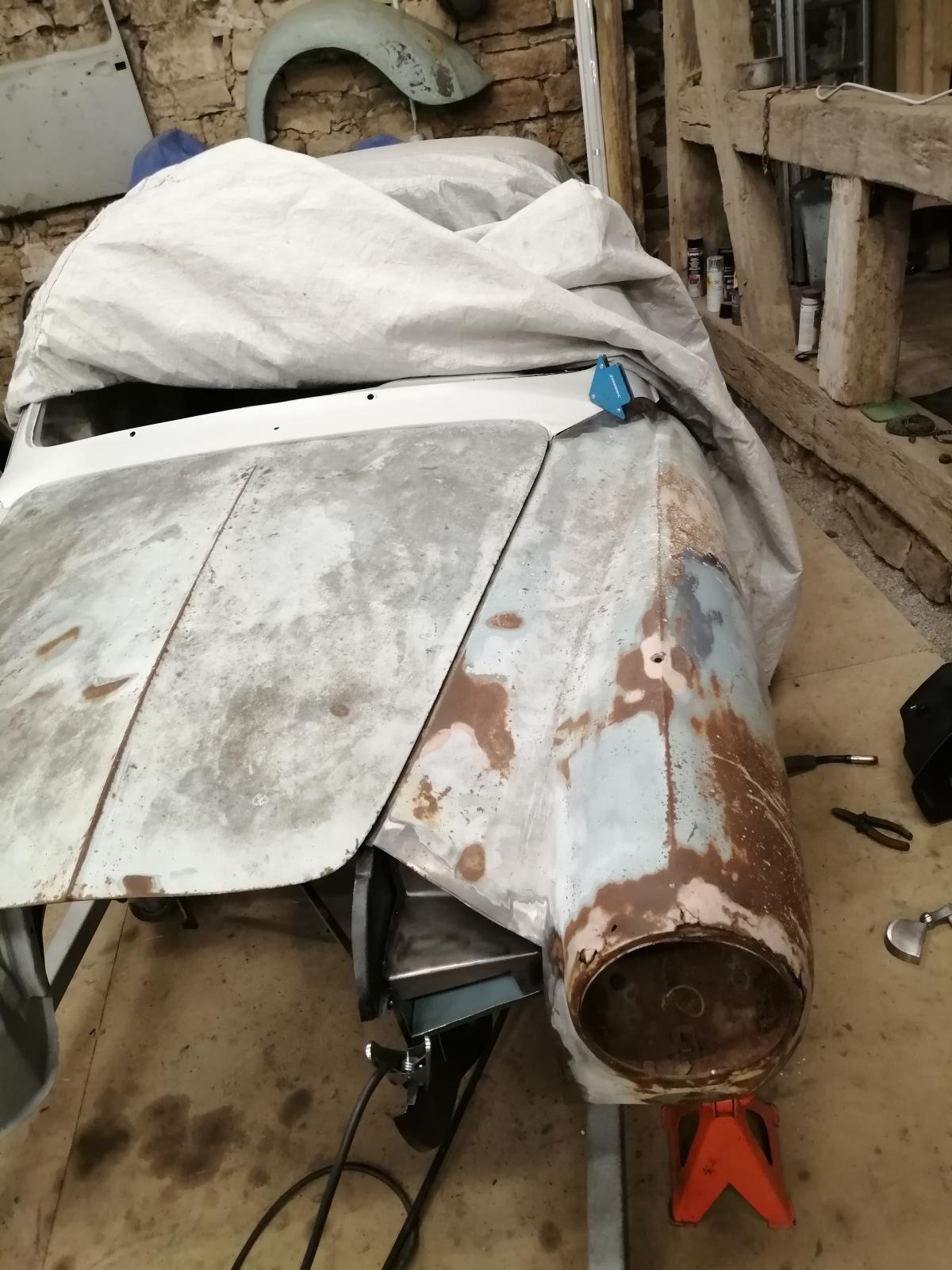

Then I put the repro "tunnel" for the back part..and it was totally wrong. I compared it with my original..and for sure it was way off...
I then made some cut to "adapt" it:
and welded some tab to keep the position:
Then it was a matter of filling the space by creating the missing part and tig welding it:
now it fits:

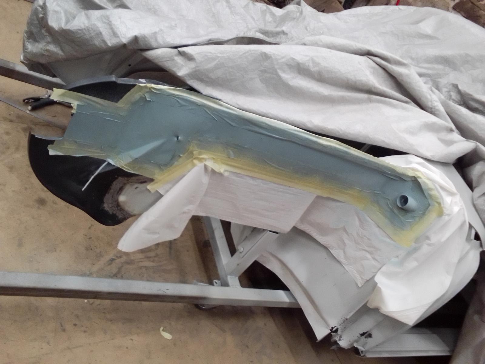

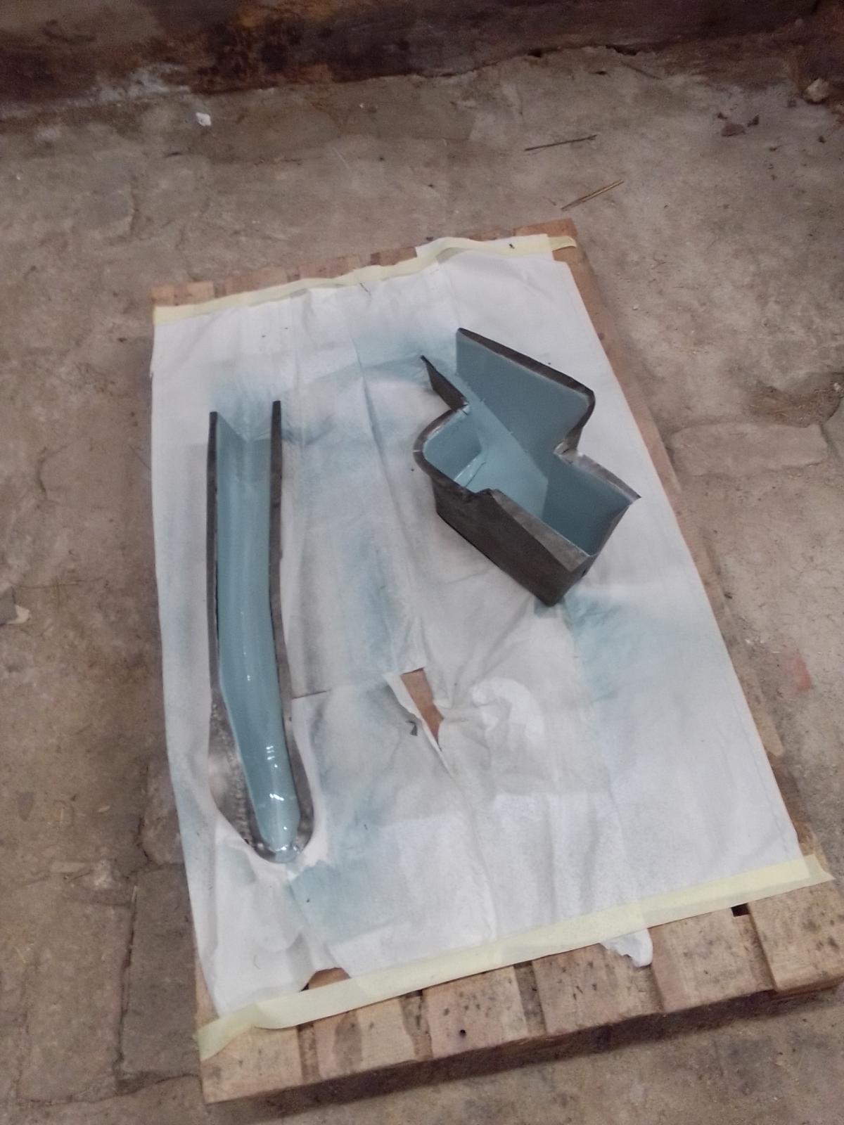

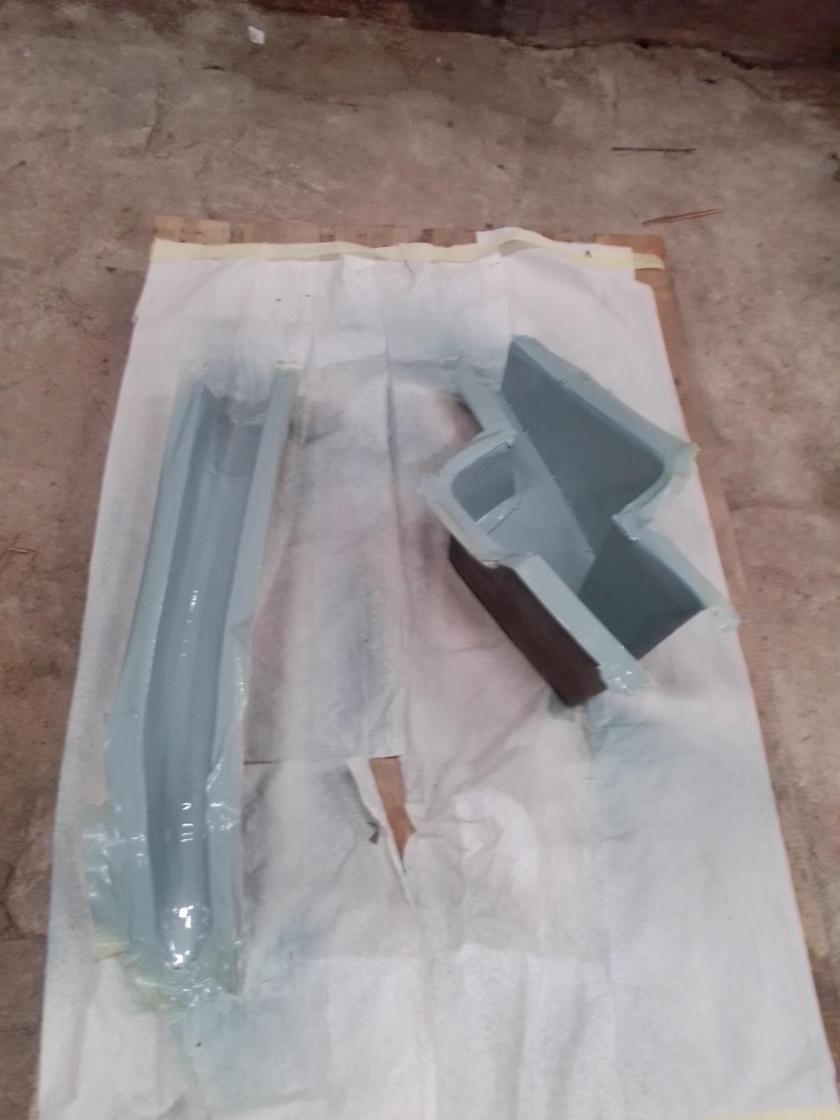

and then I removed the old storage primer, put some primer on it and then some paint in the OG color except where welding comes (I put there some welding primer!):
and then some on the body counterpart:

So, a bit to report on that front

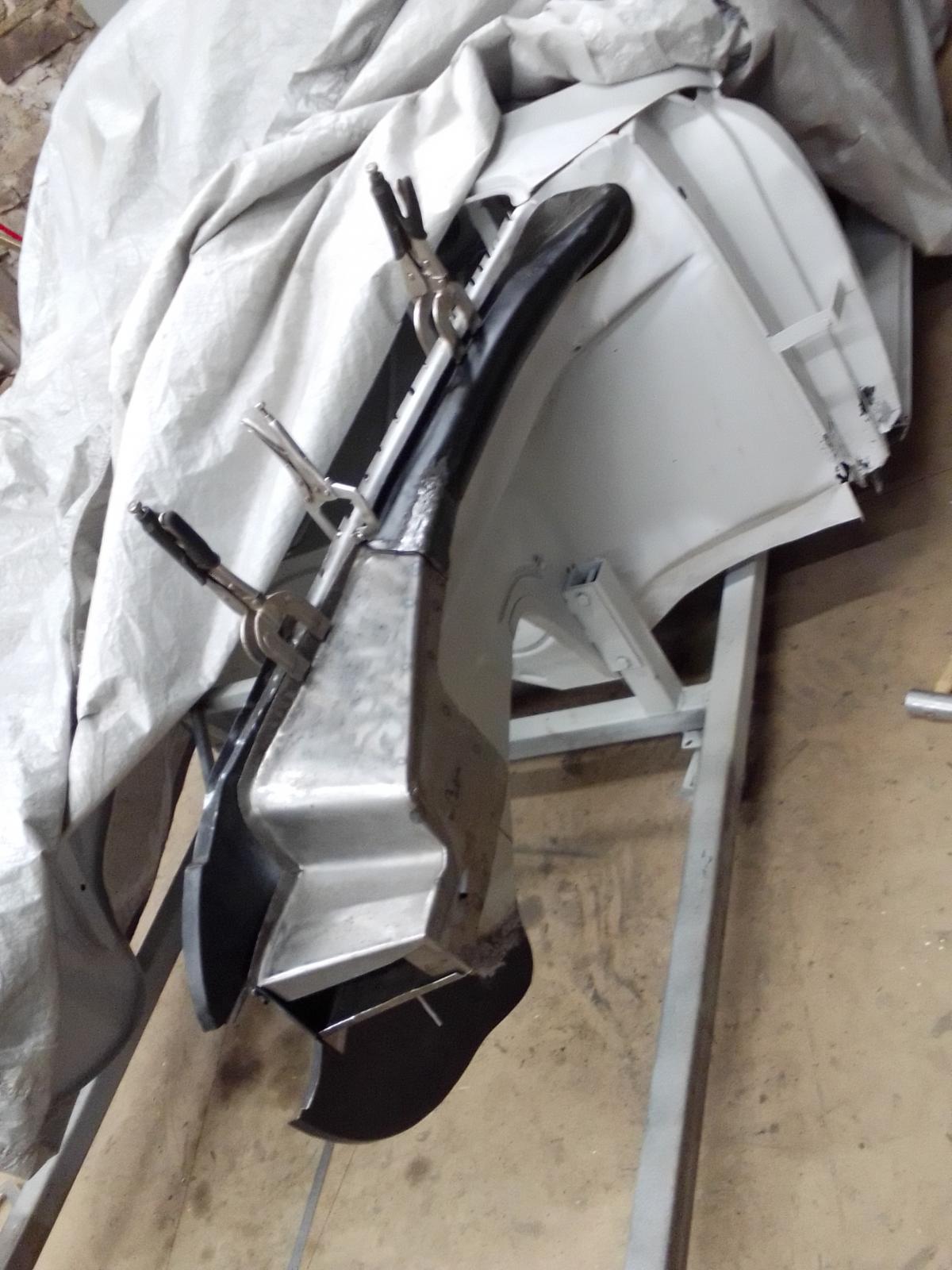

After the paint, time for some welding primer on the body:
Then the firsts tack weld:
And check with every surrounding parts:
And Then fully welded:
Voilą

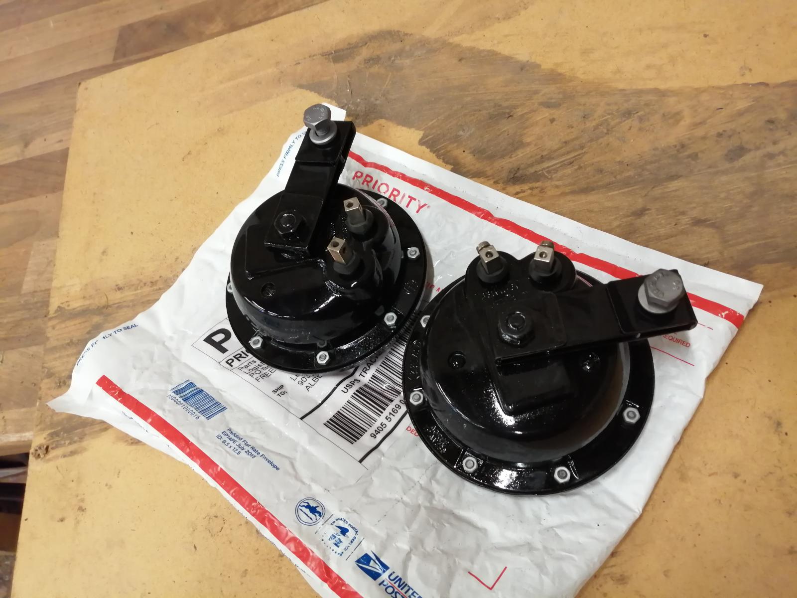

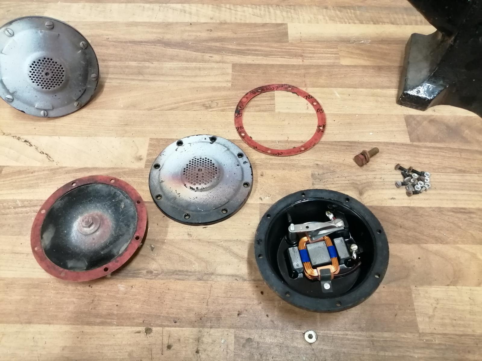

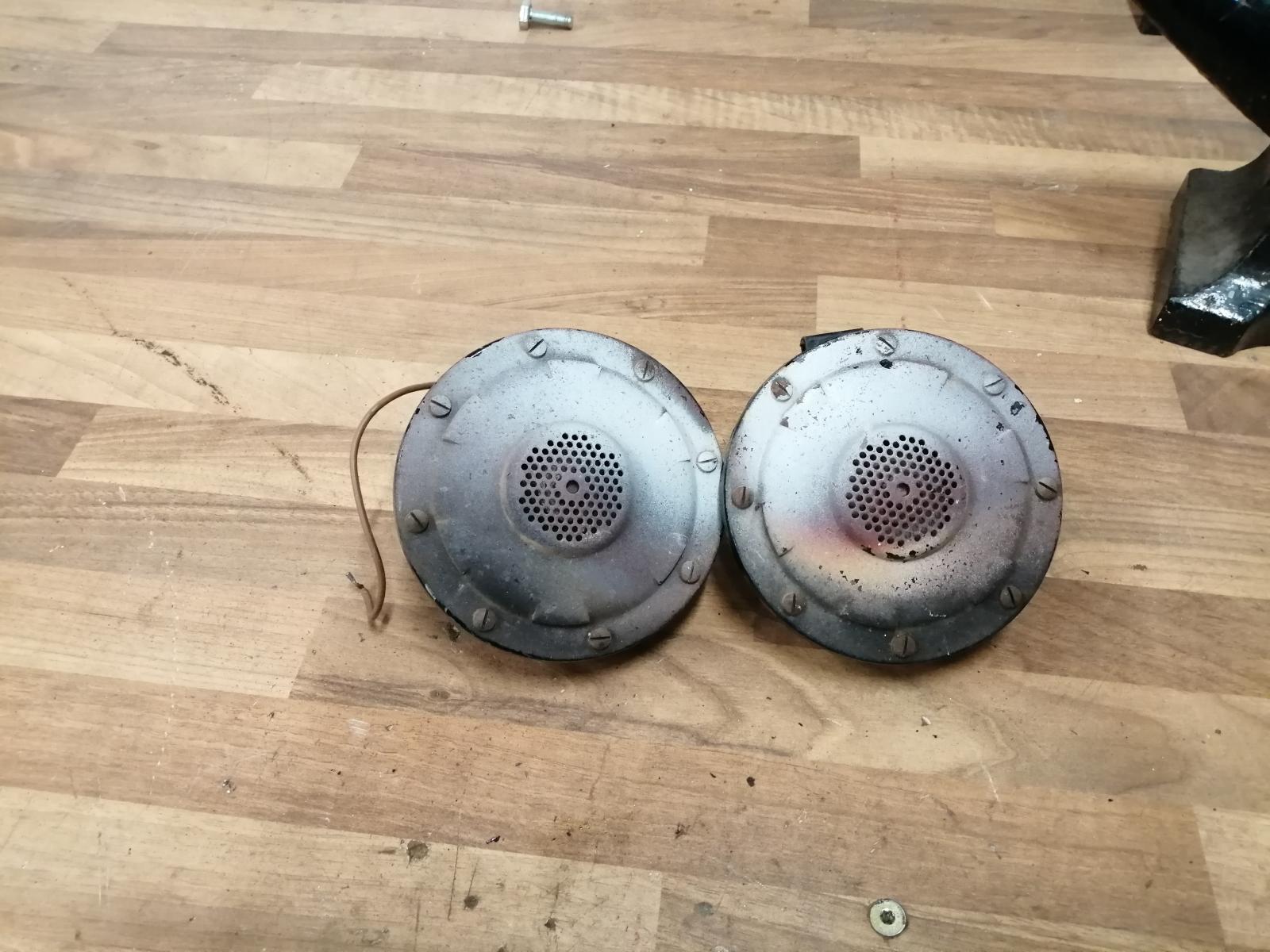

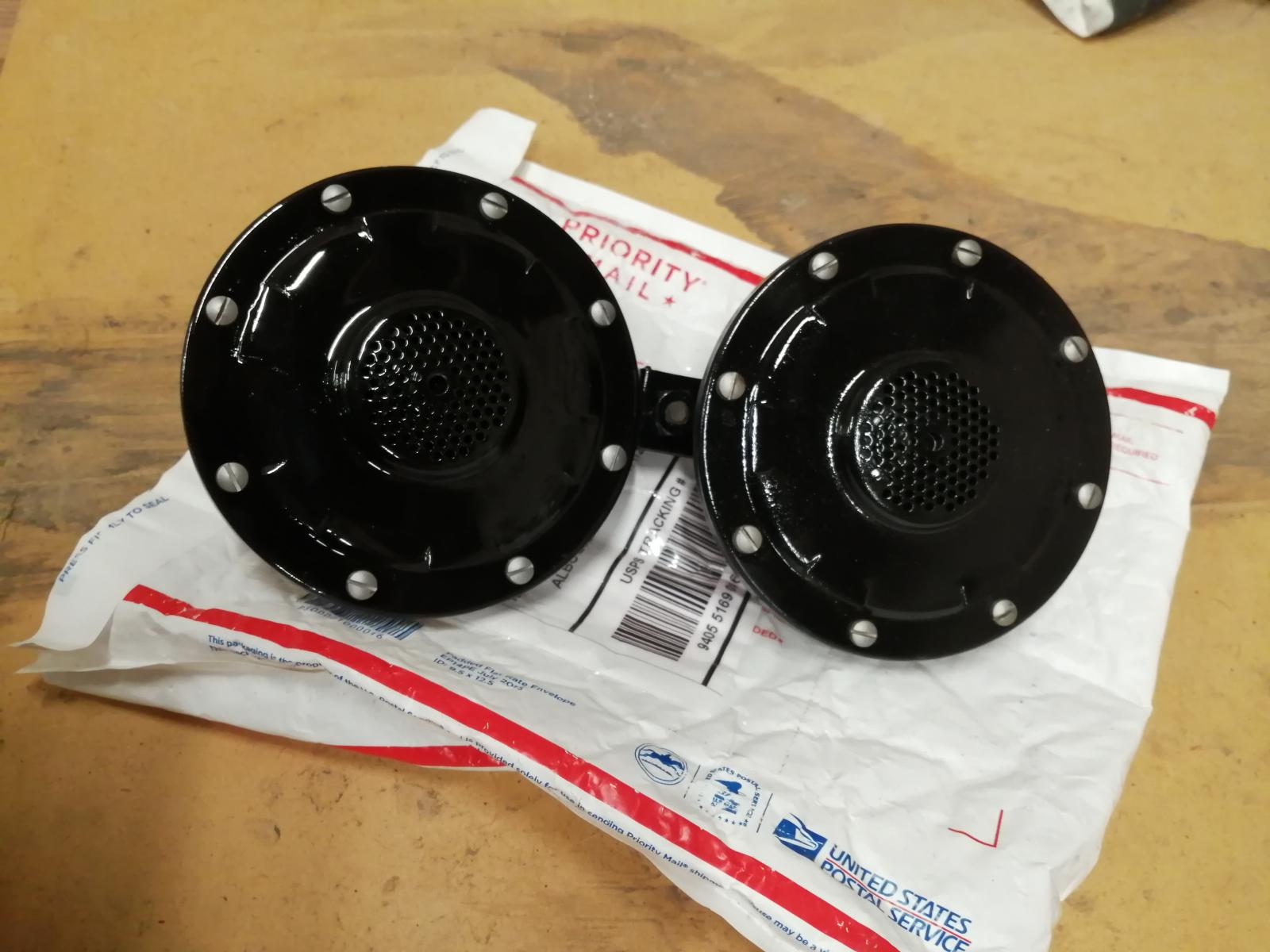

I made some progress on my 60 only (screw connections!) horns:
As received:
Disassembly:

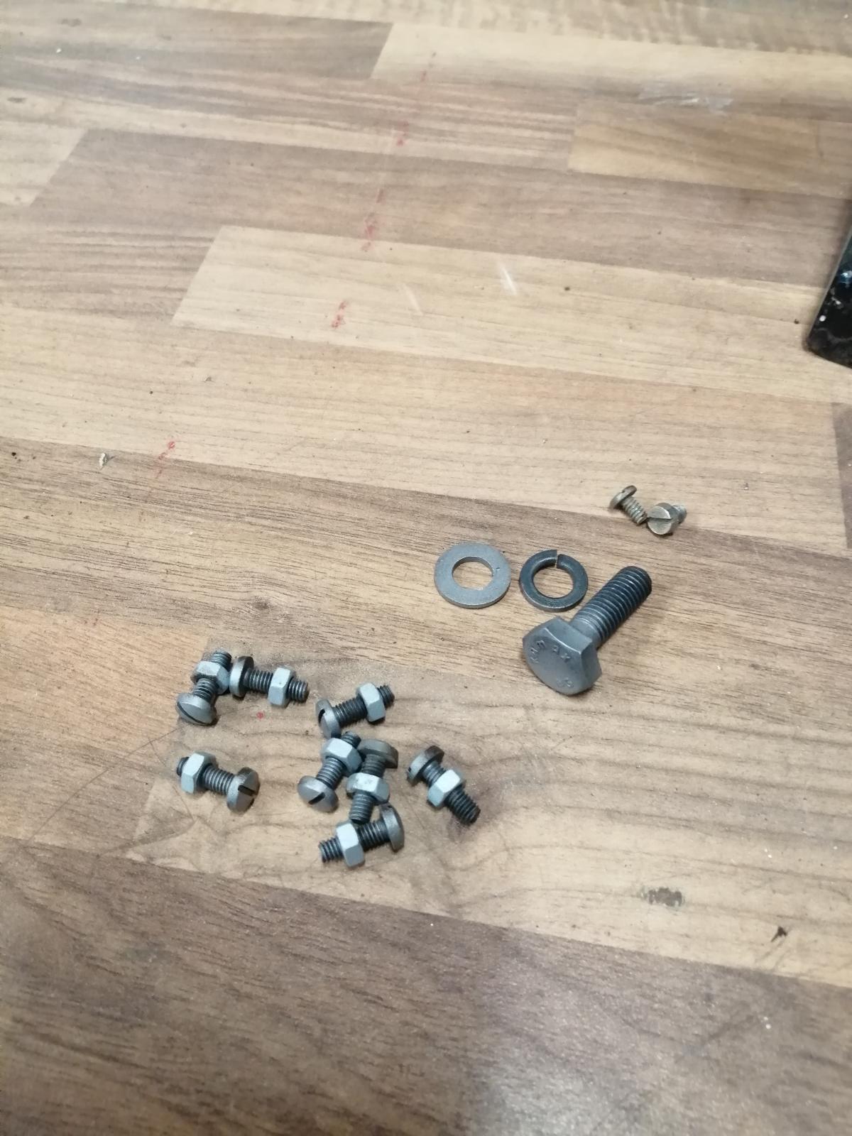

Sandblasting, inclusive the screws:
Fresh paint and reassembly:
So, second one is done:

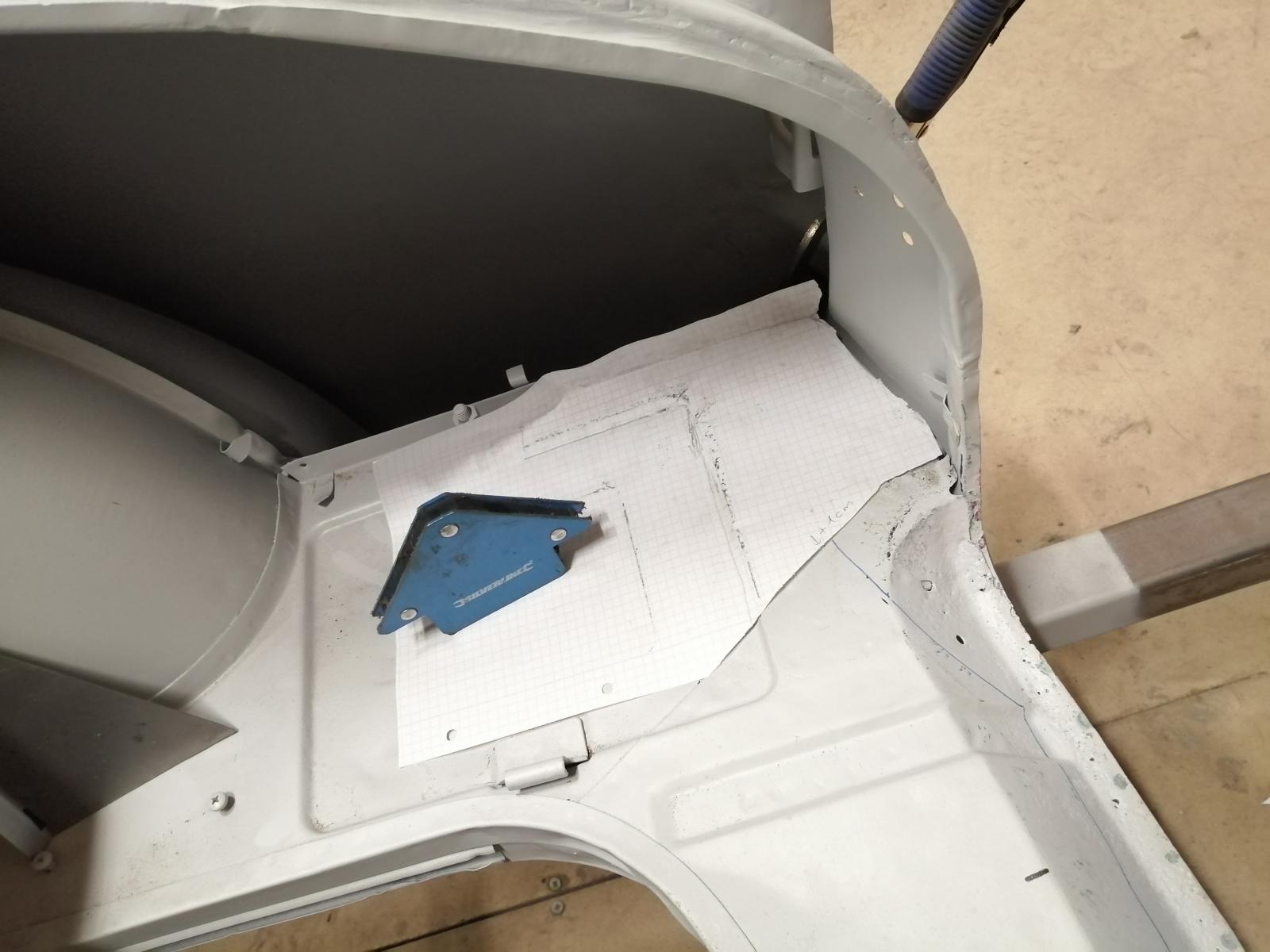

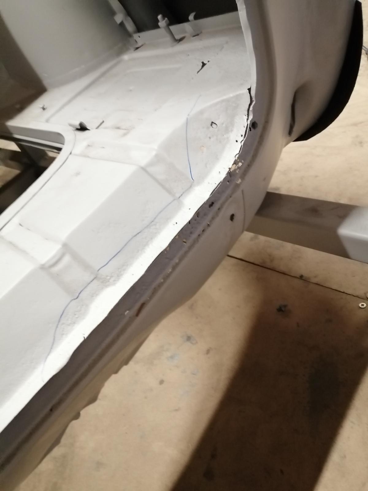

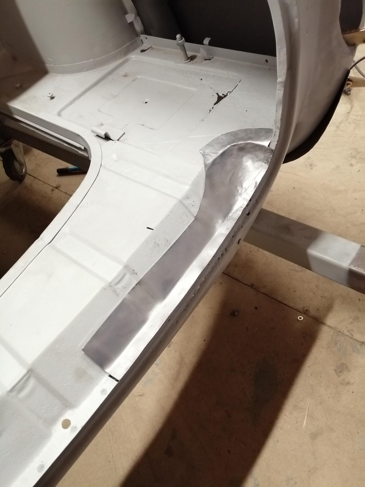

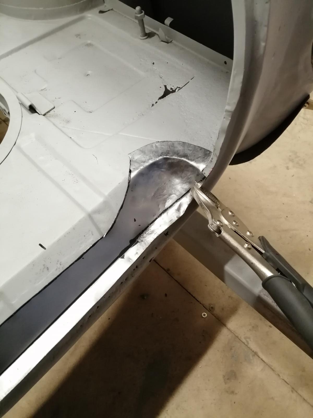

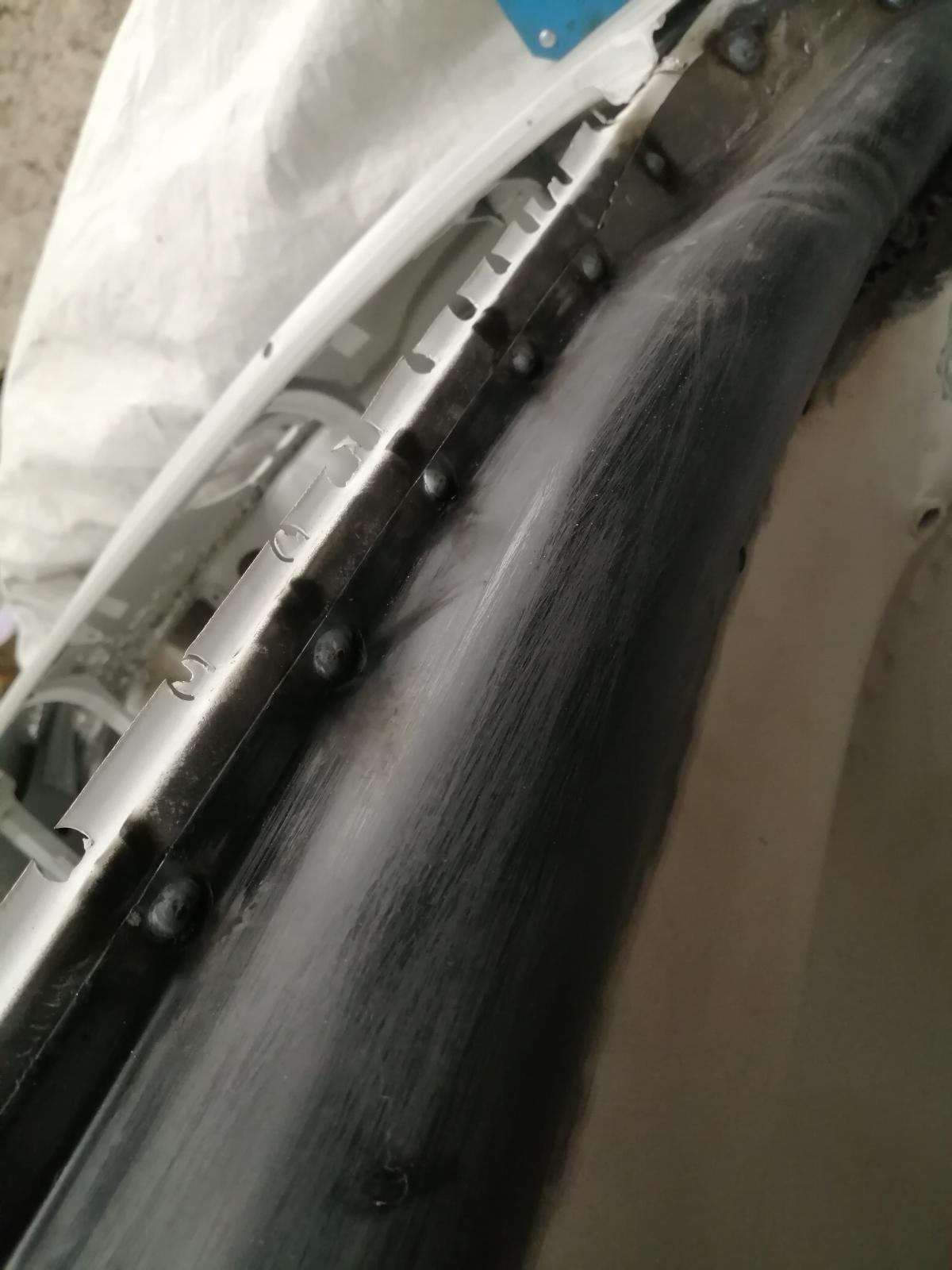

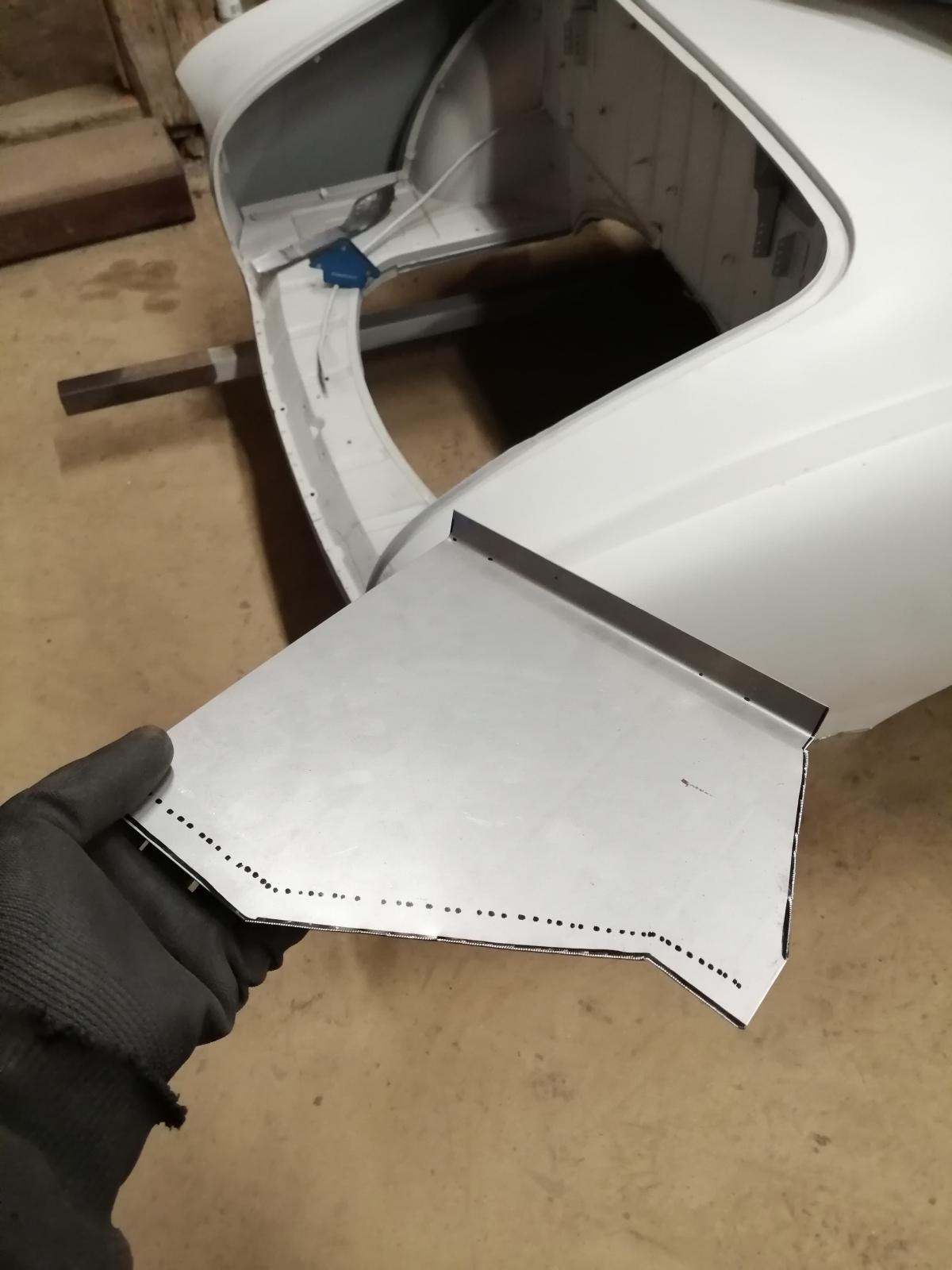

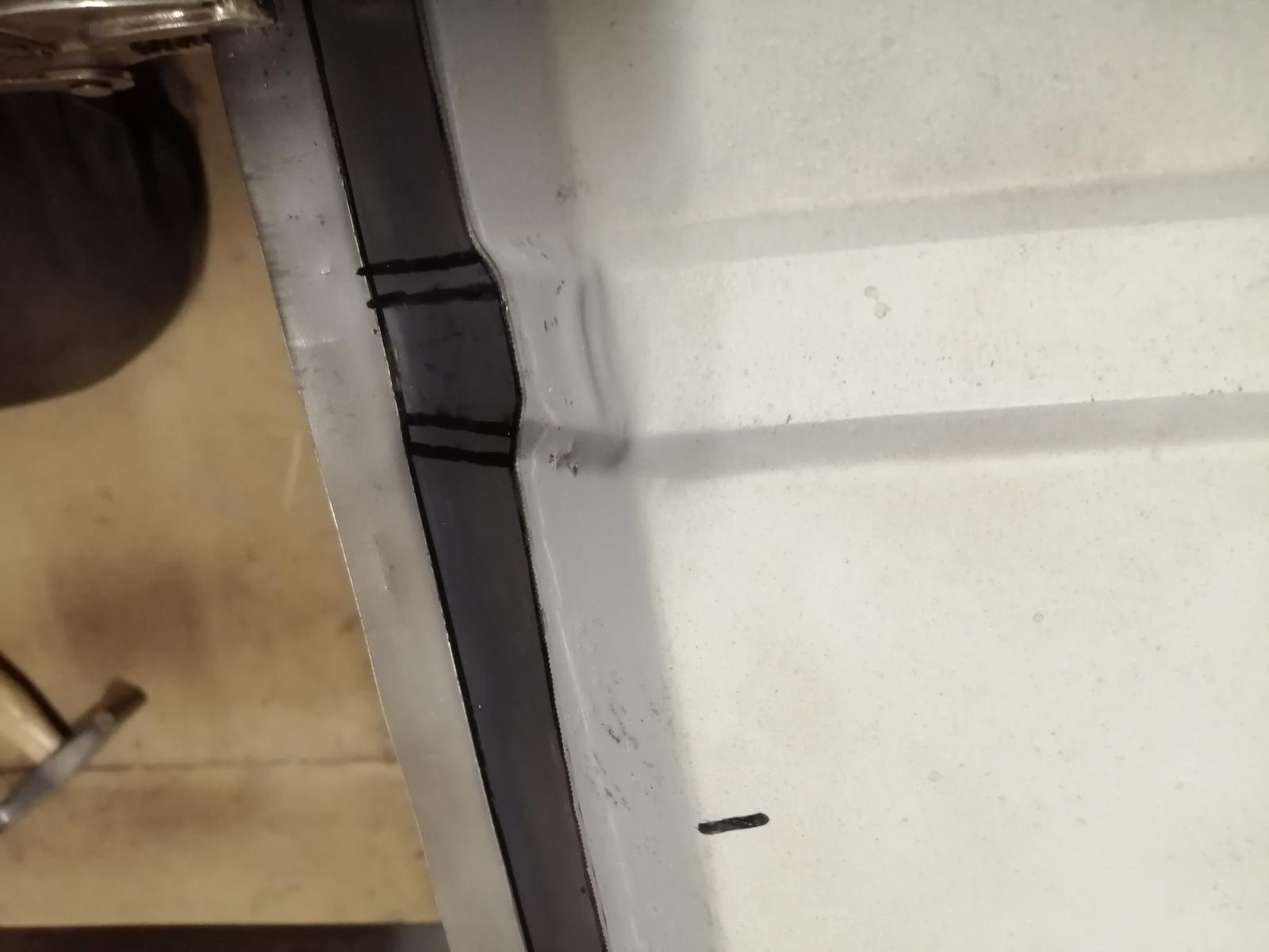

And then started to create some metal patches:
Here we see the rust:
So preparing some steel:
It first gets worse..
And then better:

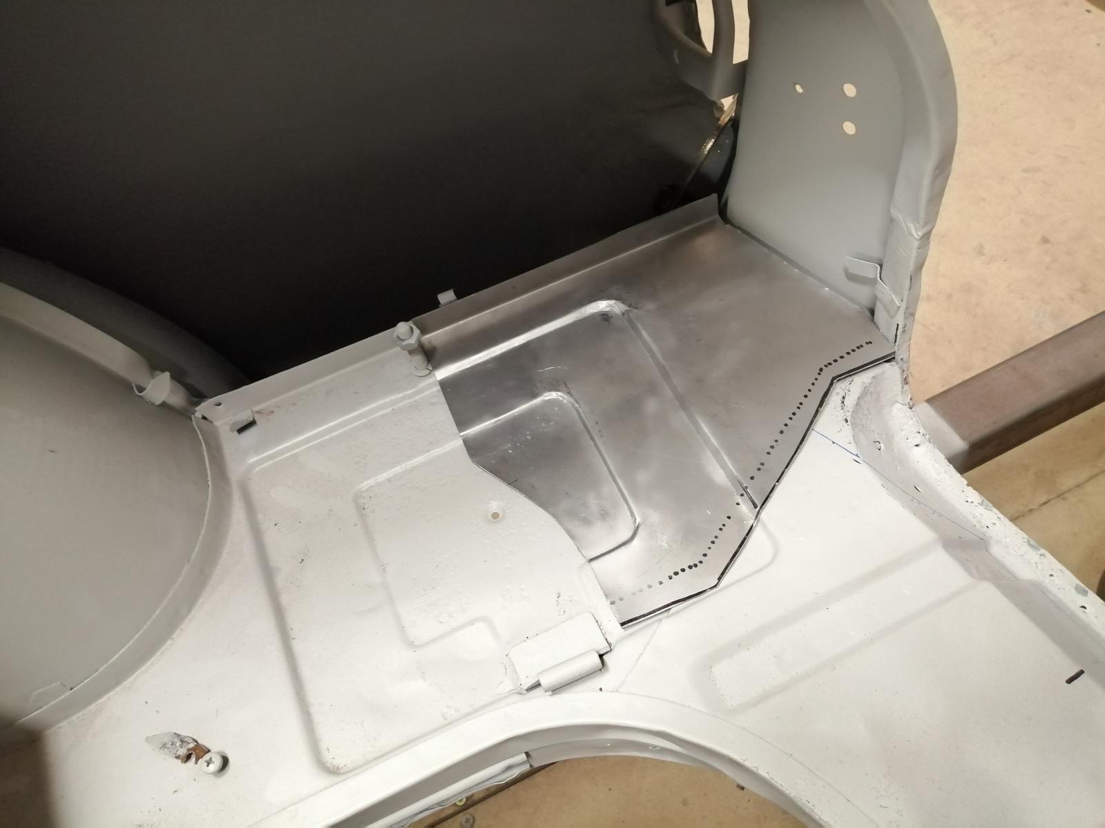

Then it was time to put the beads.. All the material pictured here:
And here we go:
Now some fine tuning left and it will be ready to weld, but I will weld it when all the surrounding is ready:
Stay in touch, news coming soon !

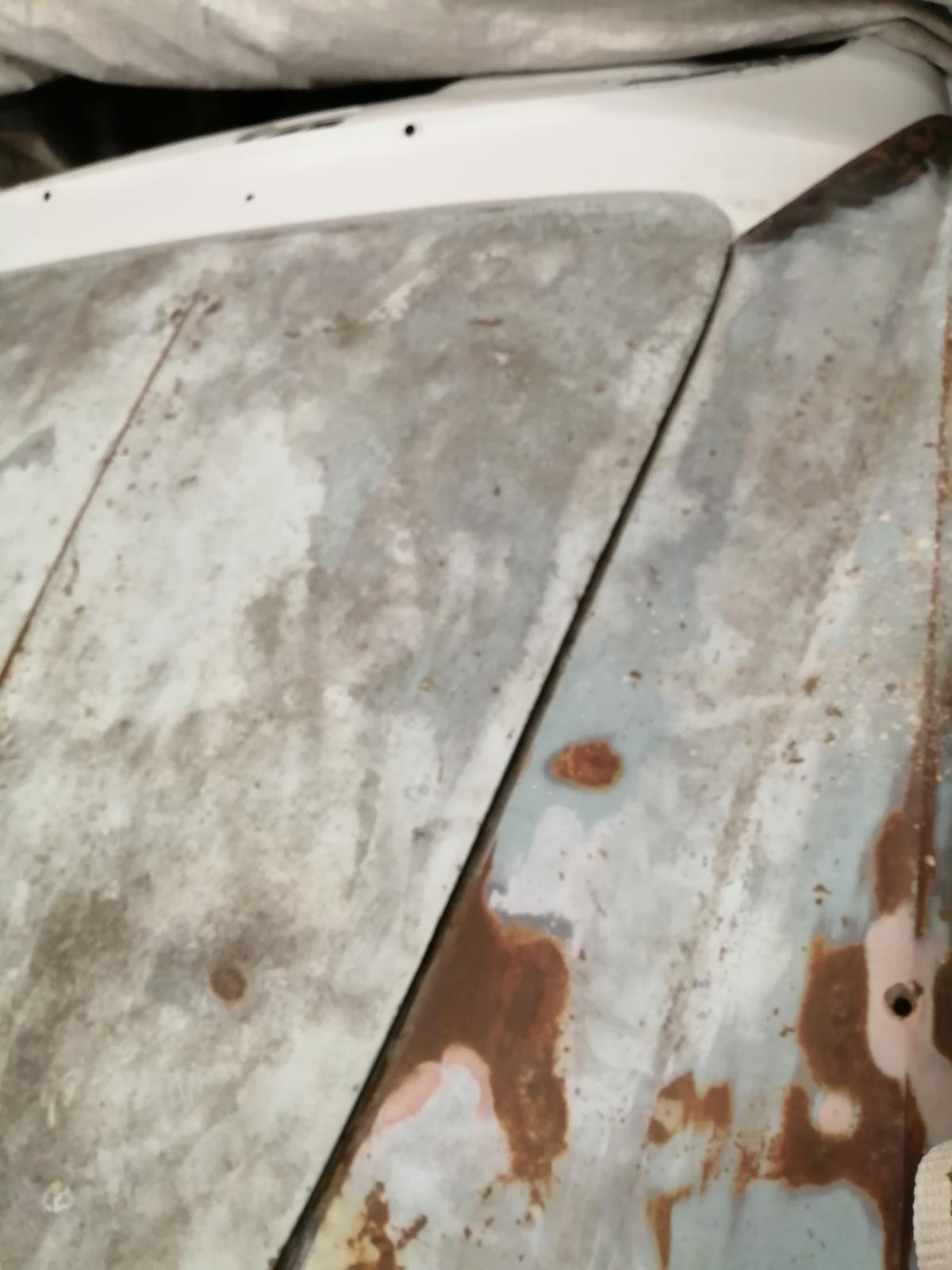

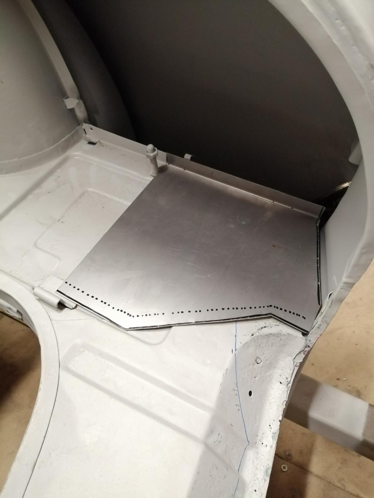

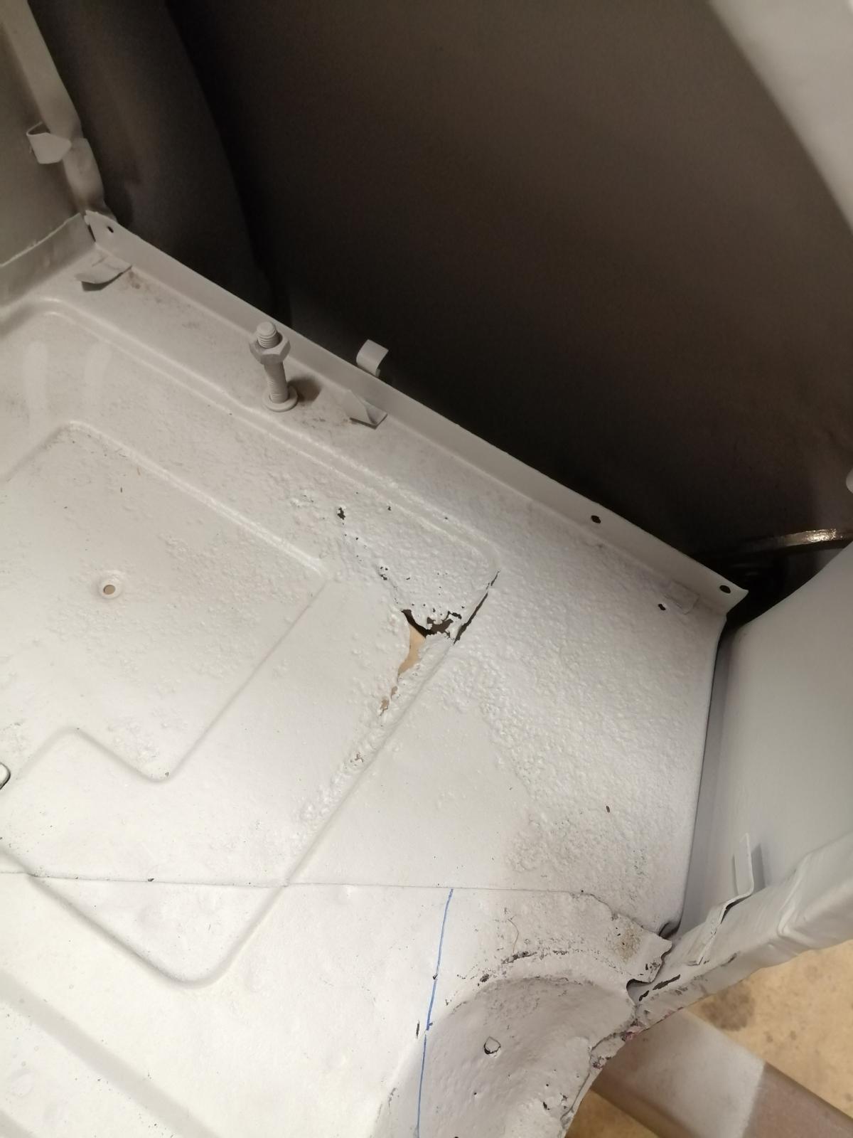

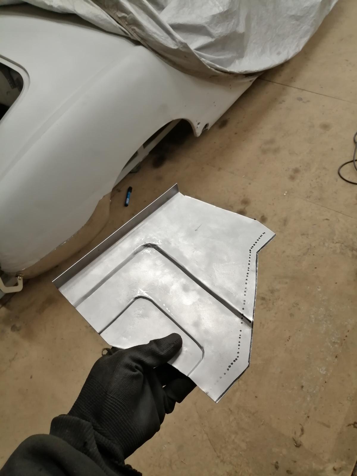

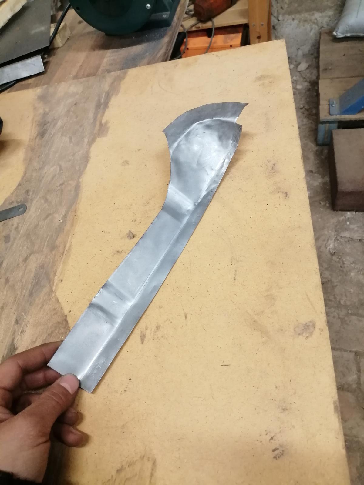

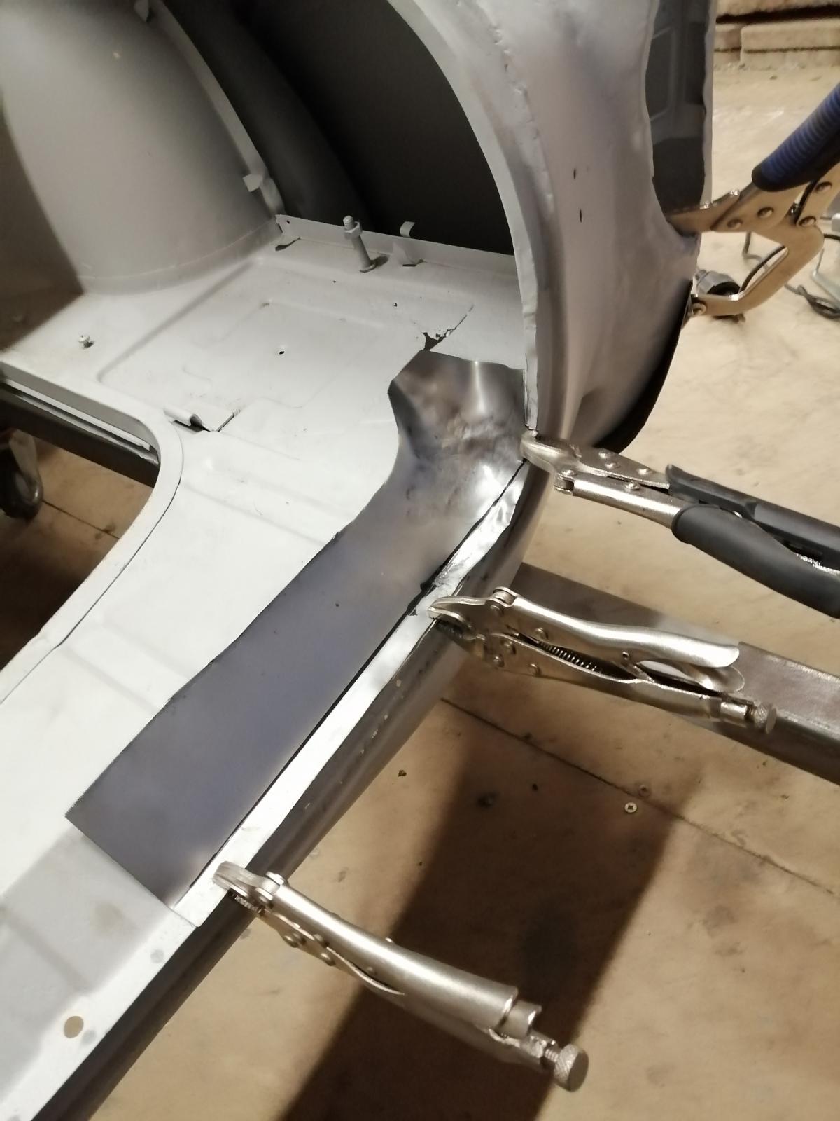

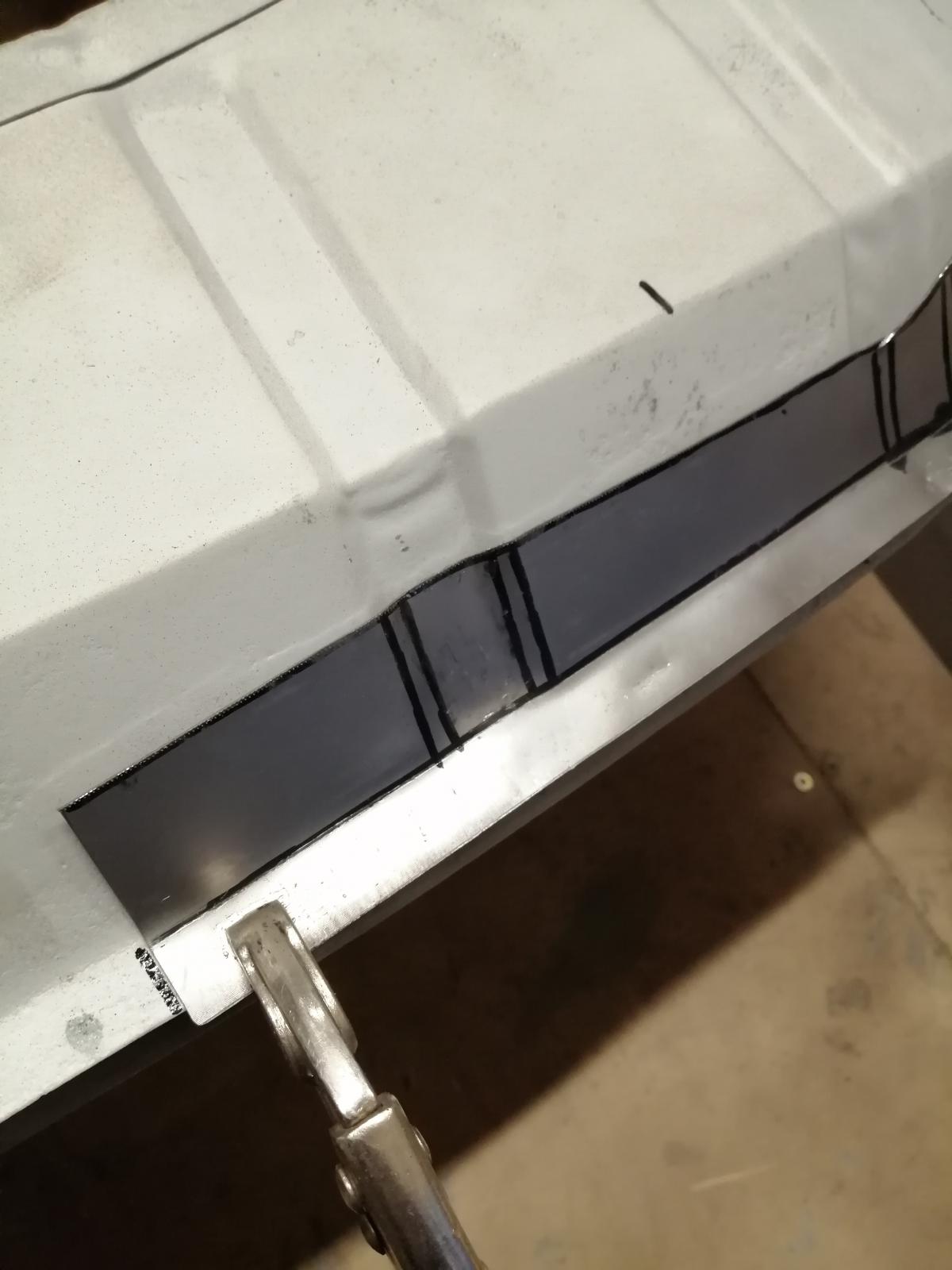

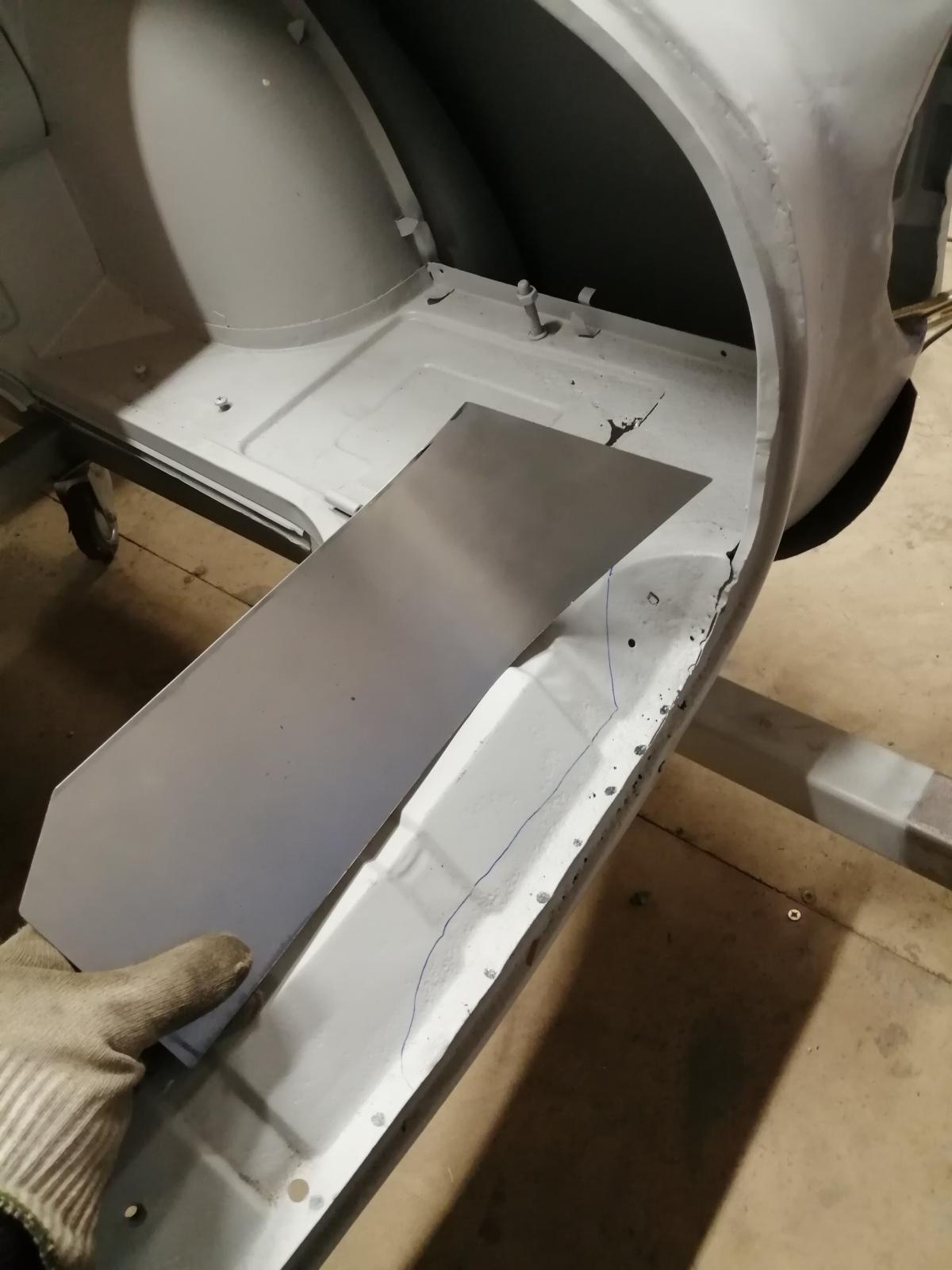

Next patch in preparation before a big welding session ops:
Here the rust:

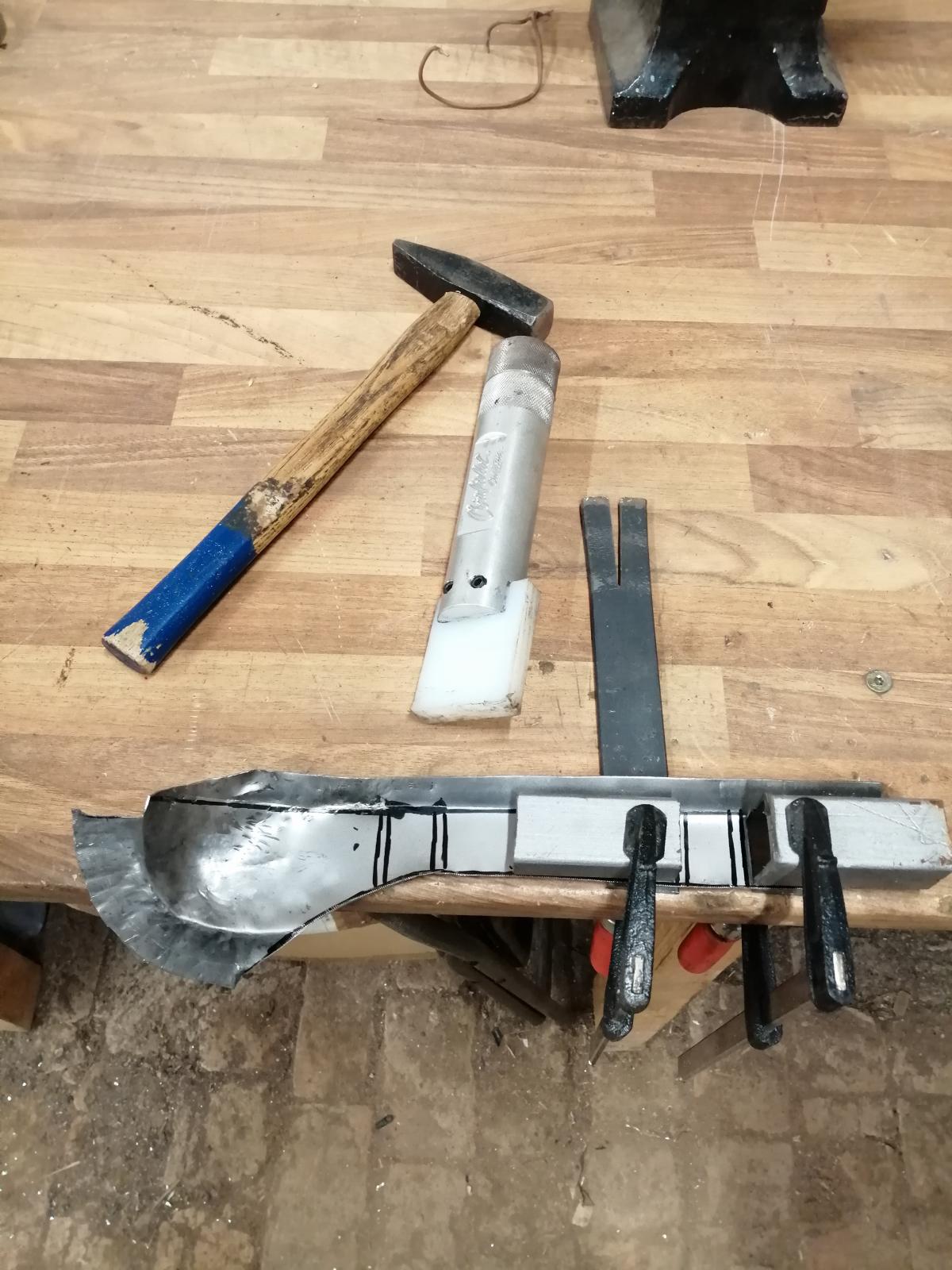

Template in preparation :
Cutting some metal:
First bend:
And starting with the bead:
And here we are:
Stay tuned for the next update,
