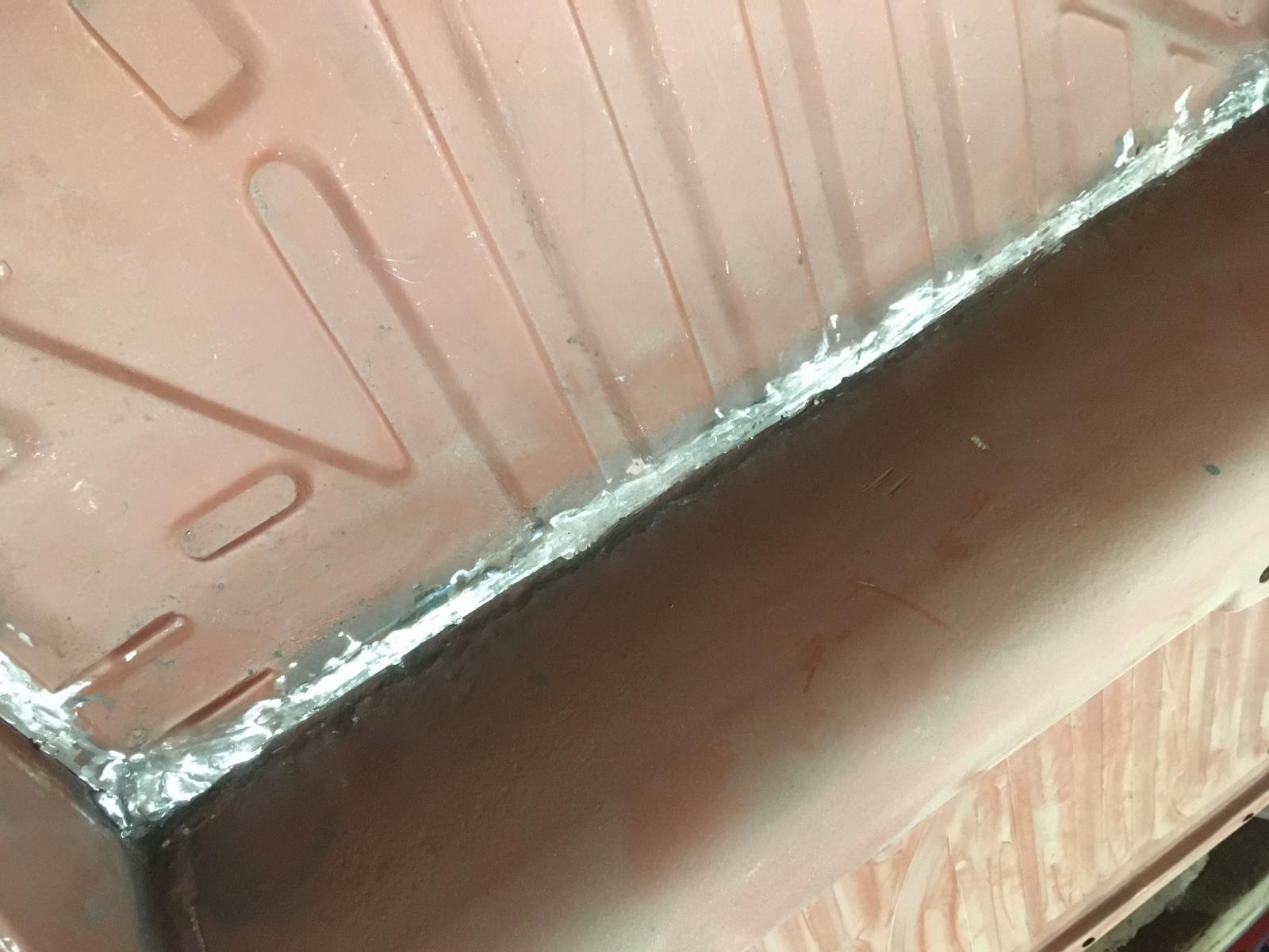

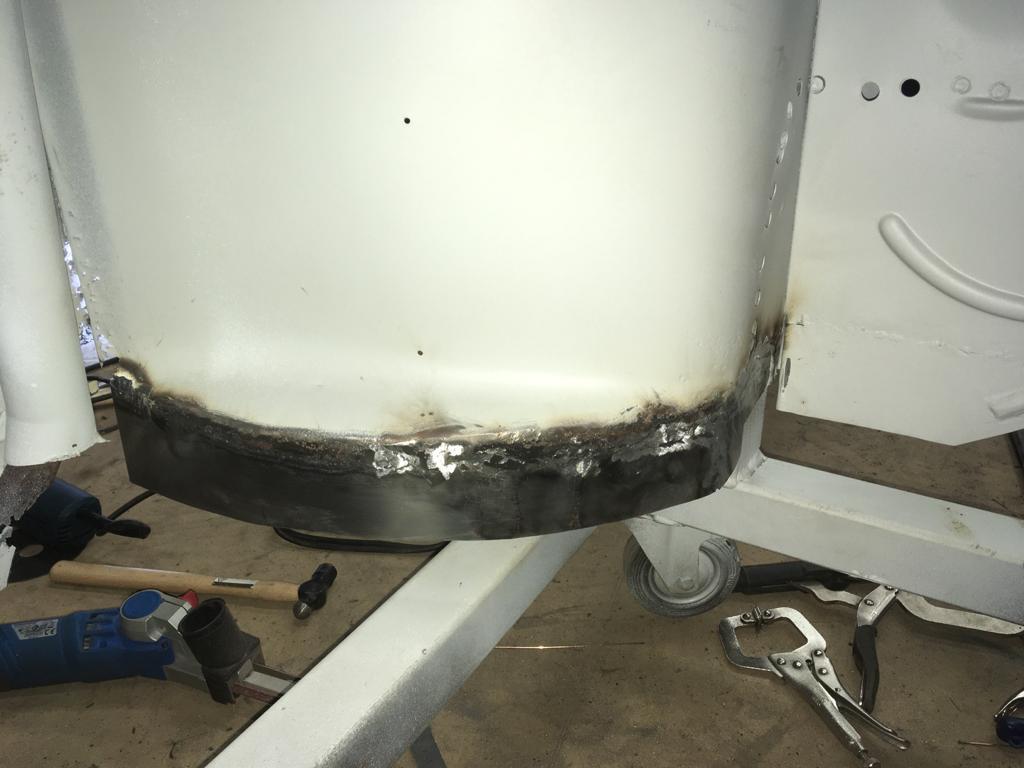

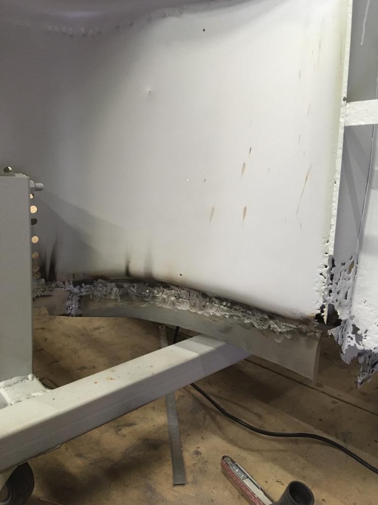

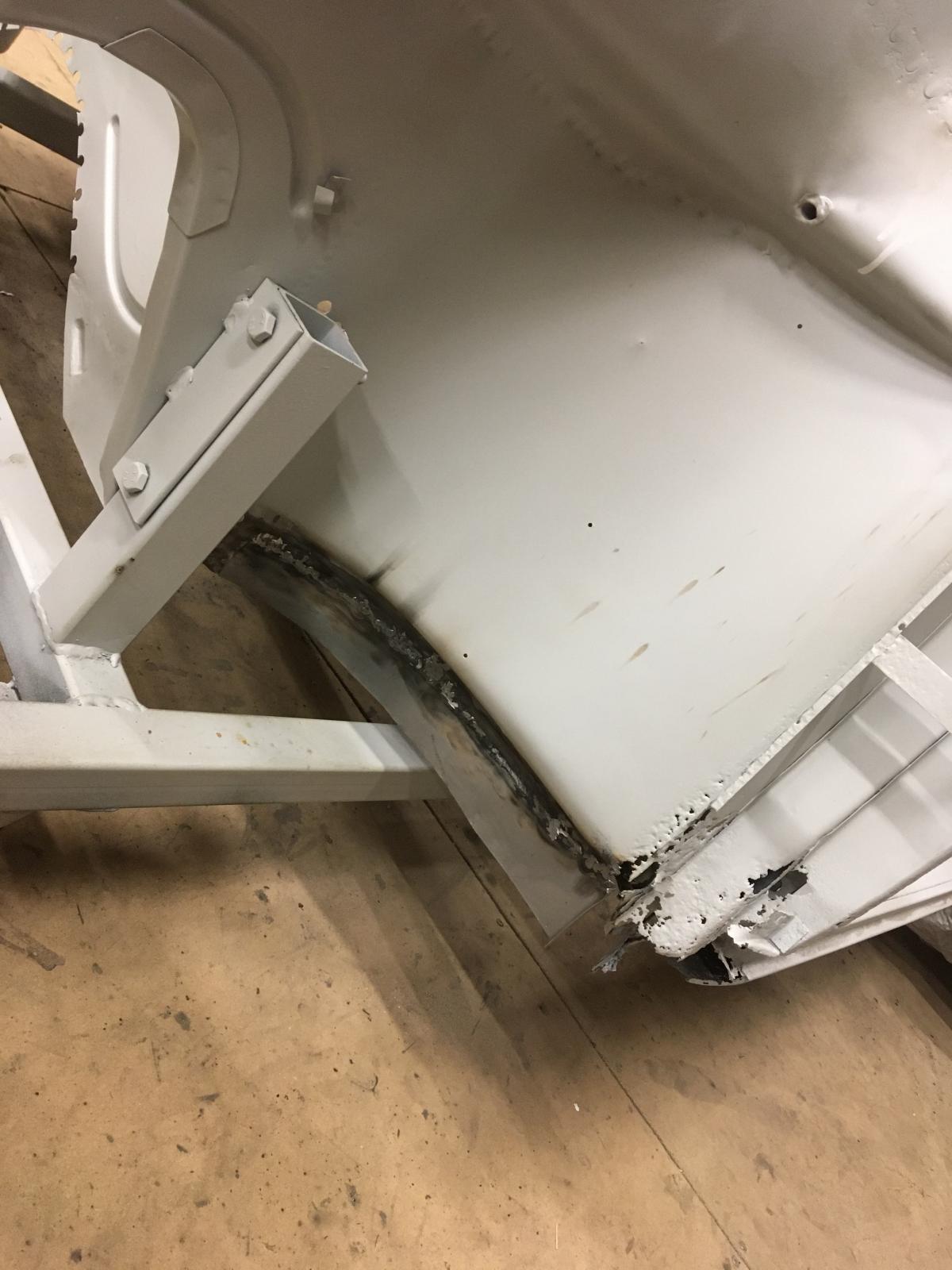

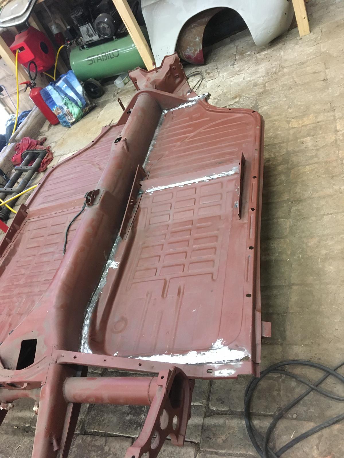

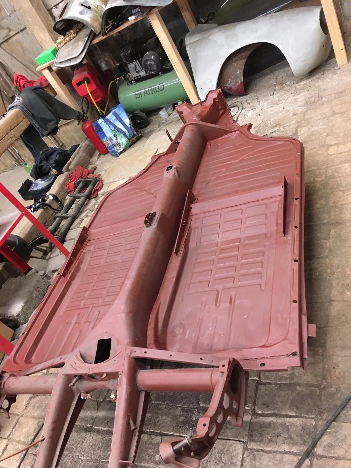

So, sometimes you have to take a few steps back to get it as wished.. I had welded my pan halves almost 1,5 years ago and even if robust, the welding aspect wasn’t that good.. i had left it, but I decided that I can’t let a part of the build not making me proud so.. I redid it
Primer removed, welding cleaned, rewelded where necessary, ground down and back in primer
And as it’s good for regular checking, I mounted the front panel back with some grips and this time didn’t forget to take some pictures:
And my favorite, my motivation-boosting picture:

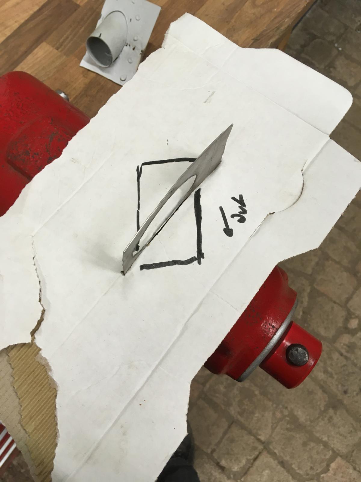

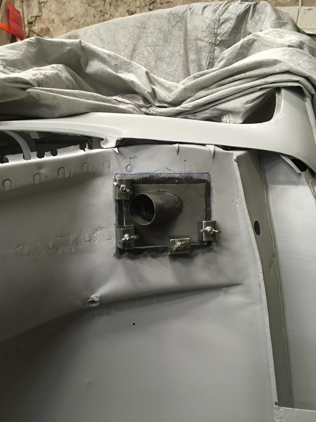

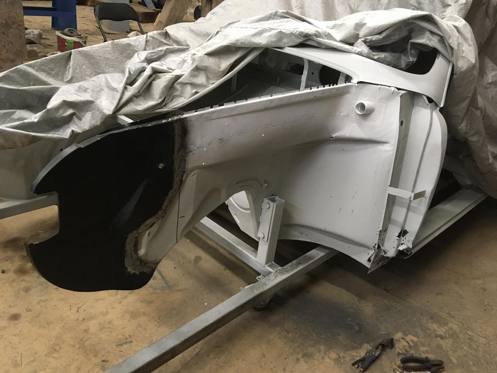

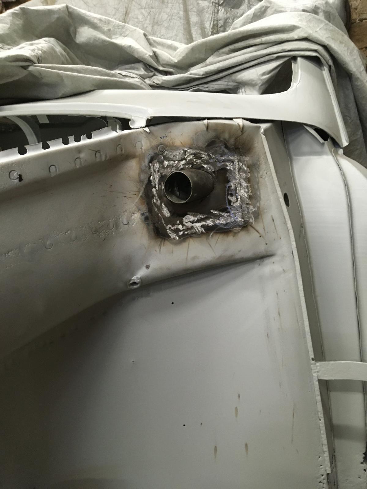

Due to family holidays, I had only a couple hours for the ghia but step by step it‘s getting solid

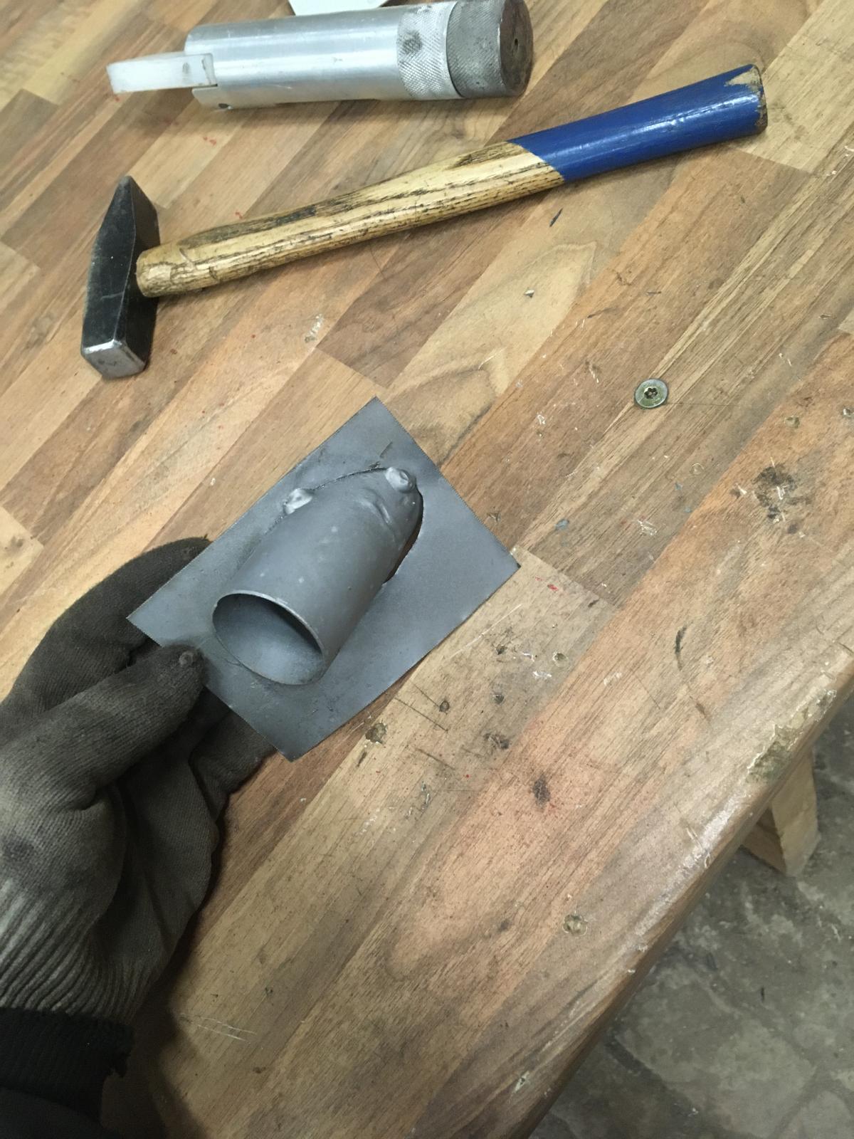

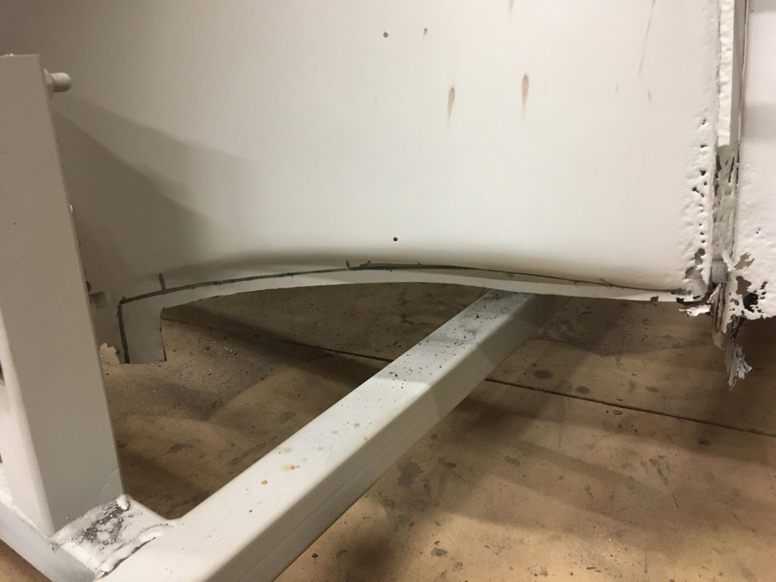

I took care of those holes:
Cutting after lots of measurement:

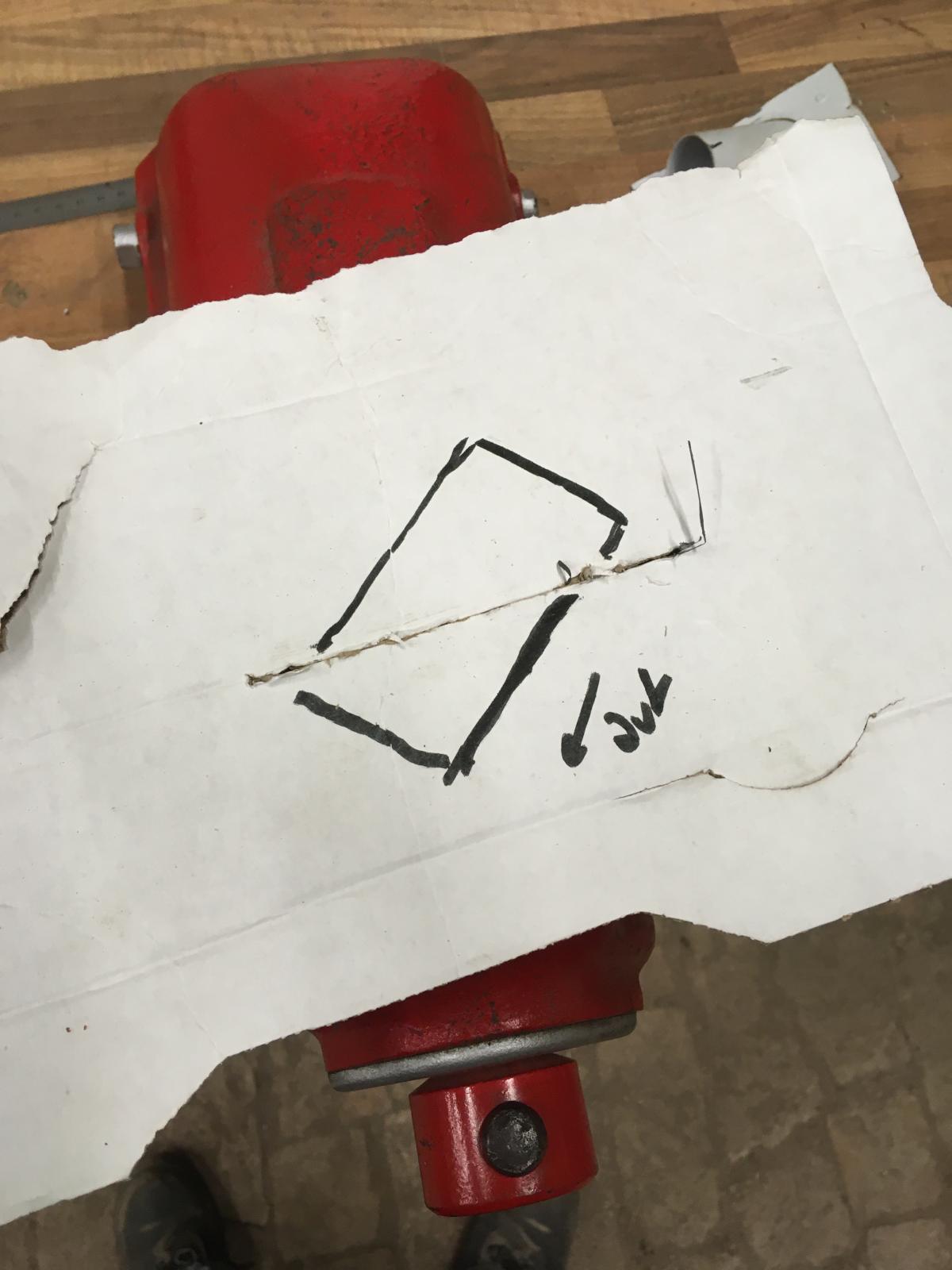

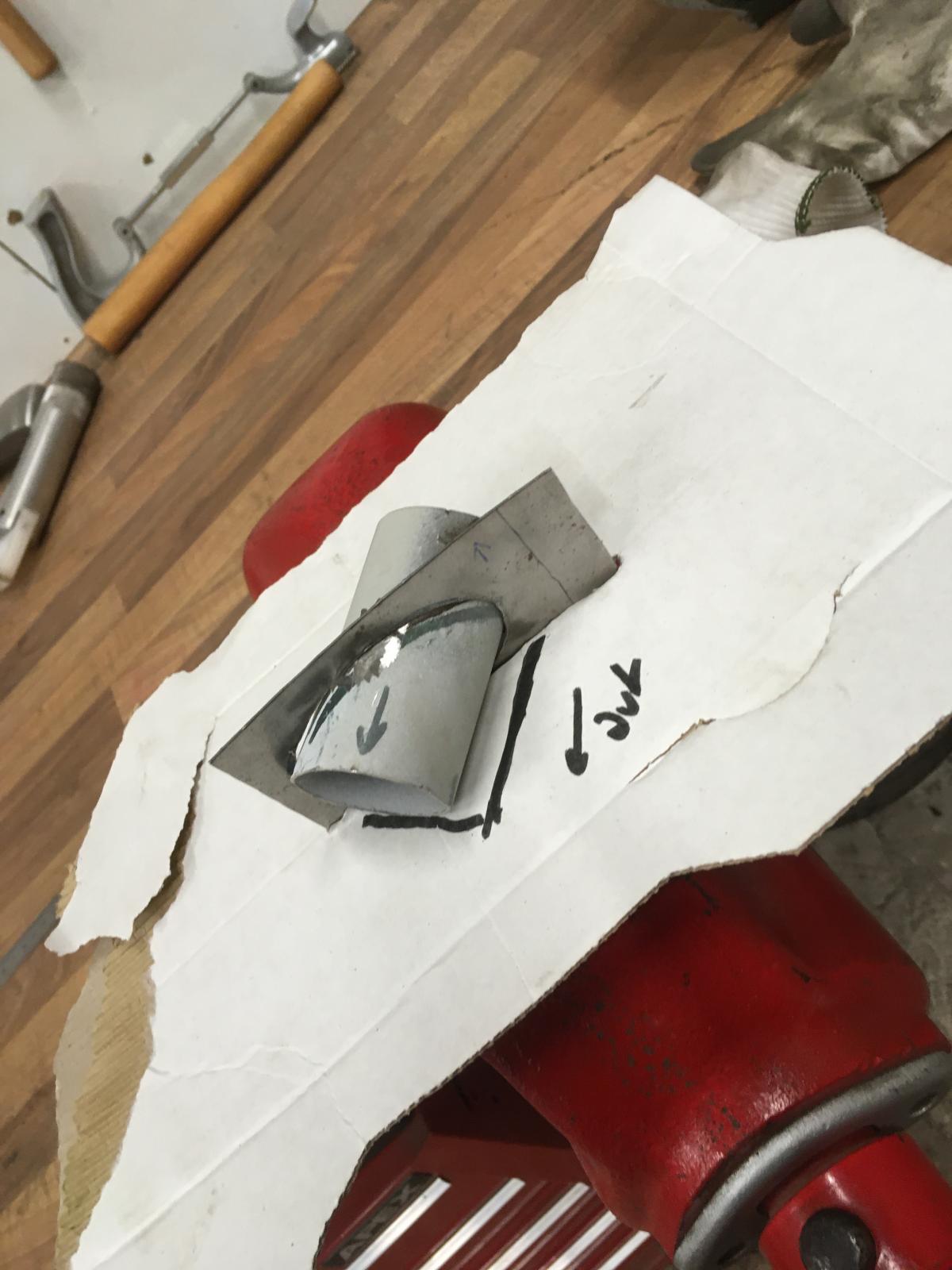

And a „Pizza-Box“ Template for the tube:
Patch panel ready:
Welded from behind like original:
In position:
Welded:
And in primer:
  #136

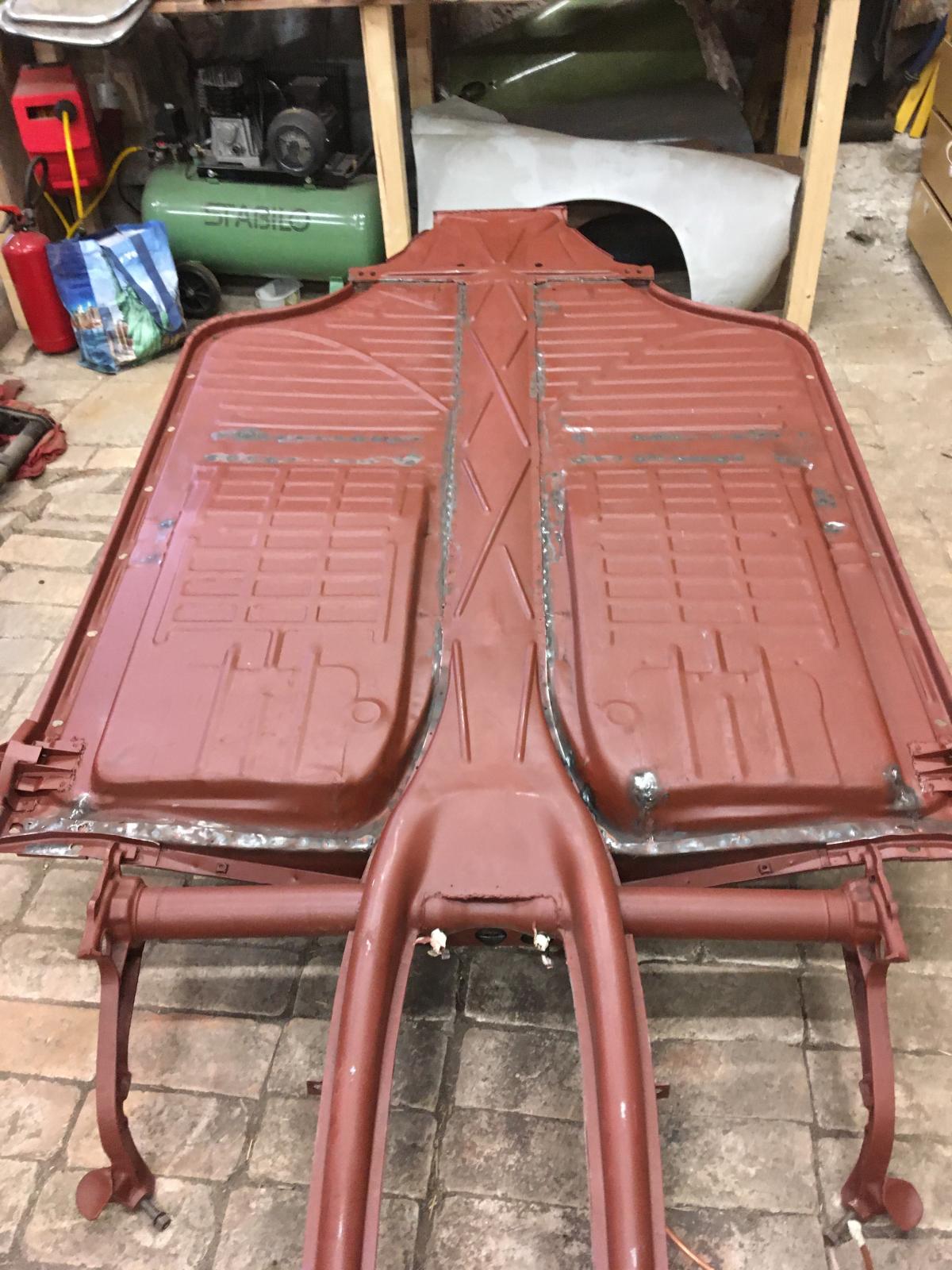

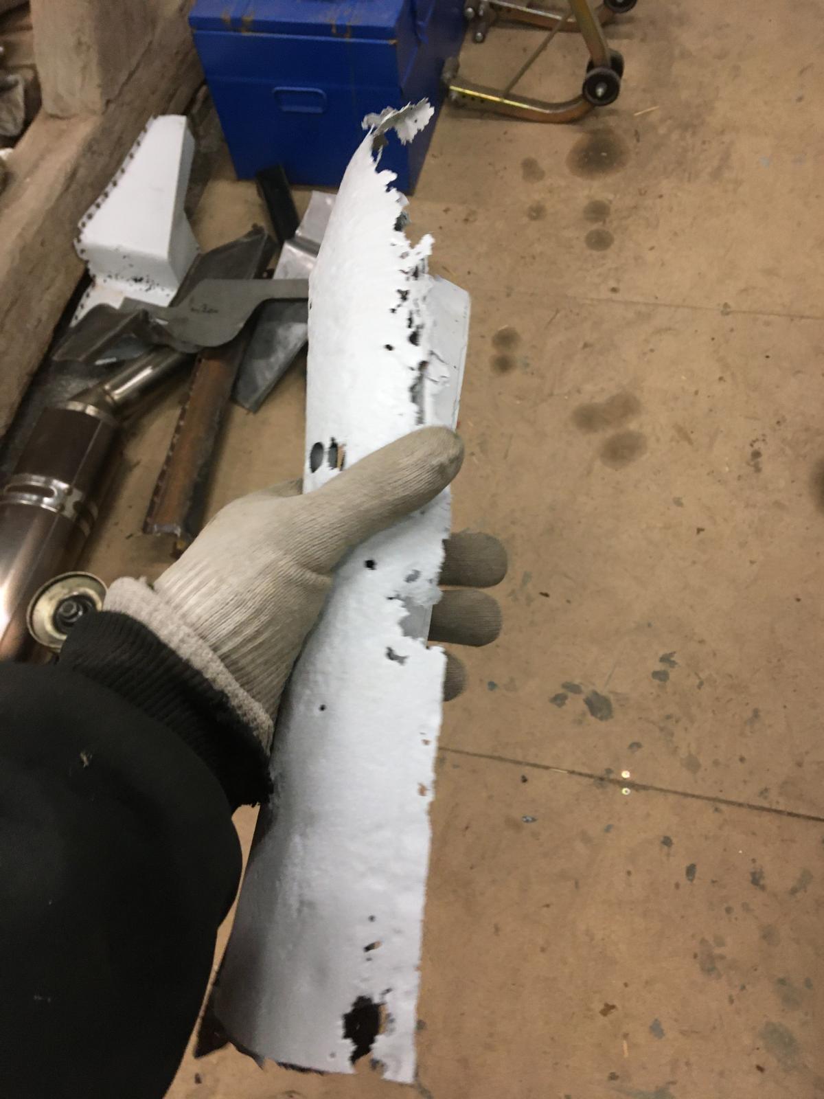

I first finished my second door strut, so that I will be able to start the heater channel when time comes.. Of course, everybody loves pictures so:

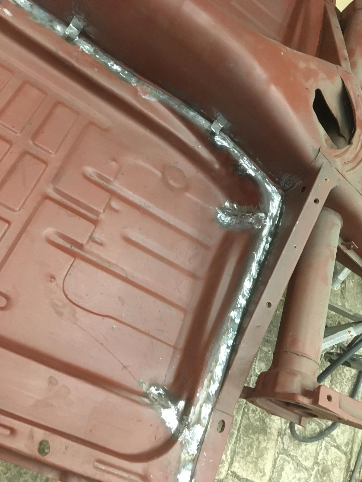

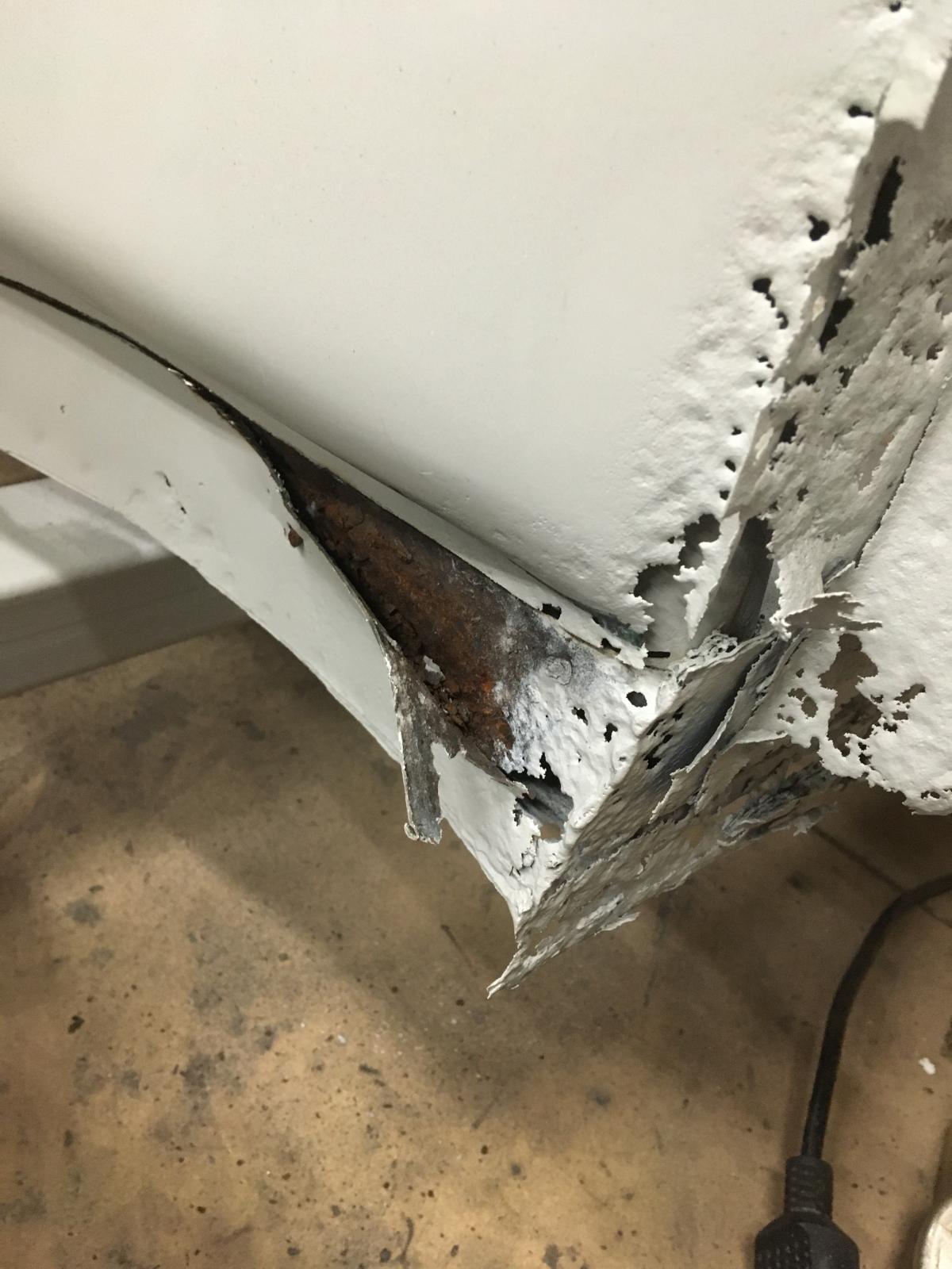

Then I made a bit on the front-left bottom..here is also some work needed:

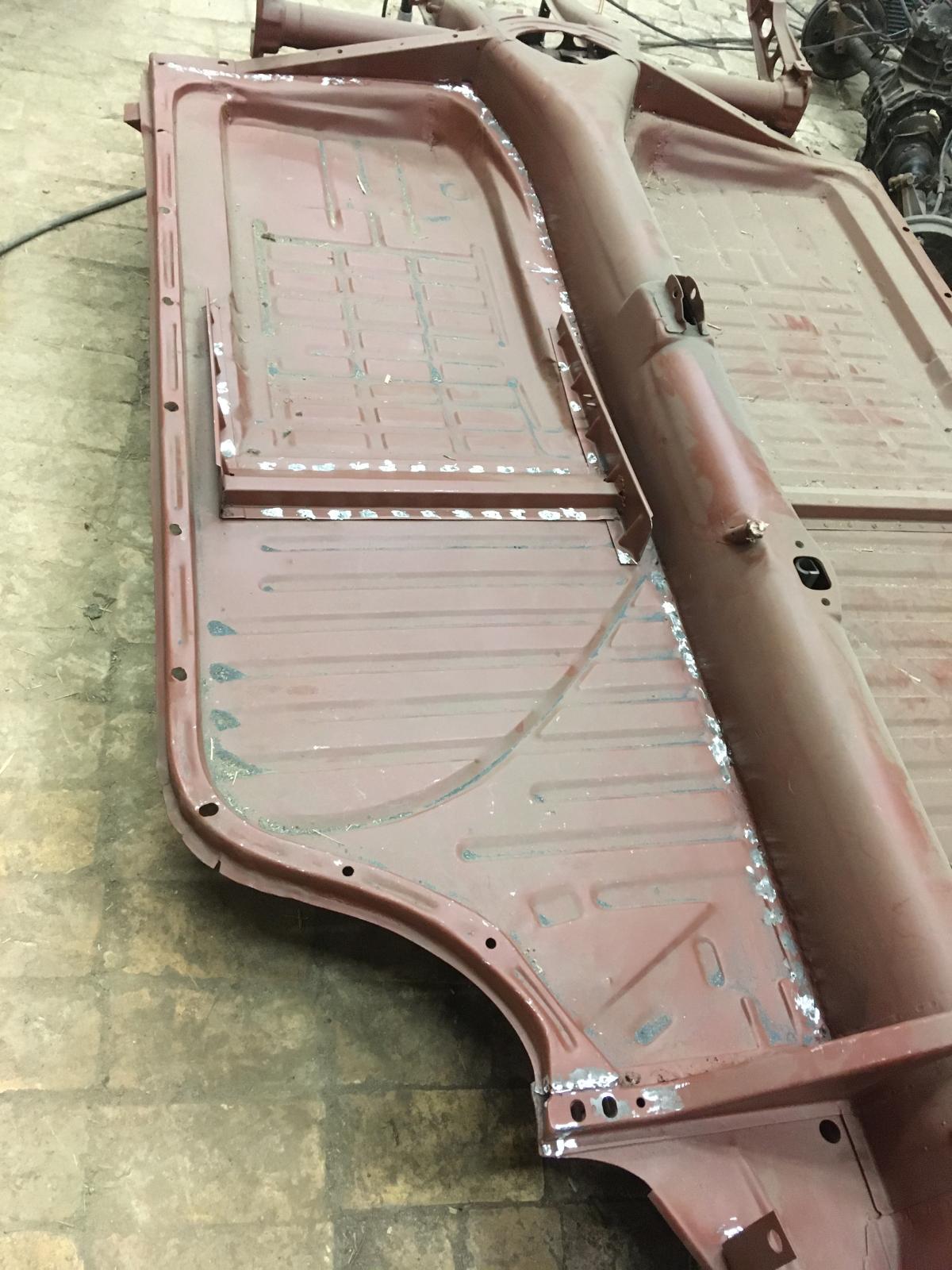

same behind the front metal:
so let's measure the fresh metal needed:

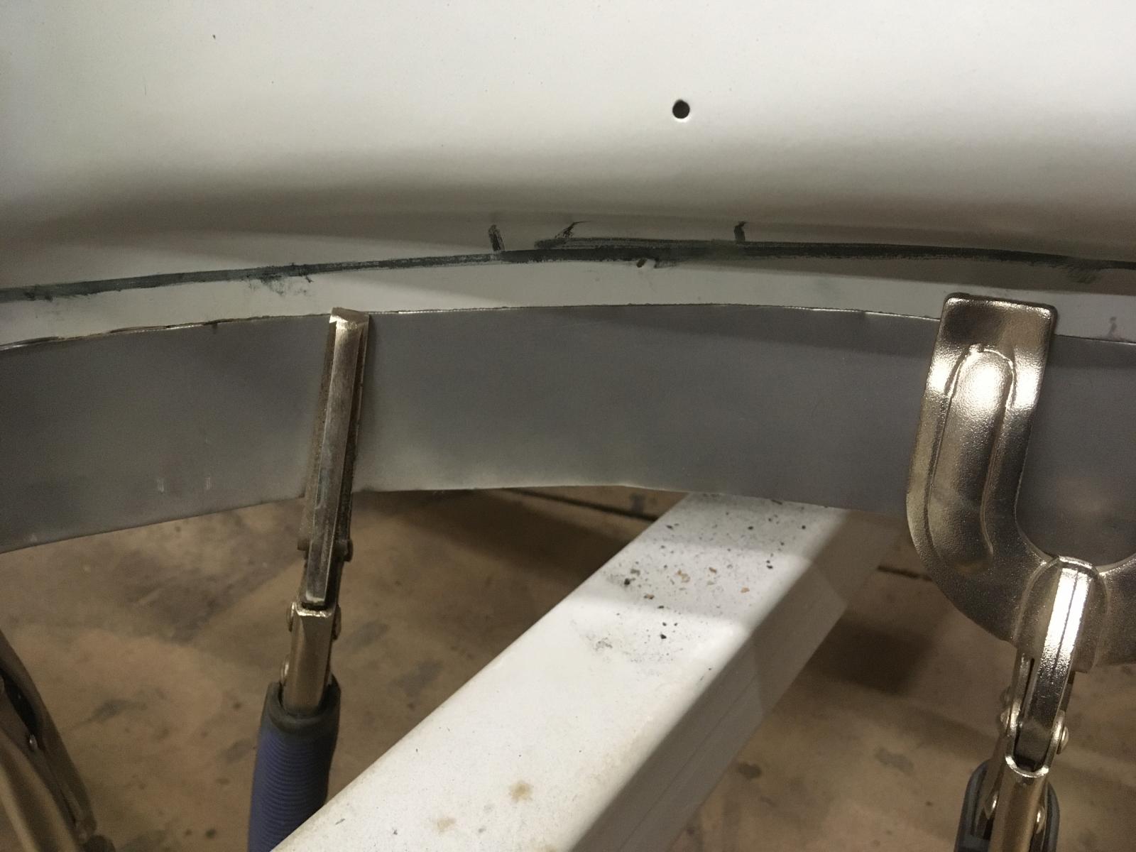

and make some place:
the part of the heater channel behind was quite rusted..
then adjusting:
and point welding in place with the tig:

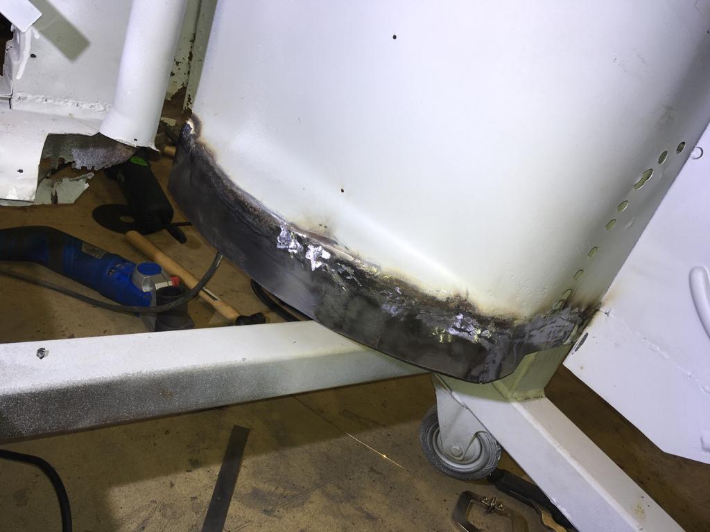

and continuously welding, mostly without extra material, as adjustment was great:
Almost fully welded, next time I will finish the welding, planishing it and then put in primer:

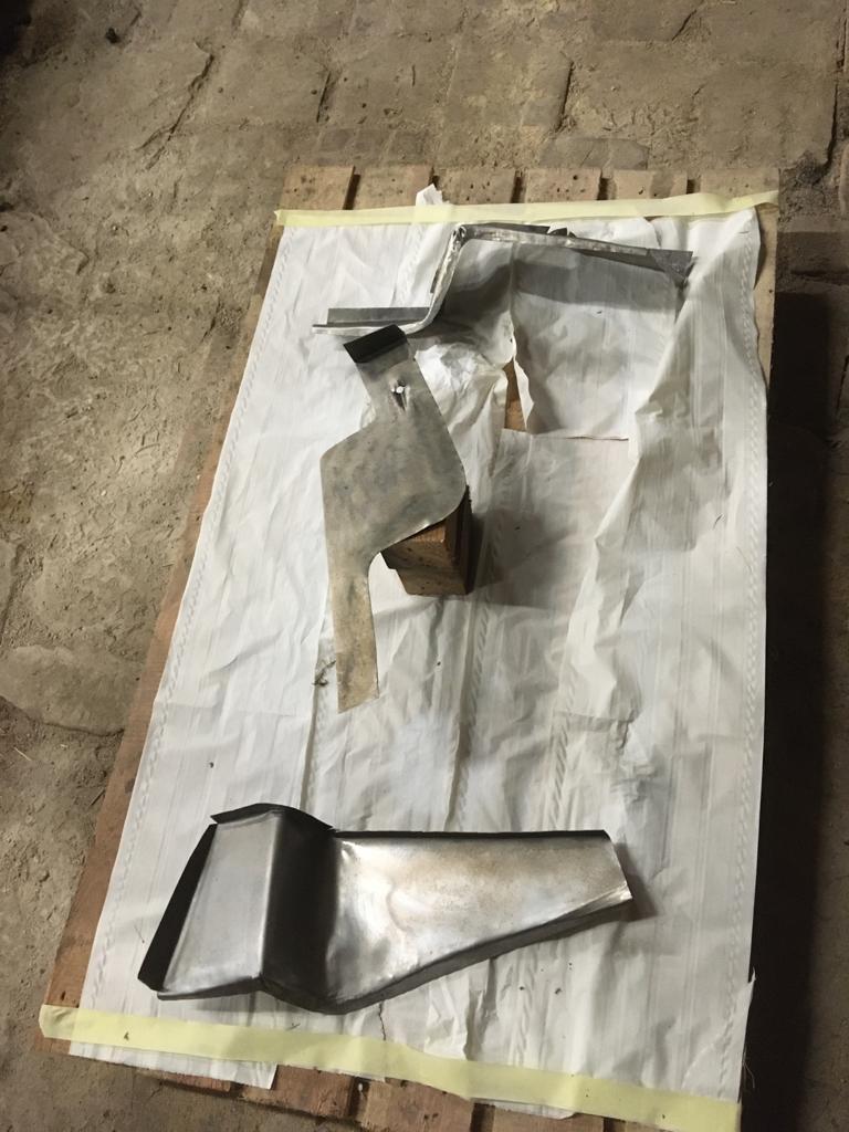

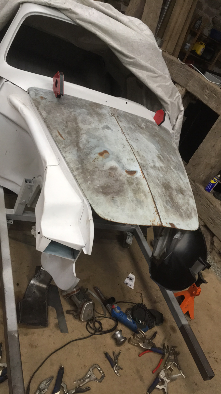

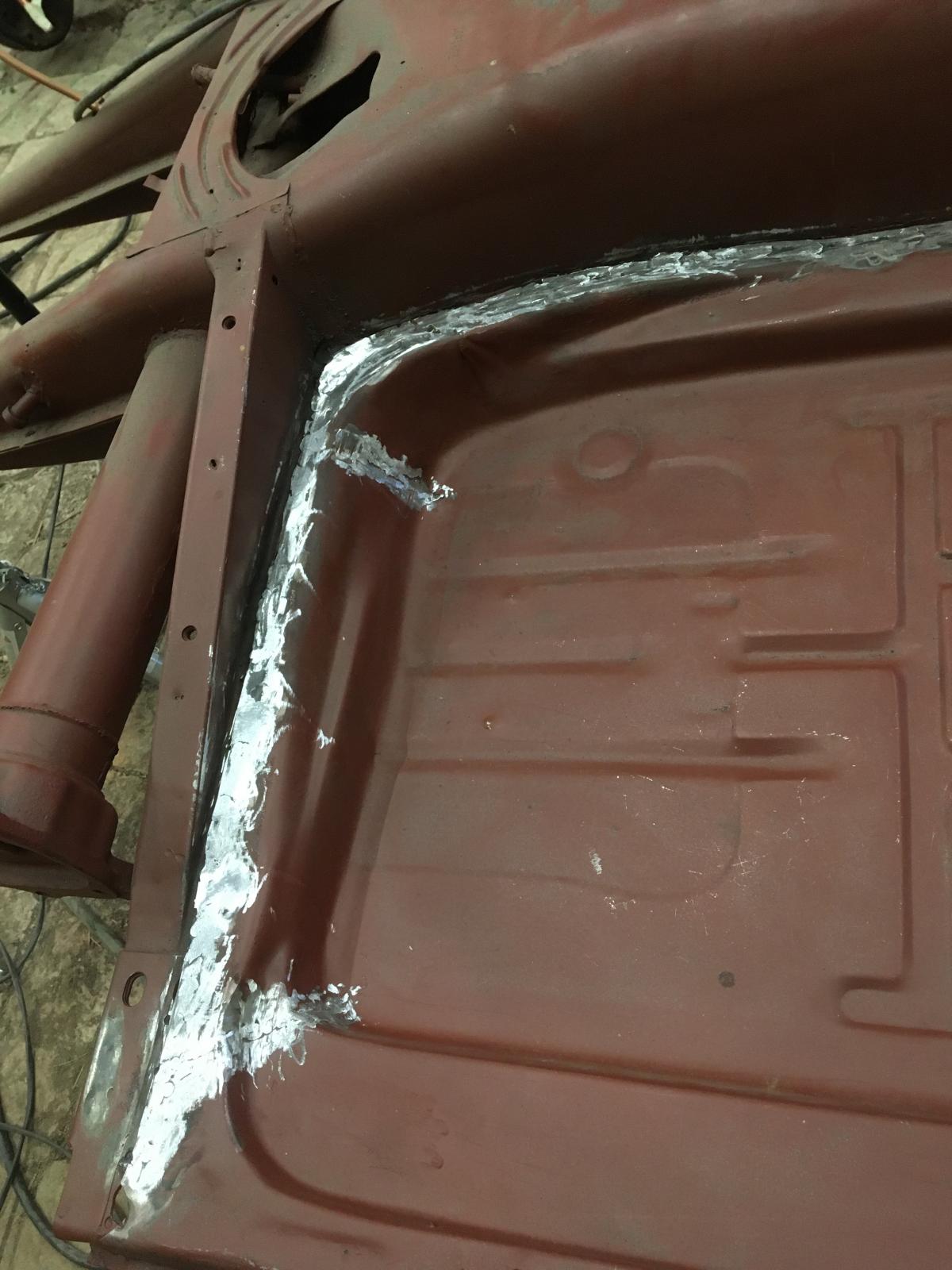

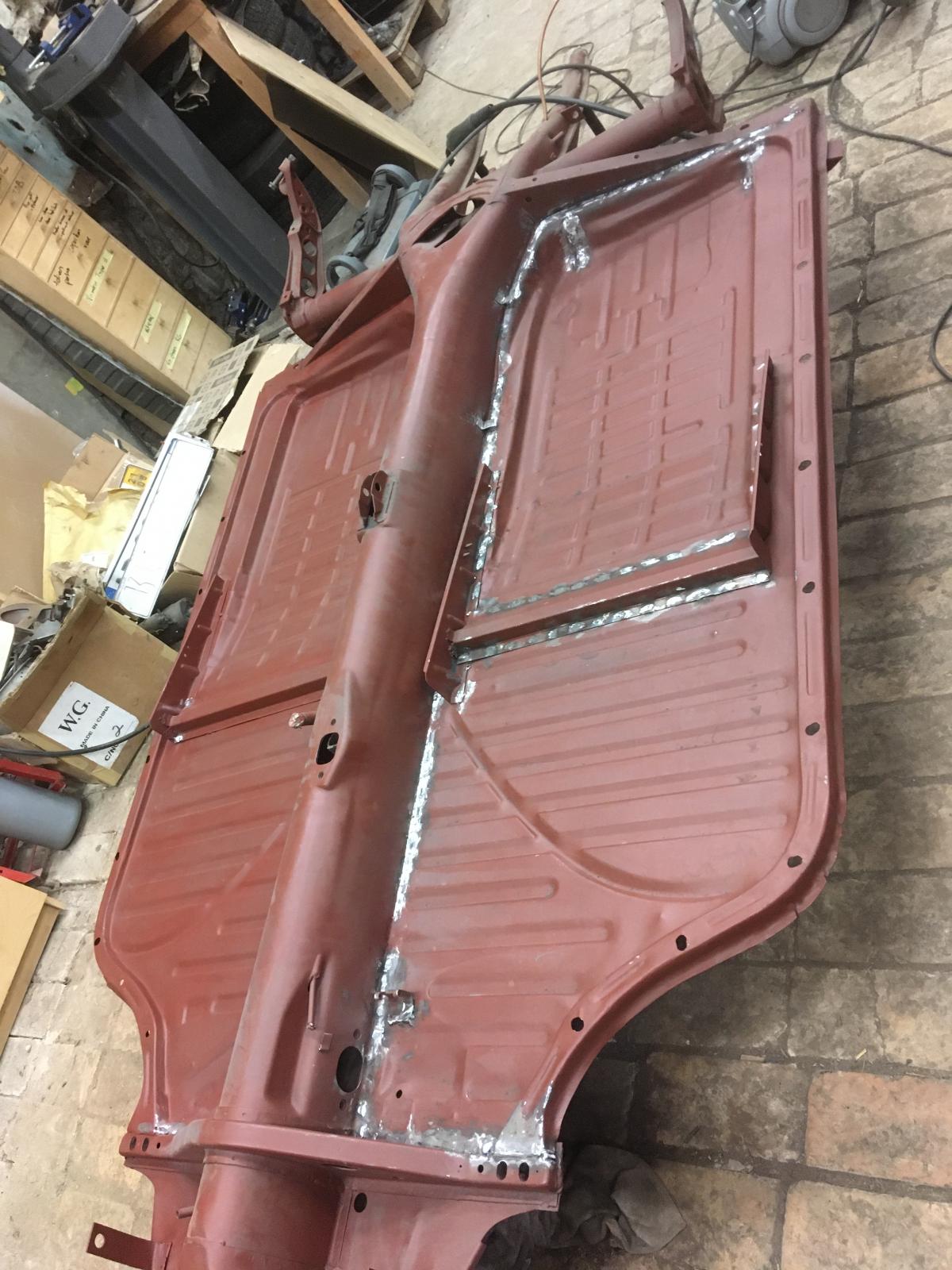

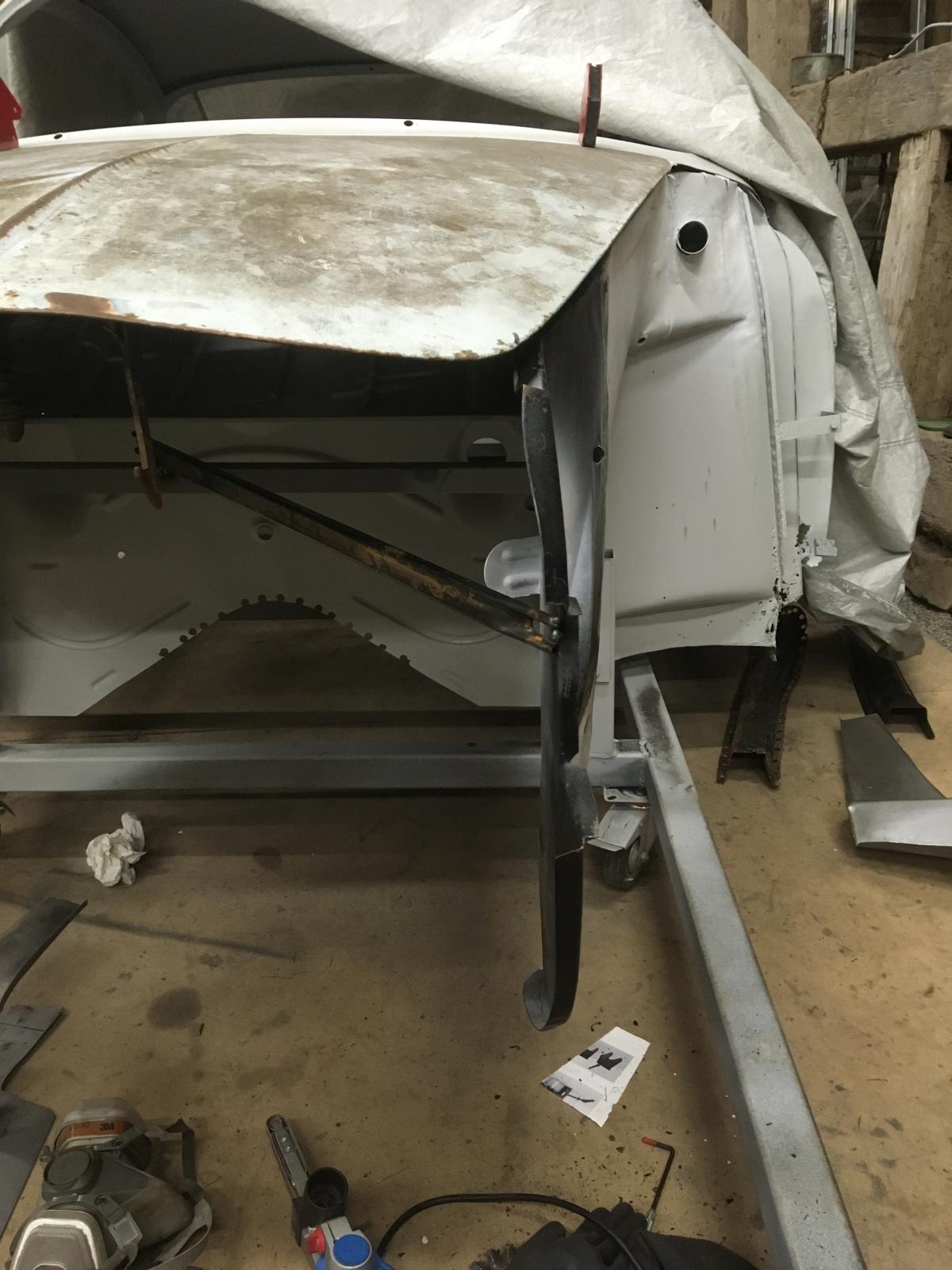

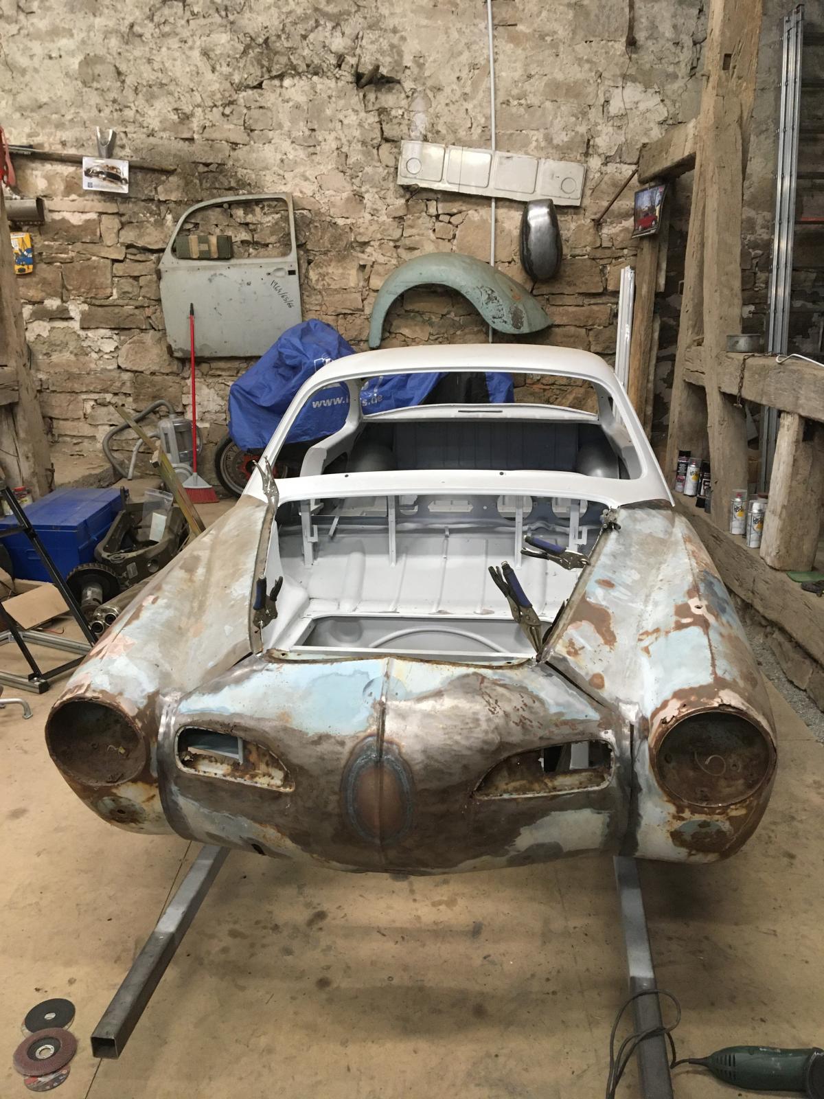

So, continuing on my latest update, it was almost fully welded..but only almost.

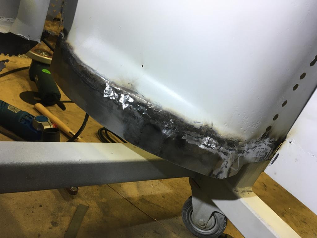

I had originally planned a bit differently but finally made the patch on the whole width as there was some rust in the front too:
so all welded, and cleaned:
Then my attention can go back to the front :twisted:

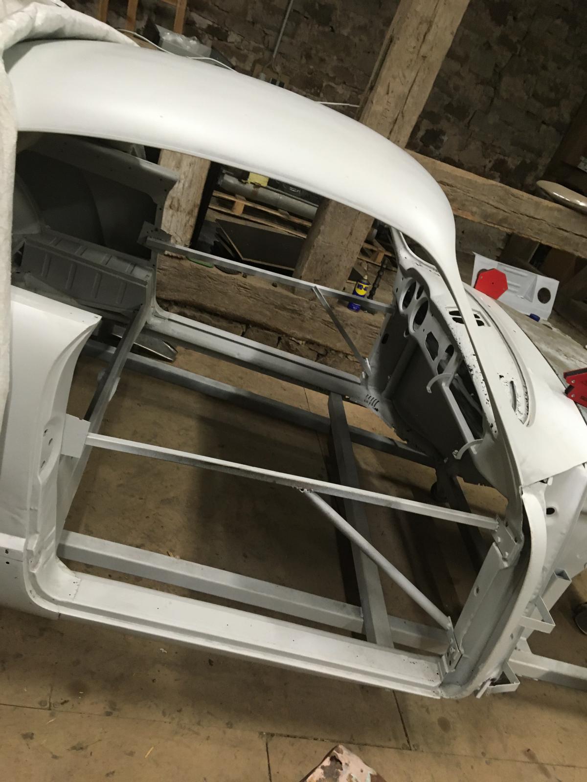

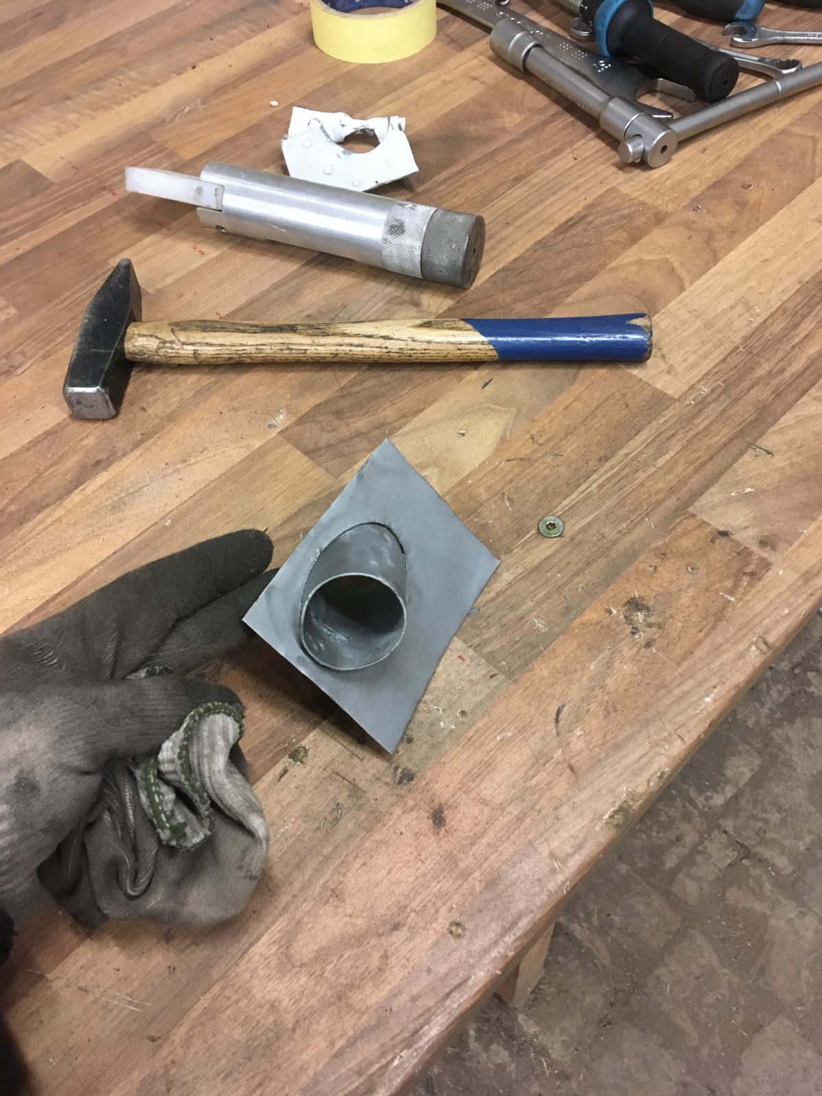

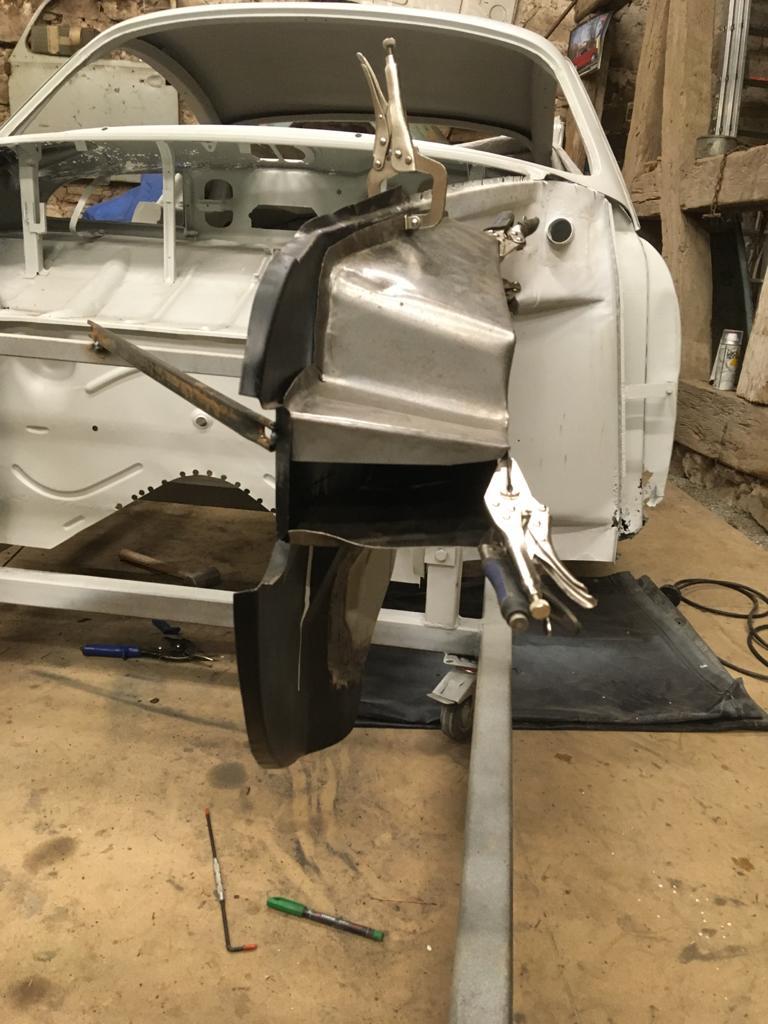

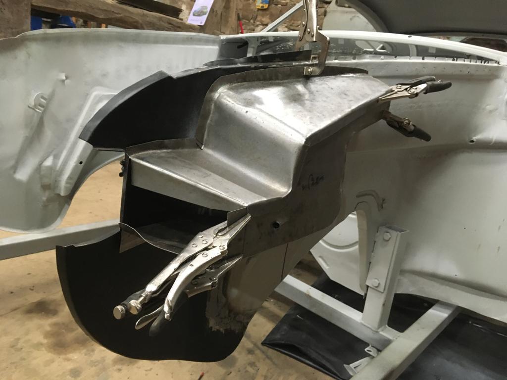

I once again mounted all fenders, hood,.. and took measurement/alignment, and then put some bracing to the front to keep it in the good position:
and then it's a matter of forming the new airbox:
and putting some welding primer before tack welding it together:
