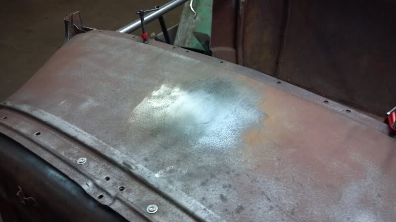

This was my first patch panel. I learned a lot on this little piece. I had to relocate the bend at the bottom and also shape it to it would fit the contour of the cowl panel. I used my MIG welder to do it. I have an O/A set-up, but I have not gas welded since high school. It took me about 8 hours to do start to finish. But I was happy with the results. A bit of filler and it should be fine.

I spent the whole day in the shop. I have spent countless hours here, on youtube, and on metal shaping forums learning how people form metal. I had an absolute blast! This is my first shot at it. I'm really looking forward to more. I'm going to use the gas welder next time. The MIG was horrible.

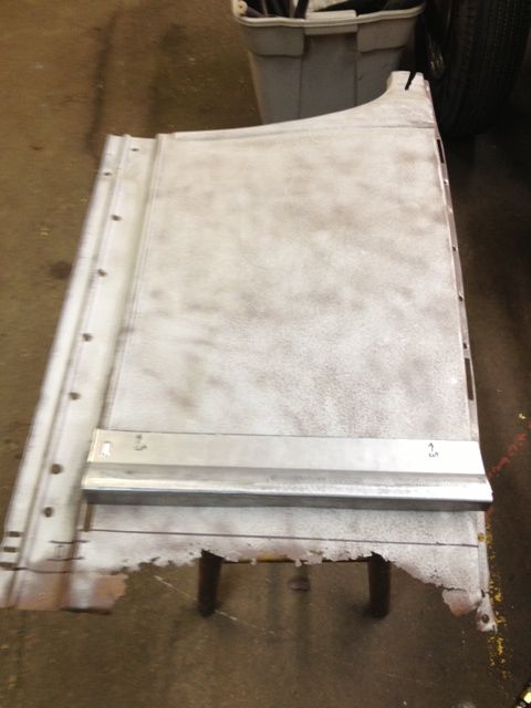

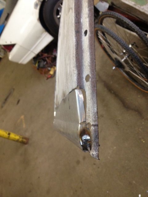

I bought cheap patch panels from a local shop. They had the general shape, but I soon learned the Mr. Ford didn't make these panels anywhere close to flat, in any direction. It took a lot of hammering, twisting, shrinking and stretching to get them close to the shape of the panel.

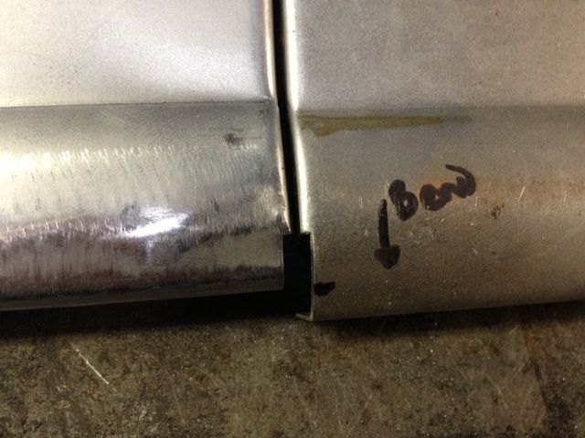

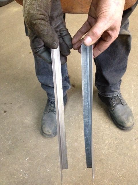

I don't know what this line is called, but it was bent in the wrong location and was thicker than the stock width. I have to bend in flat, then I put in my brake and made a new bend that corrected the width. This turned out to be harder than I expected.

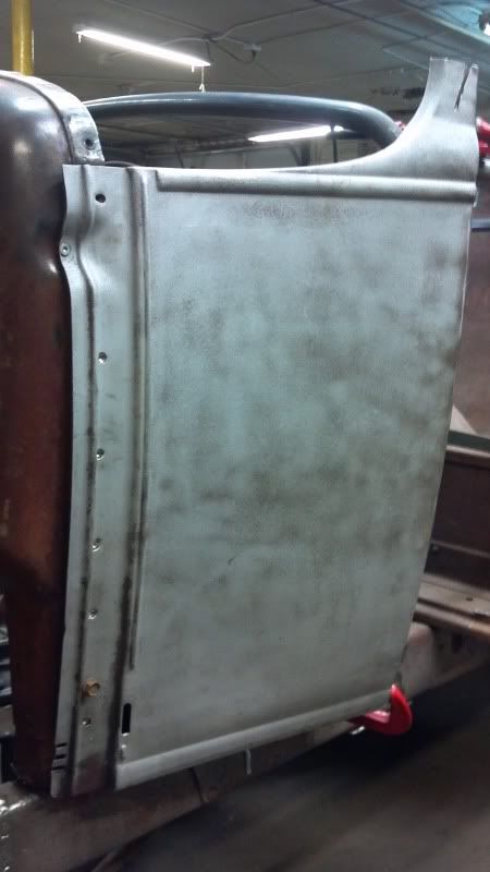

Here's the panel. I drilled out the factory spot welds and removed the panel. It made it easier to hammer weld and smooth.
After the cut and tacked in. The shape was almost spot on.

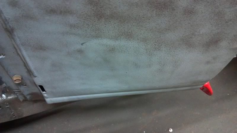

...and this is after a bunch of hammer welding, grinding, more hammering, some slapping and media blast. It's not perfect, but it's real close.
I also patched in the hole where the factory gas tank filler was.
I really like working with sheet metal.
